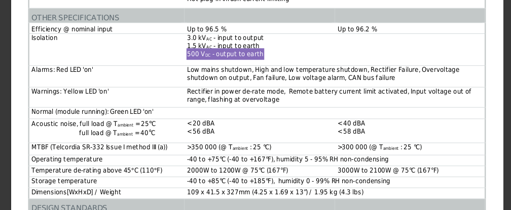

Another option is to use 9pcs of Eltek FlatPack HE2 48V 3000W power supplies connected in series. That will give you 400-518V output voltage and 27kW capabillity or 62A. I run 7pcs for my 96S pack.

bexander wrote: Sat Jan 28, 2023 6:05 am Another option is to use 9pcs of Eltek FlatPack HE2 48V 3000W power supplies connected in series. That will give you 400-518V output voltage and 27kW capabillity or 62A. I run 7pcs for my 96S pack.
The funny part is that I am already building a charger with 9 R4850G2's in series, at 58,5V 3kW per unit gives 526,5V 27kW. But I worry running into unknown safety issues and/or control issues putting so many in series. HV isolation and voltage fluctuations between units for instance. How did you deal with that, do you experience any issues keeping the system stable over the full charge range. Seen any effects of units starting to fight each others CC CV control?

Well, in the FlatPacks case they are specified 500Vdc to earth.
So should be almost within spec with 9 in series.

It really a problem, charger wise when you need voltage above 450Vdc.
EDIT: No issues with the FP fighting each other. I do keep them within there voltage operating window at all times.
