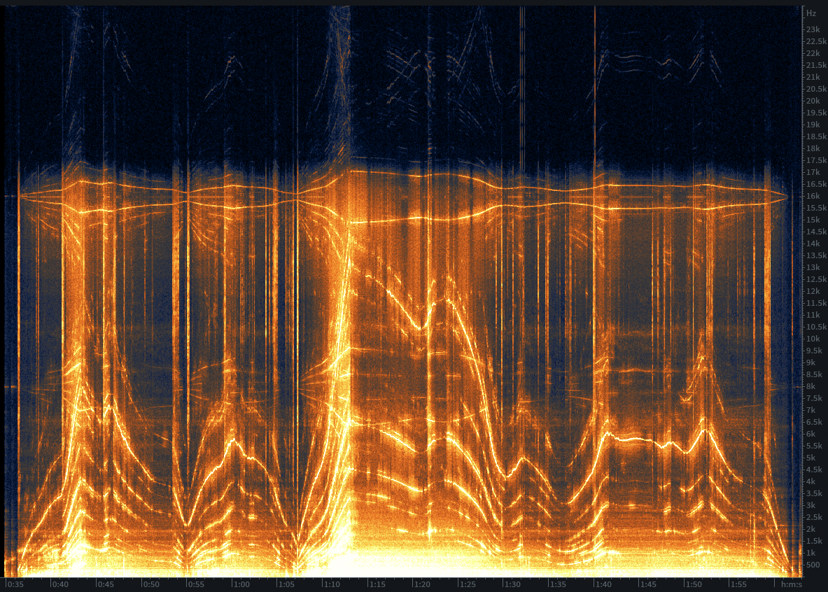

Wow, your replies are so heartening. I didn't expect much of a response at all, and just wow.. Thank you!
Funnily enough playing music loud is really the only solution, so long as it contains enough high frequency content to mask the motor and inverter. To me, that's kind of a "don't shower, just spray on some more axe body spray" solution, but it truly is the best fix I have come across.
I did try some absorption materials at the top of the bonnet and they actually helped to reduce some of the more offensive frequencies. The firewall was also mentioned. I made numerous recordings with a cardioid lav mic, and indeed there is substantial noise coming through the front of the vehicle to the occupant compartment. Next steps, attempting sound dampening material under the bonnet, and textile/foam + MLV on the interior firewall.
For fun and testing I taped the lav mic to plastic cover on top of the motor. Here's what that looked like. Pretty lines! If only it had some lower harmonic content to balance it out..

Pretty pictures!
I'm surprised the noise is that bad in the Mini and would have expected the BMW engineers to have done a better job of the noise suppression. Is you car representative of others, it is possible that there is actually a problem with it?
Or is it that the car is so much quieter without the IC engine that even relatively low level noises become intrusive?

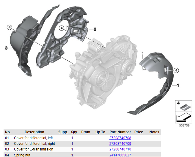

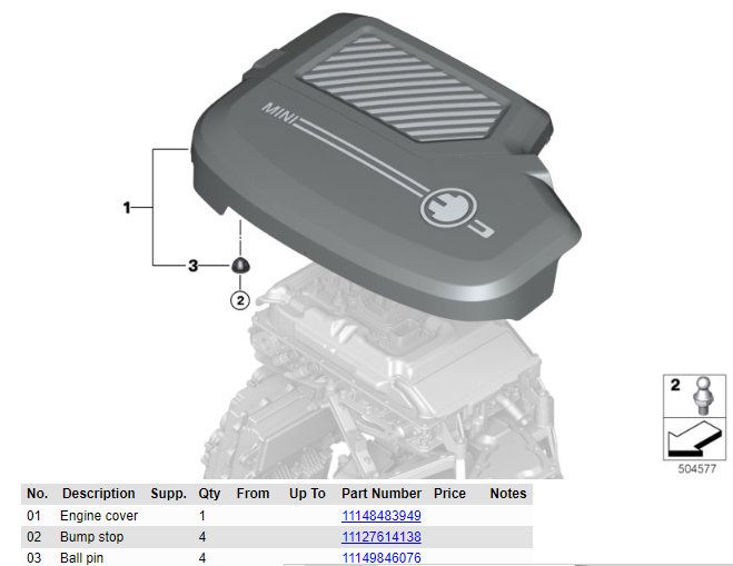

Re: Reducing noise of electric vehicle inverter?
I presume the standard 'acoustic' covers including motor cover - and 3x transmission covers are present and correct?
As mentioned I would check all the rubber mounts are 'free' and not in hard contact with the body?
I would also try filling the void behind the motor with acoustic insulation to see if this helps - old bath towels have been shown (saw a video on video on YouTube so must be true
) to be virtually as effective as actual acoustic panels but for free!
You could also try covering the fire wall in dyna mat type damping panels.
How about a white noise generator - picking a frequency which doesn't offend your ears?
Noise cancelation is interesting - but in an automotive environment (a metal box) I would say (guess) is really rather difficult to implement effectively as you will have many sound sources reflecting around the cabin. Bose and JLR have noise cancelling systems but I think these both work on lower frequency noises which don't bounce/reflect as easily.
