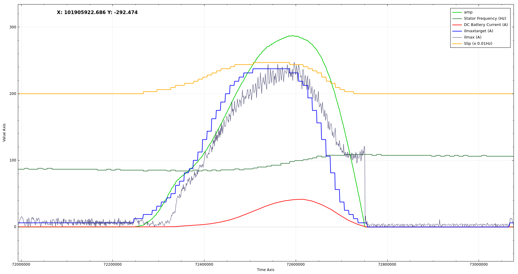

Well... I seem to have found a way to work around the problem! I compared the data for the V/Hz and the current control modes, and the obvious difference was that the V/Hz code uses fslipmin at all times, where my code adjusts slip according to torque request and previously did not even have a concept of fslipmin.
So with fslipmax=3 and offthrotregen=-20% I was running 0.6Hz of negative slip. In theory, this is the right amount, but in reality this seems to be the cause of the instability.
I tested with fslipmin=2, fslipmax=3 and the problem was significantly reduced, at fslipmin=3 the problem went away almost completely.
Once I started using fslipmin, I was able to notice a second (and more expected) issue that causes the same effect, very sudden changes between positive and negative torque request. With the higher slip, it became much more noticeable that high throttle slew rates between driving and regen still upset it a little. It's worth noting that because of fslipmin, the *slip* transition is still instant, no matter how slow the throttle moves, but the current request tapers down to zero before coming back up. Looking at the charts, the defining factor that seems to solve the problem is that current much reach zero before starting back the other way.
I will implement a few more code changes now so that I can experiment more:
* Configurable slip slew rate limit
* Configurable current slew rate limit
* Individually configurable fslipmin and fslipmax for forward and regen modes.
One big success here is that I'm seemingly able to control regen all the way down to a stop
NB. this is only tested in axle stands for now.
Attached charts showing acceleration and regen cycles. Note that in one example I came off the throttle excessively fast, and the current did not reach zero before the regen began, causing a small overshoot on the regen current.

Here are closeup examples of good and bad transitions (same graph scale to make clear the slew difference), note in the second example, stator current never reaches zero and hence causes the overshoot as it rises again.
Edit: I wonder if increasing the strength of my PID would fix the second example, as a faster drop in voltage would probably cause a faster drop in current. I haven't done much tuning on it beyond the major fslipmin experiment.
Edit 2: Looking again, maybe the best solution is to set the negative slip (which seems to pull the current down hard) and wait for it to reach zero before allowing the current request to rise again.

One more chart, this is letting the regen run all the way down to a stop (regenrampstr is set to 2Hz to prevent oscillation when stationary). This is an area where I hope this algorithm will improve real driving.

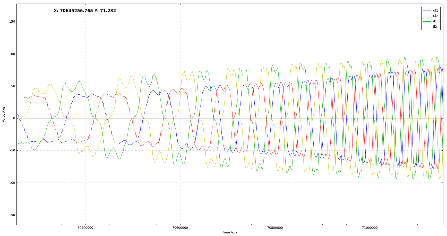

Another day of studying graphs, and I think I'm better starting to understand what's happening here, but essentially I believe Pete9008 is right about this being all about rotor current. The following is speculation, but seems to match what I observe:
Starting with the situation where the rotor is spinning, and no current is flowing in the rotor:
1) We raise the stator voltage until we see the desired current flowing. At this point, the motor is drawing power from the battery.
2) The combines stator current and slip causes a current to start flowing in the rotor.
3) The rotor, now having current, starts to cause a back EMF and changes the phase of the stator current.
4) After a short while, the net flow of energy switches to being motor -> inverter -> battery.
5) The back EMF slightly exceeds the inverter voltage and current rises.
6) The algorithm attempts to reduce the current by reducing the AC voltage
7) This only further increases current until the output voltage reaches zero, essentially a short circuit across the motor which pulls a huge current until the fields collapse or the inverter shuts down
Here's a close up example of this happening repeatedly, at consistent slip. The high frequency oscillations are caused by the output voltage oscillating between 1 (basically a short circuit) and 0 (which shuts down the inverter): One puzzling question is why the current is proportional to the inverter output voltage in V/Hz mode, when seemingly the opposite should be true. My suspicion here is that the slip used is high enough to weaken the rotor field, and ensure that the back EMF never exceeds the inverter voltage, and hence the inverter is the one controlling the current flow. This explains why my algorithm becomes stable if I increase negative slip well above the point of maximum efficiency. Of course the main reason that V/Hz is stable here is that it doesn't reduce voltage when there is a small increase in current.
The question is how to fix this. For now, I see two immediate solutions:
1) Run higher slip during regen. I'm experimenting with this.
2) Run V/Hz during regen. This is irritating but seems like it would abruptly solve the problem, and might be a lot more stable until we have "proper" FOC.

So here's another interesting thing that's come up today. Even if one has a consistent positive slip (forget regen), reducing voltage does not necessarily reduce current linearly and immediately. This probably isn't hugely surprising, but what *is* surprising is that current actually rises momentarily when inverter voltage falls below back EMF. Not a huge problem, just another interesting and annoying factor.
Sometimes this effect can be more pronounced.
I've decided that for now I'm going to run things with current control, but using the fslipmin and fslipmax from the V/Hz algorithm. This means in theory I should be able to just control voltage the same way V/Hz does. It actually works quite well, but the relationship between voltage and current can be a little slow and weird at times. Doing this work the right limits on slew will hopefully work.
At around 500ms (0-100% throttle) the algorithm seems pretty effective. At 150ms things get a bit messy particularly when trying to reduce regen and go back into positive torque. I now need to work out whether to simply limit the slew, or whether I can work around it more effectively.

I'm looking more closely at these voltage-current charts, and something is amiss! This is not a happy shape for a current sine wave!
Not sure if I've messed something up with my changes.
Edit:
Looks like a small offset in the current sensors is causing the total calculated current and hence the output voltage to oscillate so this is a "me" problem
It goes away once the current is significant.

Pete9008
- Posts: 1801
- Has thanked: 102 times
- Been thanked: 350 times
Re: Current control of induction motors
Think that is just the space vector modulation (gets an extra 15% amplitude by shifting the zero point around). Or do you mean the bit around the zero crossing? If so then that possibly be a little oscillation in the slip calculation.
Edit - ignore me, it shouldn't be there in the current waveform too! No idea what that is
Edit2 - Wondering if it's due to the way the space vector bit is done. It doesn't add a true third harmonic, instead it shifts the waveform. Wondering if the small errors introduced get amplified somehow by the motor impedance?

I'm pretty sure the problem here is that a very small offset in one of the current sensors causes my calculation of RMS current to oscillate a little. The current control algorithm tries to correct it, causing an oscillation that matches the frequency. It's really only noticeable at very low frequency and amplitude.Pete9008 wrote: ↑Wed Jan 25, 2023 8:23 pm Think that is just the space vector modulation (gets an extra 15% amplitude by shifting the zero point around). Or do you mean the bit around the zero crossing? If so then that possibly be a little oscillation in the slip calculation.
I was originally concerned it might have been a problem with the SVPWM output, but that's so simple there's really nothing to go wrong, so I found the problem elsewhere. It only exists in my new code, so nothing to worry about.

i believe you're correct. My understanding is that the D current can just be a constant amount to correctly magnetize the rotor, and then Q can be controlled directly according to desired torque. The (VERY) hard part is estimating the angle of the rotor field though. Once you know that, everything else falls into place.johu wrote: ↑Wed Jan 25, 2023 8:37 pm FOC by itself doesn't optimize there. If you feed an induction motor pure q-current it will not move at all as you need d-current to magnetize the rotor. So similar to MTPA for PM motors you need an algorithm on top of FOC that decides on a wise d/q split and a slip calculator that derives slip from d/q and some motor parameters. Way back in the tumanako project they had worked out some basics, like here: https://github.com/tumanako/tumanako-in ... lipAngle.c
