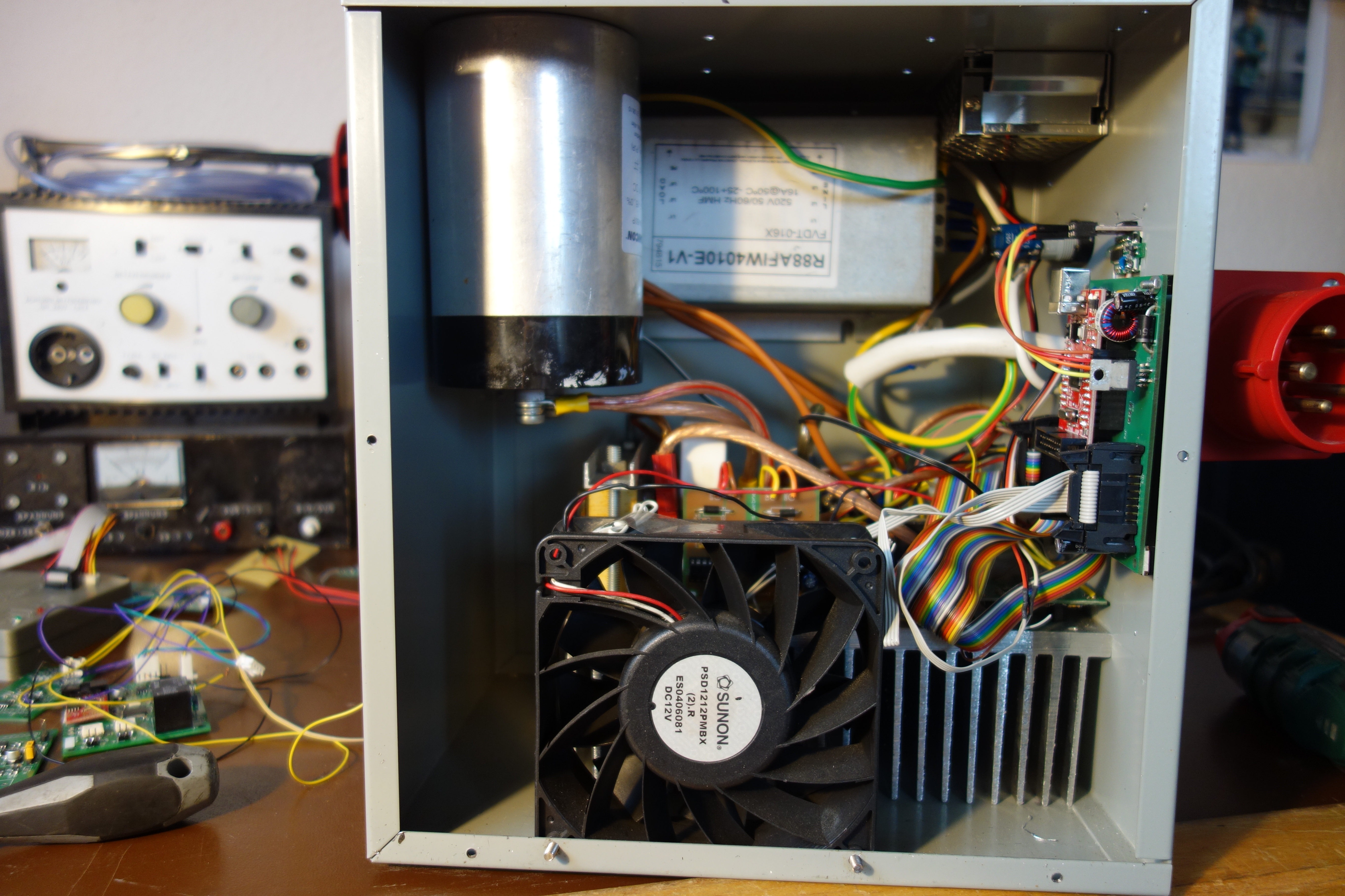

So since Touran has no built-in AC charger at all I created various hacky ChaDeMo chargers to still be able to charge it at home. For sake of completeness I will present the 3-phase version as well.
Power path: grid filter -> 3-phase rectifier -> buck stage -> output.
Let me walk you through this electric mayhem - again
Ingredients
  • Metal enclosure that has to be lurking about in your basement (don't buy new)
  • Heat sink (must also be left over from a previous project - EMW charger in my case)
  • Fan (large 120mm from EMW charger)

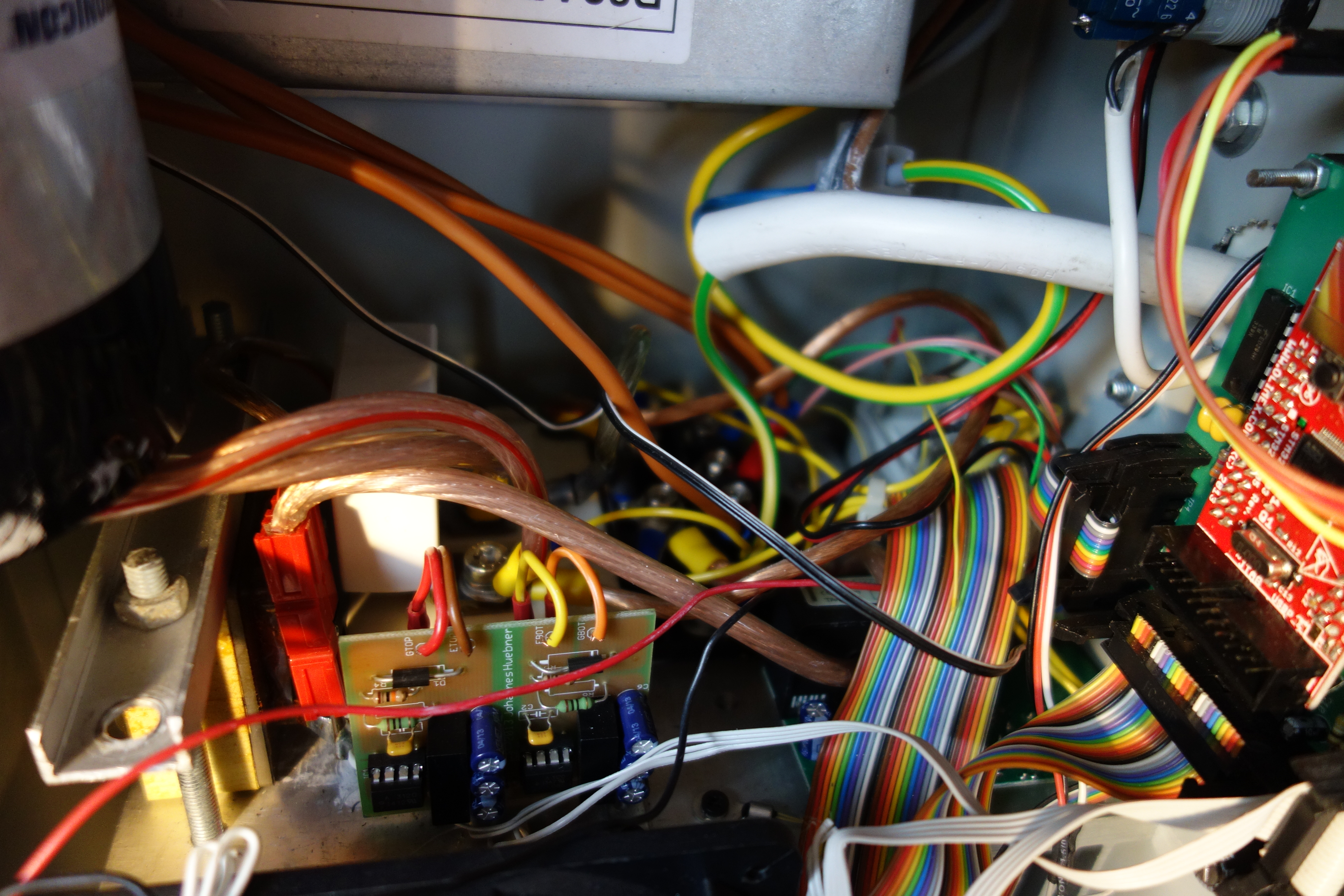

  • Rev2 or 3 inverter brain board
  • Rev2 gate driver - half populated
  • About 50A IGBT brick, 1200V! (in fact I use a 400A brick)
  • 100A or so 3-phase diode rectifier (cheap as chips, these)
  • an EMC grid filter (or your fuses will sing, also we want to be nice to the grid)
  • Current sensor (here: half populated legacy sensor board)
  • inductor (buck inductor from EMW charger)
  • A 420µF film cap and a precharge resistor, discharge resistor (ooops, forgot about the latter)
  • IC sockets (that are hot-glued to the Anderson connector to carry the ChaDeMo control signals)
Update: the IC sockets were bullshit, replaced them with a separate 7 pole connector left over from, guess what, the EMW charger.
Operation:
  1. Plug in ChaDeMo (best do this first, as the output goes live as soon as you plug in - who needs an output relay :evil: )
  2. Plug in mains, hit start
  3. The cars battery relay is closed
  4. The configured max charge current is transmitted via ChaDeMo
  5. The current command from ChaDeMo is obeyed
I have no idea if the power factor is any good, but it runs fine at 9kW for prolonged time. I took it up to 11kW (28A battery). The fan is temperature controlled and has to go mighty quick (and noisy) to remove the heat. Bucking seems less efficient than boosting.
If you're interested I can upload the software to github. Works the same as the inverter software. Web interface, CAN mapping and all that. It's the same software as the 1-phase version.
But strong disclaimer: this charger is a mayhem, it offers multiple chances to be electrocuted - don't do this at home.

Rich man just blew a 400A IGBT brick. I connected it to a 22kW EVSE and already at the default setting of 28A DC the charger sounded a bit angry. I then set it to 32A and the charger shut off. It worked subsequently for another second and then died for good. Replaced the brick and it seems good again, will test at full power later.
I do wonder what caused the trouble. Maybe the grid at the EVSE had such low impedance that the control loop just didn't react appropriately to the little 3-phase dents. Also the failure mode of the IGBT is a bit unusual: it failed open. I tend to think that I lost the bond wires. Might open the module to check.
Take away: don't let your charger sound angry, it is telling you something ;)

Like i said Johannes, you want to have two contactors with charger in between. AC contactor on input and DC contactor on output. So whatever happens to the grid energy at shutdown will be small and usually IGBT will survive. I managed to run my buck charger that way for 6 years now. Also for good measure i add 100A output diode so HV battery + will never see IGBT.
