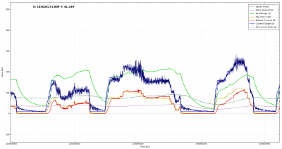

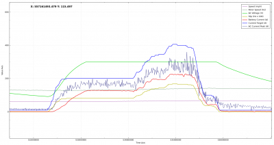

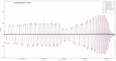

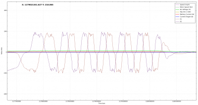

Re: Current control of induction motors
Pete9008 wrote: ↑Sun Jan 29, 2023 8:34 am I think you could be right with your suspicions about deadtime. At small pulsewidths deadtime will have a much larger impact and will cause the current to be slow to move away from 0 which is pretty much what you are seeing. Will be interesting to see your results with svpwm disabled but my guess is that the distortion around the zero crossing will still be there.
Edit - actually is this right with centre aligned PWM??
Johannes is correct. At zero sine wave amplitude, the inverter output is 50/50, so i think the deadtime should be negligible.
I redid the test with SVPWM offset disabled. It's still broken. I can't comprehend what's going on here
There seem to be multiple oddities to see here, but the standout problem is the odd current shape.
NB. This is running at 0Hz shaft speed plus 0.5Hz slip. The period is about 2.5 seconds. The top values are the actual hardware PWM outputs (shifted down, originaly centered at +1024 to fit nicely on the chart)

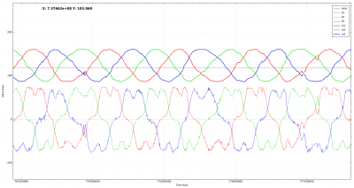

What's the voltage scale there, any idea what the actual pwm register values are? Very suspicious about the zero crossing, if its not deadtime then quantisation?
Edit - I think the zero crossing distortion on one phase may be responsible for the peak dip on another.
Edit2 - pretty good sin waves though
Edit3! - do the SDU gate drivers have any deadtime functionality built into them?
Edit4!! - do you have any way of plotting the phase to phase voltage values rather than the phase values. I think that small waveform distortions may be leading to phase to phase errors that would become apparent if they are plotted.

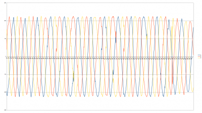

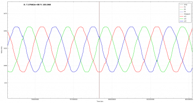

1) The PWM scale is 0..2047, centered at 1024. Attached is a chart with the raw values (I just removed the offset).Pete9008 wrote: ↑Sun Jan 29, 2023 9:56 am What's the voltage scale there, any idea what the actual pwm register values are? Very suspicious about the zero crossing, if its not deadtime then quantisation?
2) The sine wave looks pretty good, though I need to work out why it occasionally appears to skip backwards a step.
3) I don't know if there's any hardware deadtime. I assume (hope) the value of deadtime=63 came from somewhere. I'm scared to attempt to reduce it, as my only power source is my battery.
The PWM resolution isn't great, but it really should be good enough to create something that looks like a sine wave.
Edit: looking closely at this waveform it looks like its missing its peaks. Perhaps the resolution isn't good enough?
I've plotted the phase-to-phase voltages (based on the PWM output values). It looks clean.

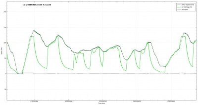

This is with the rotor locked (specifically, this is in my car, with the brake on, and i'm deliberately pushing slightly too little current to create substantial torque).Pete9008 wrote: ↑Sun Jan 29, 2023 12:01 pm I'm pretty much out of ideas then
Only other question is does it still do it with the rotor locked, or is this with the rotor locked?
Edit - I know it's an induction motor but could it be cogging? See https://www.electrical4u.com/craw ... 0cogging.
It's definitely possible that the stator windings are creating this harmonic.

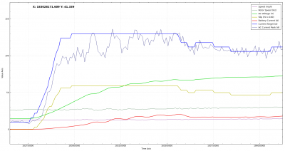

So it turns out the relationship between output voltage and rotor speed is almost completely linear (who knew?!).
This gives me a crazy idea. What if instead of measuring current, I just set the output voltage according to measured rotor frequency?
Yes, I know... but I'm tempted to try something a little different - using the V/Hz curve, but with fully dynamic slip. With the correct motor parameters, I wonder if I can disconnect both voltage and current from the throttle, and instead allow current to fluctuate dynamically while controlling only slip.
I have no idea what the results will be, but I sure want to find out. I guess this is just what you get if you (carefully) set fslipmin=0 and ampmin=100 on the V/Hz firmware, and I'm intrigued.
It's worth noting that I've now proven we can effectively do cycle by cycle current limiting, so after getting fed up with current sensors, I think I will play with the V/Hz firmware for a while and see if I can bring across what I've learned here.
Edit: 30 seconds of testing has put an end to this idea. The idea above doesn't work at all. I'll have another stab at tacking the current sensing issue.

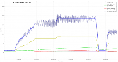

Just did a bit of reading. It seems very likely that this waveform is the result of oversaturating the stator magnetic field at this very low frequency. It may be that the magnetizing current needs to vary with frequency (or more likely, I'm just not setting it correctly).
This paper has some similar looking waveforms. https://www.sciencedirect.com/science/a ... 2316300177
I feel like it would be easier if I had a hard figure for the correct magnetizing current for an SDU, even just a ballpark.
Edit: I'll go read my book again!

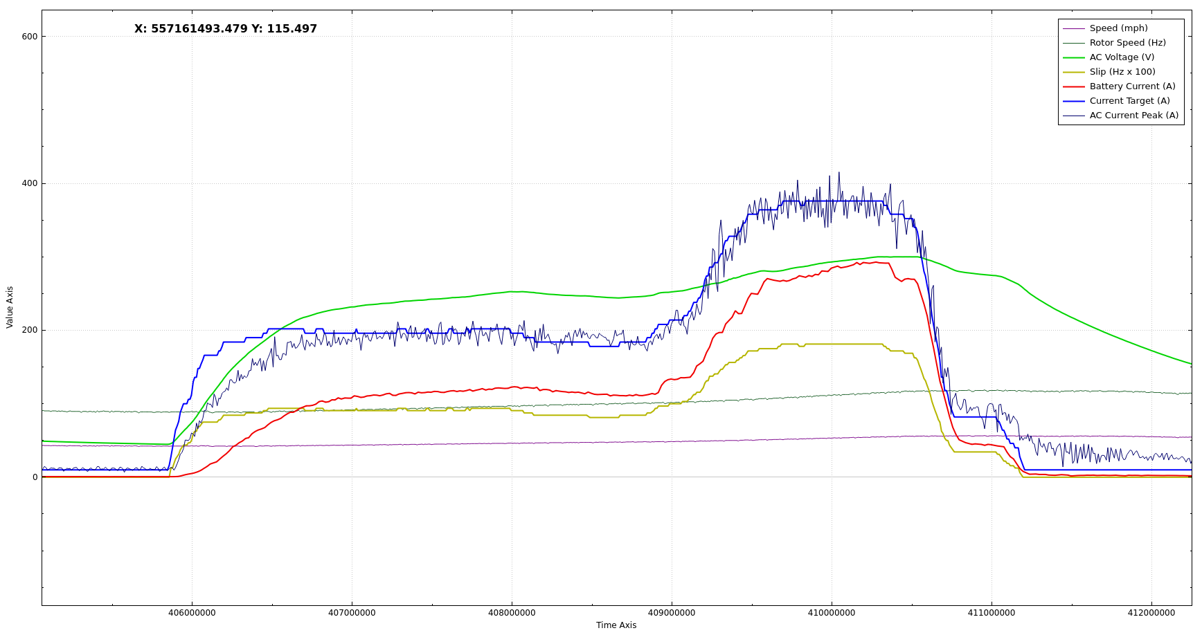

I think the voltage and speed will only be proportional for a fixed rotor current, the moment the rotor current changes so does the flux linkage and so the back emf.
Find it a little hard to believe that you are saturating the stator at those currents, I could easily believe it is saturating the rotor though (that would also give very odd current waveforms).
I like all the approaches that you are are trying here but still think you need a better handle on the rotor current/flux to make them work well.
That certainly seems to be the case. Using raw V/Hz directly doesn't work correctly at all. I'll ignore that idea and get back to learning about current and flux linkage.
I believe you're correct on both counts. I've certainly been flailing a little while learning and experimenting with simple approaches that almost work.Pete9008 wrote: ↑Sun Jan 29, 2023 7:31 pm Find it a little hard to believe that you are saturating the stator at those currents, I could easily believe it is saturating the rotor though (that would also give very odd current waveforms).
Here is what I do know so far:
* Current delivered to the stator windings is divided into an active portion that delivers torque and a reactive portion.
* By adjusting slip, we can change the proportion of D and Q currents.
* At full torque in steady state (at least as far as I've pushed it), each winding carries 500A RMS, the optimal slip is around 3Hz, and the power factor is around 0.6.
* Something is interfering with my current, creating unusual waveforms.
What I absolutely don't understand right now is how and when the rotor is magnetized, and how that interacts with the stator field and current.
I think next I should capture compare the current waveforms with a few different frequencies and currents with the rotor locked. I should also try to find some information about how the rotor gets magnetized.
Thank you for the pointers so far. I realise you understand the physics better than I do!

Here's a dump of the current state of affairs (the good and bad).
Also a savvycan dump of a couple of miles of driving with gentle and hard acceleration if anyone else can be bothered to dig into the data.
The main outstanding problem seems to be the voltage/current oscillations during very slow/gentle driving (ie small slip, usually low rotor speed), possibly caused by unusual current waveforms. Otherwise response is excellent.
