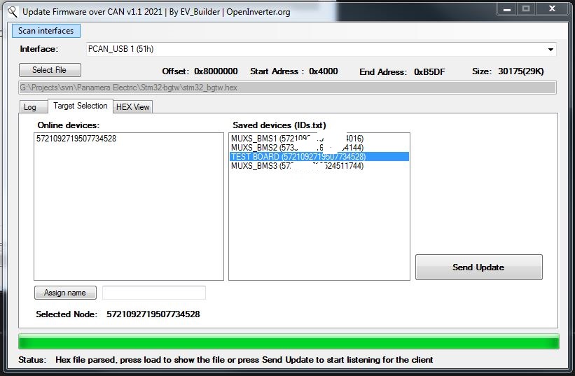

As per title!
Couldn't find anything available so took the bootloader from Johannes and modified it towards a CAN version.
Build a GUI and the rest is history.
The CAN Interface used is a profi one from PEAK Systems.
https://www.peak-system.com/PCAN-USB-FD.365.0.html?&L=1
Didn't optimize yet for performance or size.
Currently 1 msg per mS (8bytes).
+/-8K/sec.

Ok i optimized it a bit i now reserve 8K in the loader.
This is my contribution to the community of OpenInverter.org.
Enjoy!
https://github.com/EV-Builder/CANBootloader

Ok cool! I'm building the Bootloader GUI app right now.
Current speed is like +/-12 seconds to program 27K but i have some tricks on my sleeve remaining.
I think its the host pc limiting the speed not the uController.
(each msg invokes the GUI currently and that's expensive).
(how big are our inverter / charger programs anyway?)

@johu; would you mind add to the bootloader (or paste it here) the code snippet to obtain the unique CPU id?
I need a 5 to 7byte ID.
I want to send it out on the first request for bootloader.
In the GUI we can then select which device we want to adress for the update and give normale names to the devices. (DHCP/DNS style).
This saves us from uploading to the wrong device in the network :)

Ok made the tool stand-alone.
Node selection works.

That looks very nice! Would the GUI also run on Linux?
