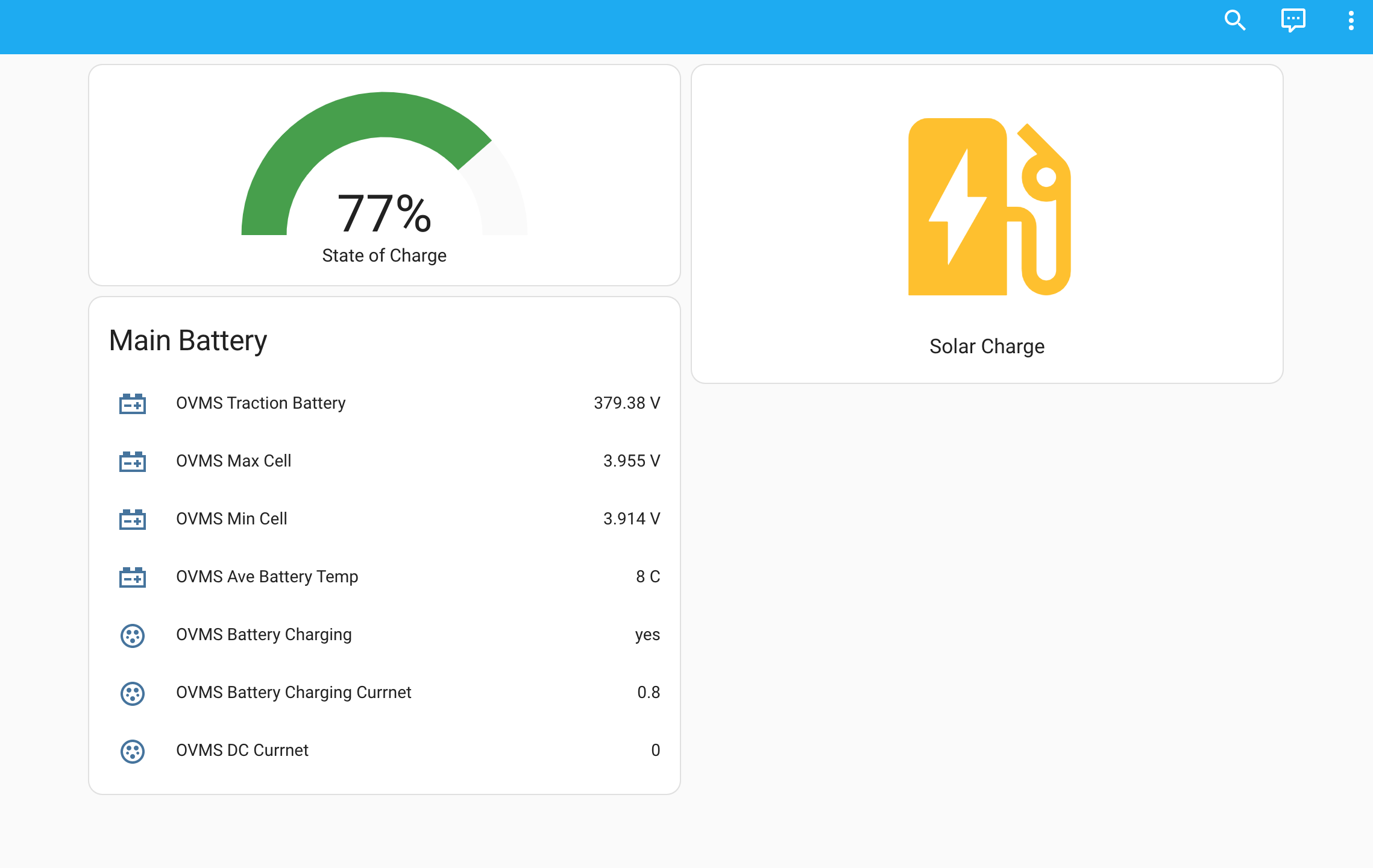

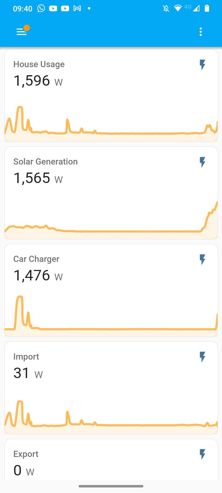

I've been faffing more with OVMS + Home assistant and now Home Assistant is controlling the car charger based on the spare solar capacity I have :D
