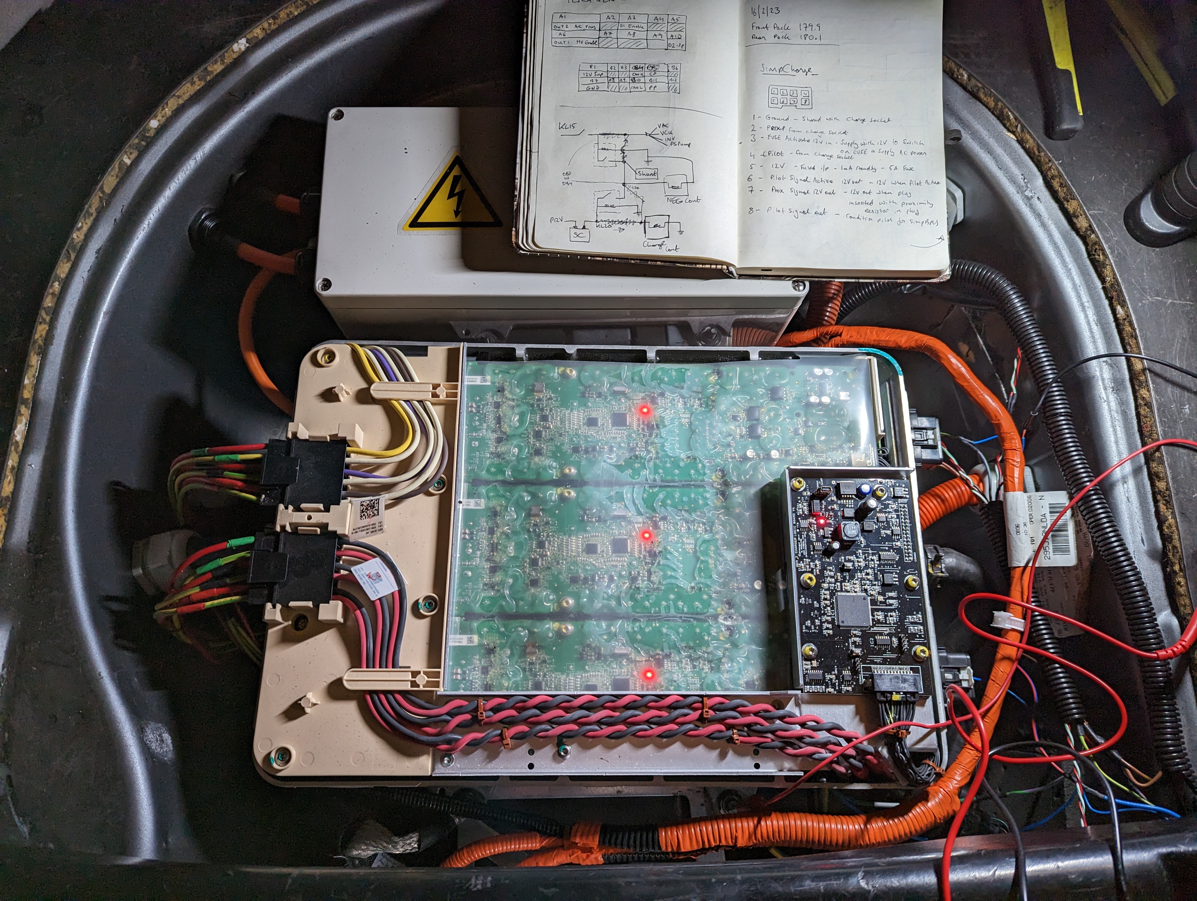

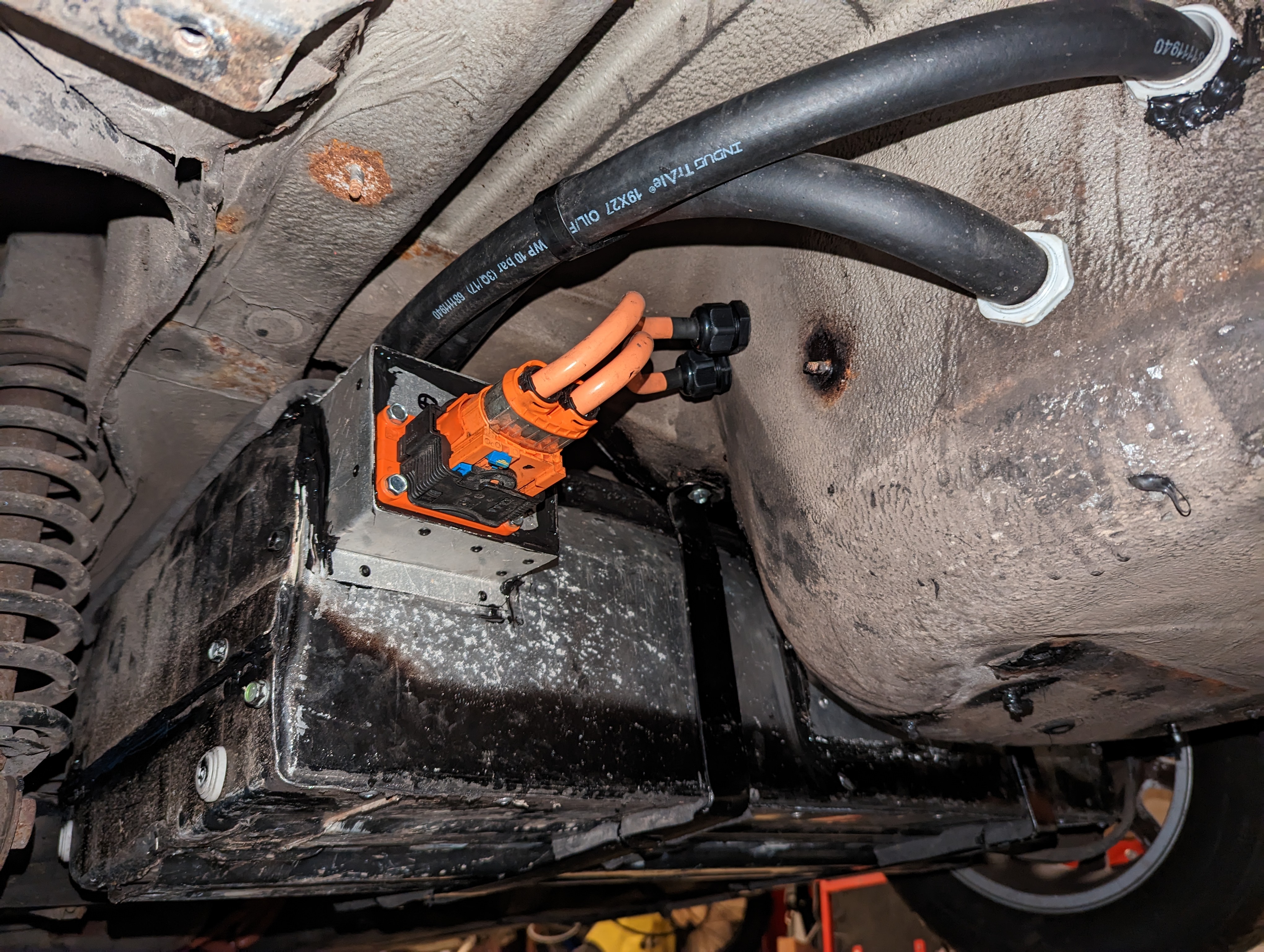

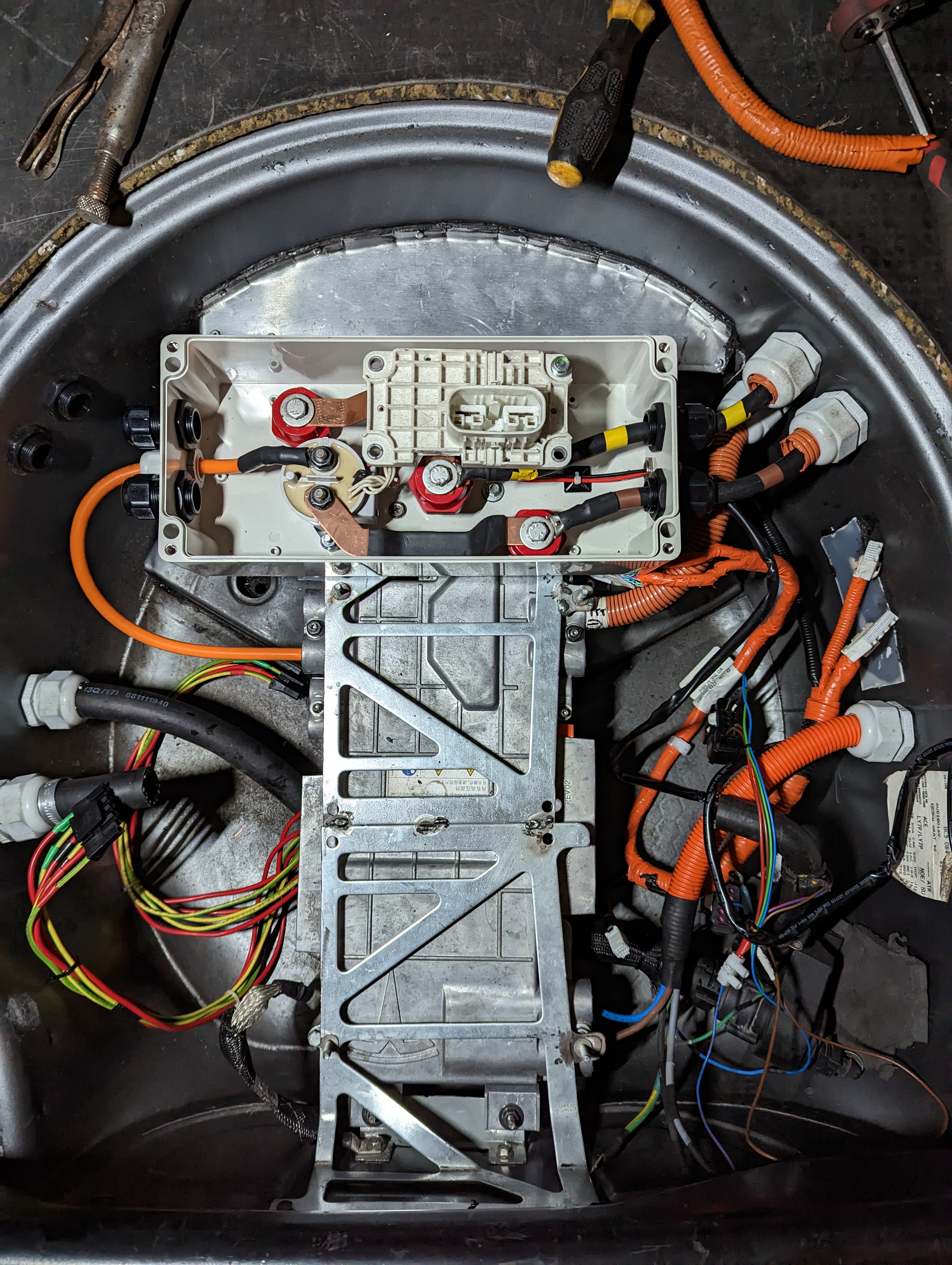

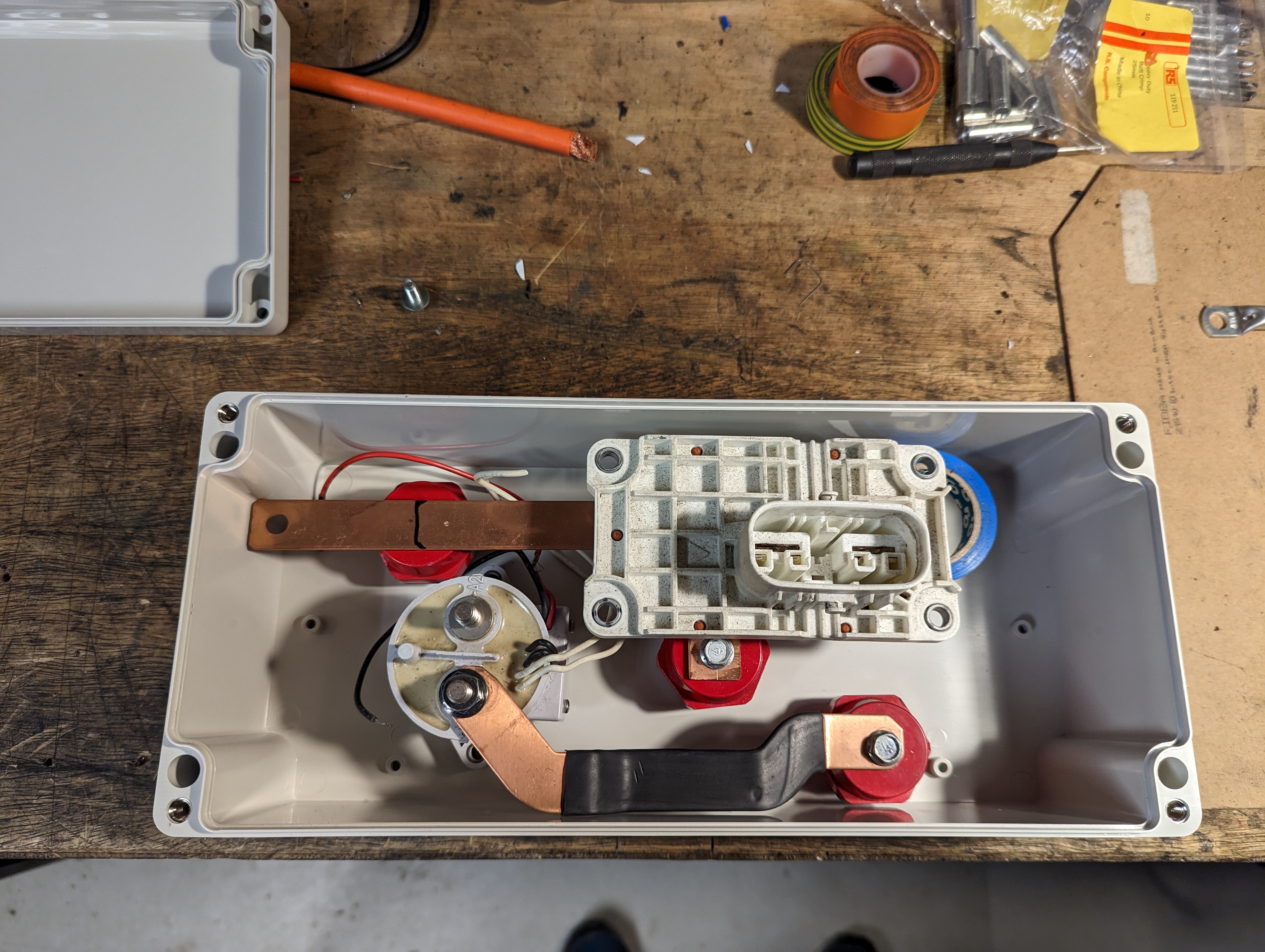

Good bit of forward movement this week. The mess that was in the boot has finally been banished! The first step was to make things just simpler, cleaner and functional. With limited space to play with and many many drafts scribbled, I finally got my hands on a 330x140x120 oblong box that fit my plan, rear pack + and - in from the left and exiting out the right with a contactor and the msd in there for good measure.
Once I knew everything fitted, it was time to install the bits and bobs including some 16sq to the other side of the charge contactor and back to B+ of the Tesla HVJB. The B- connected to the most negative of the pack, back down in the front HVJB.
The penultimate step was then to hook up the + and - to the right hand side back up to the front of the Audi, button everything up and install the charger.
All that's left in the rear apart from buttoning up the rear pack and installing that is to wire up the SimpCharge when it arrives, hook it up to CP, PP, new contactor, charger and pump. Reckon I'll have the rear all done by the end of next week... few steps closer to the deadline :D

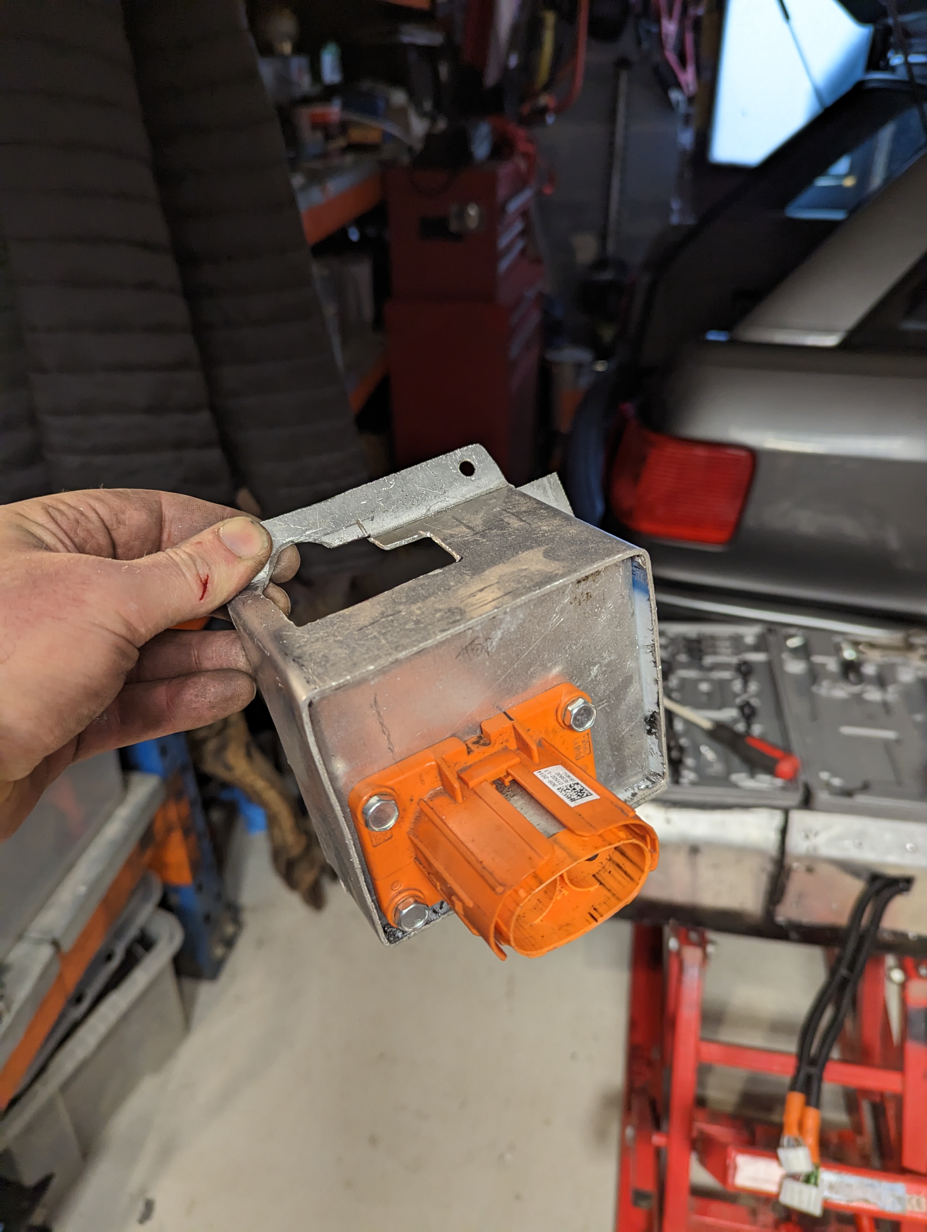

And the revival goes on...

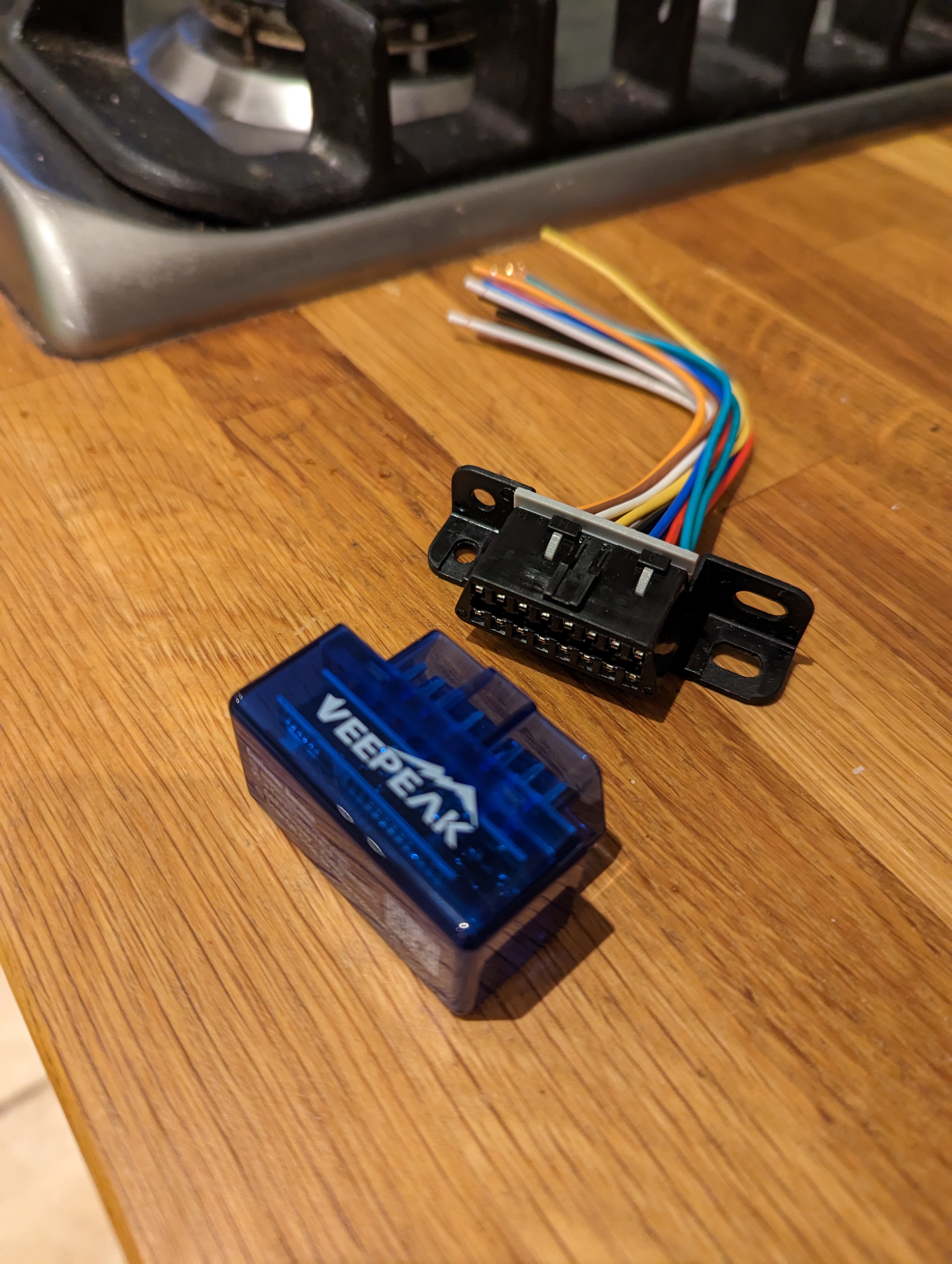

More stuff has arrived. The OBD port arrived as did the reader, ready for inclusion into the updated system. Added to this was some home made twisted pair for front to rear vehicle and the cheapo Android 10, 7" single DIN head unit which I fired up last night and seems like an ok purchase for the price! More on that in another post.

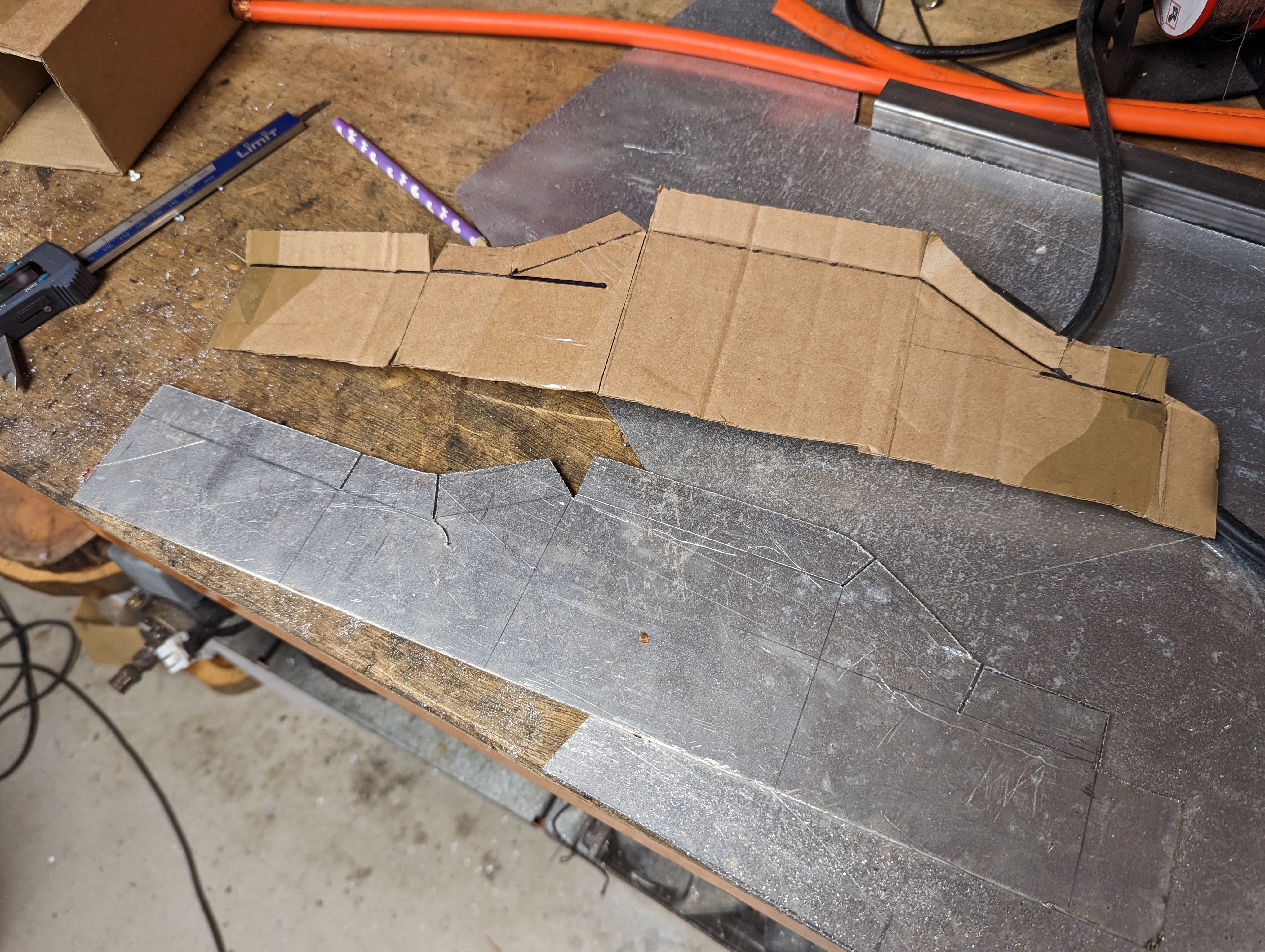

Last Saturday was spent getting back to cardboard-aided-design again... Oh, I missed it so... I first off had to put back in place the old 'face' of the rear pack, cutting out a slightly larger section on the Pos side of the pack to allow ample room for the new (old) HV connector taken from the old box of Leaf bits and bobs I have hoarded since the early days. Quite handy removing and replacing the main pins with ones more suitable length and orientation from other Leaf HV connectors.
After a couple of hours mixed with cutting and deft alu bending on the bench vice, I was actually pretty happy with the result. I then made up a front face for the new box with a good tight fit so it could be tapped into place.
Access panel added in the top to enable hooking up the +and - terminals, we were sorted. The lathering all the joints and interfaces with layers of eastern European automotive seam sealant, it looked a mess but was perfect

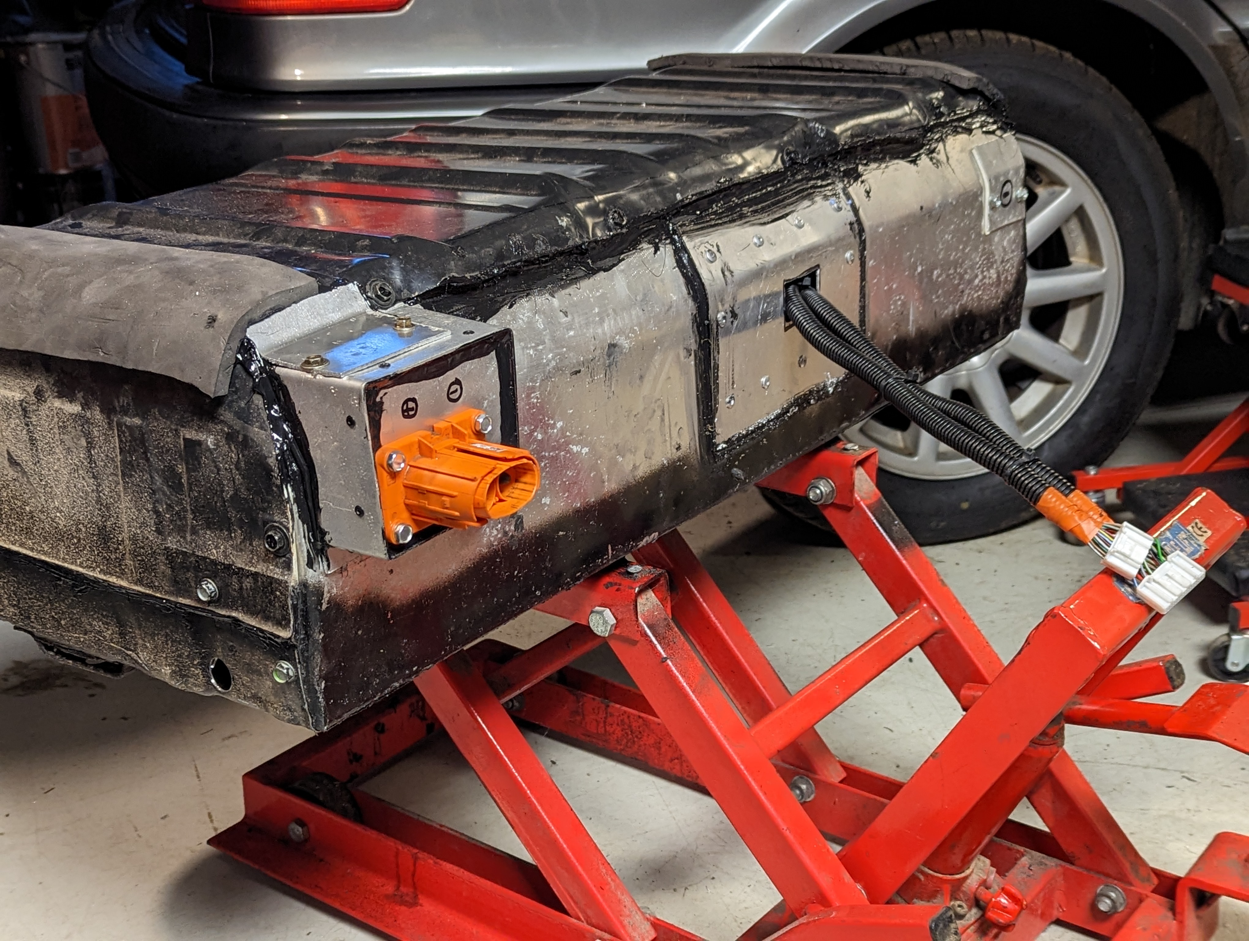

The time had come to offer up the battery again, months later. Delighted. Fits really well and the HV connector worked a treat. Once I had the lengths where I wanted them, I then was able to terminate the ends in the new HVJB in the boot and pop the lid on. Another job finished as time ticks on towards the deadline... Very much more positive now.
Next up, sort out the main Neg contactor control to work in tandem with the new rear Neg charge contactor so only the front main Neg and Shunt come on and nothing else during the charge cycle... at the mo, they all get Ign 12v. The plan is to put in a drive relay to power the main neg & shunt to make it independent from the rest of the power circuitry.
While I'm at that, I'll run the CAN from rear to front and back again, install the new 7" screen, hook up the OBD and at some point.... connect the BMS... the one thing I most fear even though I have checked it more times than I have had Covid tests.

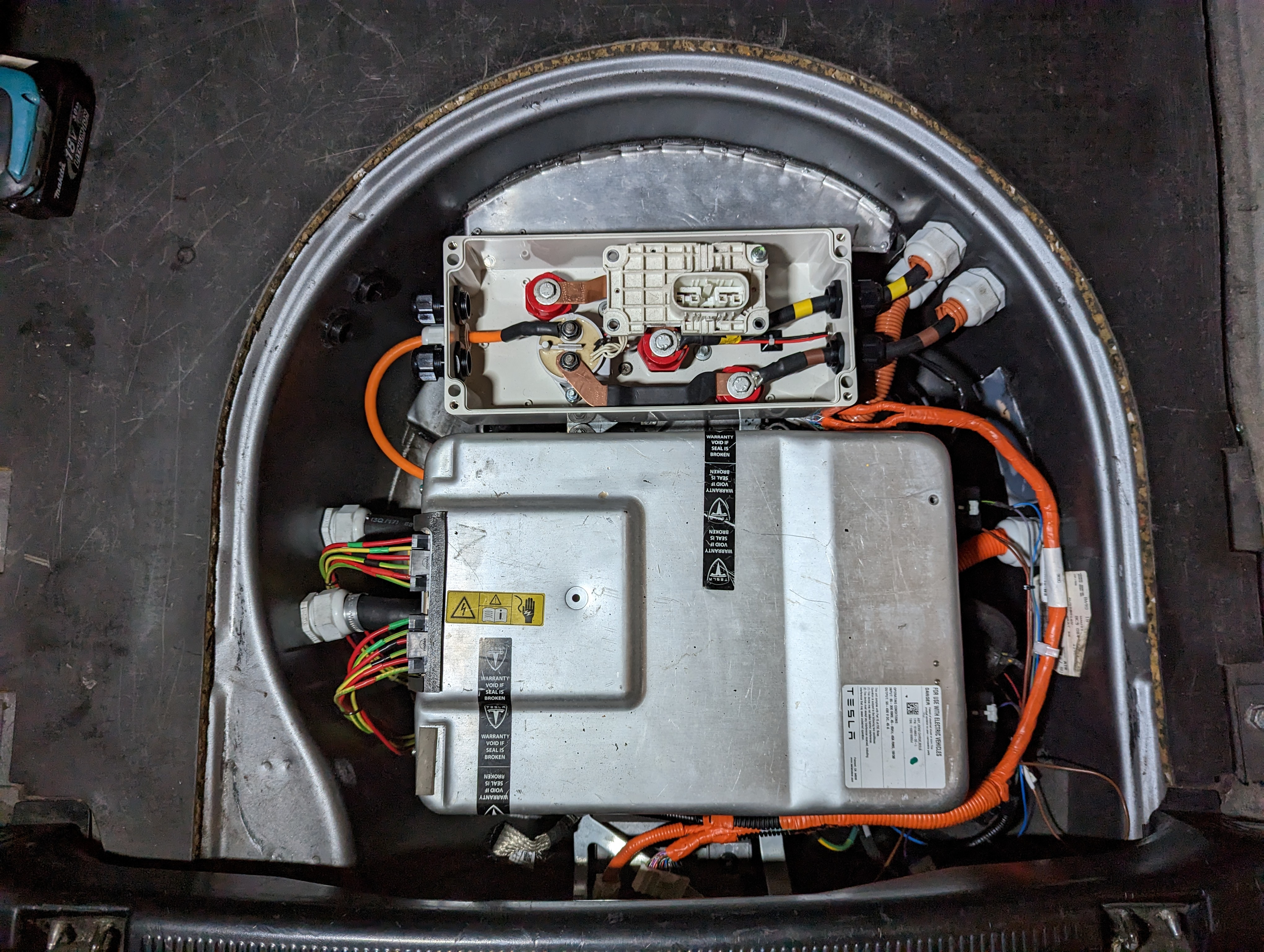

Following on from my last post, we ploughed on and got everything buttoned up, CAN bus run, charge circuit hooked up, HV lit up and wheels rolling.
Really good feeling when it all comes together and copper fastens the idea of documenting everything, and triple checking your work, especially when long days and nights are part of the build. Little mistakes can wreck your head and create noises you didn't want!
Here's the latest update of how I got on.
The last piece of this puzzle was on the SimpCharge and it's something I'm going to isolate over in another specific thread Tom has fed back into based on his work to figure out how best to get things running reliably with the 'workaround' when using the unit in tandem with a Tesla Gen 2 charger.

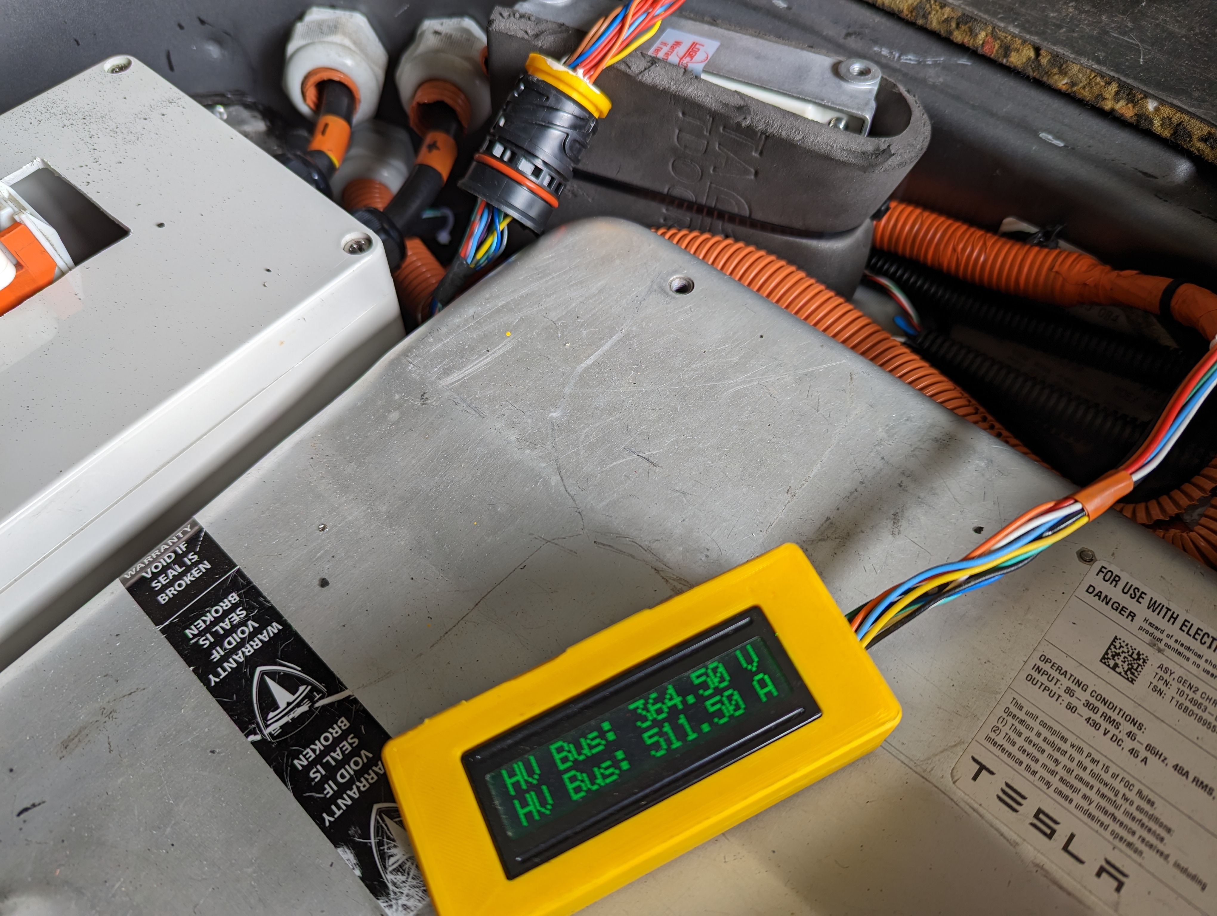

Quick update
Been driving the Audi a lot lately. Well, about 100km so far but, it's a lot for it since it hit the road first. Getting used to it's range capability and from a few back and forth to work, it looks to have an approximate range of 80km. Further testing - taking it to 0% SOC, charging to the top and doing the calcs - are to be done next.
All of this of course to be done with the Leaf BMS in place which, as any of you following this build since it's inception, has been the monkey on my back. Well, after multiple changes, tap checks and wiring, it finally went in... without any drama :)
Pretty happy tbh. Was dreading it but I had triple checked all the taps again and was fairly confident all was well. I spliced in the connector from the PackSniffer 2 also to aid preliminary tests while I wait for another obd adapter that I am promised will work with the unbranded android head unit. Long term plan is to root the unit and put a custom ROM on there, this removing any of this proprietary adapter crap. I can use to connector to hook up to via a can shield to see what's going on via the laptop.
So, there you go... It's really becoming the daily driver I set out to make it. Already thinking about a battery upgrade 😁
Oh yeah, don't mind the 511A... there's a glitch in my wiring to that Leaf current sensor I reckon
