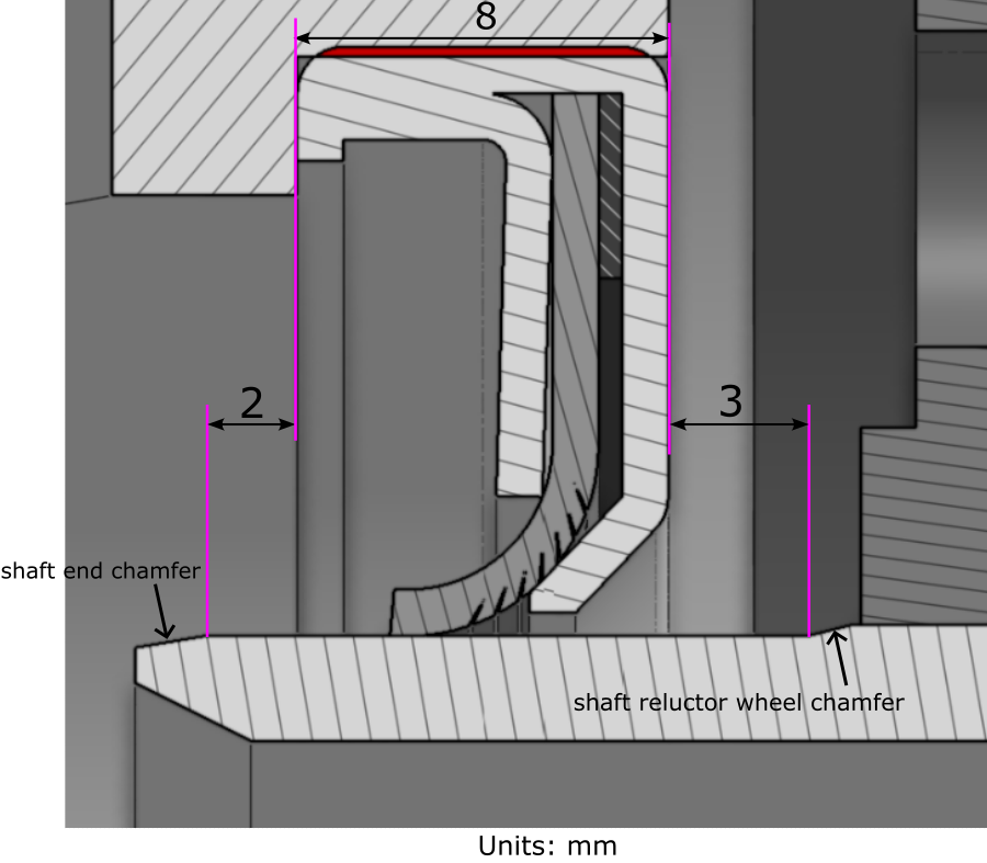

As I have already written, I am in negotiations with a seal manufacturer in Germany. He sent me an interesting draft. I have pointed out that a Speedi Sleeve may be used. He also takes into account the slightly larger diameter and the limited length.
He also has reservations about using Loctite because of the poor heat dissipation. I did some googling and came across this glue.

: Very interesting design! It looks like the lip is CNC machined and definitely not formed using a mandrel. Some questions and remarks in random order (I may be dead wrong of course):
1) Does GFD have experience using this design (and @10k RPM with coolant) or is it highly experimental?
2) The left "primary" lip is too close to the shaft end (at least for my LDU which I measured - see my drawing below). Now it would contact the "shaft end chamfer" and probably leak! It must be moved at least 1mm away from the shaft end (relative to the current position in the drawing) in order to have at least 1mm of clearance from that "shaft end chamfer". Which is maybe still not conservative enough. Simultaneously, the excluder lip is allowed to be positioned a maximum roughly 1mm extra away from the shaft end (relative again), so that it has a (reduced) 2mm clearance from the "shaft reluctor wheel chamfer". Why 2mm and not also 1mm? Because my drawing shows the motor in the "cold" configuration. Once heated up, differential thermal expansion can move the shaft roughly 0.5mm deeper into the manifold because the rotor can get hotter than the stator+housing, and also lateral accellerations can "bounce" the rotor roughly 0.5 to 1mm in axial direction (because the rotor is kept in place by a spring and floating bearing on the manifold side), which reduces the clearance to maybe only 0.5 to 1mm. This design is very tight! Seems like Tesla had very little available space ("bauraum" in german)
2) The garter spring seems to be able to "slip off" the lip easily, so maybe add some more material to "cradle" it (keep in place). Especially because I think that the spring pressure must be relatively small (compared to the classic elastomer lips) because too high pressure results in too much frictional forces and thus heat development.
3) Does the steel ring have an interference fit? It shows 55mm nominal only and no tolerance.
4) The excluder lip should ideally maybe have nearly zero pressure on the shaft, maybe even a very tiny gap like the SKF FKM seals, so maybe reduce the interference.
5) What price range?
6) Maybe increase the primary lip contact area (width) to 2mm in order to reduce contact pressure. This is also a benefit from some formed lips (like the Ceimin lips). Just an observation based on Stuttgart PhD work on PTFE seals.

I received the final proposal from XXX. It should fit the original shaft and also work with the speedy sleeve. I also have prices, depend very much on the quantity purchased, but will be at least €80. Do you think there are enough buyers who are willing to do this?

If a goal is to be a provider of a tested-and-guaranteed LDU "reseal kit" or service, then -- maybe -- a USD$10k investment is warranted. For DIY-ers (ie not a repair service or a "reseal kit" reseller), having a seal with some positive track record is sufficient. To achieve that point, some pioneers may have to suffer a few arrows in their backs (if you're not familiar with my tortured version of the aphorism, read here).
DIY-ers will gladly play pioneer, if the alternatives are sufficiently awful . . . or untrustworthy (see below).
Installation will be uncomplicated without the excluder, because the direction of shaft install naturally deflects the lip in the normal direction.
The Ceimin seal might be fine. As more people install them and rack up kms/miles, some people may report success and newer DIY-ers might be more comfortable using them.

I'm not certain that shaft wear is really an issue. Depending on the compliance of the PTFE material (or its substrate), either the natural seal characteristics, or the garter spring-aided design, may adequately compensate for, say, 0.3mm shaft wear (or sleeve wear).
Put another way, if we assume re-sleeving at every seal change, do we care if the sleeve is worn through completely by the time the seal is due to be replaced?
By definition, the excluder lip is not a liquid seal: it excludes particulates and is not expected to seal against liquid, which means the seal's main lip has at least incidental if not total wetting.howardc64 wrote: ↑Tue Feb 07, 2023 10:41 pm #3 is how to reduce leakage. I conclude micro structure pumping aid is unavailable (and maybe ineffective after coolant silicate crystallization clogging the structures) so I think the only solution is # of lips. @asavage distrust this kind of design. However, SKF, Parker, Saint-Gobain all show simple 2x media lip + excluder lip PTFE rotary seal designs in their design catalog . . .
In a three-lip design, the "last" lip is deprived of that wetting, so it has to operate at ~10k RPM with only whatever material characteristics it has to prevent it from accelerated wear, and that's what I mistrust: a seal that is both supposed to prevent liquid from getting past it, and also operates dry for some very significant portion of its lifecycle.
There's a reason why you can't run a typical water pump (a type that uses a shaft seal) dry: that quickly destroys the seal. And that's what I see in the triple-lip LDU seal: a seal that runs dry (or, perhaps, with some installation "lubricant") until the main/middle lip leaks, and then that last lip is expected to be a backstop seal? Yeah, I mistrust it.

In my humble any LDU seal fix needs to incorporate seal leakage mitigation - so when it leaks again the coolant is safely diverted away from the electronics into a catch can or back into the cooling system.

I agree 100% with SuperV8. I would definitely drill a drain hole, on the one hand to notice a leak and on the other hand to prevent major damage. One of my motors also had water ingress on the inverter side, clearly due to corrosion on the data connector.
