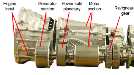

Wrote code last night to spin up MG1 to 1000 RPM and hold it there when MG2 <1000 RPM. So at a stop sign, MG1 spins up and keeps oil pressure up. Once underway, MG1 spools down and freewheels again. Consumes about 3amps holding 1000 RPM.
No oil pump needed. Even works in reverse, but only up to a point. If I back up too quickly, MG2 reverse spin overcomes MG1 and oil flow stops.
During testing, MG1 spun up pretty high by itself a few times and the car never lurched forward. I was expecting it to from internal frictions at least, but no forward movement at all.
Next: put negative torque on MG1 if RPM exceeds 6K or 8K to keep it from getting above 10K.

awesome, but MG1 is spinning opposite direction than MG2 correct? (it's the magic of the planetary gear design that converts that motion to "forward" motion?)ggeter wrote: ↑Thu Apr 28, 2022 5:07 pm Wrote code last night to spin up MG1 to 1000 RPM and hold it there when MG2 <1000 RPM. So at a stop sign, MG1 spins up and keeps oil pressure up. Once underway, MG1 spools down and freewheels again. Consumes about 3amps holding 1000 RPM.

No -- MG1 spins same direction as MG2 relative to the centerline of the transmission. In Damien's code, he spins it opposite because the code assumes the input is locked. In my code, I apply torque in the "forward" direction to get the mechanical oil pump to work. MG1 in "reverse" (per Damien's code) does not pump oil. When cruising, I'm assuming MG1 continues to spin in the same direction as MG2, but at the very least, the oil pump is still pressurizing, so I'm doing something rightGregski wrote: ↑Thu Apr 28, 2022 5:09 pmawesome, but MG1 is spinning opposite direction than MG2 correct? (it's the magic of the planetary gear design that converts that motion to "forward" motion?)ggeter wrote: ↑Thu Apr 28, 2022 5:07 pm Wrote code last night to spin up MG1 to 1000 RPM and hold it there when MG2 <1000 RPM. So at a stop sign, MG1 spins up and keeps oil pressure up. Once underway, MG1 spools down and freewheels again. Consumes about 3amps holding 1000 RPM.

I watched MG1 rotation speed live yesterday while driving. In my setup, I spin it to 1000 RPM until MG2 hits 1000 RPM then I set torque to 0 on MG1. I expected MG1 to keep turning, even speed up as it was being dragged by MG2 and mechanical oil pump. But, MG1 actually stopped rotating altogether even as I accelerated past 40 mph.Gregski wrote: ↑Thu Apr 28, 2022 5:09 pmawesome, but MG1 is spinning opposite direction than MG2 correct? (it's the magic of the planetary gear design that converts that motion to "forward" motion?)ggeter wrote: ↑Thu Apr 28, 2022 5:07 pm Wrote code last night to spin up MG1 to 1000 RPM and hold it there when MG2 <1000 RPM. So at a stop sign, MG1 spins up and keeps oil pressure up. Once underway, MG1 spools down and freewheels again. Consumes about 3amps holding 1000 RPM.
I thought this was odd.
