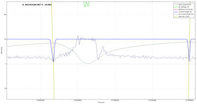

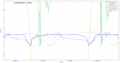

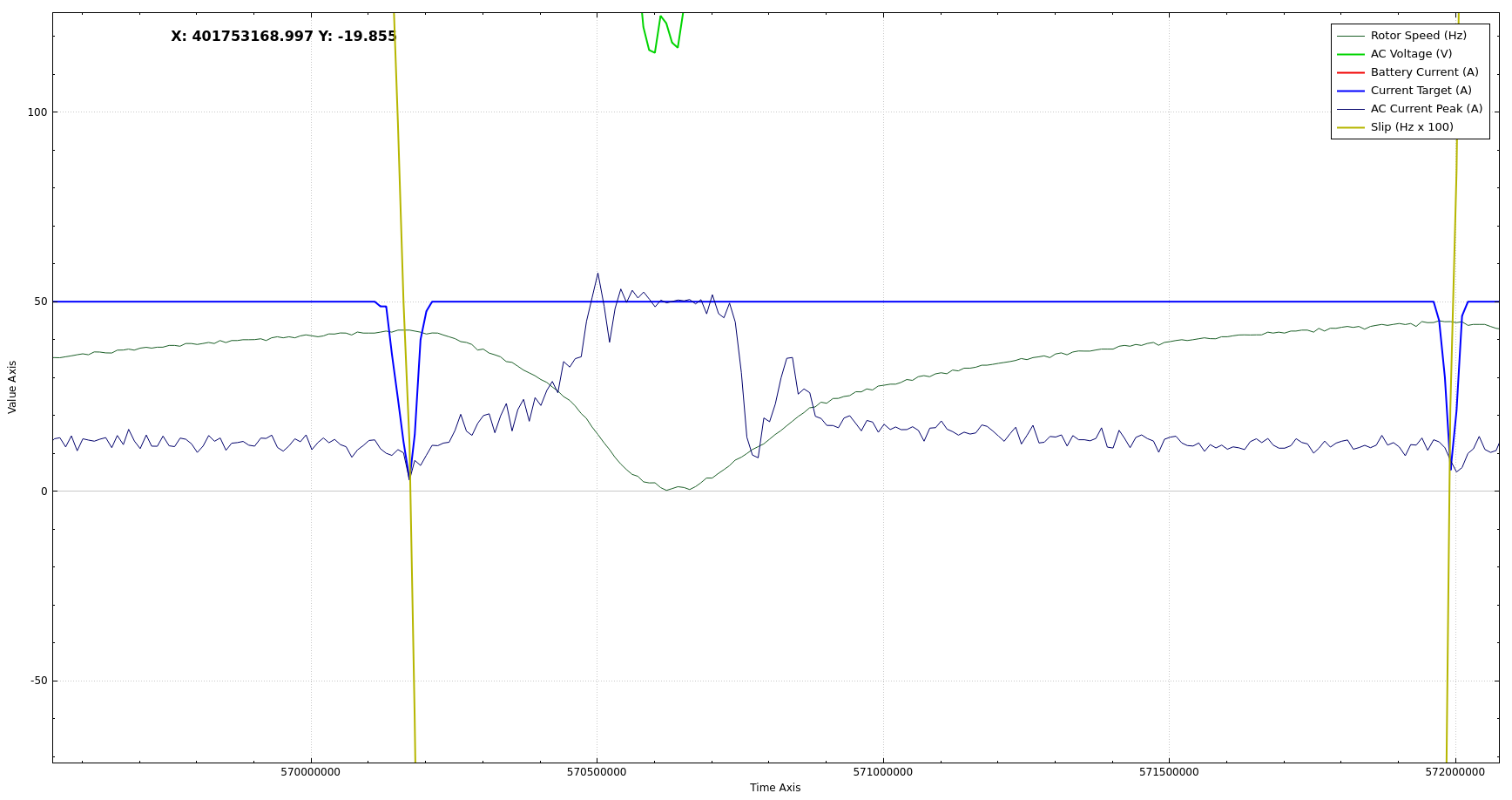

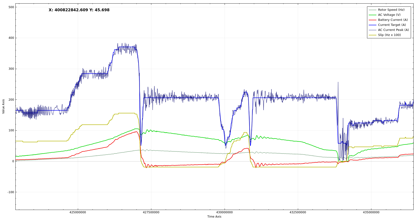

I found myself thinking about regen again today, and I think I have an idea how to prevent the unpleasant current spikes. It's my suspicion that all along I've been trying to set the current too low. Looking at this chart, we can see that as we switch into regen and set slip negative, we get a rising current. It rises about 50% above my target current, and the algorithm panics and slashes the voltage. Doing so creates a huge current spike because the voltage suddenly drops way below the back EMF. It's clear what is happening, but I still can't quite get my head around why.
With the V/Hz method this isn't a problem. We set a voltage, and simply allow current to fall wherever it falls.
Anyway, it occurred to me that perhaps I'd have a better chance of controlling current if I set the target current much higher. If we always try to push the current up higher than it naturally wants to be, he positive voltage-current relationship should be restored. In the above chart, the current set point was only 50A, whereas looking at V/Hz control, the current is generally in excess of 200A even for light regen.

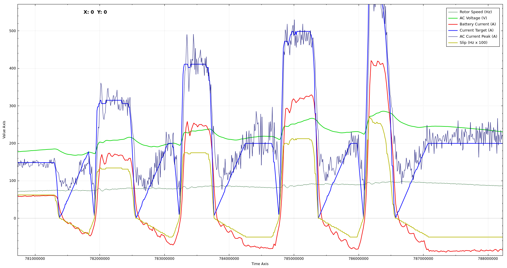

I did a quick test on the bench, setting a low regen current level (30A)
And then with a higher regen current level (50A)
And then with 50A current and a slightly reduced slip
I will try this in the car at some point and see if pushing a higher regen current has the same improvement there.

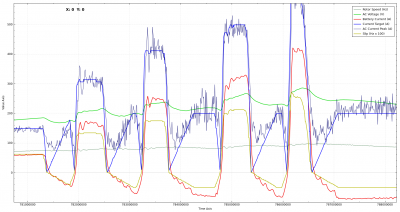

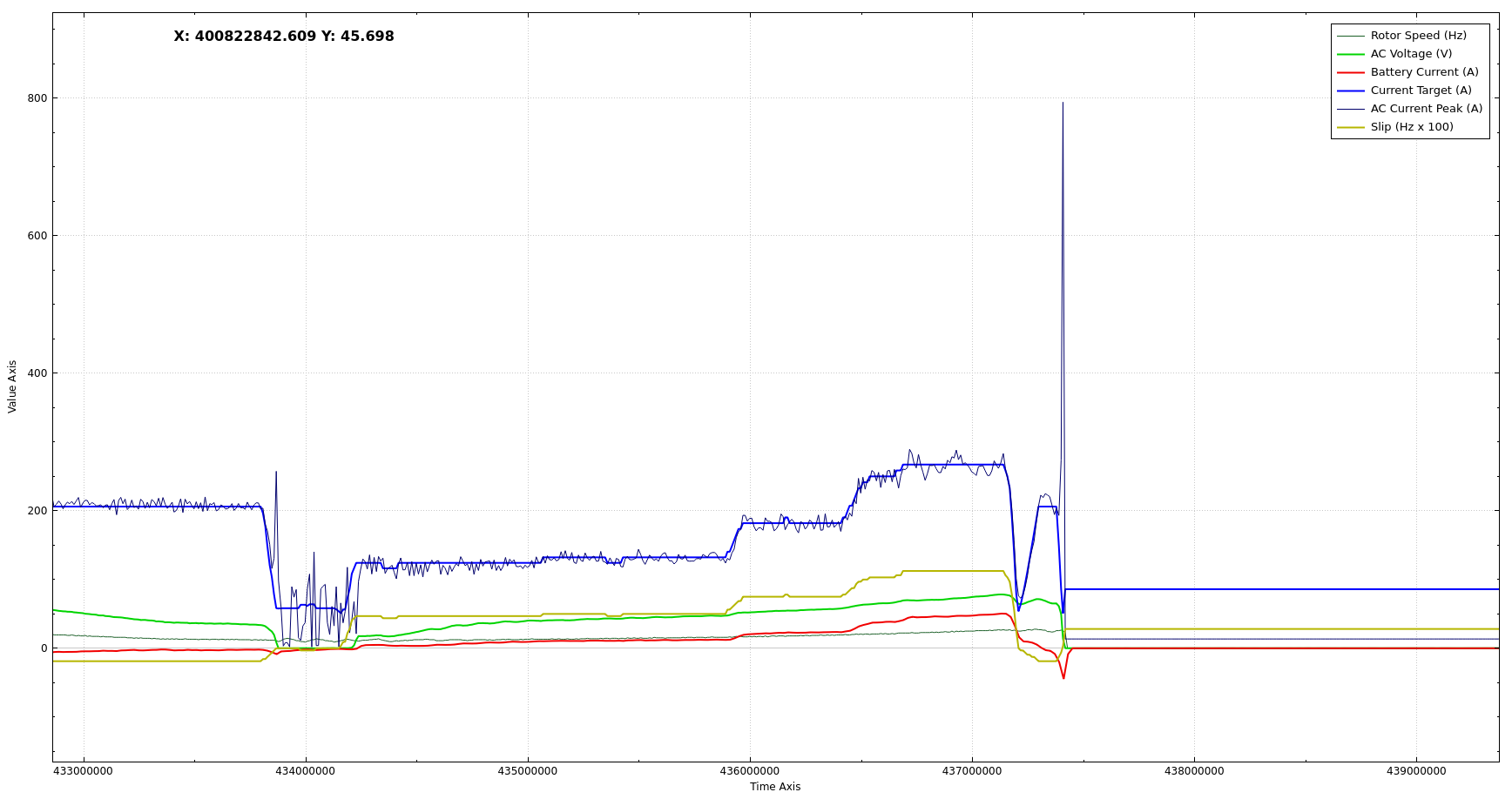

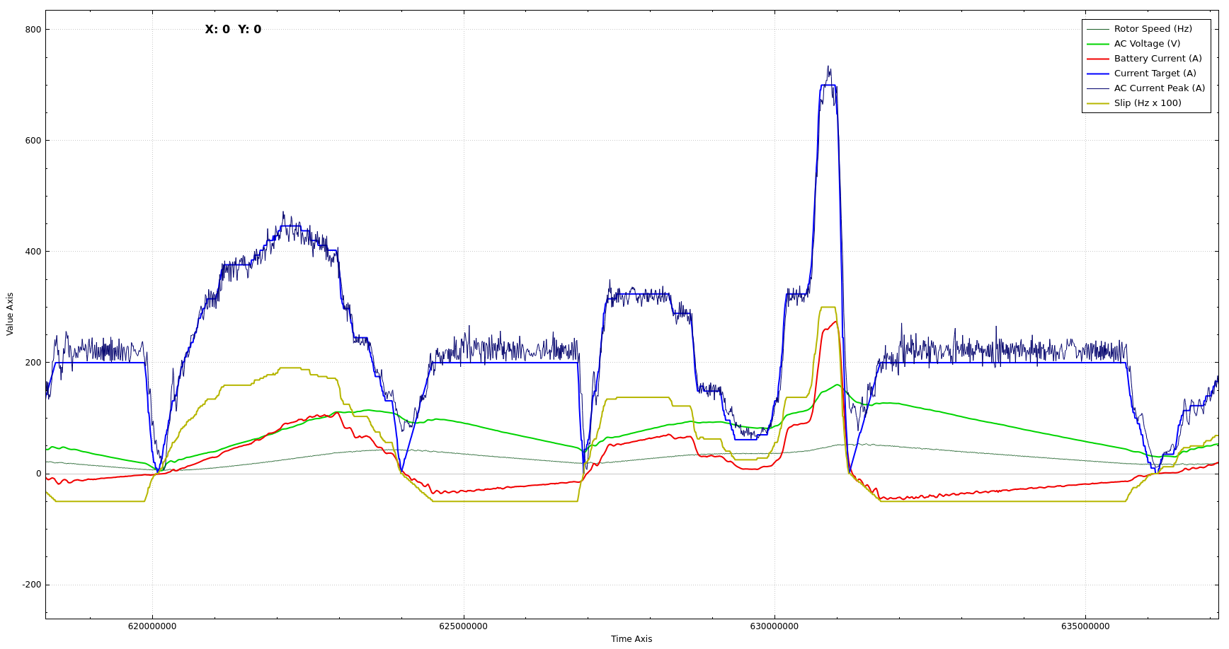

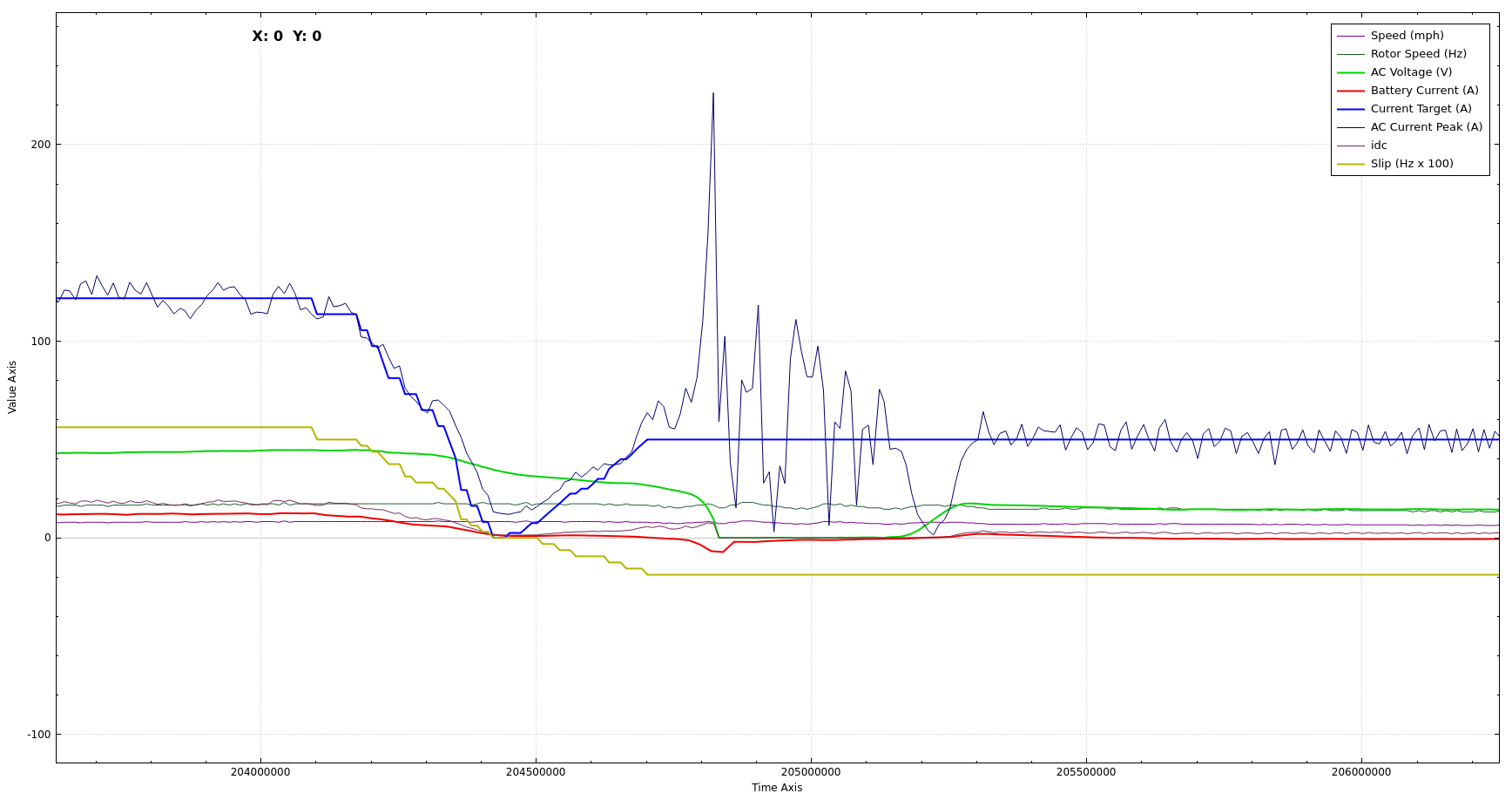

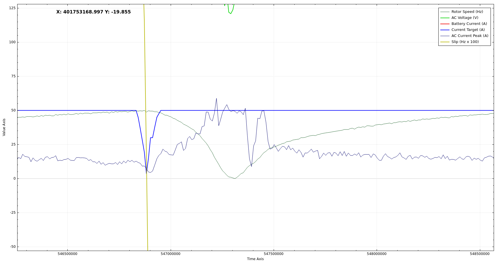

I did some more regen testing today, this time using higher current targets and lower slip as proposed. This does lead to a substantial improvement in stability! Regen seems to work and remains stable.
However, one problem remains. When reducing regen (ie moving from regen to zero or forward torque), a huge current spike occurs. This seems to be because we try to reduce the current, current doesn't reduce in a timely manner, and the algorithm reduces voltage to zero, causing the huge current spike (this triggered my 900A ocurlim).
It's likely that current changes lag behind the slip changes, so I will test again with reduced gain on the current PID.
EDIT: Edit: Looking more closely at the chart, it seems that I attempted to go from 100% regen to 0% regen in 30ms. This is probably must too fast to expect the current to decay. I'll look at adding some slew rate limiting, either to the throttle, the current target, or voltage output.
The test above was run with a 50A minimum (ie magnetizing) current. I'd prefer not to have to do this though as it poses a risk to anyone turning off the ignition while that 50A current is active.

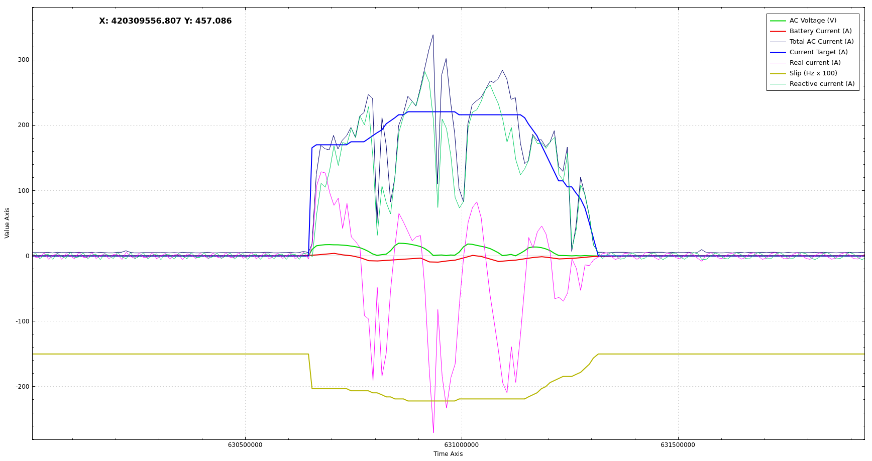

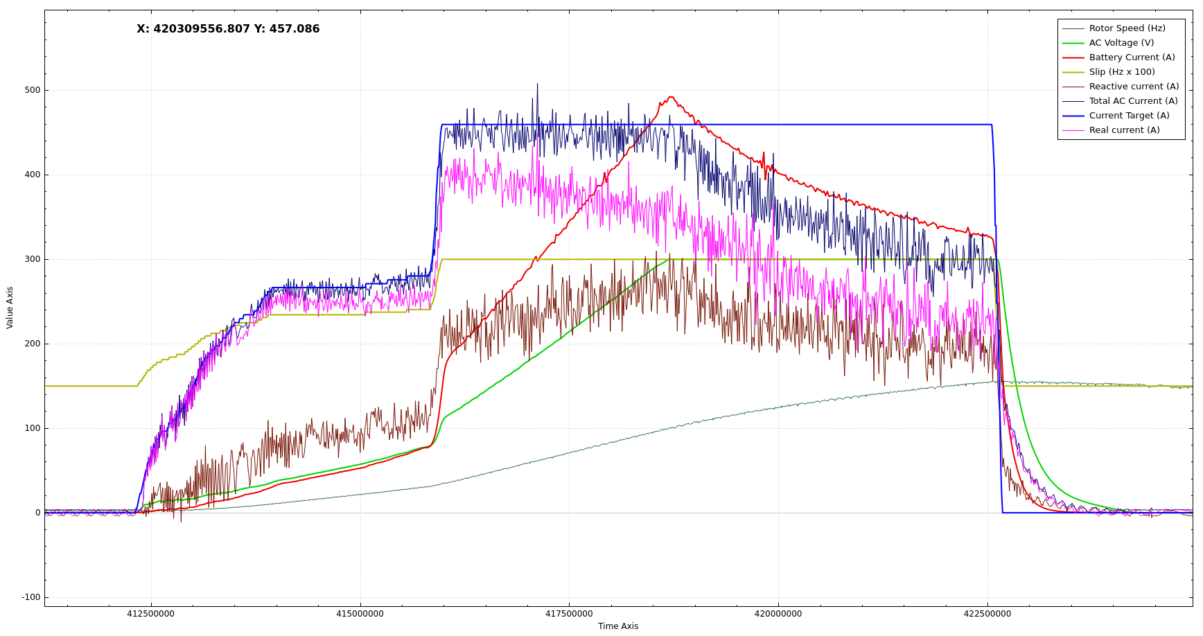

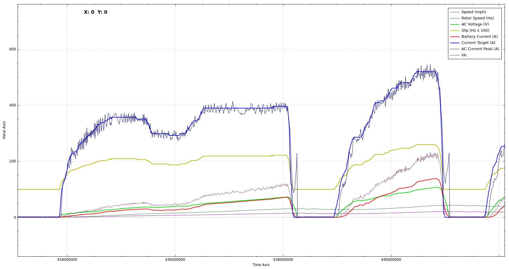

A while back, I experimented with some code to graph the in-phase (real) and out-of-phase (reactive) current. Looking again at that data I am convinced it is useful for a couple of reasons.
Firstly, looking at the following 0-60 graph it can clearly be seen that as speed increases, the ratio between real and reactive current changes, despite the slip remaining consistent. There are two possible explanation for this. Either the measurement method is incorrect and the measurement lags as things speed up, or at higher speeds, more slip is actually needed to maintain the same torque conditions. My suspicion is the latter, but I will look at different ways to measure real and reactive current to confirm this. If this is the case, the algorithm may be able to improve performance by scaling (or even automatically adjusting) slip with speed.
Secondly, I have been troubled for weeks with the problem of how to handle the situation where current is above target, but reducing voltage actually *increases* current. This only ever happens during regen, but it's been a pain to detect and compensate. Looking at the situation from a real / reactive perspective gives a nice new view on this. When current rises unexpectedly, it's not voltage from the inverter causing it, and as a consequence, it's also not measured as real positive current, so this may give more opportunity to compensate correctly. This graph isn't nearly as tidy as the first, things go bad fast during reen.
I will integrate this logging into my latest firmware and run it for a few long drives to collect plenty of data while i think about how to use it.
Finally, to speculate... there may be two things I can do here:
1) Adjust slip at different speeds to see if this evens out the ratio. Frankly I'm not convinced this is necessary, but it's a useful tool for squeezing out those last few % of torque / efficiency.
2) Find a way to scale voltage during regen using the separate inphase / reactive currents. In particular, don't reduce voltage when it's obvious voltage isn't what's creating the current (because voltage is way out of phase with the current). In this case we may need to reduce slip, increase voltage, or possibly just hold voltage steady and let the situation settle on its own.
I'll update once I have more data and more of a clue :)

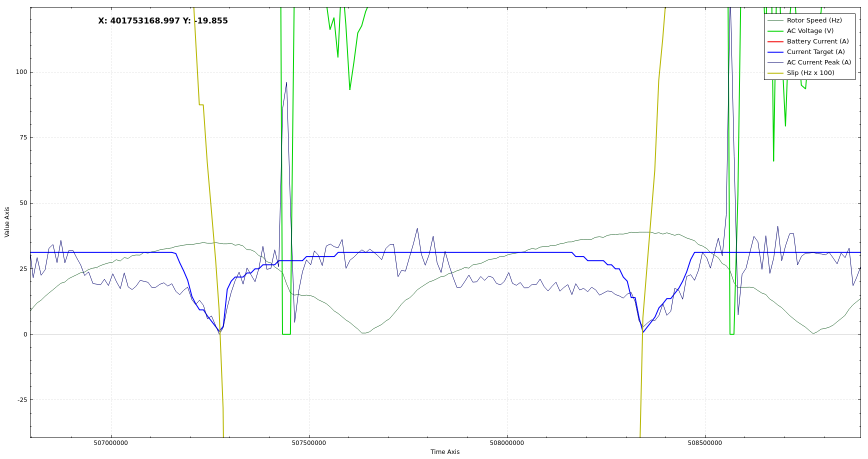

Big success. I now have stable regen. I didn't achieve this by any particularly clever code, just by limiting various slew rates.
Specifically:
1) I introduced separate gains for positive current correction vs negative current correction. This allows me to tune the negative gain to prevent hitting 0v during the transition out of regen, but keep an aggressive positive slew, which is harmless.
2) I reduced regenrampstr to 2. It therefore takes about 500ms to go from zero torque to full regen. This feels slow.
3) I reduced throtramp to 10. Therefore takes 200ms to go from full regen to full throttle, this doesn't feel slow.
I suspect with more tuning these could be brought in a bit tighter, depending on how much regen is actually required. I've been testing with 200A AC current and 0.5Hz of slip, which gives up to 100A into the battery at higher speeds.
With these settings I can get pretty consistent regen down to 2Hz. This is basically good enough for single pedal driving. I didn't try setting this any lower, but I see no reason it shouldn't work down to less than 1Hz.
Plenty more tweaking to do, but it certainly demonstrates that this approach can do regen if some compromises are made on the extreme throttle slew rates that I've been enjoying previously.
Looking at this next chart, it seems that these changes keep the current above 100A during rapid transitions in and out of regen.
It's my strong suspicion that somewhere around 100A is the correct magnetizing current for this motor, and that by holding the current above 100A at all times, we could be more aggressive with the gains / slew rates. However, in order to do this, I would need to make sure this only happens when the vehicle is in motion otherwise inevitably inverters will get blown up by being switches off while stationary and in drive.
Sorry for all the charts; I know it's boring but it's the best way I have to demonstrate progress unless anyone wants to come and sit in my car :D

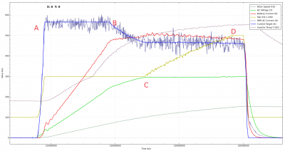

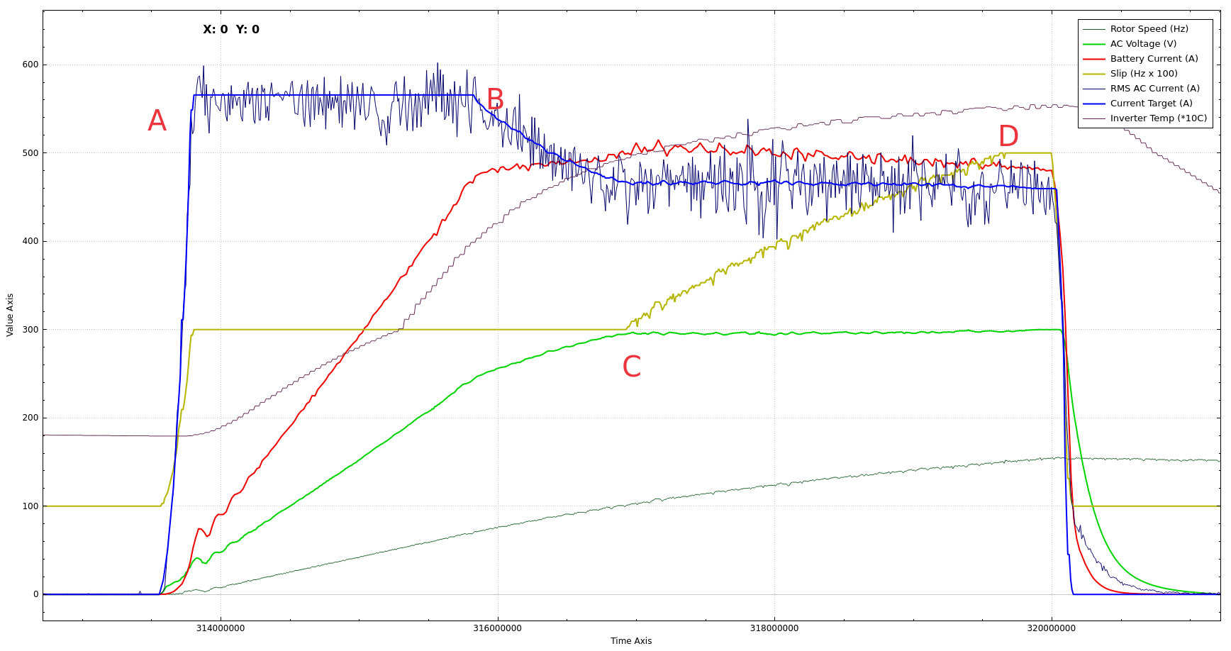

I have made the two changes above to the firmware. Removal of regen makes me more comfortable releasing this and encouraging others to try it, and the new field weakening configuration works well. A little more configuration is required, but the result is instant throttle response in the field weakening region as hoped.

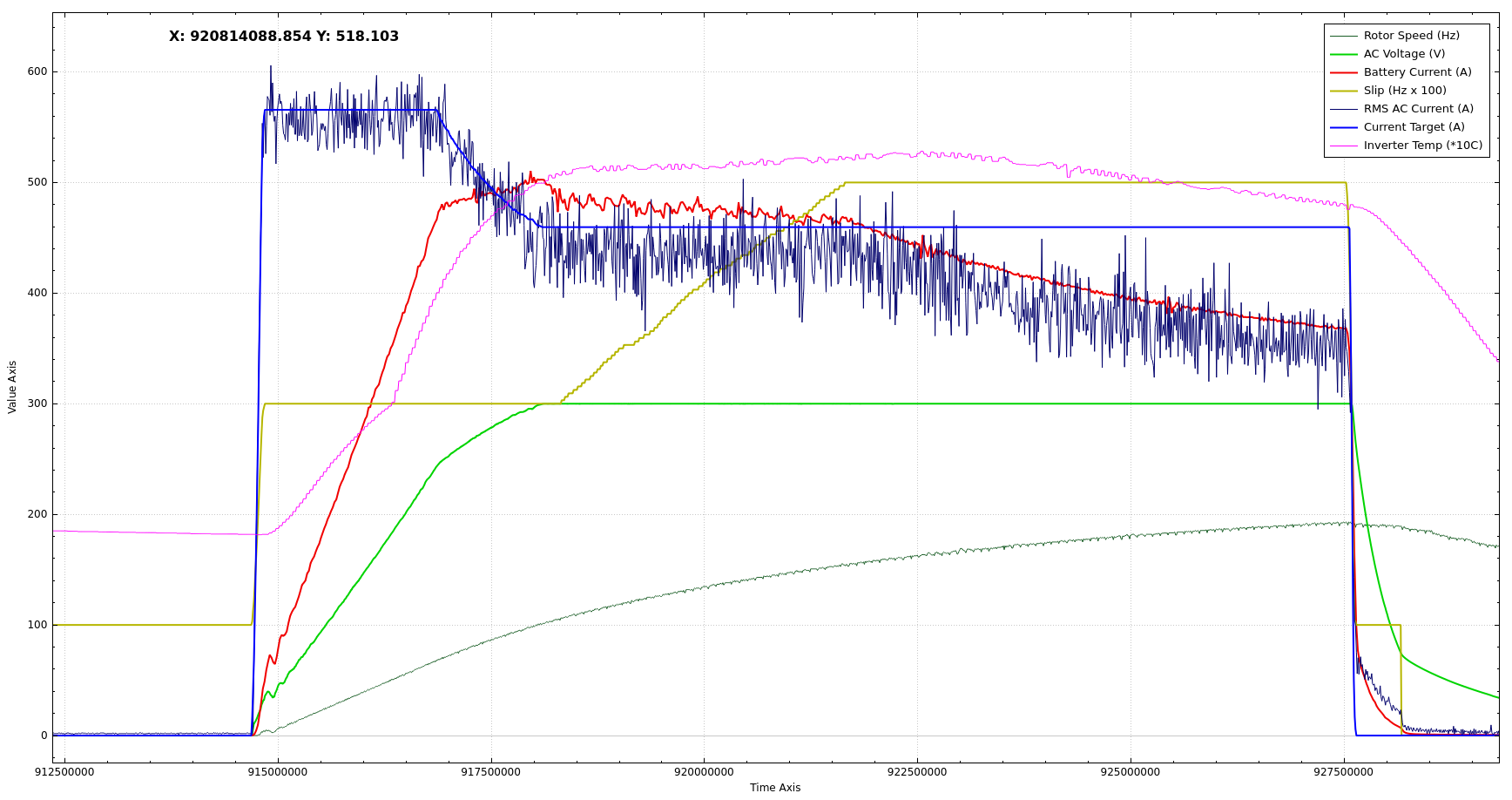

Here's a chart of testing a full throttle test run today. I've annotated it to explain a little about how this firmware is configured.
A: From a stationary start, when throttle goes to 100% the target current and measured current rise almost instantly to 560A RMS (configured by throtcur). Slip is set to slipmax (in this case 3.0Hz).
B: As speed increases DC current nears its configured limit of 500A (idcmax), the AC target current is gradually reduced in order to keep DC current within the limit. This is all calaulcted dynamically. Measured AC current closely follows the target.
C: At 200Hz AC voltage reaches full battery voltage (300V). This is not something that has to be configured, this limit is reached naturally.
C: At the same time, slip begins to increase to allow us to maintain the same current with no more voltage available. The frequency where this happens must be manually configured to the same frequency where voltage is observed to reach its maximum (fweakmin). For my configuration this is 200Hz. This point was previously known as fweak.
D: Slip frequency will rise to eventually reach fslipweak at a manually set frequency (fweakmax). In my case, this is 5.0Hz slip at 300Hz frequency.
Full release and documentation of this firmware will follow shortly.
