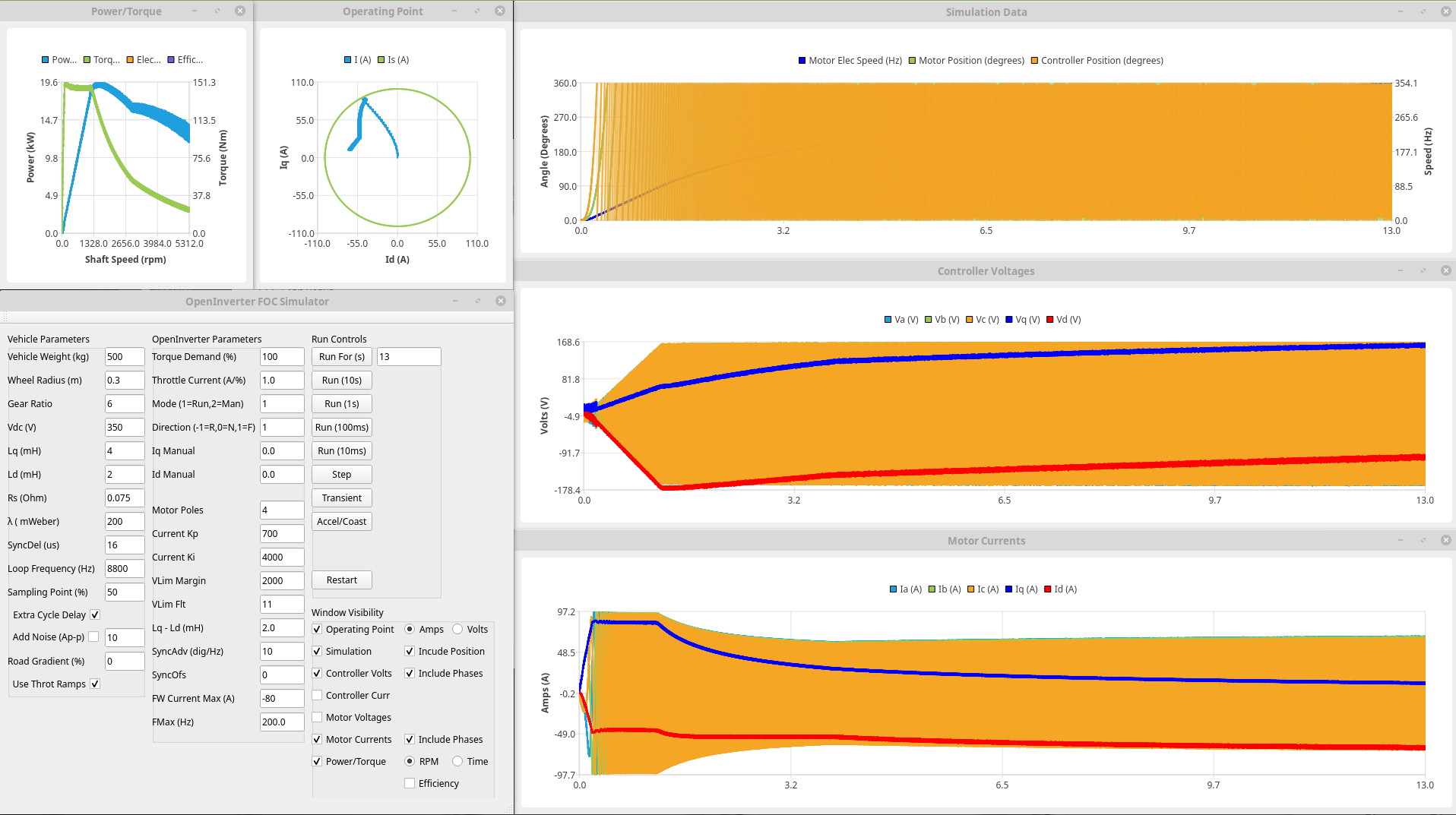

Well I have followed the wikipedia pages as close as I can think of and have things happening
Waveforms are not the same as in wikipedia, I have attempted to make all the settable parameters exactly the same:

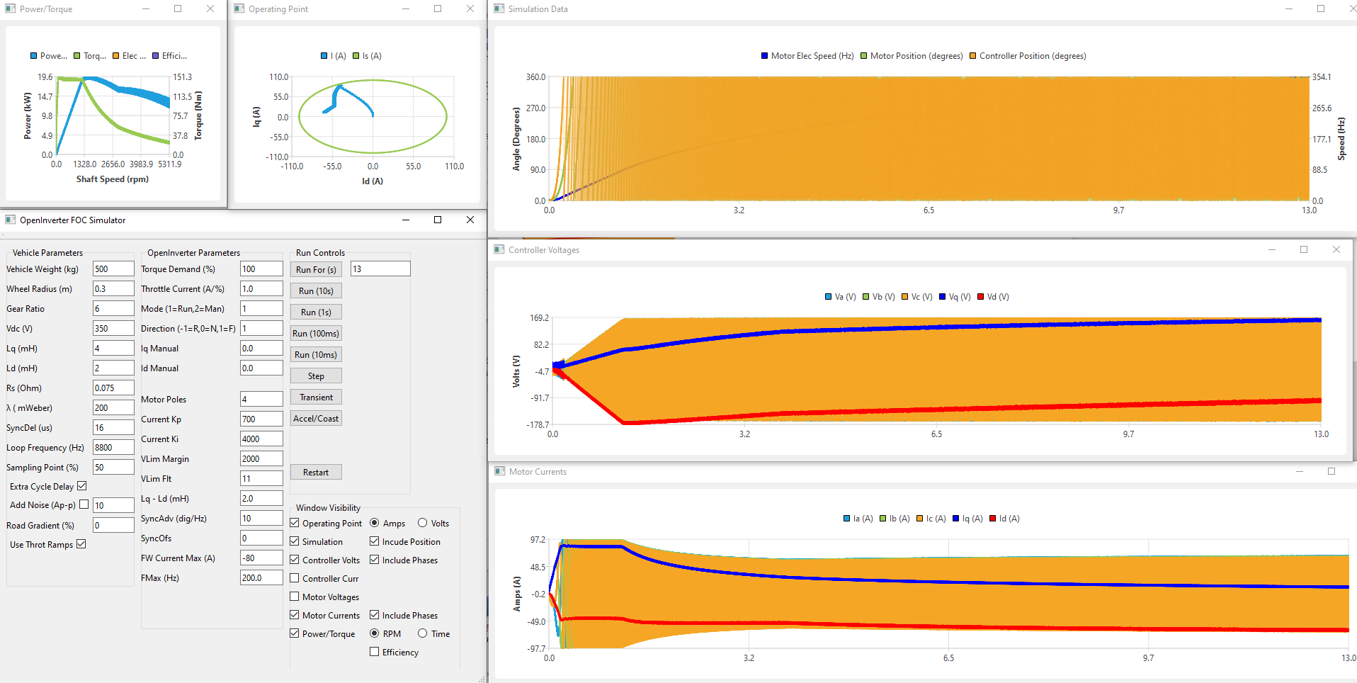

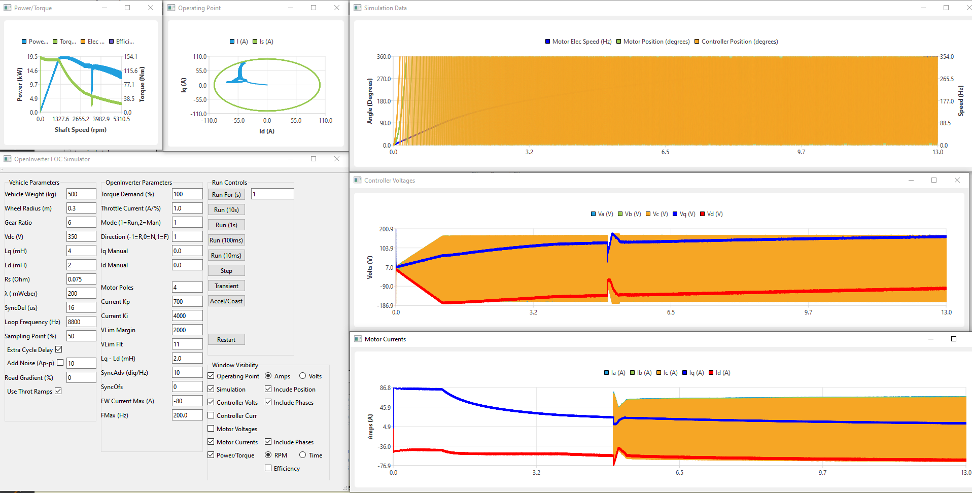

Looks like you're getting there
There are a couple of things that don't quite look right though. In particular the discontinuity you have at around 5sec and the sudden appearance of the phase currents in the Motor Currents graph at that point. The trajectory on the Operating Point graph also looks wrong.
This is what I get with a clean github checkout of the simulator and the last OpenInverter FOC specific build (777271e - Nov 27, 2022) which is what I'd expect to see with those settings: Wondering whether some of the recent sin changes could be having an impact? I'll update my version of the OpenInverter firmware to include them and give it another try.
Edit - Nope, just updated to the latest (git tag 6ff84fc) and I get exactly the same result. Only thought - was your plot from a single simulator run or did you run it to 5sec and then change settings/parameters before running again (but without hitting Restart first)?

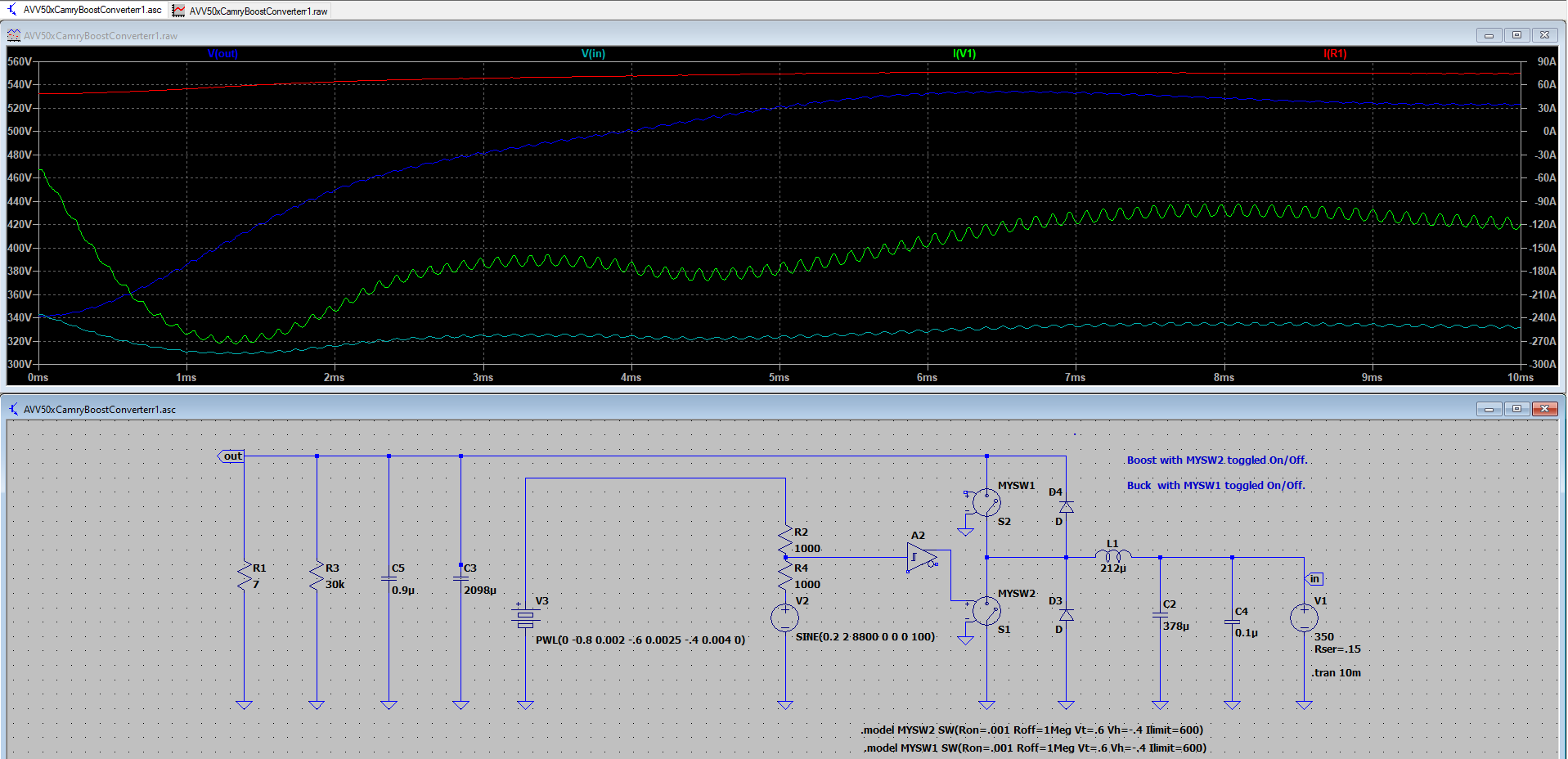

I have made an LTspice XVII model, and have put one graph on the forum:
Operation is more complicated than I thought it would be.
I have included the file as well below.
So far my model only has equal mark / space ratio, but battery voltage and parameter values can be changed.
If anybody wants to, we can explore what this model can do for us with boost.
With this nonlinear stuff, sometimes it is better to use simulation models rather than maths I find.
Kind regards
Johnspark.

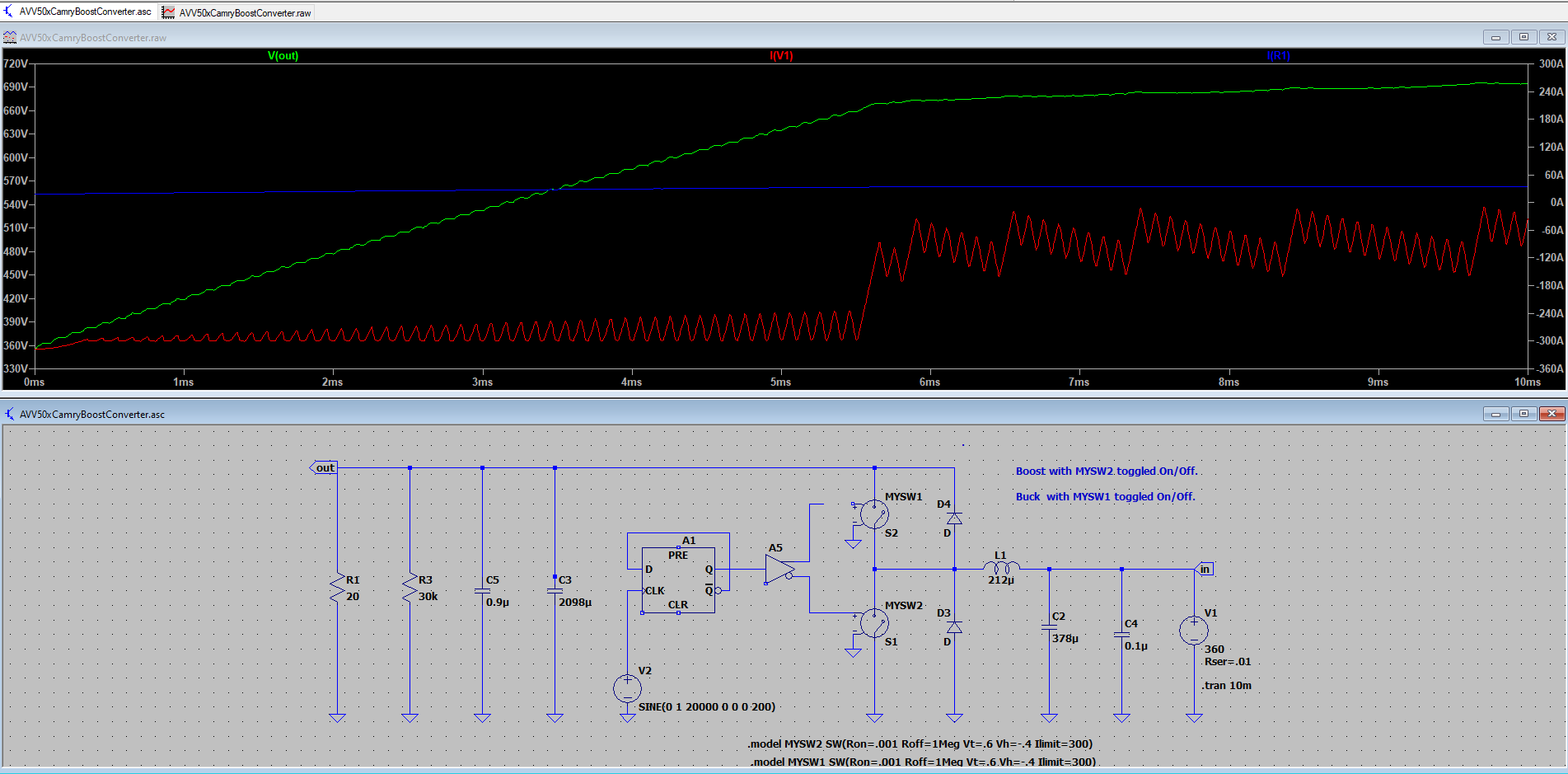

i took your advise Pete and got rid of the D flip flop. But found I could replace it and the buffer with a schmitt buffer. Now I am getting sensible results. For a 250V battery and approx 500V output, current from battery is approx double that going to load resistor.
Also that saw tooth waveform superimposed on the carrier is gone

This model now has adjustable mark/space ratio via the adjustable battery.
Very happy with this model, it can be adjusted, and gives realistic values
For this example, I have 3 different mark space ratios for initial conditions, to reduce the large inrush current (slows down speed of getting HV).
