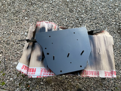

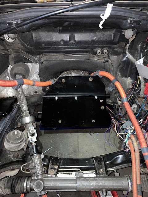

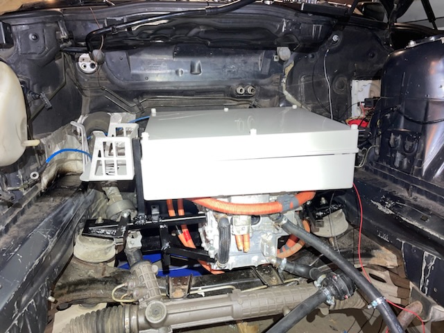

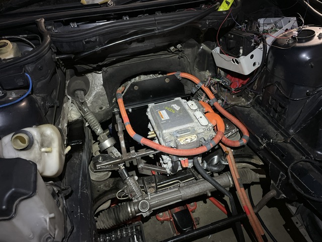

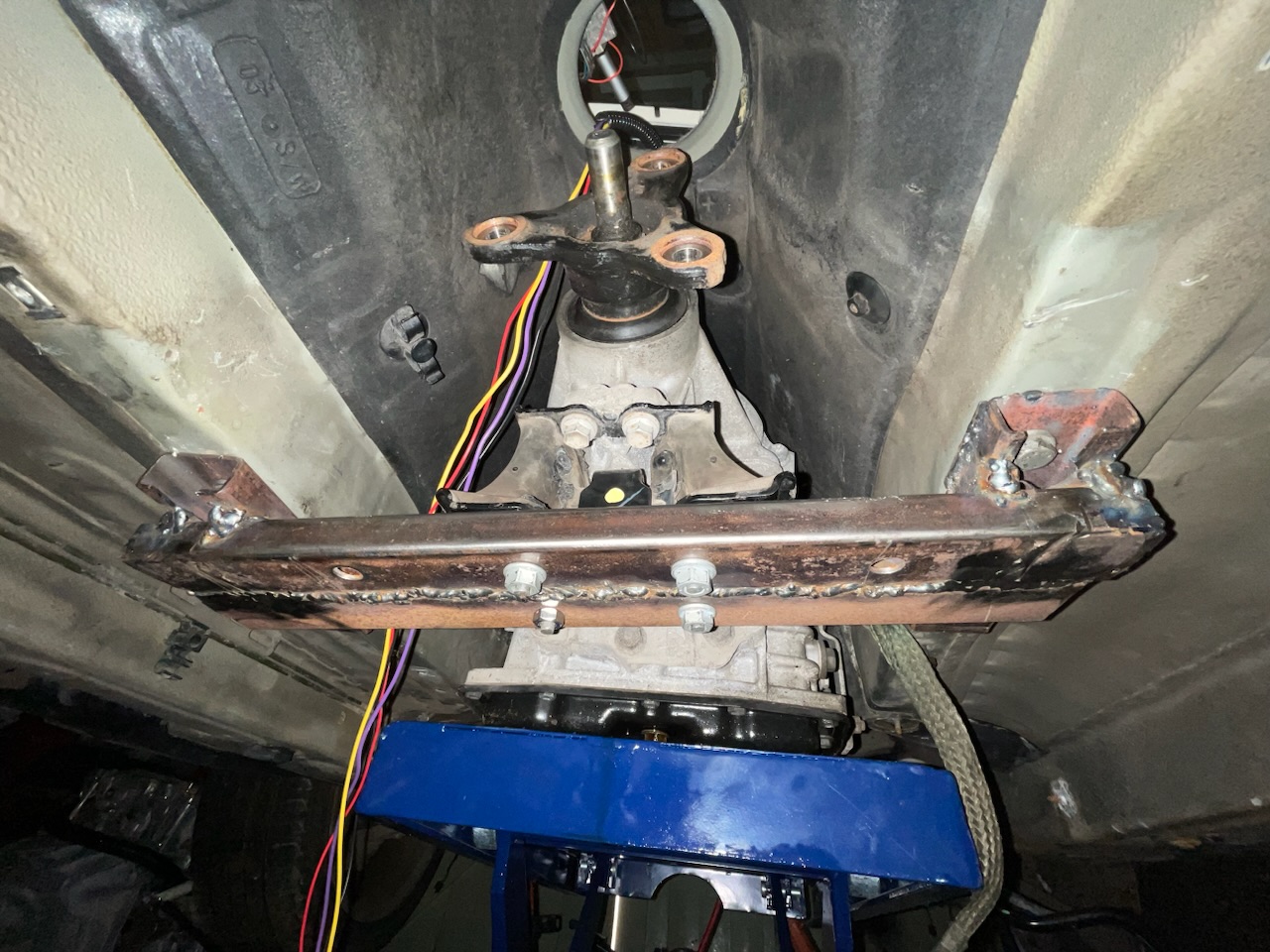

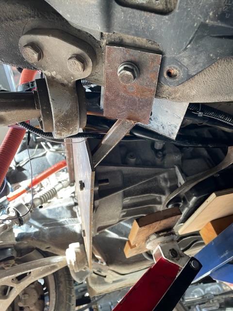

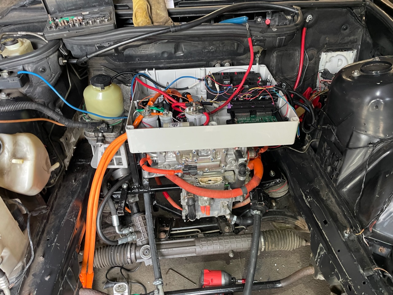

Been a while so time for an update.
‘Phase 1’ of the car is going to be pretty simple, IS300h gearbox & inverter, 3.3kW Outlander OBC / DCDC and a 8.8kWh VW GTE battery pack with CHADEMO and SIMP or EVS BMS. Later on I plan to add at least 11kW 3 phase charging, 50-60kWh liquid cooled battery and CCS. (Will probably add a second VW GTE pack in the mean time to get 50ish mi range.)
So far I have had the 300h Gearbox in, mounted and test driven, all seemed to work but I wasn’t happy with the mounting setup so I’ve re done it:
Gearbox back in, this time I have mounted it at the back using the original bmw mounting holes, and at the front using the sump guard / skid plate mounts. One thing I perhaps should have added was a bushing between the gearbox and sump guard mounts.
All painted up with under seal spray and onto inverter mounting:
Have also added a stand for the power steering pump (usual zafira pump with tubes made at pirtek) on the left, bought a ready made stand to save a bit of time. (Search for Astra power steering stand)
Thing on the top is the junction box, has my HV contractors, ZombieVerter and 12v relay / fuse box inside

Re: BMW E46 Touring (IS300h + long range)

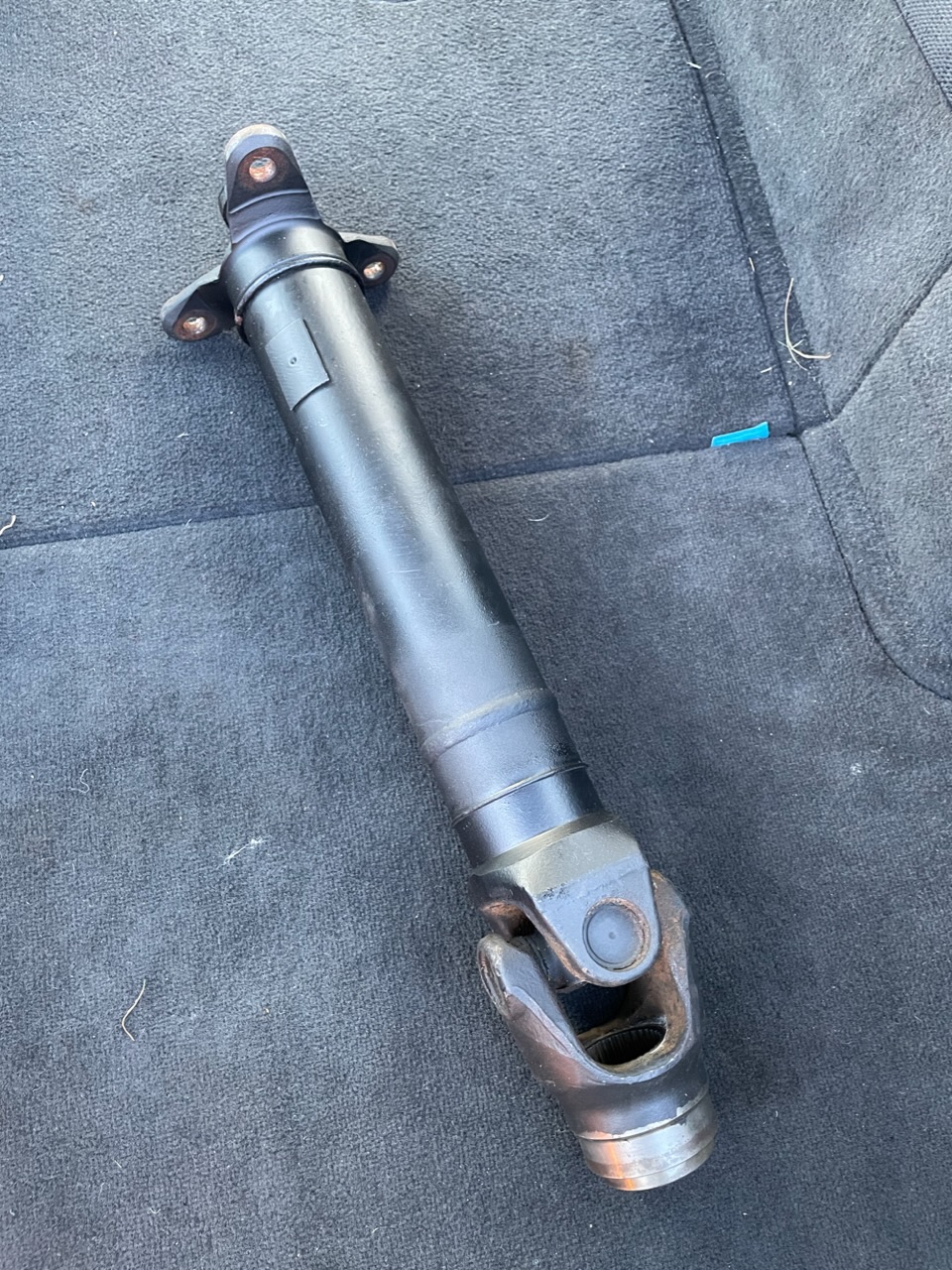

I mounted the gearbox in place, then measured the length from the Lexus gearbox end, to the CV joint in the driveshaft, then went to a local propshaft company who welded them together and made it the correct length. Costed £72

mfox its that the spline with the 3 bolt flange seems to fit the lexus box. the cv joint then joins on to the rest of the bmw driveshaft
No, it did on the GS450h but not on this is300h, the picture is the Lexus gearbox rubber mount (gearbox to driveshaft) to the bmw central propshaft CV joint
Outlander charger now mounted in, with the junction box mounted on top.
Cooling system is: radiator out -> pump -> inverter -> charger -> radiator in
Next step is to re-program the simp bms to add support for the outlander charger, then install the battery pack
Do you have any pics of the rear mount for the gearbox? I'm considering converting my e46 touring. I've already got the is300h gearbox and inverter, so keen to see how it fits.
Yep, its a pretty simple one as the 300h gearbox mounts point straight down.

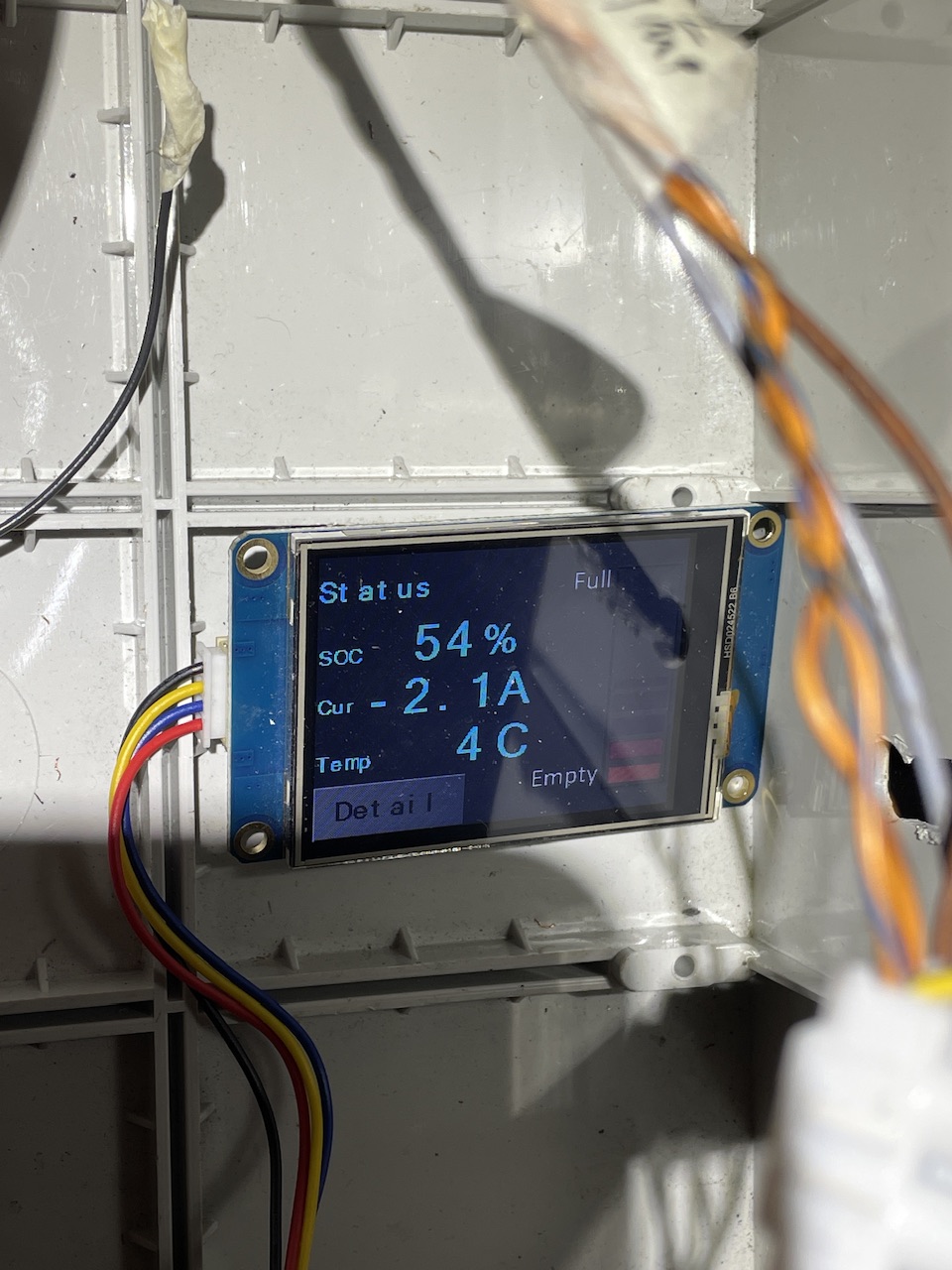

Another update:
With huge thanks to Jamie, I now have the outlander charger working from my SIMP BMS, have hooked it up to my VW GTE 8kwh hybrid battery and charges up fine.
One thing to note if someone else is using the outlander charger is the numbers on the connector itself are the wrong way around (I.e the pin labelled 1 is actually pin 6, the diagram on the wiki page appears correct)
Connected it up temporarily to a type 2 charging socket from a Volvo.
