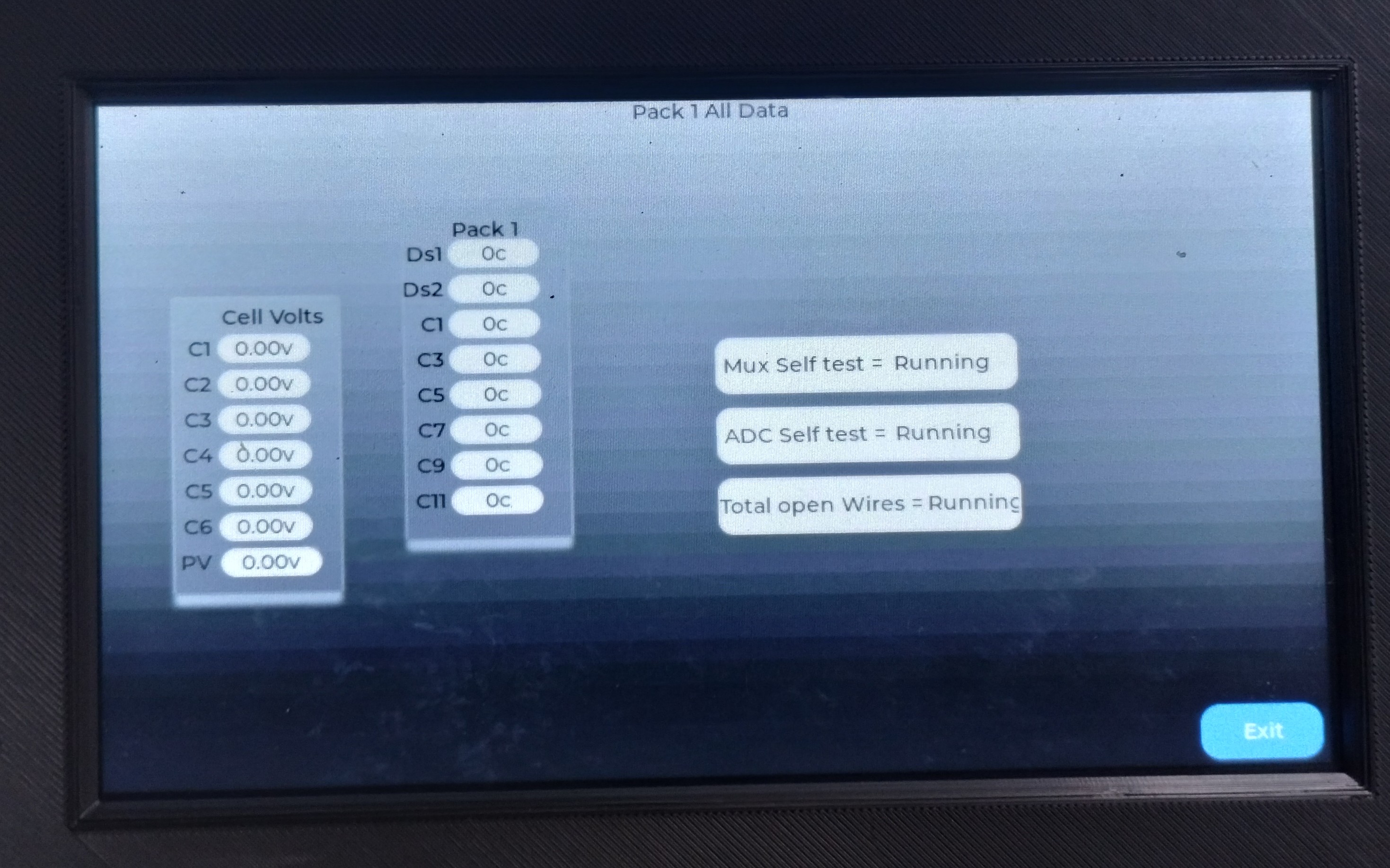

Thanks for this info, I'm sure it will be useful, I hope to include on the software I have written so far in platform io. Here are some pictures of my BMS unit so far, still a working progress.
The cell voltages
Cell temperatures
And the self test of each BMS
And the result
The graphics needs more aligning etc , but it gives u an idea of what I'm building 😁
