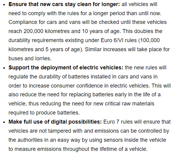

This seems fishy to me!Peter wrote: ↑Tue Feb 28, 2023 5:34 pm https://www.gov.uk/government/news/prop ... the-future
Among the proposals, the consultation will consider whether electric vehicles’ batteries should be tested to improve the safety and reliability of EVs, if additional measures should be introduced to tackle excessively loud engines, and how the DVSA can continue to crack down against MOT and mileage fraud.
Give you a carrot - look we will save you the grand sum of £40! at the expense of monitoring your every move.
I've been looking at Euro 7 future regs - which seems to follow similar trajectory making use of the tech in new cars for monitoring any tampering!
The coming decades will be tough for car enthusiasts.
