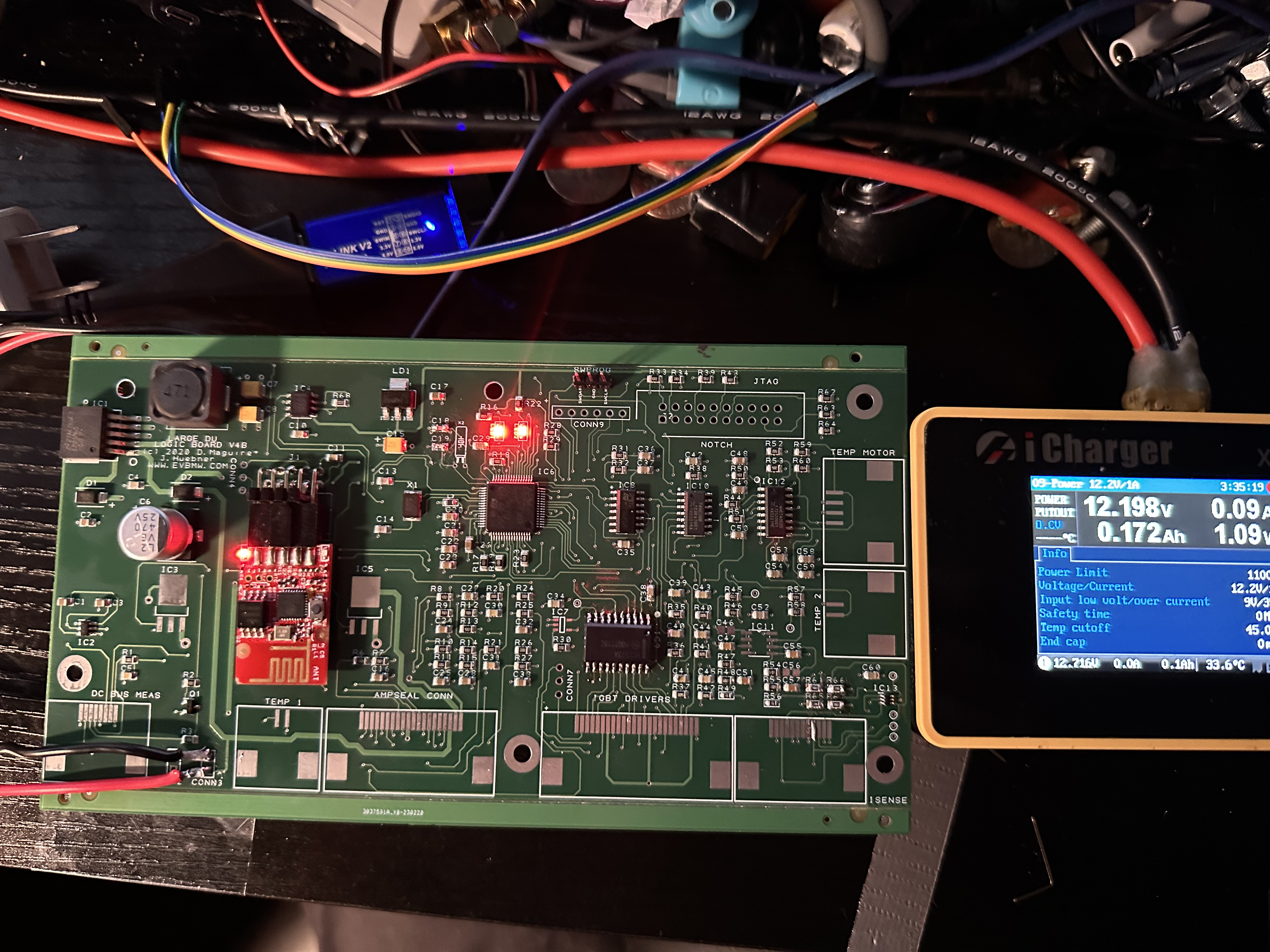

Another test of the dual control board, setting up to charger my Mazdas battery’s in the next month. Hopefully this test is useful. After this I found the limit of the offset and ran out of power from my tester, going to use two 12 volt battery’s once I get back home, should be close to the opperation soon.

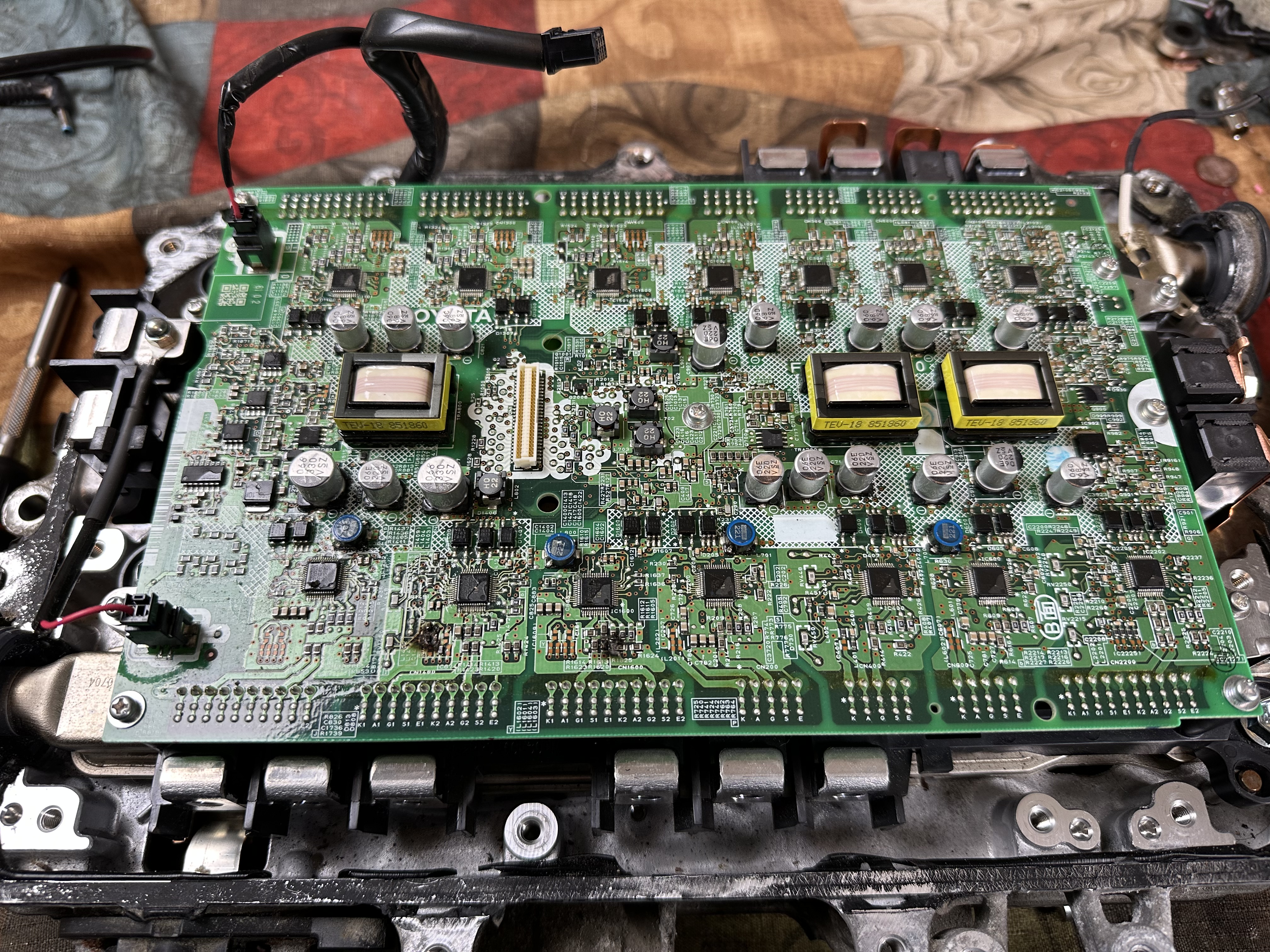

Well. I’m confused, the electric car was driving great until I updated the foc firmware, blew my second inverter, first one I thought I had reversed the power connection but after spending three days attempting to get the new inverter and dual motor board to drive I ended with a blown inverter again. Can anyone help with this. I’m not using my third inverter until I know this won’t happen again. Also the first inverter blew the buck boost igbts, the second one blew the control board on the inverter. I have stopped for now because I can’t seem to figure this one out. Been reading for hours on the forum and wiki just to verify it wasn’t me.
Note that I did correct the different wiring for the main signal cable when installing the dual control board. Disconnecting the grounds from mg1, and verifying before powering up.

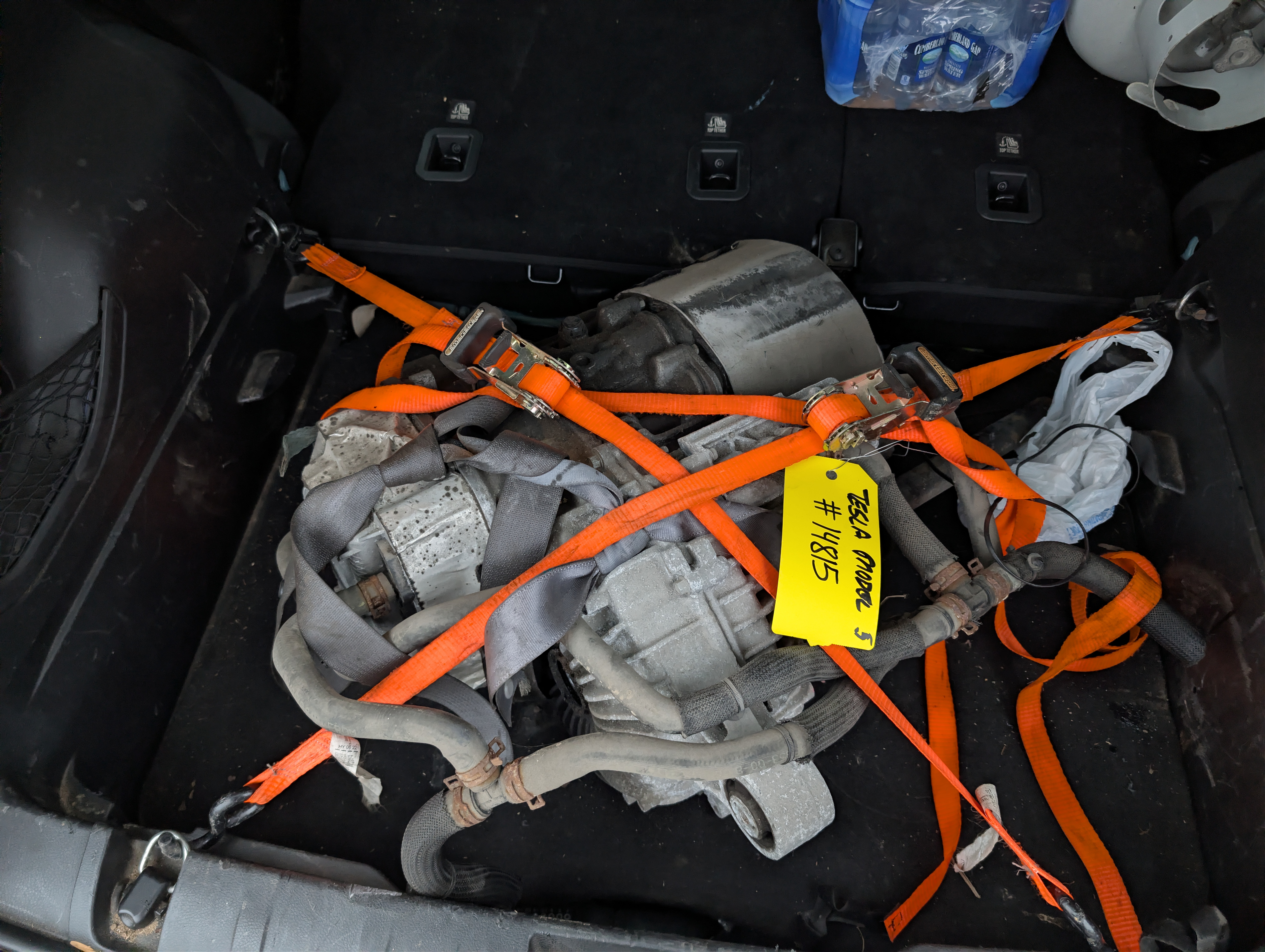

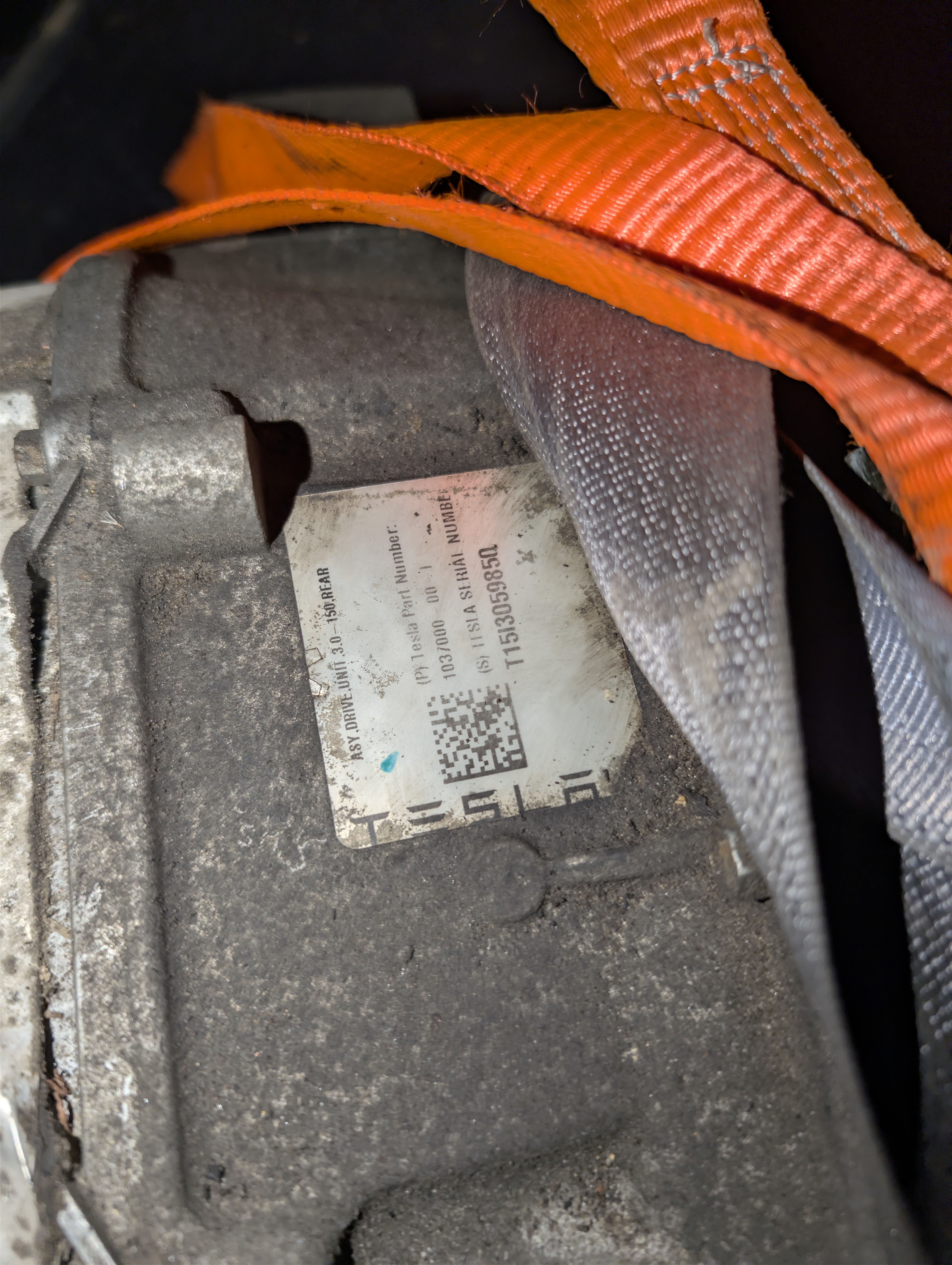

Route change up for the mazda, purchased a Tesla small drive unit and control board to change the Toyota headache over to tesla. Should get a much faster car video out soon
