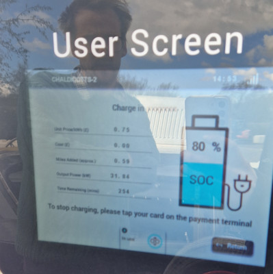

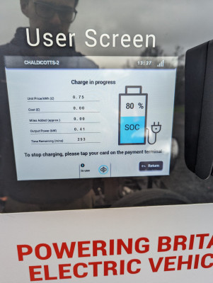

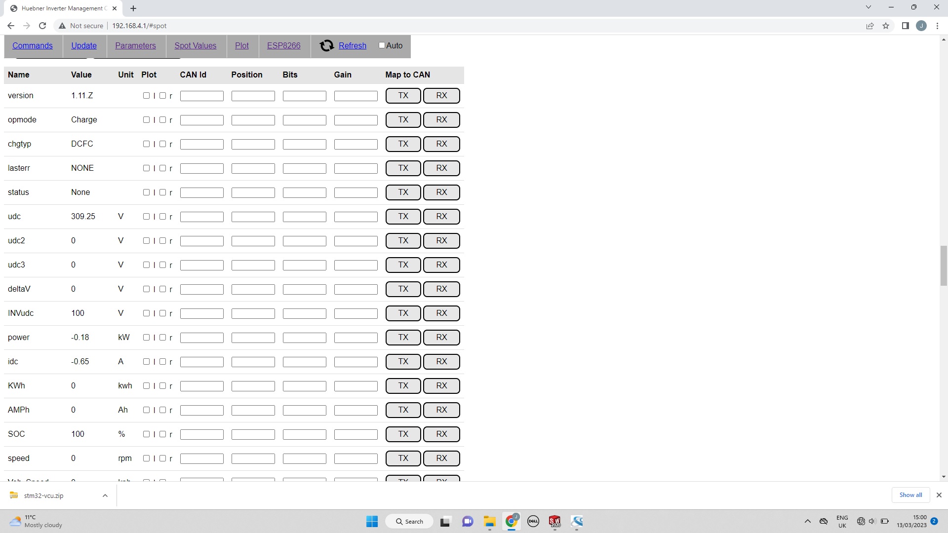

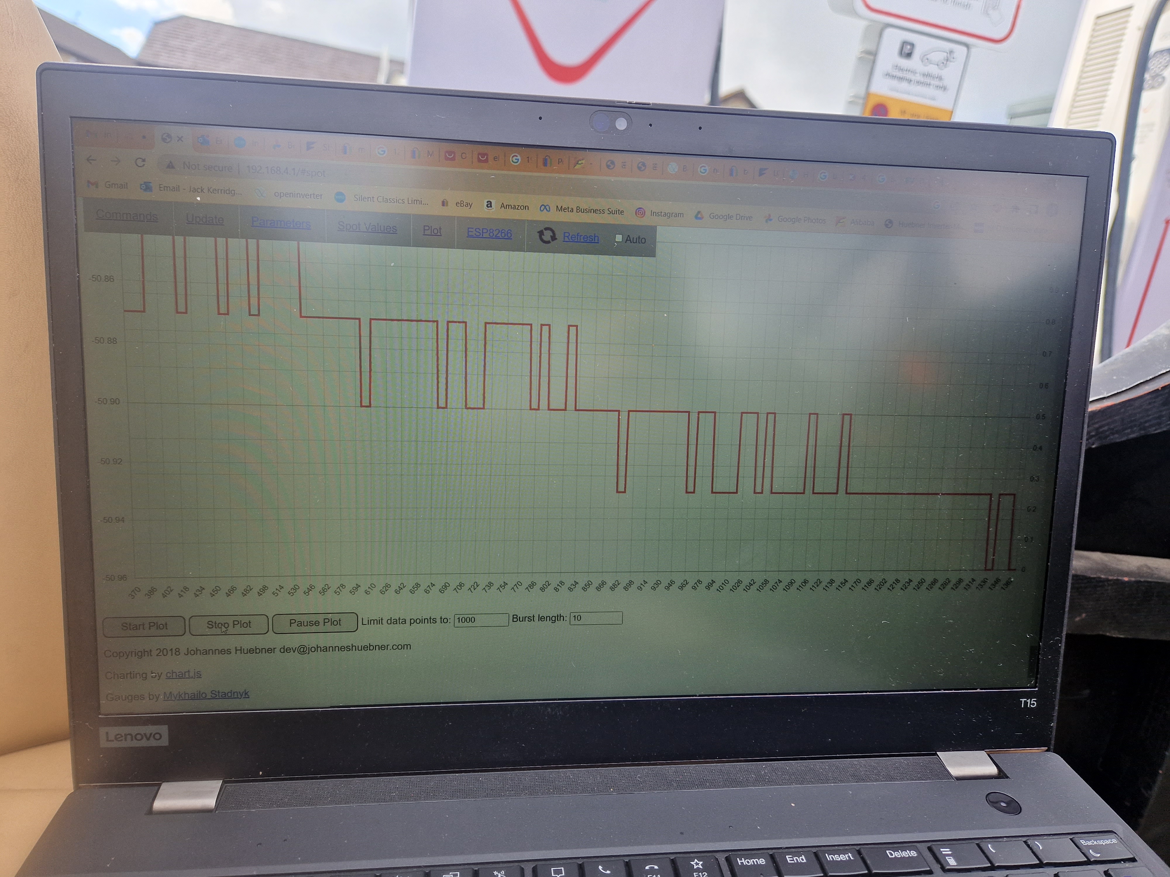

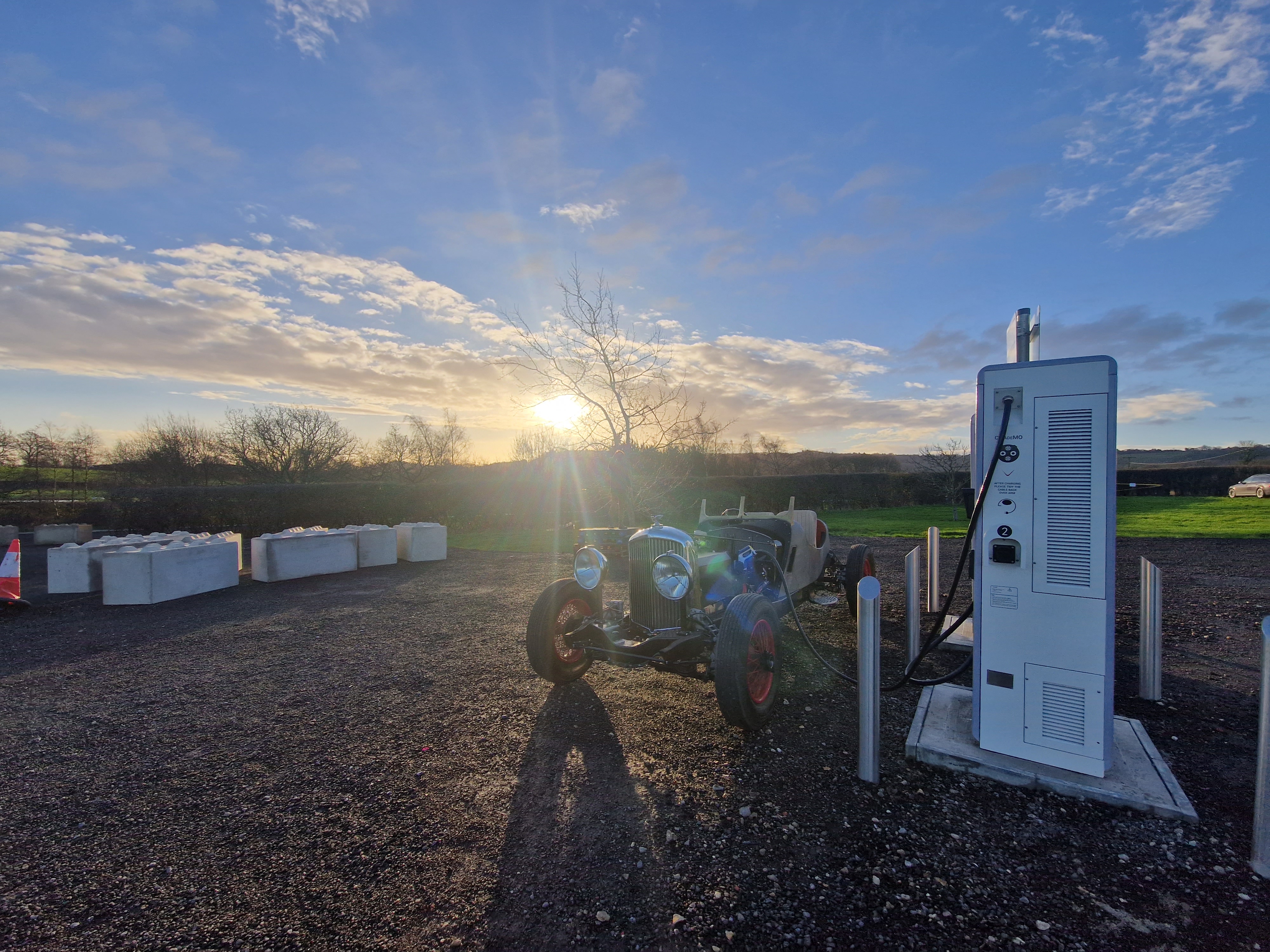

So following on from catphish Posts, we have had a chance to test the CHAdeMO.
I Can confirm that CAN now works!
I have attached some supporting images.
However no current flow. We have established that the CHAdeMO Contactors are not closing. Within the pdm - (Picture attached from Johannes YouTube video on the pdm) ( We haven't pull ours out the vehicle yet to open it up) however it seems that p2&10 go to a logic board. Assuming this is controlled via can to close the contactors, has anyone got a can log from a leaf during CHAdeMO to try decipher what the required messages may be for the board?
Regards, all!
Regards, all!

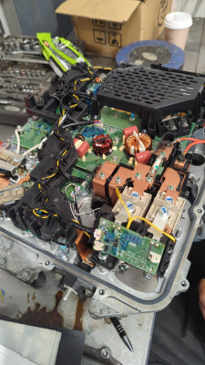

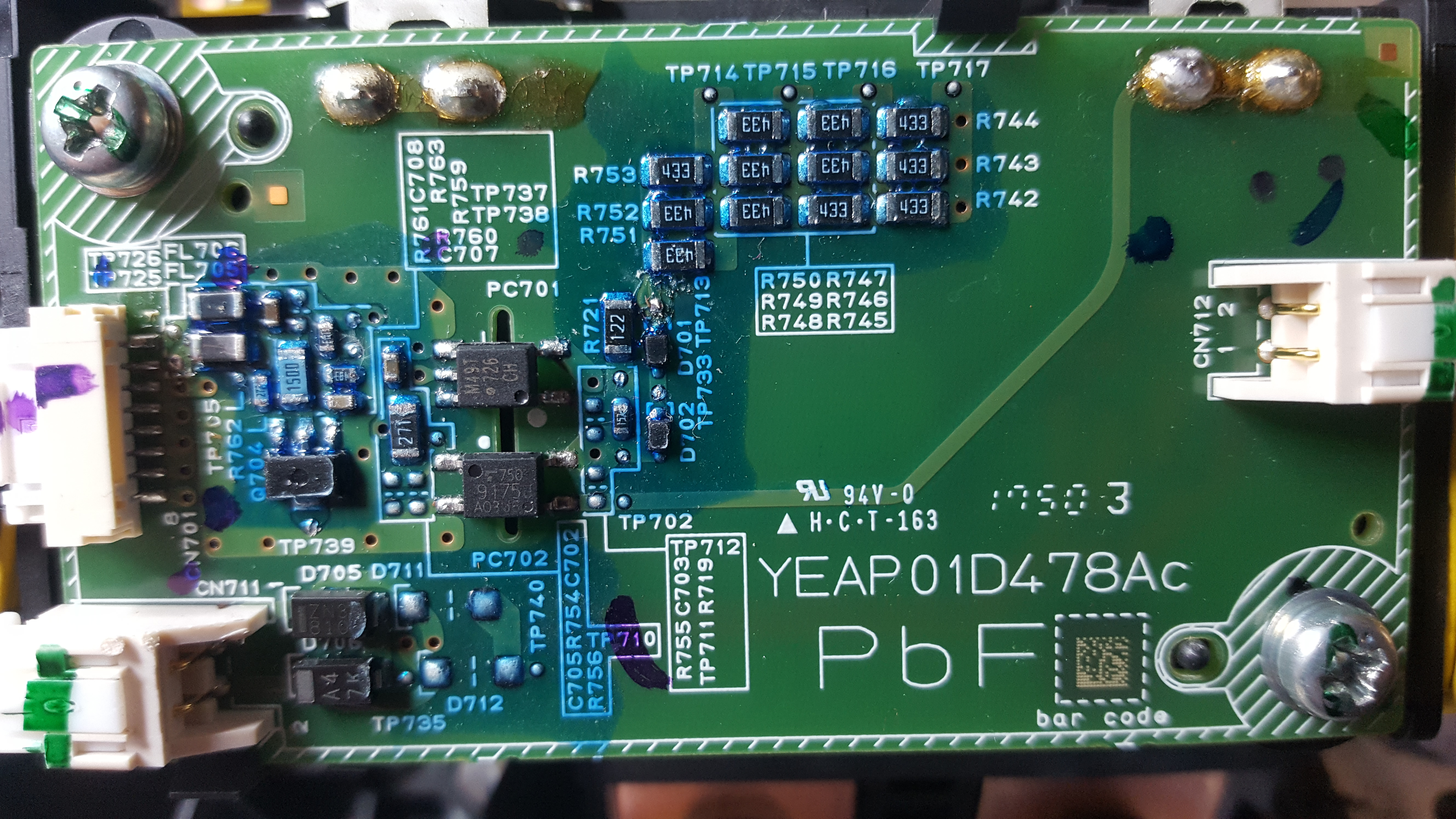

I have had a good look at the gen 3 Chademo logic board (YEAP01D478Ac), attached is the circuit (possibly with some errors) Edit attached picture for reference
I have powered up the voltage sensor and it works as follows:
PDM connector
4 sensor gnd
2 sensor output, pullup to 12V or 5V if using an analogue input)
3 sensor supply, 5V
Connect 5V between pin 3 +ve and 4 -ve, note that powering the sensor from 12V will give 50mA to the opto which is quite high. The sensor work still works with 4V supply so I expect it designed to work with 5V. The sensor is a threshold detector.
Connect 1k pullup from pin 2 to 12V to (5V)
output 1.35V(0.62V) HV is > 180V
output 8.5V(3.5V) HV is < 180V
Note this was tested with a voltage across the 1k5 and 1k2 resistors (no high voltage supply), threshold is 2.65V which equates to about 180V across the full resistor chain.
PDM connector
4 sensor gnd
3 sensor supply, 5V
leaf_gen3_Chademo_contactor_logic_board.pdf- (5.32 MiB) Downloaded 682 times

You could bypass the logic board and wire directly to the contactors, or possibly make a cable from the logic board connector (looks like TE 1744426-8 for gen 2) and pass it out of the plugged hole in the case. That way you could also use the voltage sensor to implement contactor weld test and detect charger supply voltage before closing the contactors.
I have a gen 2 PDM with the lid off, I will produce a schematic of the logic board as I did for gen 3.

SUCSESS!!!
We have CHAdeMO Charging!
So we bypassed the logic board within the PDM (Gen 2) tried it at our local charging station and it charged!
So now on to the next challenge, As it is, the way the CHAdeMO is integrated means that only AC OR CHAdeMO charging will work at one time. It requires a change of setting for the alternate method to be used. For both to work we need the Zombie to essentially have two charge modes at once, so it can look for the Digi input for the CHAdeMO and also the Can signal for AC...
Also at present SOC for the CHAdeMO is a manual setting, this needs to be taking data from the shunt in order to be accurate.
Any suggestions on what can be done for this? I'm not at all savvy when it comes to code but we are willing to trial new firmware versions etc now we have CHAdeMO successfully working.

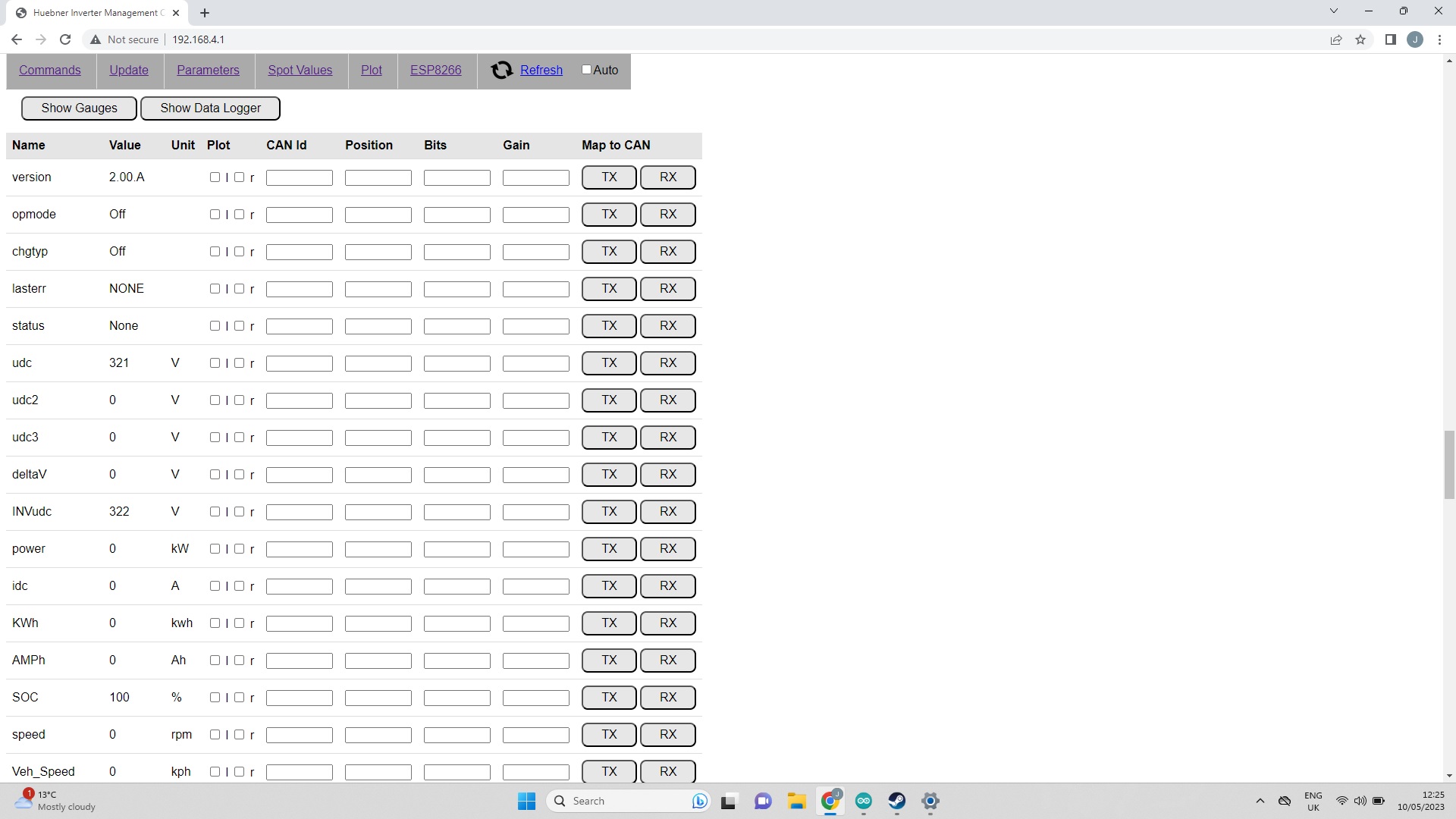

Hi guys, Has anyone tested CHAdeMO with 2.00??
We took our car to the local fast charger this morning to test, following testing driving and AC which were both successful
However we failed to get the car to charge on CHAdeMO..
I have attached our settings for reference.
It seems as though the VCU isn't picking up the 12v from the charge station to send it into fast charge mode, and therefore start sending the can messages required to start charging

hi,im strugling to get the AC charging to work with zombie vcu running v2.00 firmware and 3.6kw leaf charger,the the j1772 socket is recognised and the DC-DC kicks in ging 14volts to the battery but i get no charging,im using an 96s leaf battery pack with an orion bms
m.art.y
