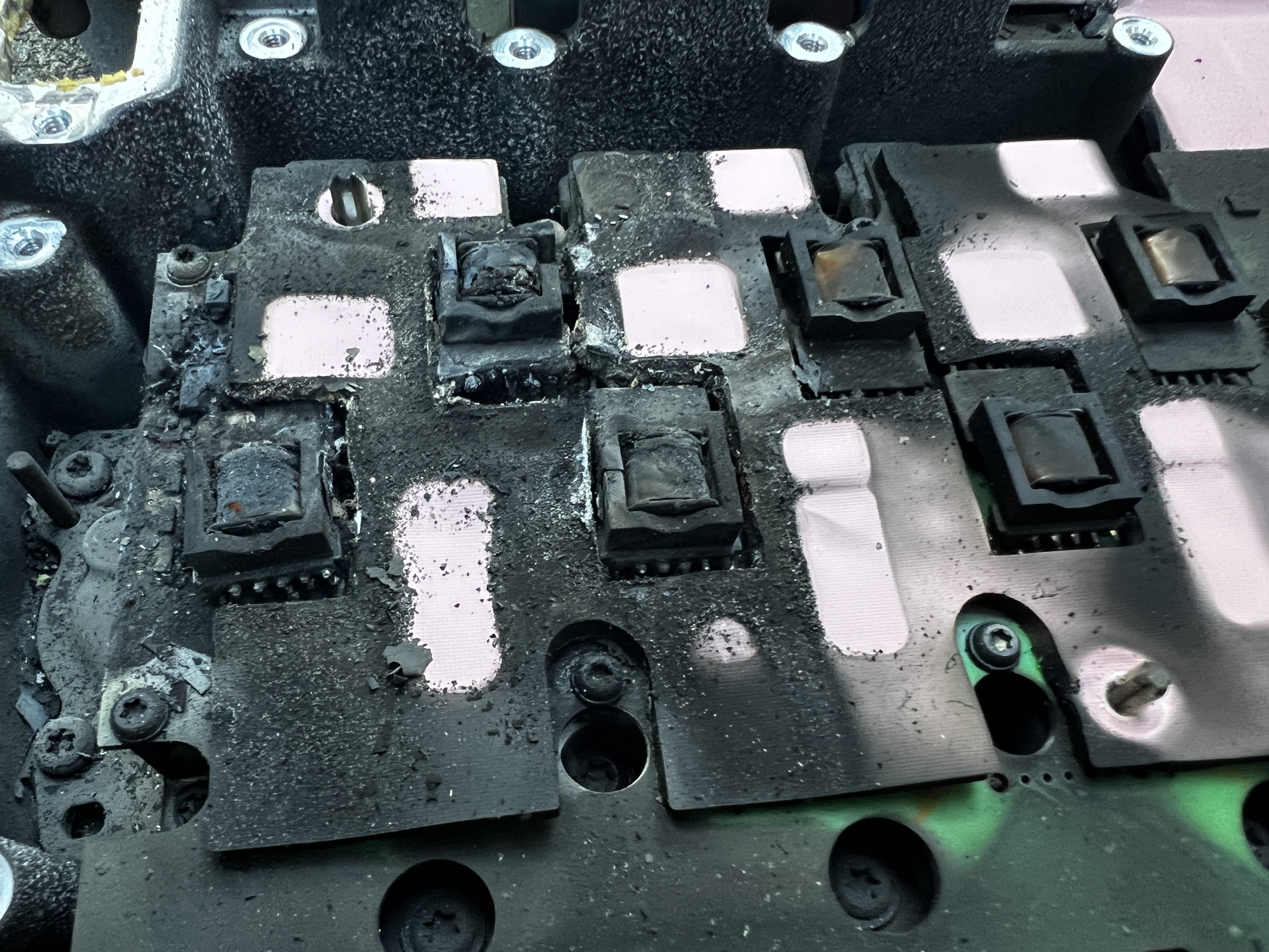

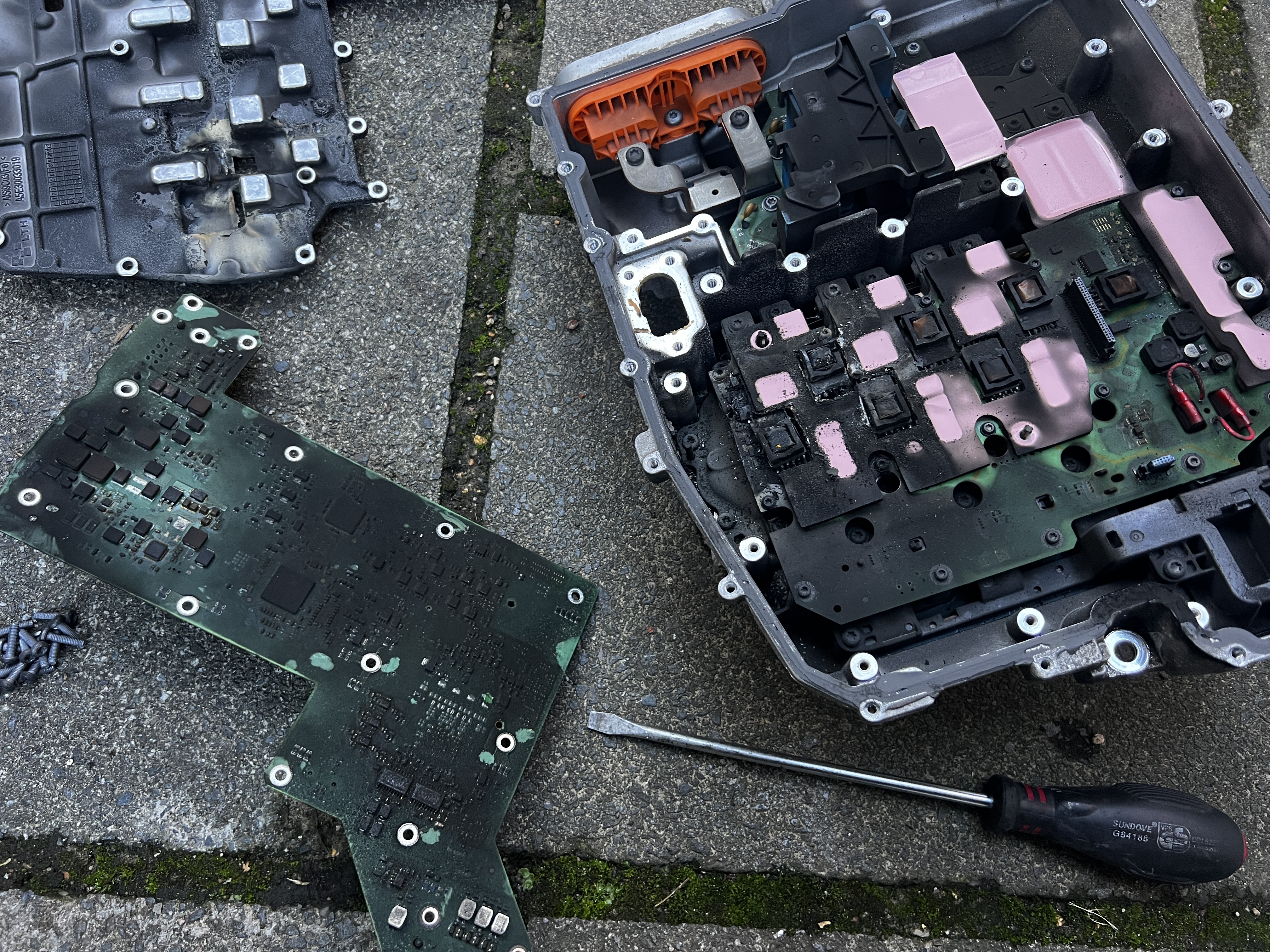

I bought second hand inverter with the electric motor complete from ebay and tried to swap it with my old one but the imobilaizer fault code came up and i can’t bypass that! Anyone can help?
Re: MEB motor and inverter (ID.3, ID.4, Eniaq, etc.)
you need to re pair it as it has component protection. cant be done in vag come you need official vw dealer tools
What was the reason of the swap?
Do you still have the old inverter/motor?
The car sustained minimal damage at the front, and both front airbags were triggered, along with the pyro fuse, I had no communication with the electric drive and then I found that the inverter had failed. I still have the old partsEV_Builder wrote: ↑Wed Oct 25, 2023 5:55 pm What was the reason of the swap?
It might be possible to swap the inverter logic board from the old one? That would get you the matching EEPROM and IMMO coding that the car is expecting. I dont know if theres any sort of resolver offset or other calibration that would need redone to match the new motor though.
Yeah; what he said was my idea too and indeed you need to maybe merge the data or re calibrate the resolver. If and only if the offset isn't stored in the resolver itself.Aragorn wrote: ↑Fri Oct 27, 2023 12:38 pm It might be possible to swap the inverter logic board from the old one? That would get you the matching EEPROM and IMMO coding that the car is expecting. I dont know if theres any sort of resolver offset or other calibration that would need redone to match the new motor though.
The logic board appears damaged as well,there's melting on the back side ! The options are if someone can remove the imobilaizer with software or to get a brand new inverter which cost £1300EV_Builder wrote: ↑Fri Oct 27, 2023 5:49 pm Yeah; what he said was my idea too and indeed you need to maybe merge the data or re calibrate the resolver. If and only if the offset isn't stored in the resolver itself.
Post us pictures of the board. Closeups.
Have you asked on Ross tech or obd eleven forums? Older vw / Audi cars you could read the old immobilizer info and recode the new / used item. Not sure how this would go on the id4.
I agree, probably will need to figure out how to get the immobilizer info off the old inverter. It doesn't really look safe to power up with high voltage. I wonder if the controller would communicate without high voltage present. Might be able to pull the immobilizer info that way.
Not sure if you would get anywhere if you try the right to repair route with VW.
Older VAG cars could have the immobilizer defeated with a tune. Not sure if that's the case with this. I don't see any tunes besides throttle pedal remap "tunes."
All that damage is from the pyro fuse?
