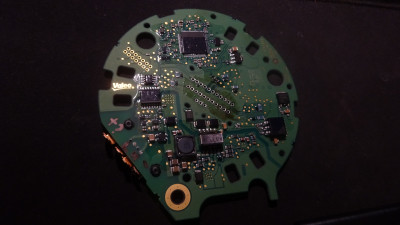

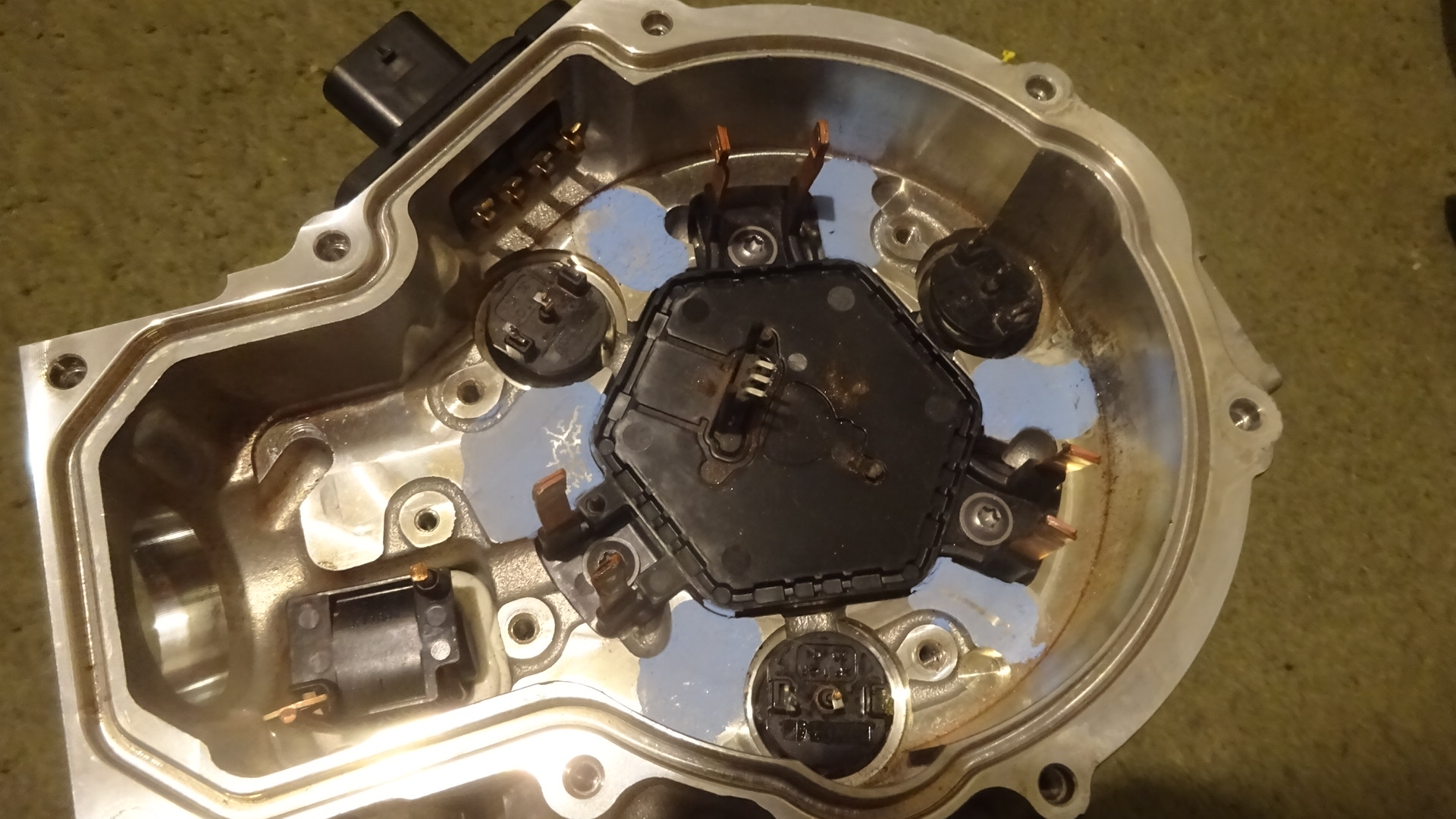

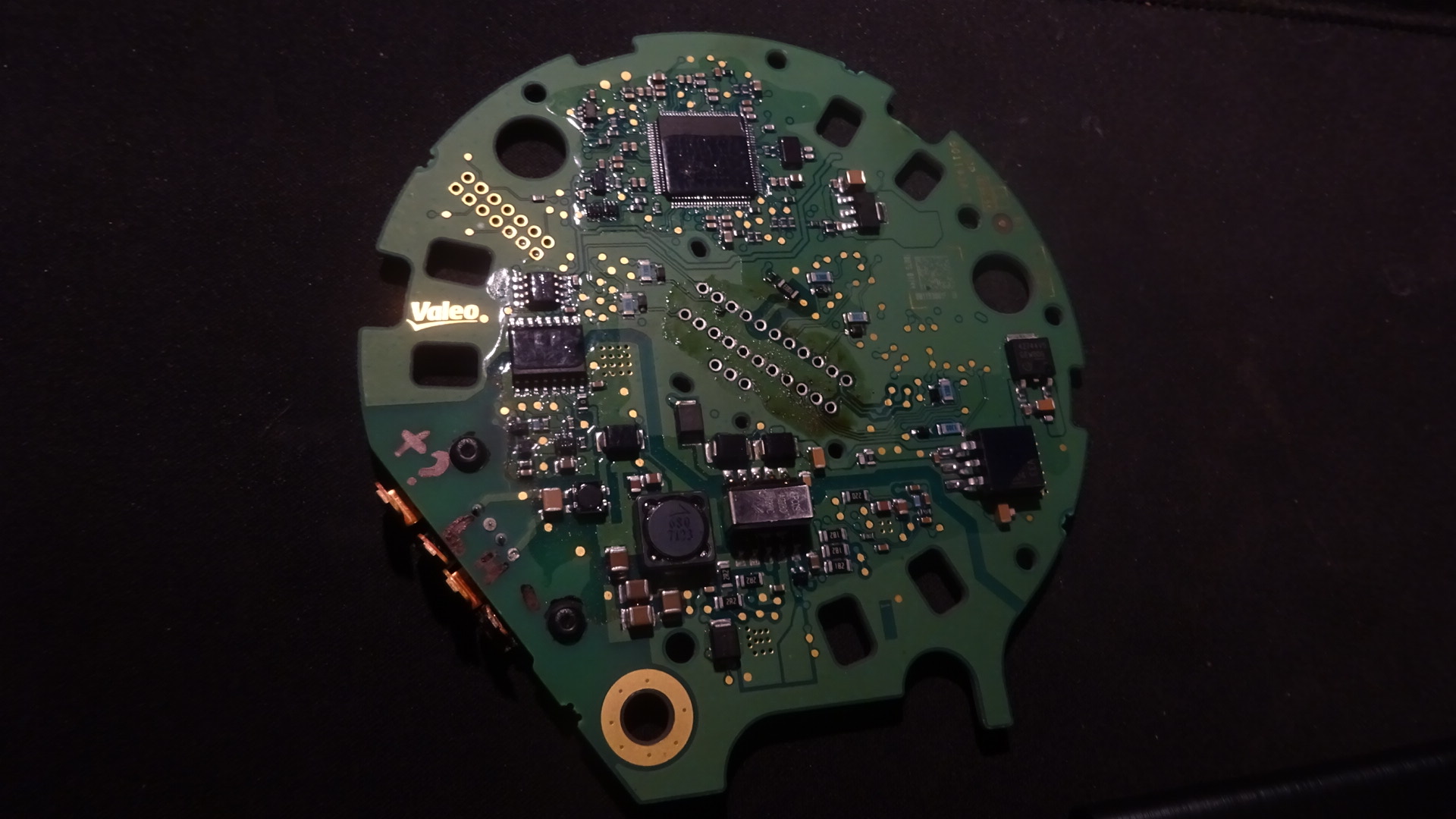

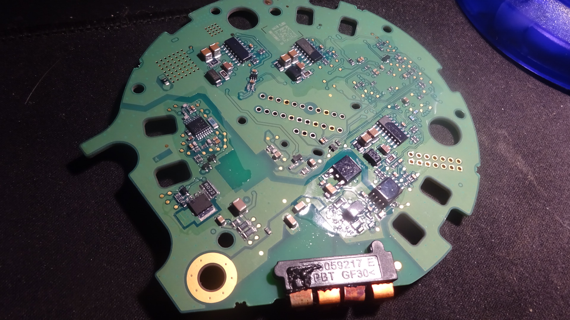

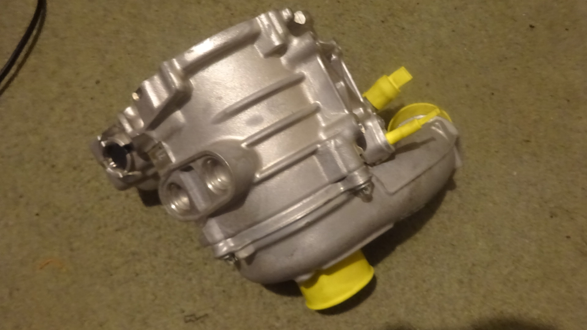

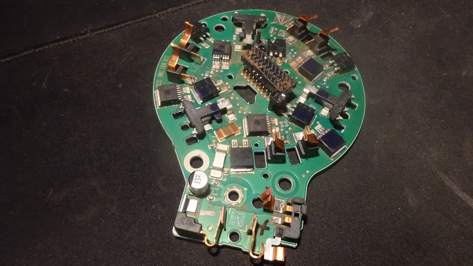

I have this E supercharger, it was bought faulty so it was torn down, its not really EV but it has some interesting power electronics and a switched reluctance motor which i thought you might like to see.
The disassembly was a success in that it can be put back together and the fault fixed, though it wont be laser welded anymore it will have to be soldered.
If anyone has the CAN protocol or a capture so I can use it please let me know.
Audi SQ7 Electric supercharger.

nice, i want to buy one of these and control it via the canbus.
there's a few people online that have done this but unfortunately don't want to share the can frames

Re: Audi SQ7 Electric supercharger.
I know, I have tried contacting them myself, I think they are probably being greedy and trying to get money from it by developing their own control system? Im not really sure why you wouldn't want to share. It still might be possible you can find the right frame if there is no serial number or CRC checks in place. We will just have to wait i guess, Im currently running a Tubrbodyne Turbopac modified with a hobby ESC but its only 6s capable so i only get a few PSI max of boost but its gains are still quite impressive.

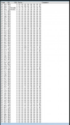

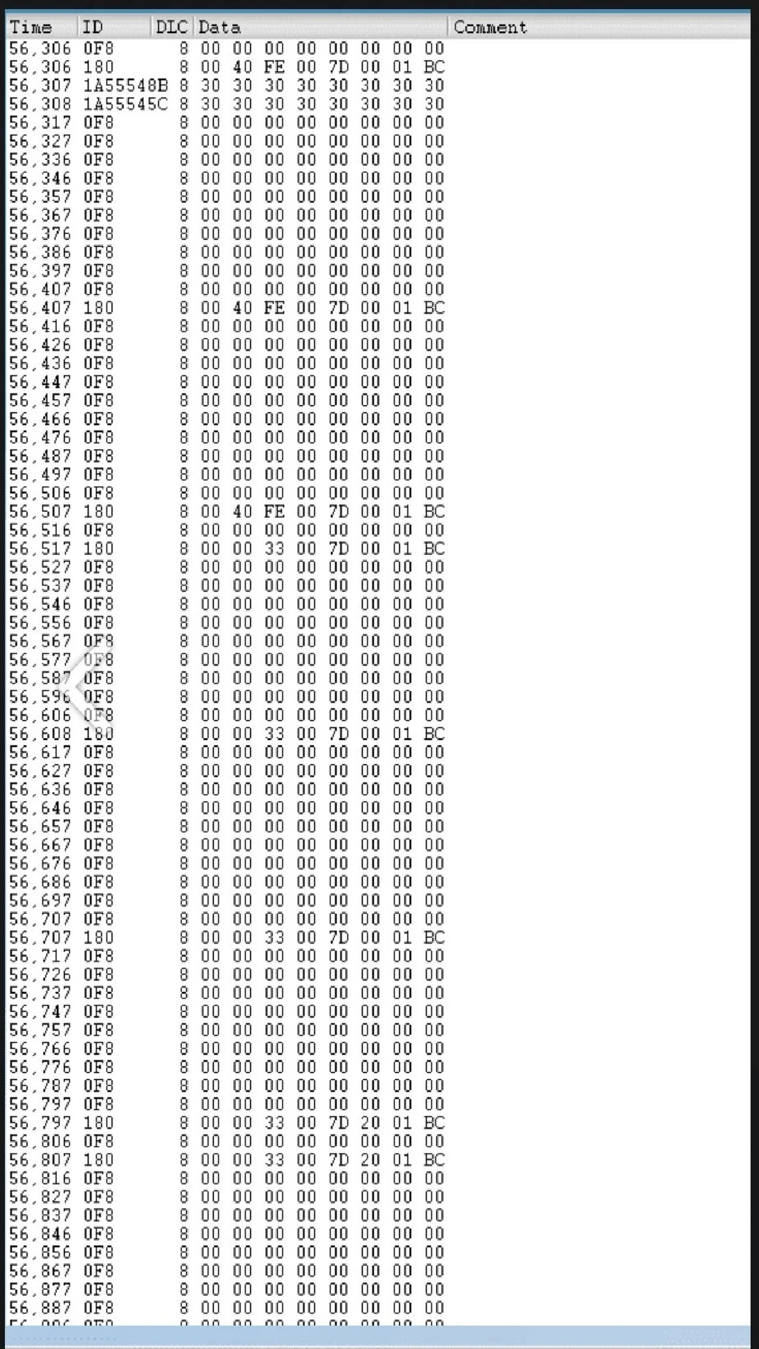

I put this back together and had a look at the can signals, i didn't learn much, it times out after a few seconds probably waiting for a wake up from the ECU
frame 180 tells some information about voltage and temperature, Byte 3 is temperature and byte 7 Is voltage, i think they are both DEC X 0.255
i assume the other bytes are probably current and RPM which should be fairly obvious when its working.
I think these might be some kind of CRC check or announcement to the ECU?
1a55545c 8 30 30 30 30 30 30 30 30
1a55548b 8 30 30 30 30 30 30 30 30
1a55548c 8 00 00 00 00 00 00 00 00
If anyone has any ideas let me know, i saw on some of these threads some work with CRC but i didn't understand it, perhaps someone who has worked on similar VAG stuff explain what the reply should be?
I'm a bit stuck on this without a can log of a working car, those who have it working are unwilling to help it seems.
An Arduino program for testing different can ID's might be helpful, i think its called fuzzing? is there one anyone knows?
