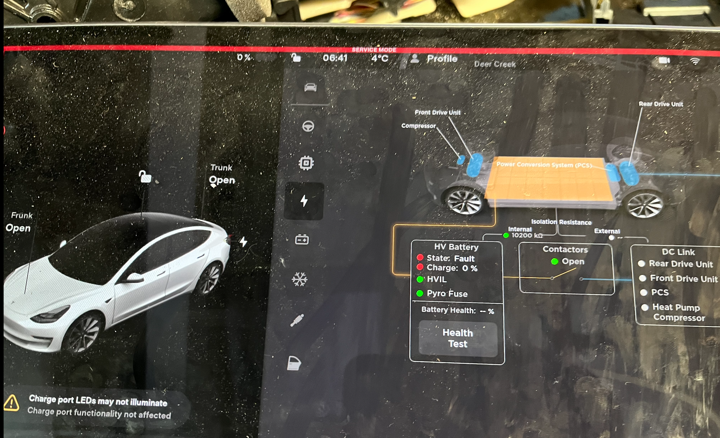

I am still unable to close the contactors; I shorted each of the HIL pins with a small wire. Do you know how I can check if there is damage to the PCS of the battery?bielec wrote: ↑Thu Jan 05, 2023 8:11 pm I have a dual motor version and I have linked the HVIL on both front and rear motor connectors and the small pins on the "Anciliary"/heater connector.
I have nothing connected to the charger socket.

Re: Model 3 High Voltage Controller
Don't know about damage to PCS but have you checked.....
1. Capacitor across the H.V. pins
2. Resistor on X098 across HVIL pins
3. !2v on 2 pins of X098
3. 12v battery across DC/DC stud terminals, + on outside stud
4. If you are using my hacked code for the ESP32 then did you remove the line of code which caused error in transmission?
5. Links on the HVIL pins on both HV motor connectors and aux HV connector
6. CAN data connection on Vehicle bus on X098
7. The penthouse lid screws must be in place to complete the HVIL. I think just the two which hold connector X098
If you use SavvyCan to view data (by hanging an extra can transceiver across the vehicle can lines) then you can view and study the can data stream which will give you information such as HVIL state and will indicate if closure is being attempted and much more.

I mean there are two stud connectors one positive one negative and the outside one is positive.
Another point, the lid screws of the "penthouse" must be in place. Specifically the two which hold connector X098 in place. These complete part of the HVIL

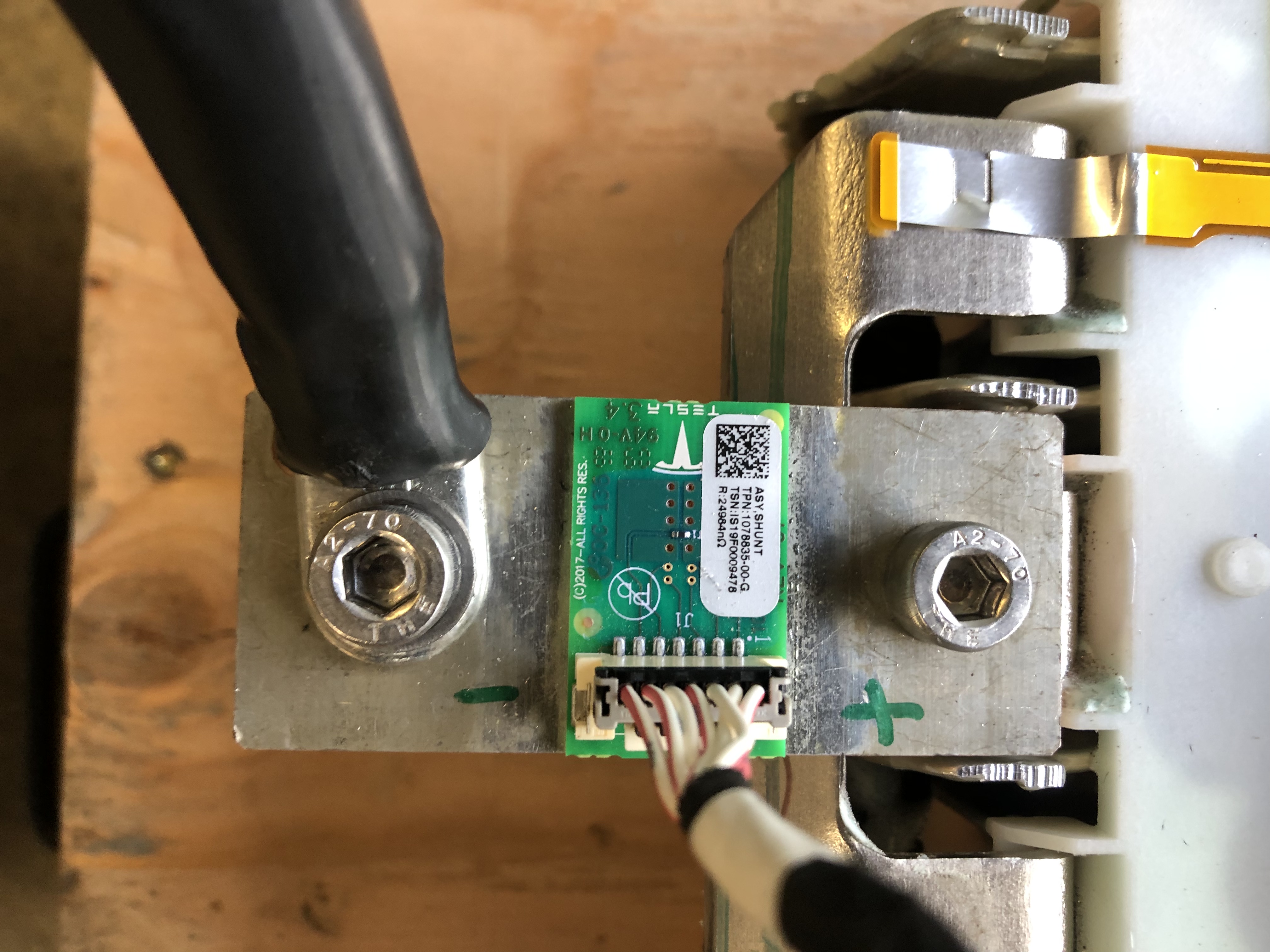

okay im started to take a crack at this for my battery setup.
for now im only using 3 out of the 4 short modules.
i have one of the middle modules "missing"
stripped down the HV controller harness to just the isospi and shunt connectors.
here's my log. looks like i can read all the cell voltages off id 0x401 (on charge port can) just fine with only 3 modules connected.
it seems to only read the first module the hv controller is connected to and report the max/min cell voltages on 0x332(vehicle can). Not the min/max of all 3 total.
so the actual min/max from 0x401 and 0x332 dont match. is this because of the spam thats occurring on vehicle can from all the errors?
i just want proper min/max and temps

Also can anyone confirm this is the orientation of the shunt?
- EV_Builder
- Posts: 1205
- Location: The Netherlands
- Been thanked: 37 times
Not sure but the measurement would flip sign isn't it?
- muehlpower
- Posts: 692
- Has thanked: 14 times
- Been thanked: 141 times
I'm not sure how to interpret your caption. On the M3, the shunt is between the middle batteries, in series with the fuse. Your terminal labeled "-" is connected to "-" terminal of a battery and the other to the the Fuse . The Fuse is connectet to "+" terminal of the next battery.
- Bratitude
- Posts: 1000
- Location: Canada
- Has thanked: 176 times
- Been thanked: 369 times
cheers, yes just want to confirm polarity. i have it between modules just like stock.muehlpower wrote: ↑Wed Feb 08, 2023 5:31 pm I'm not sure how to interpret your caption. On the M3, the shunt is between the middle batteries, in series with the fuse. Your terminal labeled "-" is connected to "-" terminal of a battery and the other to the the Fuse . The Fuse is connected to "+" terminal of the next battery.
I have 2 packs sat at my workshop and I'm tearing my hair out trying to get a HVIL OK status.
120ohms across pins 1 & 3 of the main external connector. 12v connected at the same connector and the 12v studs. Pyro was blown so that has been bridged with a thin piece of wire for testing voltage only, the element has been linked out with a thin piece of wire.
I'm playing back your can log M3221.csv and it shows NO_12V_SUPPLY for approximately 10 seconds before returning to unknown. Current draw is ~230mA and 18mA when 12V is removed from the studs.
https://i.imgur.com/8uaYSRy.png
https://imgur.com/a/HWVx79W
I do not yet have a capacitor across the main HVDC out. And I have no standard cables attached to the charge port etc.
I know I cannot close the contractors with this status, I want to set to a state where I can. Any help would be appreciated.
Edit: Thanks to bielec and comments here I was able to find the last HVIL link which was located on the underside of the pack, underneath the penthouse.
For others having issues with closing the contactors, keep an eye on the HV voltage reported from 0x2b4 and the state of your PSU across the 12V studs. Undersizing the electrolytic capacitor causes a precharge attempt to abort as the voltage ramp fails to conform to expectations (I assume). Oversizing seems fine although it does take a while (+6s for 3300uF) to match with pack volts before closing.
