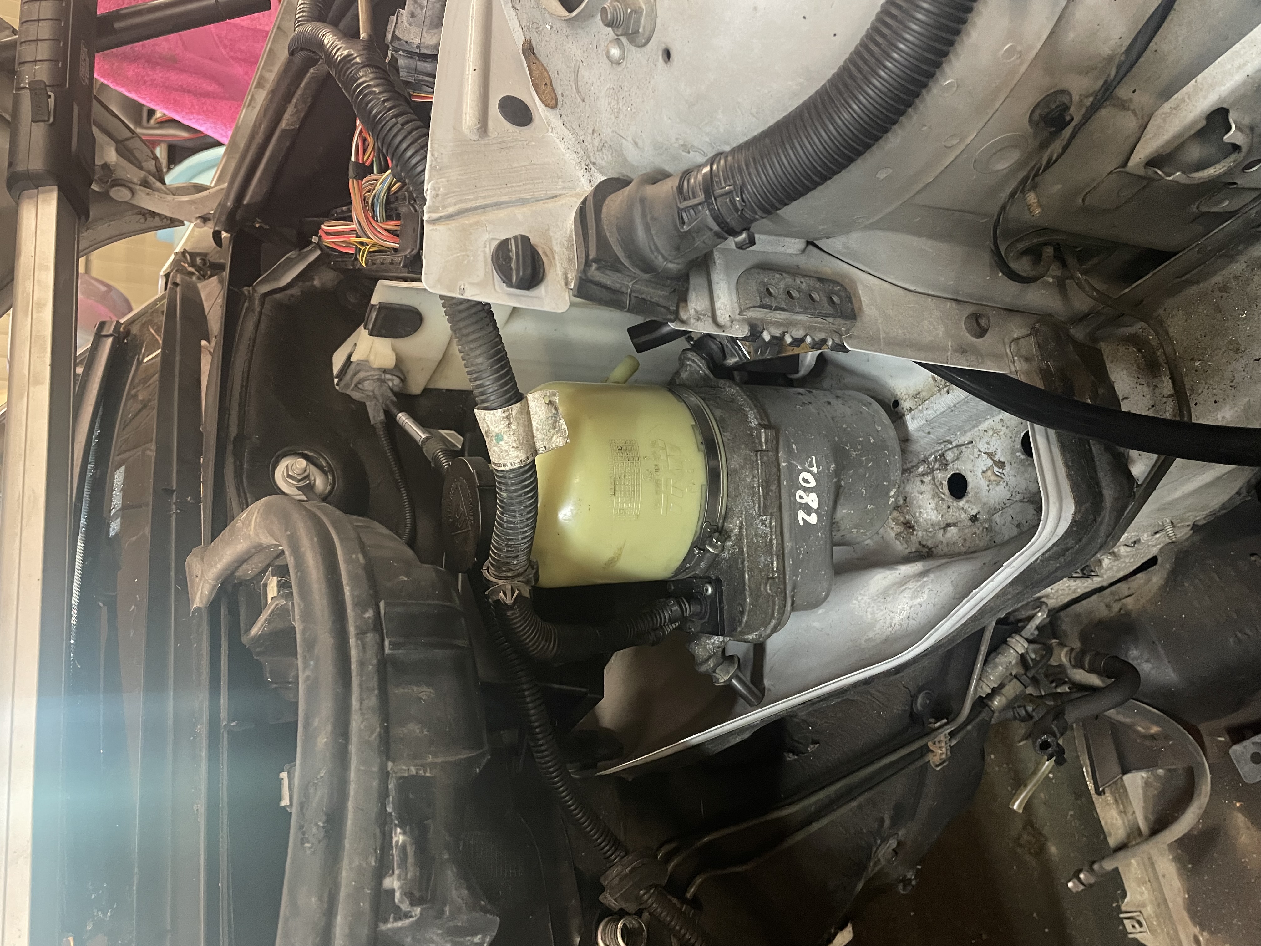

Couple of snaps showing power steering pump prototype and vac pump. I've been told the power steering is the noisiest part of the build, so i've mounted it as in-board as i can. There is a stout plastic cover to go round that corner.
The vac pump itself it mount under the headlight where the drying cannister used to be, and the cannister is relocated to beside the washer bottle. Just need to add a non-return valve and the wiring.
12v fuse box fits behind the PS pump on the firewall but not shown yet. Need to work out how to mount it without drilling any holes.

What functions does the original ecu still do that means it needs to be kept, can these also not be taken over by something else?
That is one hell of a chunk of aluminium you have there!

yeah tell me - wasn't cheap but i do have a tendency to over-engineer with an aim of only doing it once

The lunchtime run revealed a recurring issue of power steering leak, there's a lot of pressure in there and one of the solid to flexible pipe joins doesn't have a flare on it, so i need to rectify that.
My vac pump also won't stop, suggesting a leak somewhere, need to track that down, maybe try it without the reservoir as other members report there is enough capacity in the servo for 3 good brake depresses. I'll try that, though i kind of like the concept of a vacuum reservoir, the 'fuller' it is, the less it holds etc
