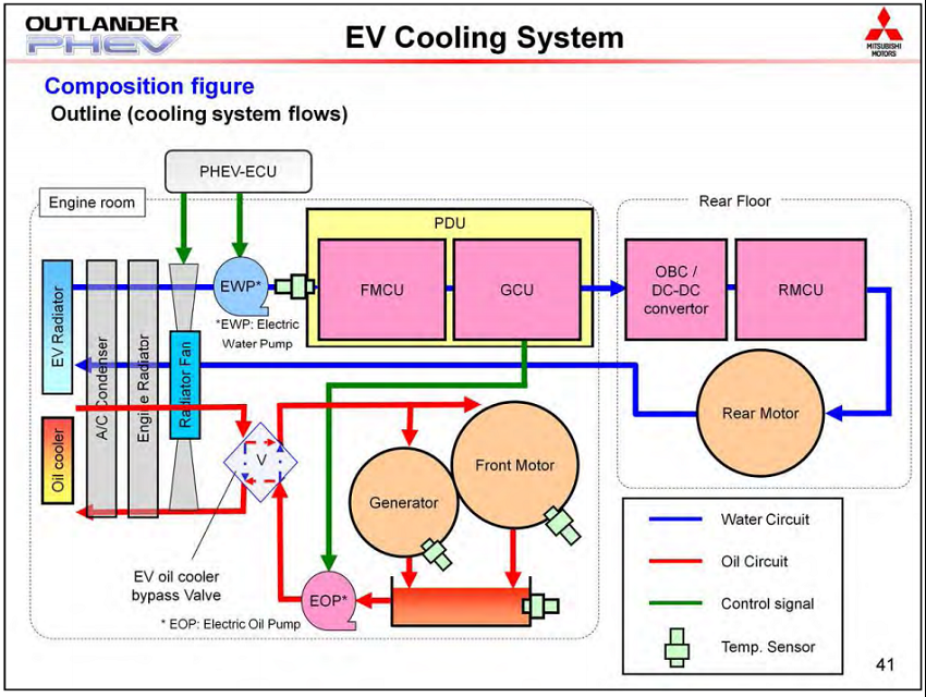

Ok this might be a daft question, but i have 3 components in my EV project that need cooling (lets forget the batteries for now), the charger, the inverter and the motor.
So i am assuming i can run coolant (water & anti-freeze) through the charger and inverter.
With the motor (PHEV rear) though, is the coolant route through the motor actually the lubricating oil supply like say an oil cooler on an engine i.e. running the lubricating oil outside the engine to cool it. In which case, does that need to be oil circulating, or is it water cooling, and the oil is self contained ?
thanks

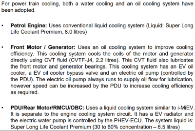

To my knowledge, the rear motor came from factory with water cooling, check the below pictures (although I'm unsure where did I get them from, someone can confirm..)
Edit: okay I found the information from this link, maybe you can find related other information:
https://www.myoutlanderphev.com/forum/v ... php?t=4255

Re: Oil or water cooling
that's a great help thanks.
So i can use water as i have a rear motor, but those using front motor should be running CVT fluid.
I have a rear Outlander Motor in my build. Running one coolant loop through the motor, inverter and charger. I think ideally you would want to separate out the motor since it runs a bit hotter than the inverter and charger. But I haven't had any issues with my setup so far in terms of heat.
Only using a heater matrix as a radiator.
