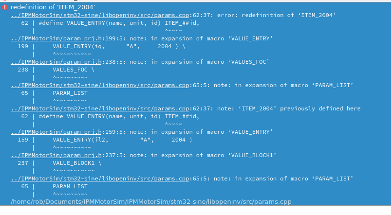

rstevens81
Posts: 377
Location: Bristol, UK
Has thanked: 29 times
Been thanked: 111 times
Post by rstevens81 »
Just a FYI, I think the simulator might be broken with the latest release (2weeks ago)... I am am only amateur will dig a bit more and report back if i find an easy fix.

Pete9008
Posts: 1801
Has thanked: 102 times
Been thanked: 350 times
Post by Pete9008 »
Wondering whether the param_prj.h file in the simulator project directory could now just be deleted (the one in the OpenInverter source code would then be picked up and used by Qt instead and would still need modifying to suit your motor). If so it should fix the above problems.
Trying to remember why the replacement file was needed, think it was primarily to override the resolver, pinswap and syncofs values which could cause problems with simulation. However, the simulator should now override these in the code so the param_prj.h file changes may no longer be needed.
I'll hopefully have a look at it in the next day or so but in the meantime deleting the file might be worth a try as a quick fix?
Delting the file almost works....
Posts: 6772
Has thanked: 385 times
Been thanked: 1594 times
Ah that's because these kps have been split into idkp and iqkp
Will need to be accounted for by adding an edit field to the GUI
