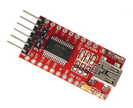

You could also take advantage of the hard work done by member Dima and install his windows based web interace:
viewtopic.php?f=5&t=255#p2756
Installs on Windows 10 but have not tried earlier versions. Ir avoids the need to install Apache web server.
It is a very nice interface with a lot of extra and useful features. I am using one of these FTDI usb to ttl converter set to 3.3 Volts.

Ahh, neat. Well since I can't find my FTDI converter, that's a solid plan B.

Dilbert wrote: Wed Jan 01, 2020 8:47 am If you don’t have the WiFi module you can use a terminal application to change settings over the usart interface.
Understood. But not the handy web interface, you'd be spitting commands one at a time using terminal, (unless you're using Dima's work that Kiwifat linked to above), and, you'd still need a UART-USB converter, which is actually more expensive than a little ESP8266 board, and less convenient.
Because I didn't have either a wifi board or a USB-UART converter, and didn't know that one or the other was required back when I ordered parts months ago, I was hoping to find a "Can I just make it work right now?" solution for my 2-month/end of year goal.
On that note, I've been at this 2 months now, (Oct 30th I got my inverter from the scrapyard, and we just passed Dec 31), and my only actual "work" on the project is perhaps 1-2 hours soldering and a few minutes downloading and using software. The rest is asking questions about what to buy/do, which, I'd say I've been borderline aggressive in doing, I don't think I've had many/any wasted days. In my opinion, that's so intimidating that I'm probably the first person to try it (at or below my competence/knowledge level). And I know that even though this is a development board, there are loads of people waiting in the wings for me to finish and do the writeup because they've either said so in the thread or PM'd me letting me know.
So my goal is that at the end of this process I can have a novice sit down at the Prius Gen 2 wiki, make all their purchases in 30 minutes, and when parts arrive go from a pile of parts into something that can spin a motor in about 2-3 hours without having to pester anyone for questions or clarifications. So I want to say thank you again to everyone who's invested time in answering these questions, I'll try to make sure as many people can benefit from that as possible without anyone having to put in extra or repetitive work.
