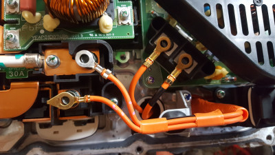

Afternoon all!
Trying to work out the gen 3 pdm
I have attached a image woth some annotations of what I have worked out connection wise. Please feel free to correct me if they are incorrect.
I cannot find anywhere the polarity of the AC in connections.
Anyone able to help?
Tia!

2019 Leaf PDM
The wire with the black tape (in the picture) connects to L1 on the type 2 charge connector. The polarity of the AC connection should not matter really, unless the PDM does an continuity check between PE and neutral, like Renault's do.
