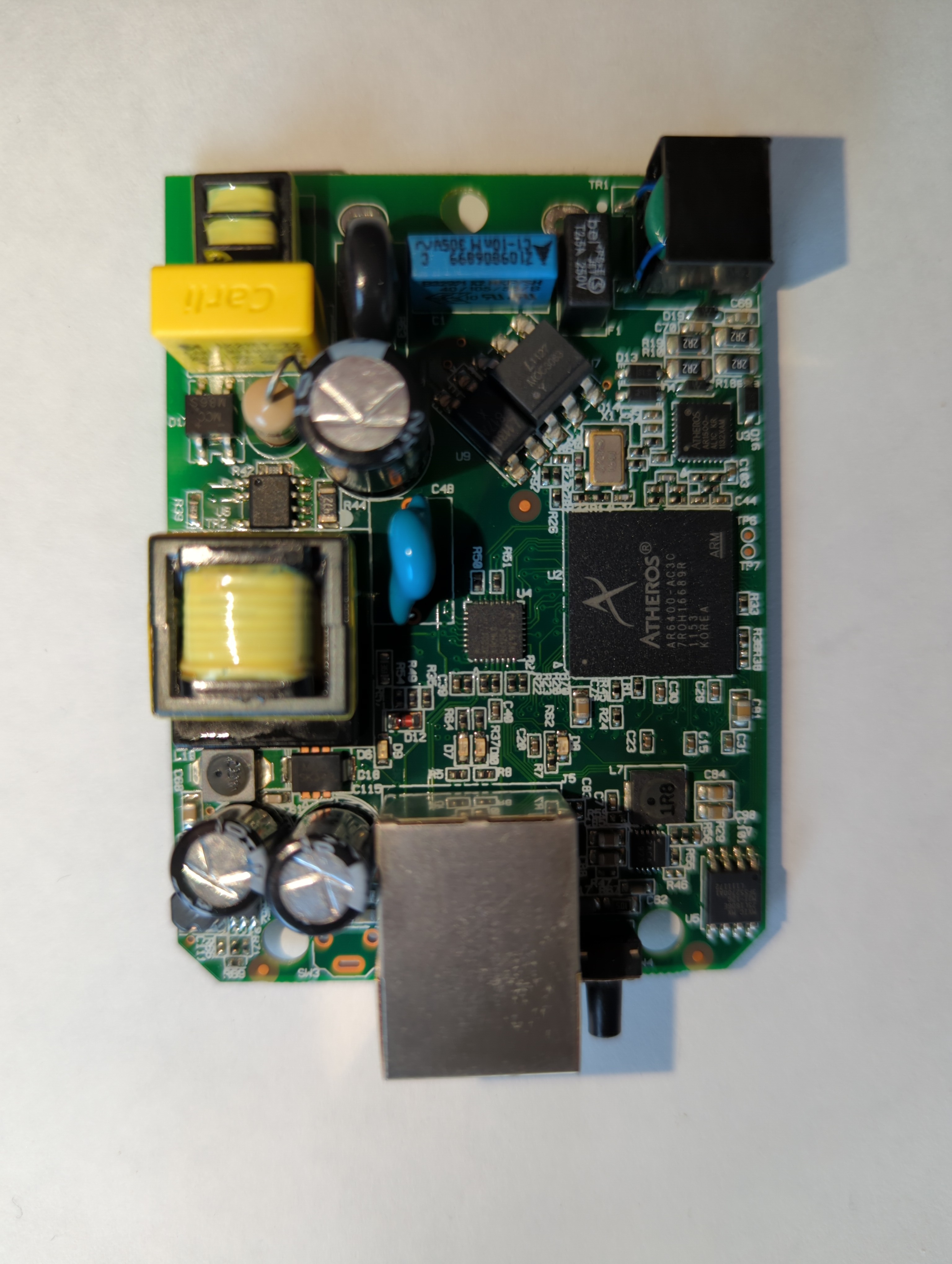

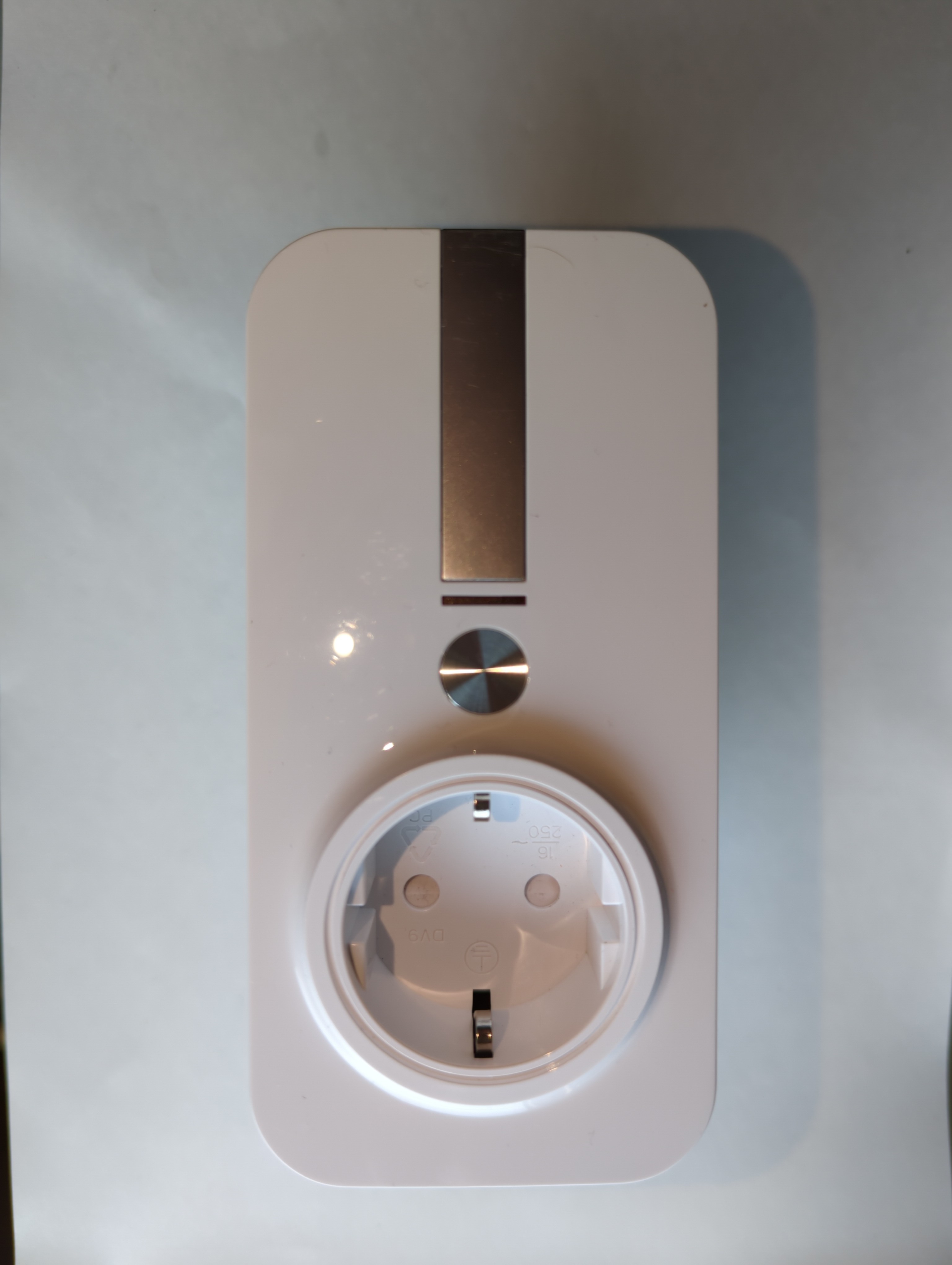

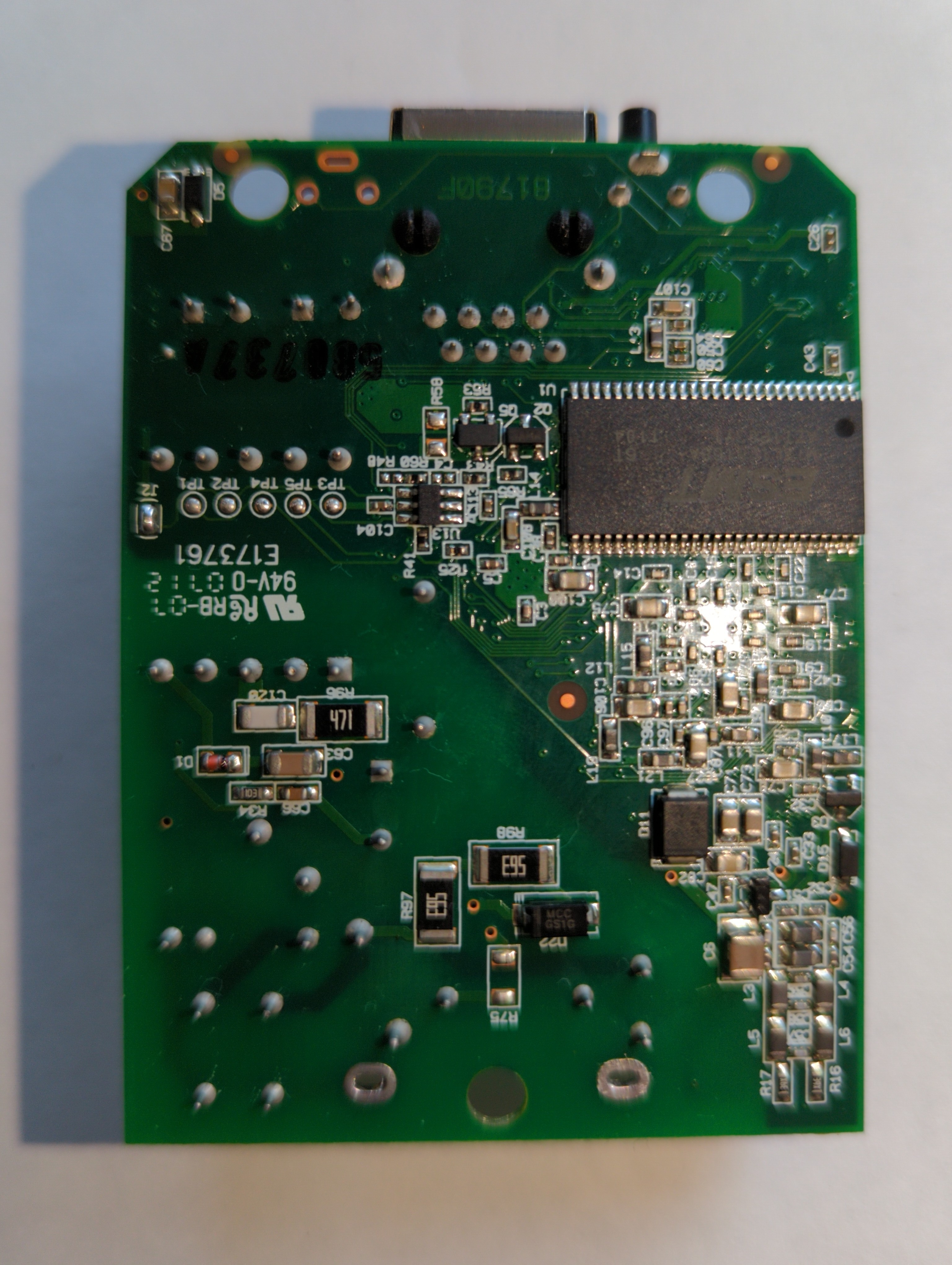

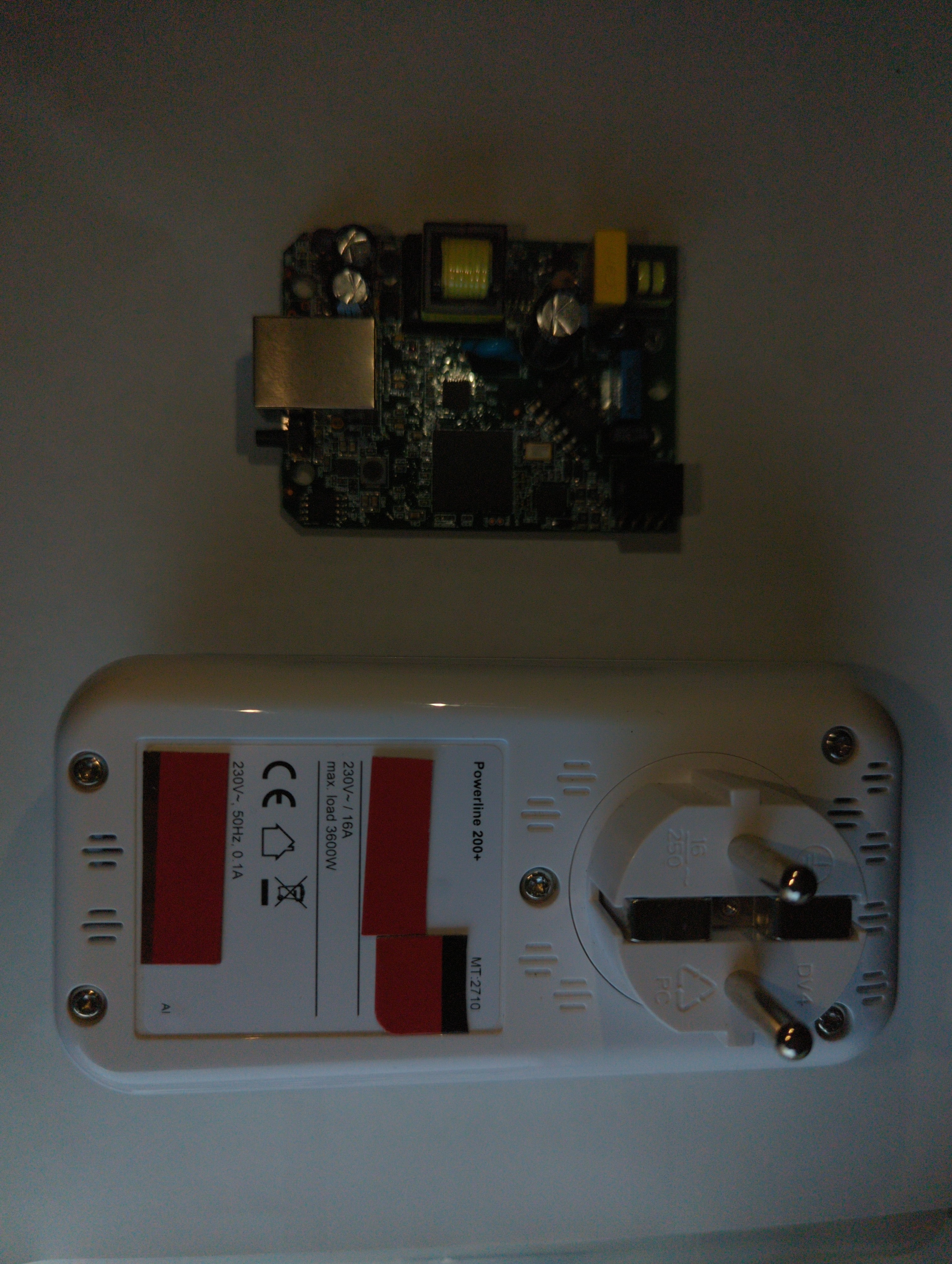

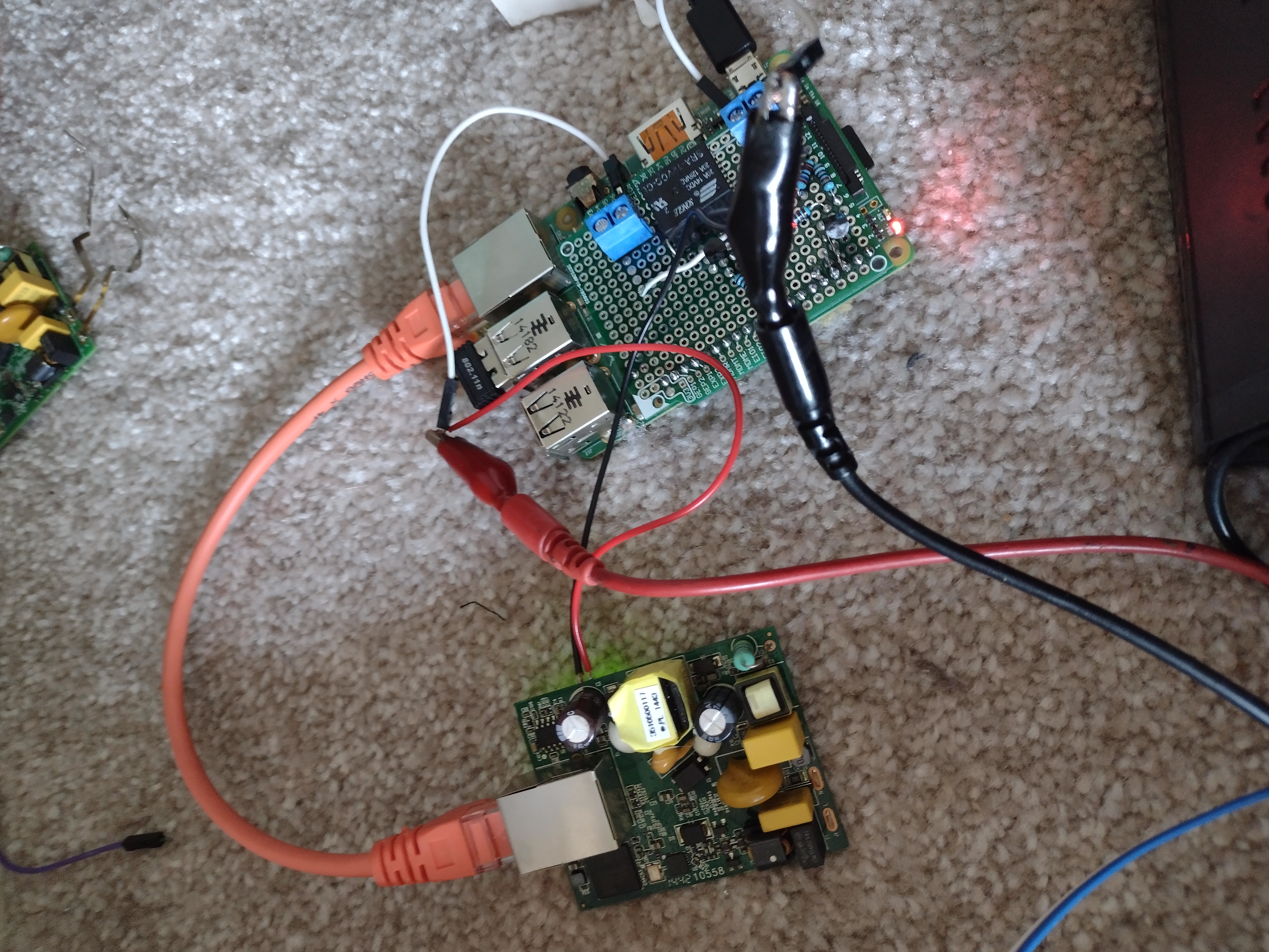

Finished some automated tests regarding the reaction in case of errors. Version 0.8 released: https://github.com/uhi22/pyPLC#2023-05-22-v08-released
I got a single Devolo Powerline 200+ MT2710 in preparation for viewtopic.php?p=54814#p54814 . I dont have a CCS capable car.
I used the Devolo software to reset to factory defaults like recommended here https://www.goingelectric.de/wiki/CCS-T ... e-Details/ . The firmware Version of the Devolo MT2710 reported by the Devolo software is 4.4.0.05 . I have seen version 4.4.0.5 as latest firmware update for other Devolo 200Mbit devices. So i expect to be the latest one Devolo released for this device series.
The Atheros Chip is AR6400-AC30. The PCB have 81790F and E173761 written on it.
The pictures are dual-licensed CC-BY-SA 4.0 and GPL V3.0 and can be used here (MT2710 is unlisted at the moment there) https://github.com/uhi22/pyPLC/blob/mas ... ardware.md
My first goal is to reproduce this setup:
viewtopic.php?p=53848#p53848
In the setup the TP-Link is been used. Is there a special reason why?

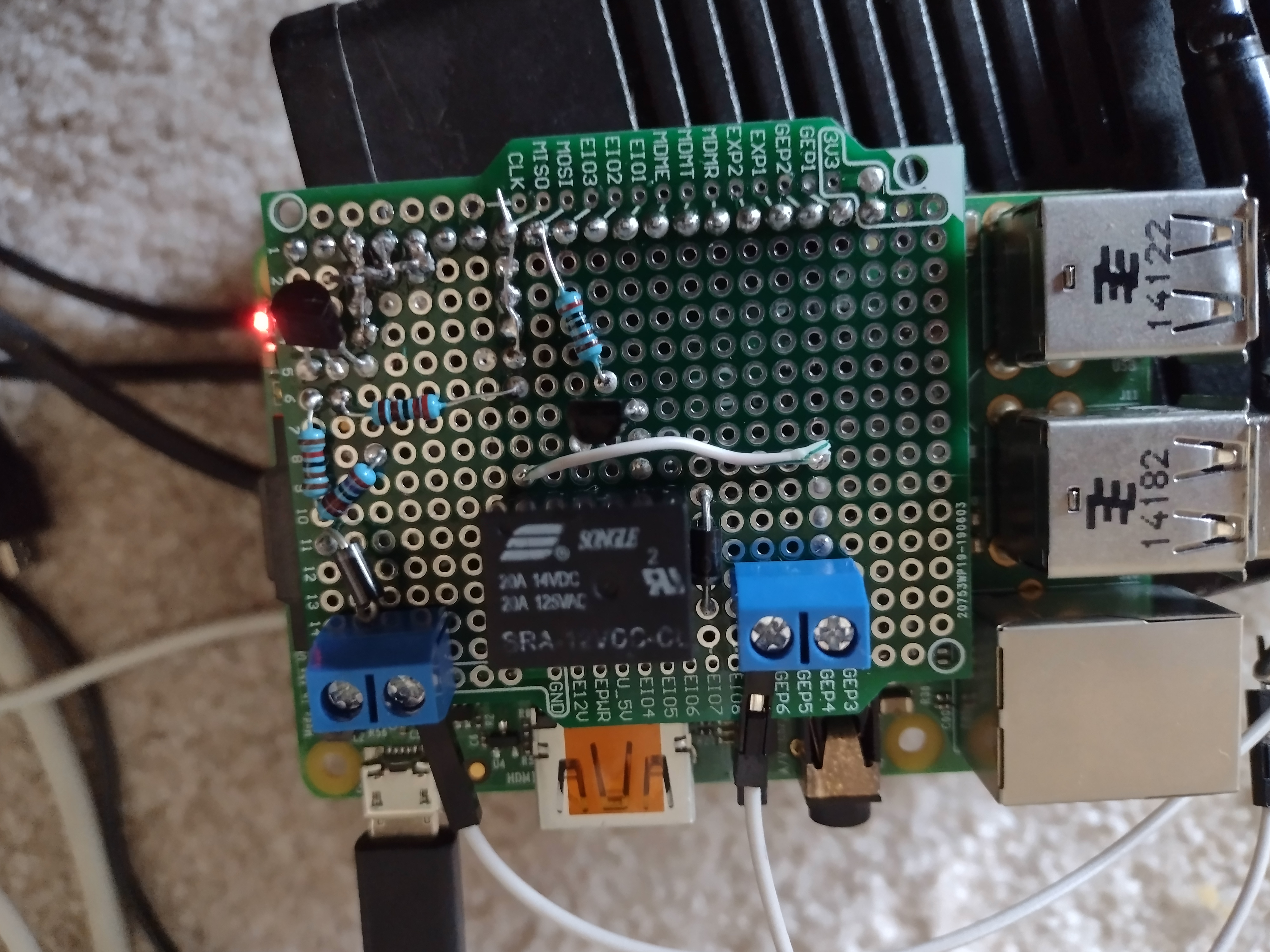

Hi @uhi22 , could u help show me directly the EVSE circuit described as "and the poti on left border to select 5% PWM." in your https://github.com/uhi22/pyPLC/blob/mas ... vseMode.md ?
I just could not wrap my head around which part of the circuit is this at https://www.instructables.com/Arduino-E ... ng-Station
And the code sketch below is looking for a +6Vdc square wave in State C?
This State Cwill be initiated by the car after EVSE responded with a 1kHz PWM in State B?

- uhi22
- Posts: 1117
- Has thanked: 206 times
- Been thanked: 617 times
Ohh, yes. That's really bad documented. The Poti is an add-on from my side, it is not contained in the original https://www.instructables.com/Arduino-E ... ng-Station. It is just a poti between 5V and ground, connected to analog input A2.
The snipped you posted is the poti evaluation, not the stateC evaluation. The poti evaluation is used to distinguish the cases "digital communication" (which leads to 5% PWM) and "analog communication" (where the target current is coded as PWM ratio. The I_Lade_Soll_A is the target charging current in ampere, for the analog case.)
The transition from stateB (PWM between +9V and -12V) to stateC (PWM between +6V and -12V) is done by the car, when it requests power. In an analog EVSE for AC charging, the EVSE would detect this and use it for closing the big AC relay. In the DC case, at the moment this information is not used by pyPLC. I just have the LED on the EVSE, which changes from yellow to blue, but no other purpose of this detection.
