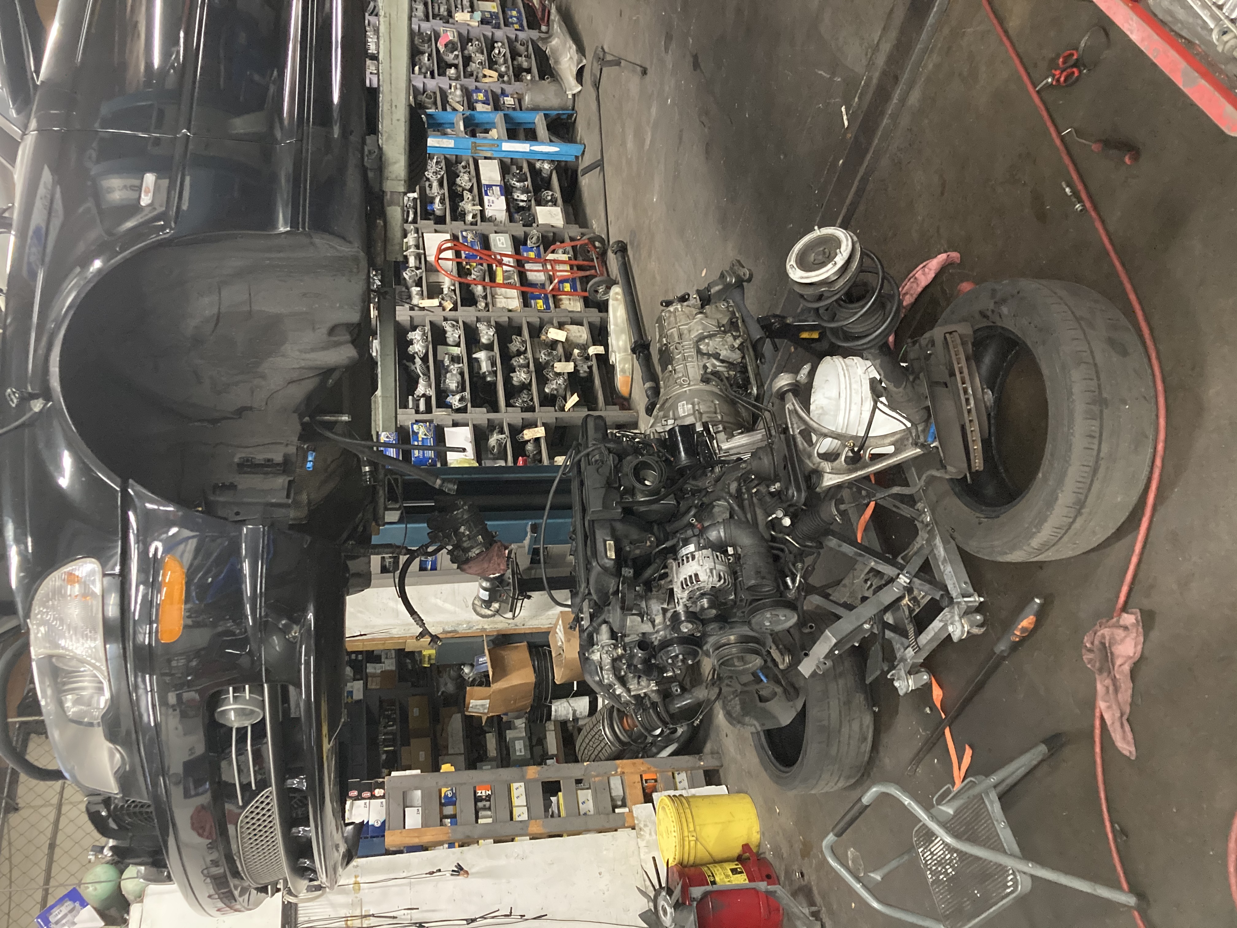

I got an ‘02 E46 convertible that had a blown head gasket for $1500. Otherwise in pretty good shape, so I pulled the drivetrain and got a transmission from an ‘09 GS450H for $400. I still need the inverter and wiring, because that was already cut out of the donor car by the time I got to it. I’m planning on using a battery pack from a BMW i3, Tesla Gen 2 charger and Chevy volt DCDC. I’m not sure what I’ll do for heat, A/C, brakes and power steering, but the last two will likely be ibooster and Prius steering.
I don’t have steady employment at this time, so I’m trying to do as much as possible on my own, and spending as little money as possible at the same time. I’m well comfortable with electrical wiring as well as working on vehicles. I have previously worked at an automotive repair shop, and specializes in electrical. My computer skills are above average, I can upload a program to a microcontroller, but I can’t write them. I’m an ok fabricator, but there’s plenty of equipment that I don’t have. For instance, I only have a stick welder, no lathe, mill, cnc router, plasma cutter. But let’s see what we can do...

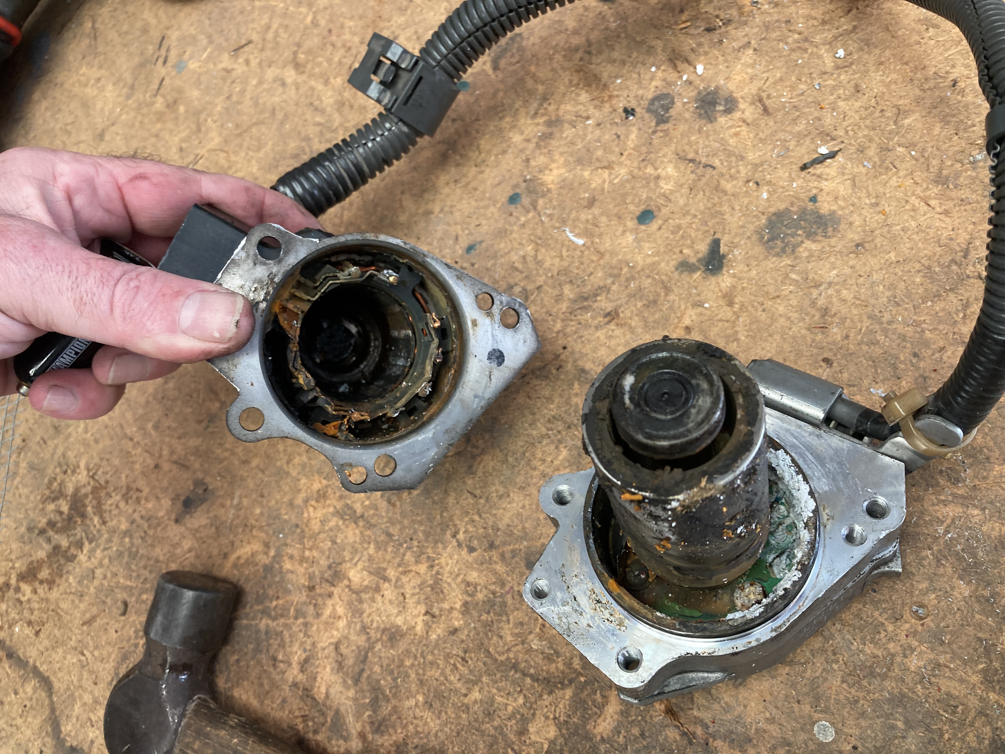

Re: 2002 BMW 330ci with GS450H transmission
I found out that the oil pump for the GS450h transmission is shot when I took it apart to change the bearings. I guess it's better to find out this way rather than after mounting the transmission in the car.
I'm toying with the idea of eliminating this unit, and using the electric hydraulic power steering pump to do both. In theory, it has plenty of pressure, but the steering needs less assist at higher speeds while the transmission needs steady/more pressure. I'll just have to test it and see.

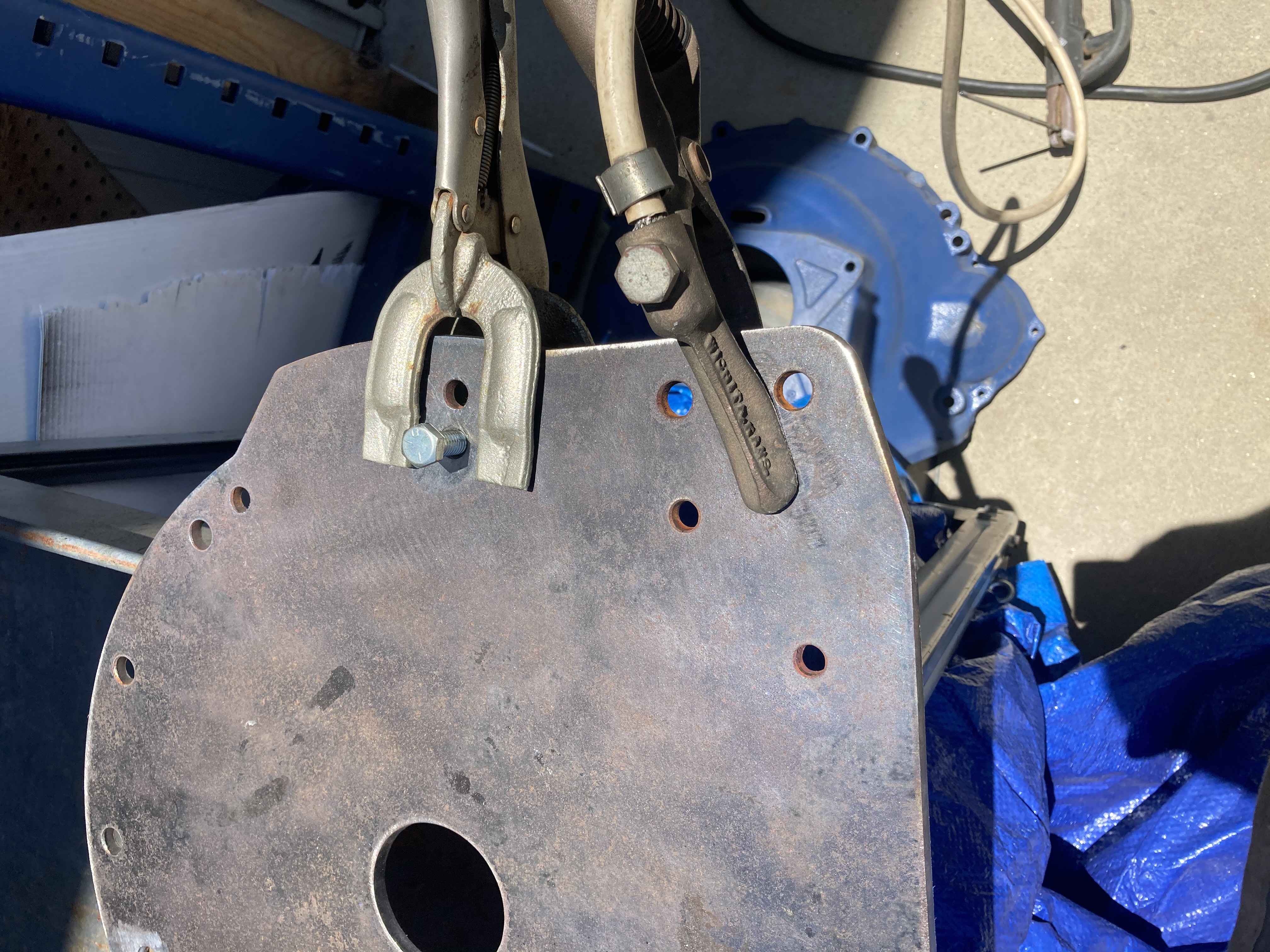

On a positive note, I was able to modify the Lexus transmission mount by cutting off the OEM mounting flanges where the 2 stamped steel parts meet and welding in some flat bar stock.
In the E46, the mount points are higher on the passenger side compared to the driver side and also has a step (not flat) on the passenger side as well. I solved this by cutting the piece off of the original E46 mount, and using it as a spacer.
I also had a friend with a cnc plasma cutter make me the mounting/locking plate for the bell housing, but I didn't get a picture. Gotta drill out the bolt holes to size, and weld in the spline, fabricate some mounts and then I should have the transmission mounted.

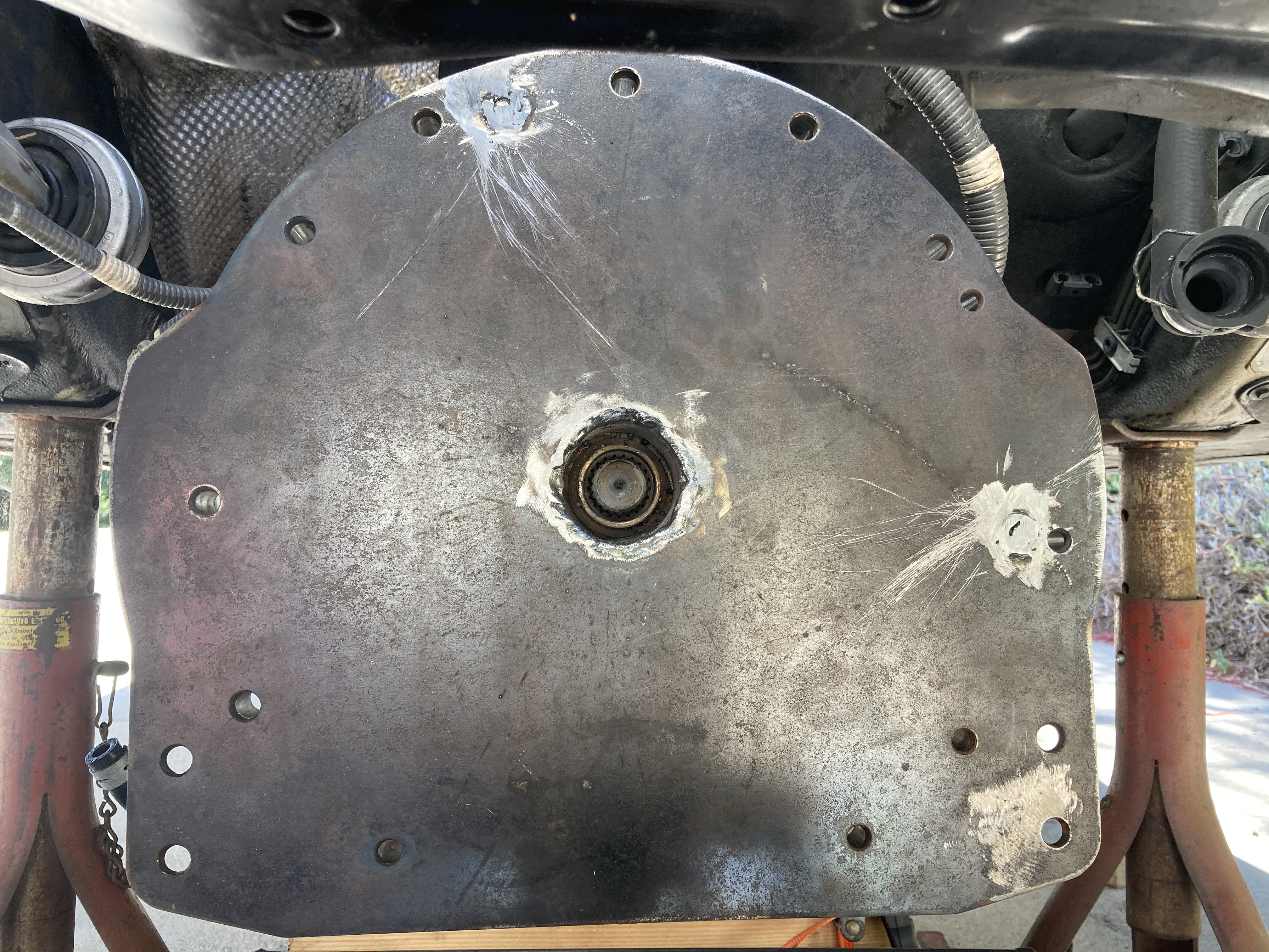

Had a buddy cut out the .dxf file for the transmission adapter plate, and he only charged me $40!! I tossed him an extra $10 for some cutoff scraps for mounting brackets.
Welded on some bolts for location pins, and drilled out the bolt holes to size. Welded the spline to a piece of tubing, clamped everything in place on the transmission and tacked it in place. Then I removed the plate, welded the rest of the spline tube and it's fitting quite nice!
Buuuuuuut, I bolted up the rear transmission mount and realized I mad a mistake somehow in my measurements. The driveshaft is not centered in the tunnel (didn't get a pic), and is maybe around 1/4" shifted to the left. The holes in the transmission mount are already oblong front to back, but I need to shift side to side. I may have to hog them out to get it where I need, then fill the hole with weld. I'm not sure if that will be easier than cutting the plates off and welding on new ones. In order to fill the gaps without filling the hole, I'll need copper backing and a copper rod to keep the welds from sticking where they shouldn't
If I cut off the plates and make new ones, it will probably be best to make the plates with the holes first, bolt them in place, then lift the transmission into place and THEN tack weld the plates to the mount. That way I can make sure everything lines up before finishing the welds...

Not sure if I untherstand correctly but basically one mount is wrong right? One hole will needs to move inwards so can be re-used?
and one outwards.
Always difficult without pictures. I think you can mill/redrill the current mounts. If that results in an unacceptable quality at least you have the models. In the end what keeps de mount from moving is the clamping force of the bolt with washer.
and one outwards.
The whole mount is off-center. The holes align perfectly with the factory locations, but with the transmission mounted in place, the driveshaft is not centered. All holes need to be shifted sideways about 1/4", but the issue is that they're already elongated front to back.EV_Builder wrote: ↑Sat Jul 08, 2023 9:43 pm Not sure if I untherstand correctly but basically one mount is wrong right? One hole will needs to move inwards so can be re-used?
and one outwards.
Hope that makes sense, you can see the picture of the mount a few posts up

Square holes are ok as long as there's enough meat there. Large & thick washers on both sides of the hogged out hole will keep it in place, as long as the washers are thick enough to resist bending.
