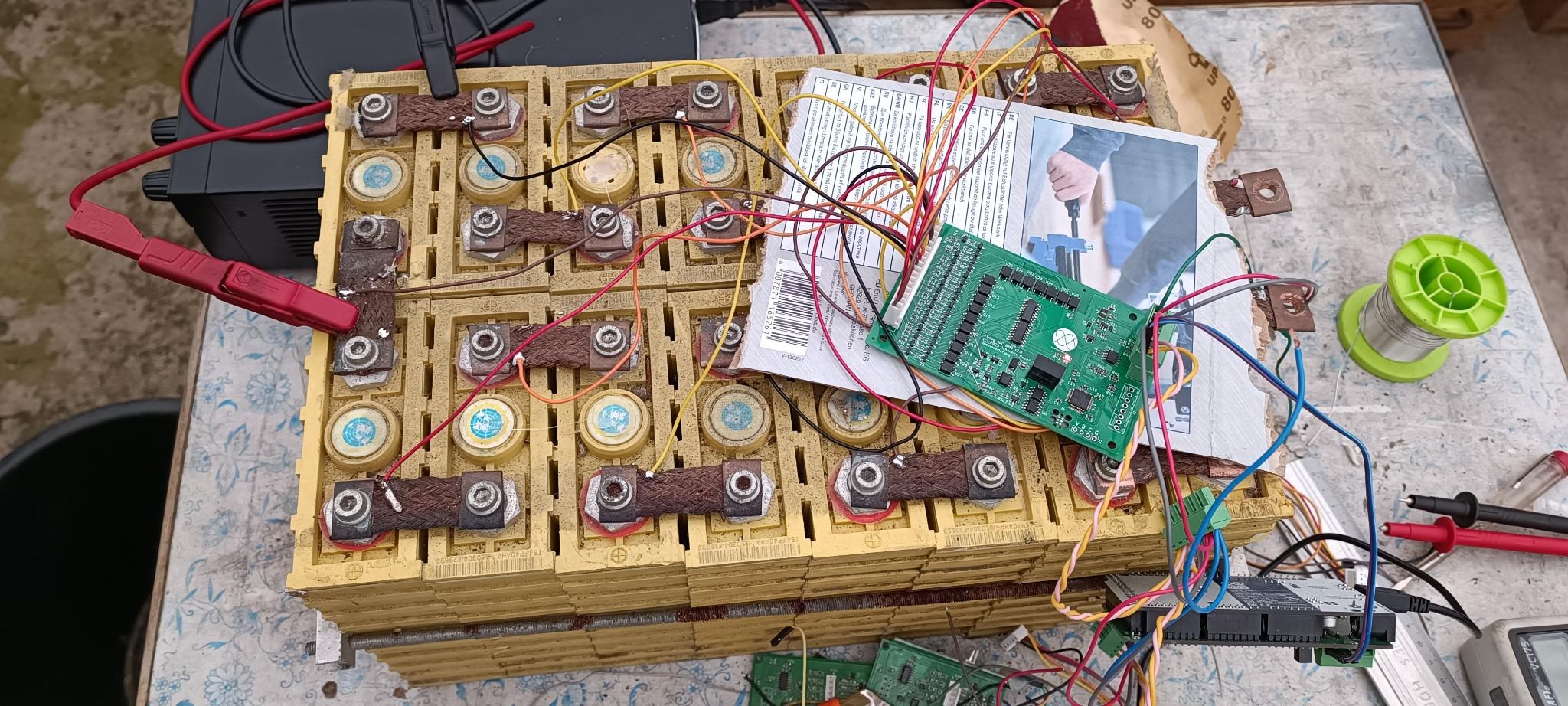

I have received the new boards and hooked one up. Worked out of the box this time.
Next I will assemble a test battery to test two modules in cooperation. The thing that didn't work back in London.
STM32 had a little surprise for me: PB4 is tied to JRST (jtag reset). So you need to turn jtag off. But in order to do that you need to enable the AFIO clock. Took me a few moments to figure out...
