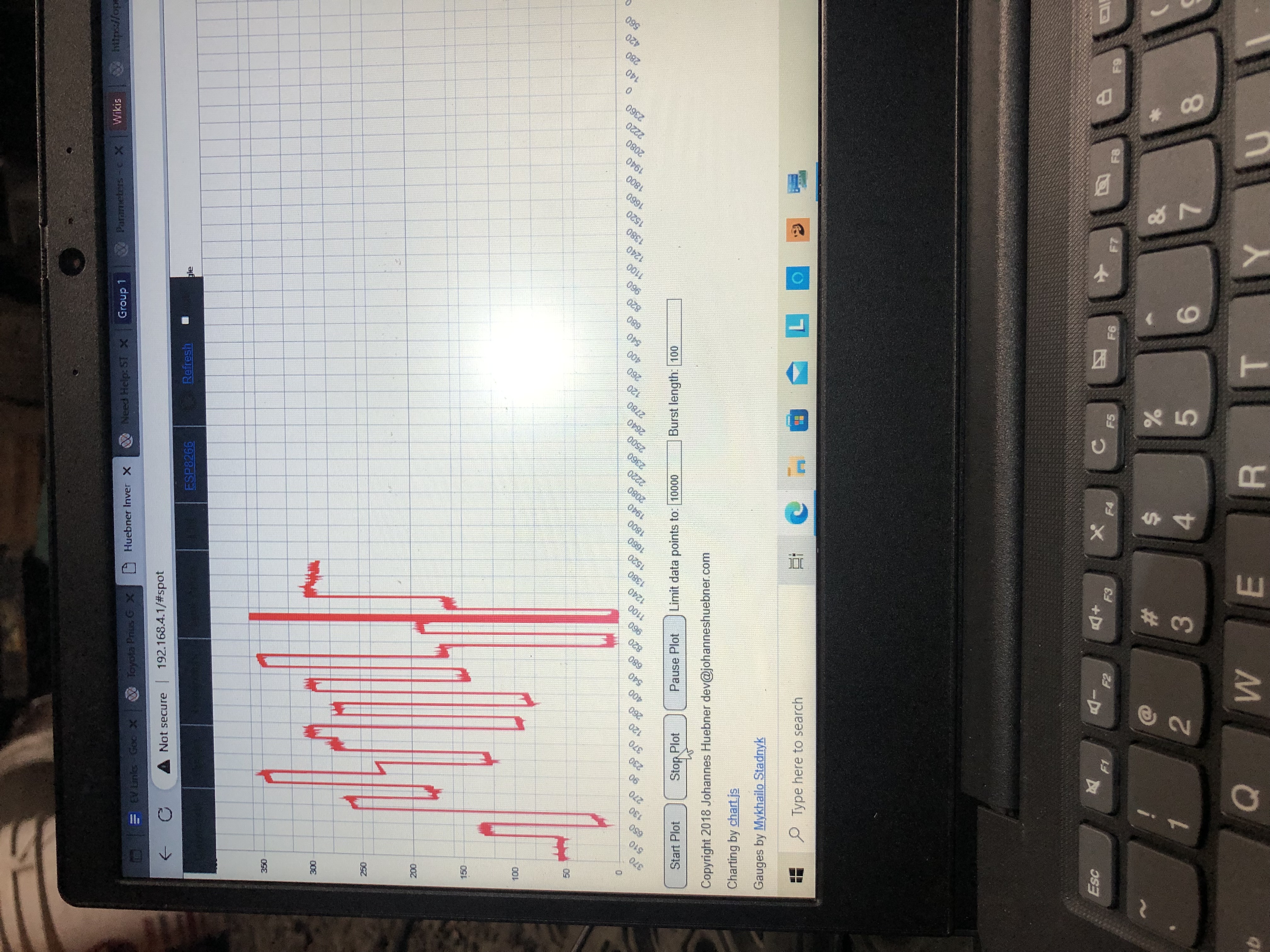

I have recently been trying to get MG2 spinning on my Prius transaxle, but have not been successful for awhile and could use some help. I have a gen 3 prius inverter and transaxle, and am currently trying to get MG2 to spin.
I was able to get it spinning with an open loop test using sine firmware, but using foc firmware I can only get it to make a loud whine with no movement or vibration.

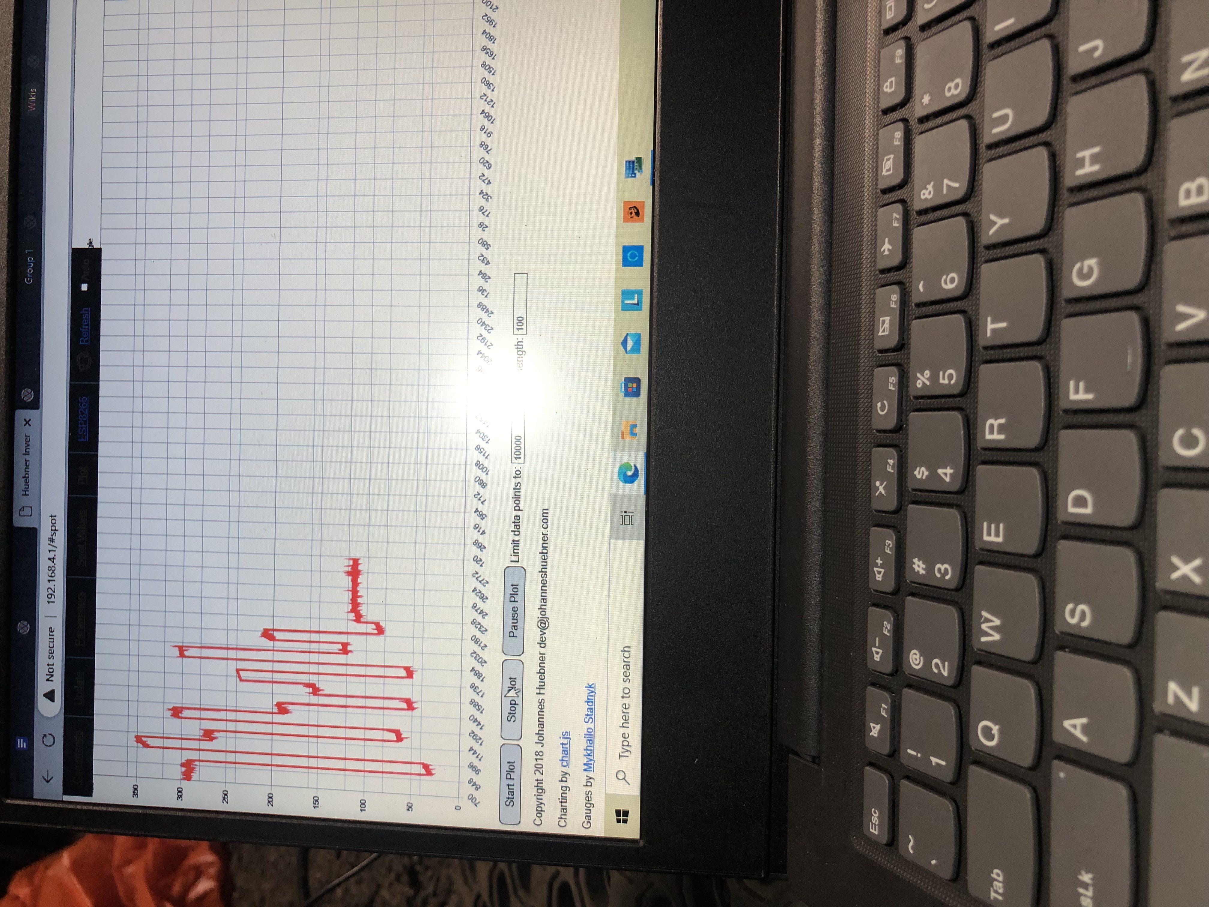

I believe my resolver is connected properly; I get less than 5 degrees of jitter, and when I rotate the motor the plot oscillates between 0 and 360 degrees. I have a welded PSD and so can spin MG2 via the ICE shaft on the side of the transaxle. Here are a few plots of my angle during one full rotation of the motor each: (note data points set to 10000 and length set to 100)

Not too keen on the plot either, I'd prefer to see a ramp (see link above), but it could be due to cogging or a plotting artefact (if the motor moves too fast). Try a 1000point, 1000length plot to see.

Eons later I have returned to this problem and solved it. I did Damien’s resolver test he outlines in his FOC tuning video, and I also realized that I had a value of 10500 for syncoffs, which was good enough to keep my motor from spinning.
