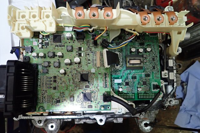

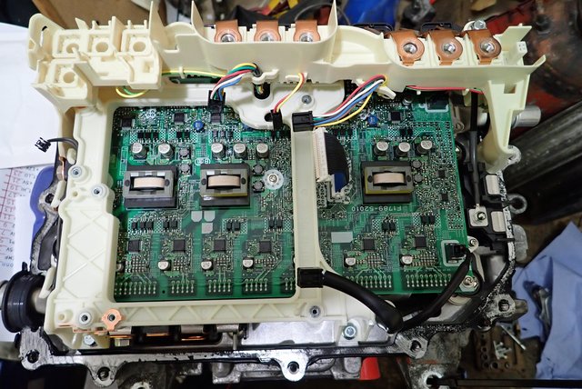

I've taken the plunge and opened the case and thought I'd share the insides.
It looks much the same as the other Toyota inverters which I know is nothing to go on for compatibility but it's a start.

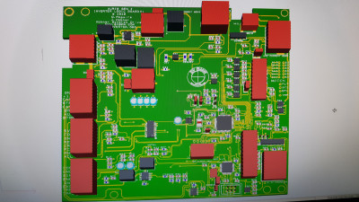

The top control PCB is shorter than the board Damien designed. I'm trying to remember if this has been encountered in different versions on another thread about at Gen 3 inverters but don't have the time to go searching just at the moment.
For reference parts are marked,

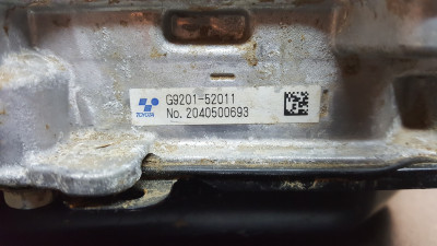

Inverter G9200-52032
Brain PCB F1759-52010
IGBT PCB F1789-52010
The top brain PCB appears to be very similar to the other Toyota Gen 3 inverters however I don't have others to hand for a closer comparison.

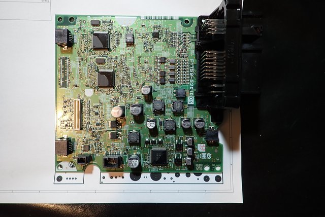

Top PCB removed.
Printout of Damiens Gen 3 PCB (with very bad conversion to Kicad for printing!!)
The PCB is 143mm wide...
Which is clearly a bit shorter than the other models.

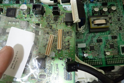

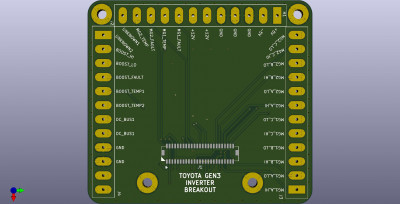

Expecting to do a bit of tinkering I rolled my own breakout board in Kicad and sent it to be made before I noticed that Damiens GIT repository contains the gerbers along with the pinout. At least I enjoy that sort of thing and have a footprint for the 50 pin connector now.
(I'm also going to have to brush up on the etiquette of open source licensing etc before getting it wrong and annoying anyone.)
As none of the usual suspects sell the 50 pin connector I filled in a sample request on the UK JST website and got a free one by return of post but also ordered a few on the slow boat from Aliexpress in China if I'm going to be tinkering with this beast.
I guess it's going to be a couple of weeks before I can start squirting signals into the IGBT board to check if the pinout is actually the same as the Prius Gen3 pinout that has been published. I don't really have the resources to be more experimental than using the pinout signals for the Prius and checking for a PASS / FAIL result on the expected output and being sensible and buffering the input with resistors to avoid damaging anything. The only positive check I've been able to make is confirming all the GND pins match up.

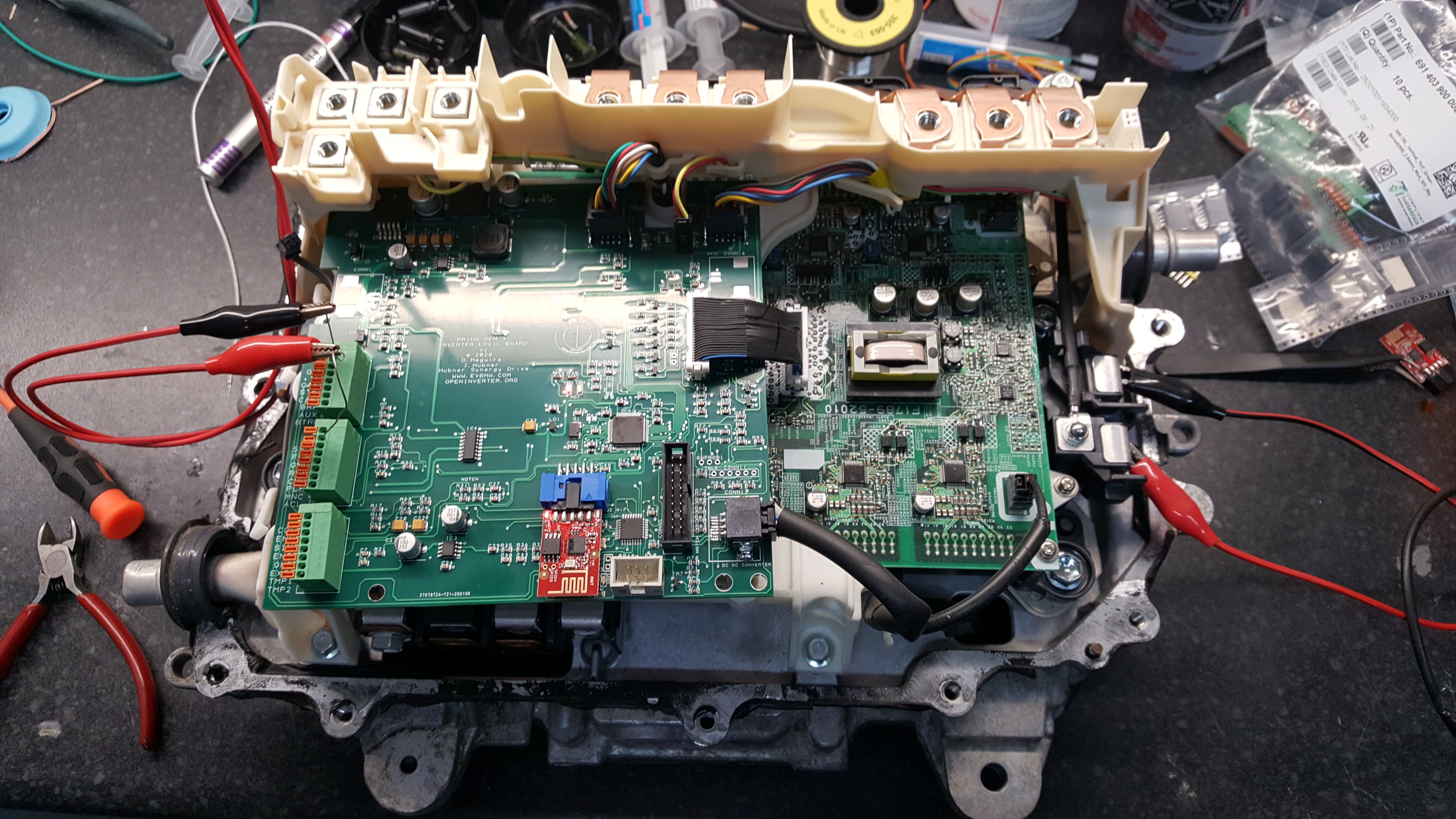

Today's lesson is always listen to Arber:) Seems the pinouts for the 50 way igbt board connector on the Yaris inverter is the same as the Gen 3 prius. As are the current sensors.
Kevin Sharpe

From my own quick research, there seems to have been a variety of part numbers used across different "gen 3" models (Prius/Auris/CT200) over a period of years as the design was iterated very slightly.

I've just put the details of the Yaris inverter I have in a table on the Gen 3 wiki page to hopefully help identifying which ones have the different sized PCBs in them.
https://openinverter.org/wiki/Toyota_Prius_Gen3_Board

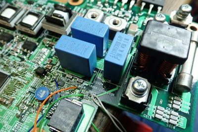

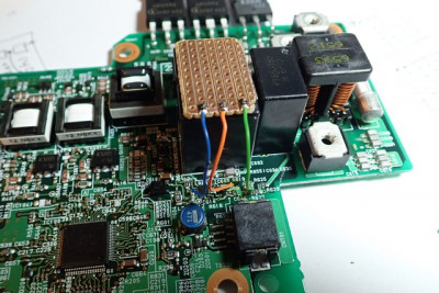

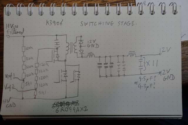

I've just got the 12V DC/DC converter of the Yaris inverter working with an input of 400V DC and also tested the output with a 40-50 Amp load.
I've posted it here as I'm not sure if the Toyota Gen 3 Yaris Inverter DC/DC module is the same as the much more common Toyota Gen 3 Prius one that is the main topic of the Toyota Gen 3 Inverter Hacking thread.
My limited experience of switched mode PSUs is once designed they are often more tolerant of varying input voltage than you would expect especially when being supplied with a higher supply voltage than intended as the control is often more than capable of altering the switching to compensate. For this to be successful the power stage components will need to be capable of working a this higher voltage and the switching mosfets 6R099A and K3906 have maximum voltage of 600V leaving the 1.6uF 250V input capacitors needing to be changed. The SMD capacitors are imposable to identify working voltage so will only get attention if they fail or explode.

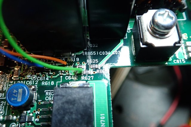

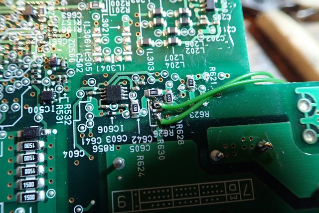

I reverse engineered the HV and output power stages looking for a single feedback point hoping this would be some sort of simple easily hacked Over-Voltage trigger. This was found in the form of a simple resistor divider network that went into what looked like an op-amp or similar before being optically signalled to the control chip on the low voltage side of the circuit. As this was the only link between the HV and LV stages of the DC/DC converter I stopped reverse engineering it any further.
Once this resistor divider network was identified I noted the feedback voltage at the normal point of shut-down of 235V and used it to calculate a resistor divider value for a new slightly higher shut-down voltage of 280V to test the concept. After this test was complete I replaced the capacitors and repeated it with a resistor divider to shut down at 400V and after this was proven to work loading it with 40-50 Amps using some cheap diesel engine glow plugs to prove it was actually working. The output voltage of the variac and possibly the ripple on the smoothing capacitor caused the DC voltage to droop when loading the DC/DC converter but it's all I have to power it with at the moment.
I took a few photos and made a rambling video about what I was trying to do.

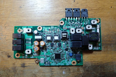

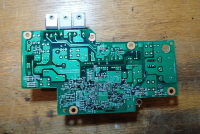

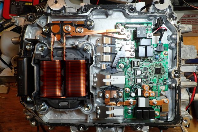

The full DC/DC module. Held in place by many screws.
Front of PCB.
Back of PCB.
Feedback voltage breakout test board.
Front SMD resistor replaced with breakout wires
Rear SMD resistor replaced with breakout wires

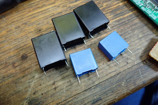

Replacement Capacitors.
Replacement capacitors in place.

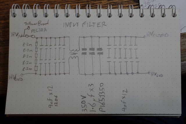

Input filter stage.
HV power stage and and 12V output + filter.

It's part of the inverter assembly. Under the bottom cover next to the boost inductor.

I just opened up a Prius C inverter (G9201-52012 on case, F1759-52010 control board, F1789-52010 power board) and the DC bus caps are 775uF 650V for the high side and 315uF 300V for the low side. The inductor is 235uH. For my application (home PV inverter), I'll be controlling it with a FPGA.
I'm surprised the DC/DC uses an active clamp forward topology, most PC power supplies (which are very similar) above 700W or so use a full bridge topology.
