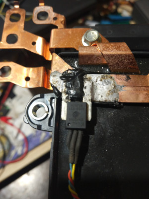

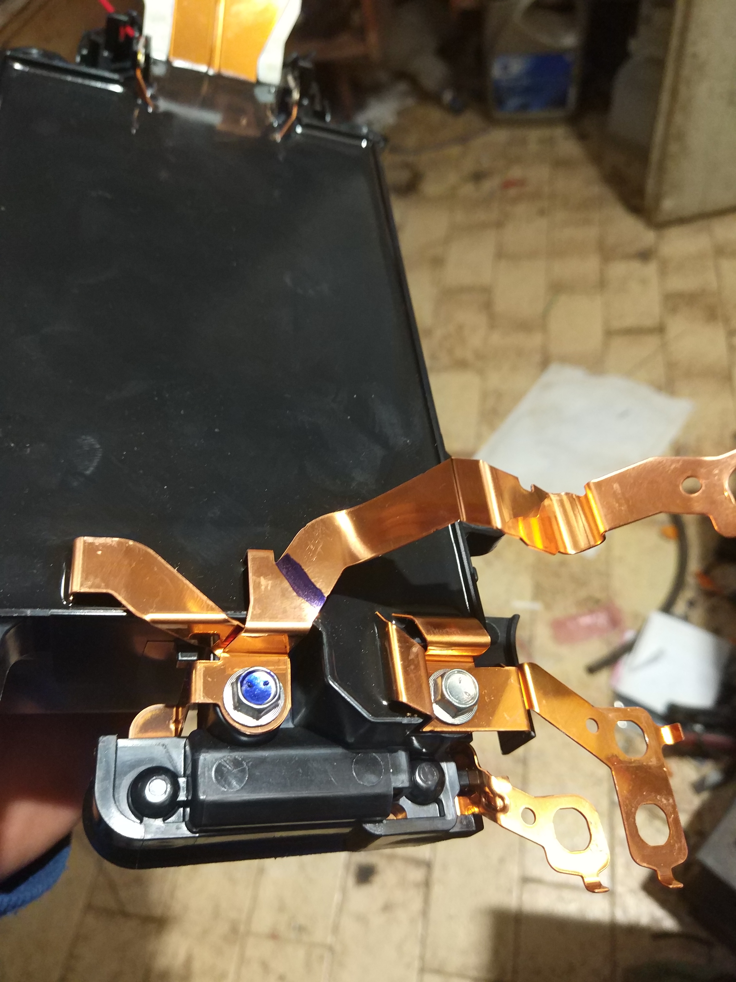

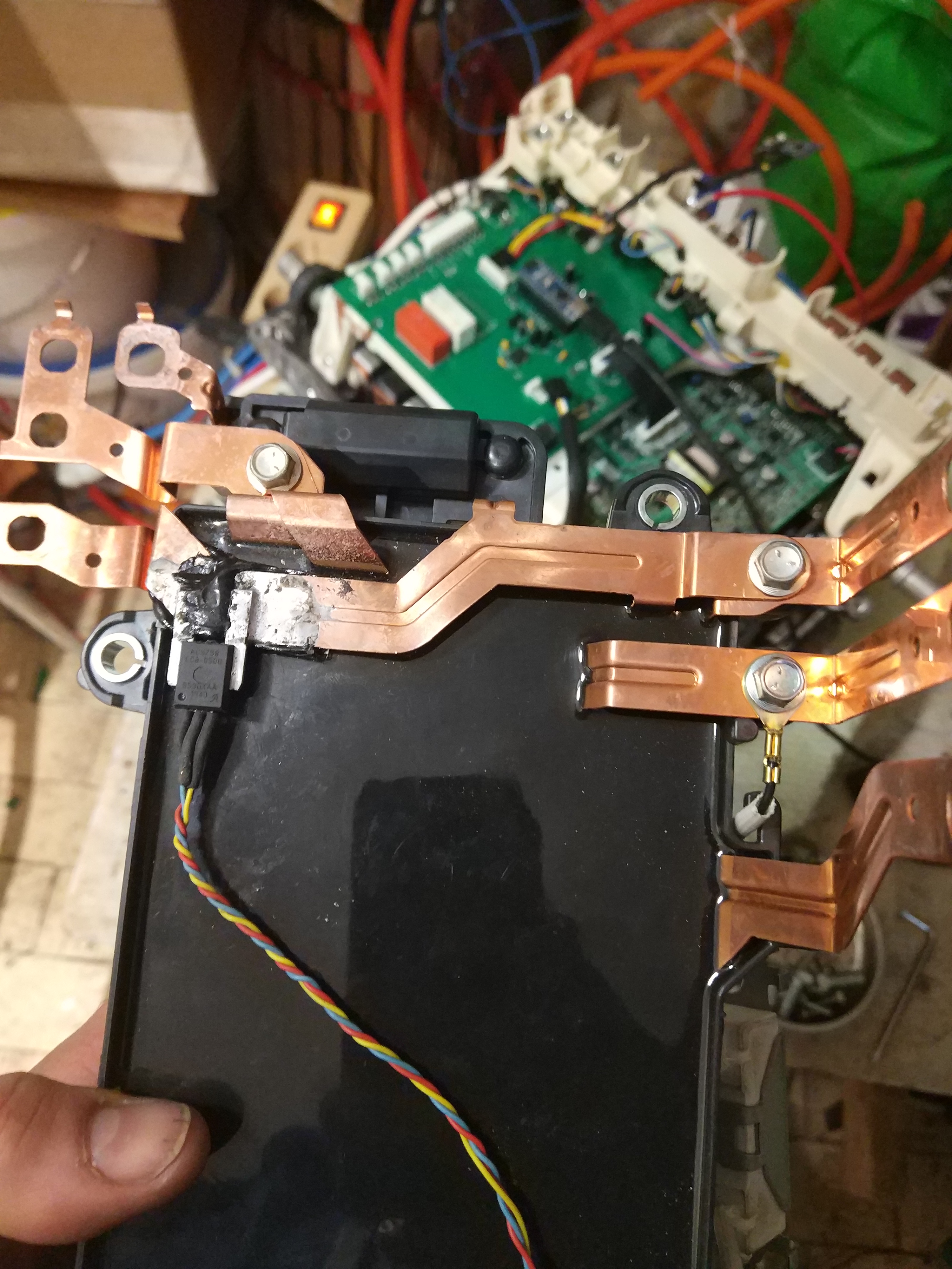

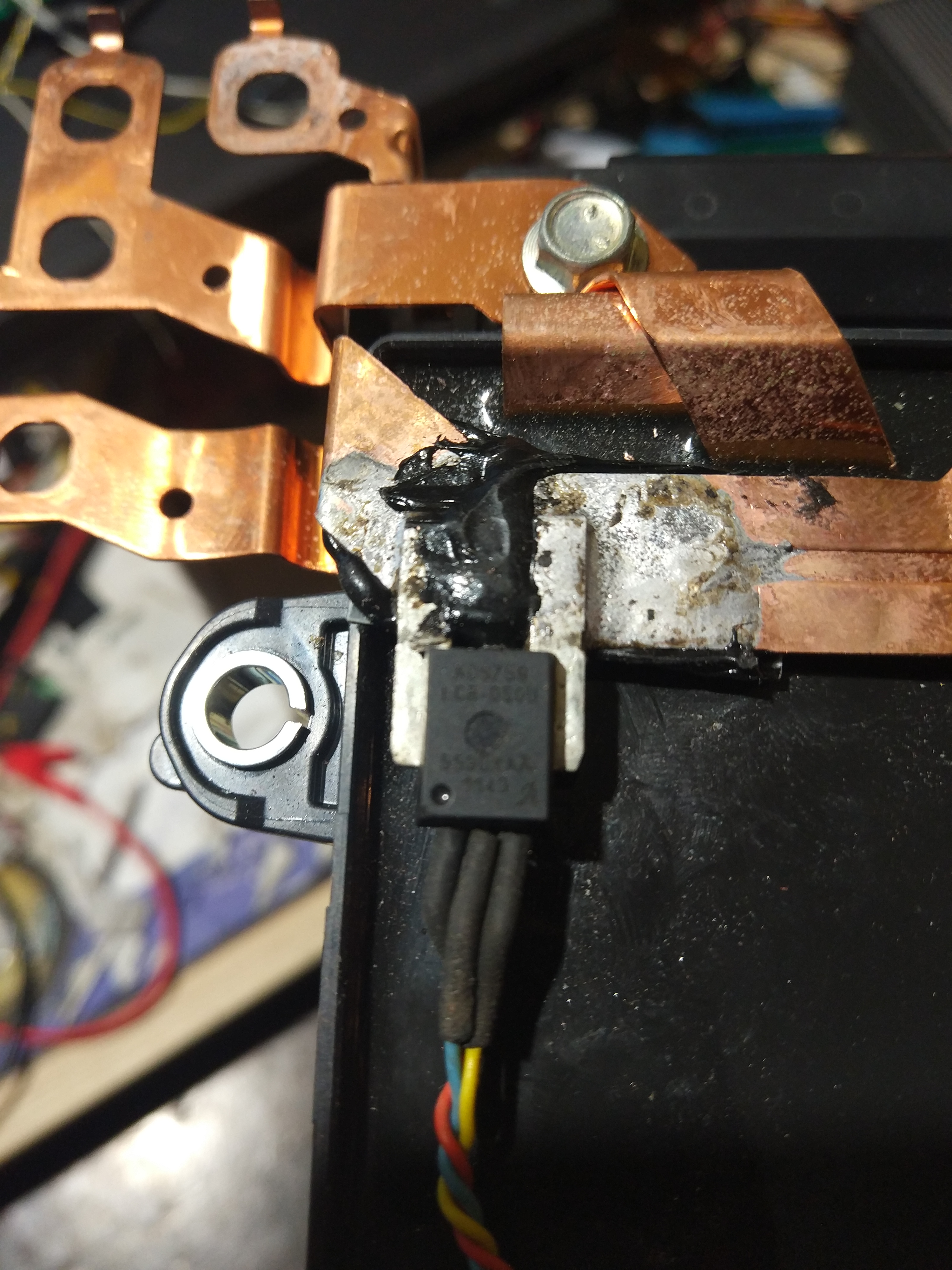

I succesfully connected battery and mains together to Prius inverter with my interface. Both voltage readout and reporting works through UART.
I made a simple current sensor setup. I soldered my 50A sensor to positive rail and then cut this rail and glued an isolated material underside it. Current sensor reporting works, i tested it with 12V 25A load.
I was not succesful in ordering charger to start providing 5A to 280Vdc battery from 320V rectified mains. I think i have setup my interface with too many safeties. One of them (UVLO) is acting up.
EDIT1: DOH! it is really simple. Charger doesnt work because i didnt connect BMS and EOC pins in a loop. This loop needs to be connected in order for the charger to work. Very simple BMS can be used with this loop.
EDIT2: I also noticed -5 voltage regulator is used to provide reference to HV side voltage reporting. Battery side voltage can work with regular 5Vdc.

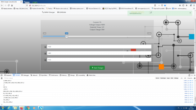

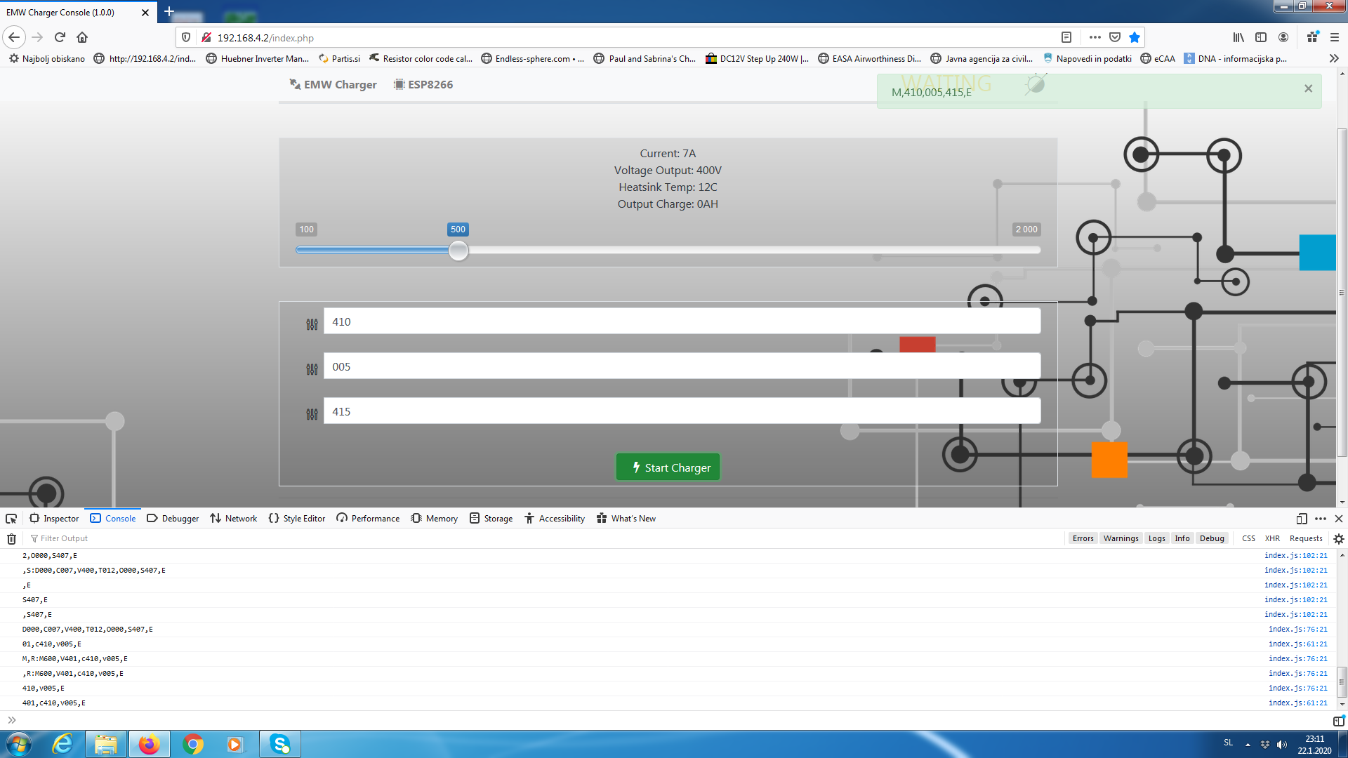

I must thank to Dima and Johannes for their intervention at my feeble attempts to reprogramm Wifi module.
I had a clear vision of my goal, just not the skill to get it.
In the end Dima presented a solution which looks good and works good enough to be used on working charger as well as in development.
https://github.com/dimecho/ESP8266-EMW-Charger There are some bugs to iron out still, but i used it today and i must say i went to drive my car just to spend kWh to see how it will charge.
Actually i will append flash code and spiff files here since they are the ones that work best.
When charger is connected it will start spitting serial data. We use that data o find out its parameters.
Also a serial string is used to command charger how much Amps at which Volts to charge.
There is a STOP button and START button.
This can be used on mobile, laptop or PC regardless of software platform...

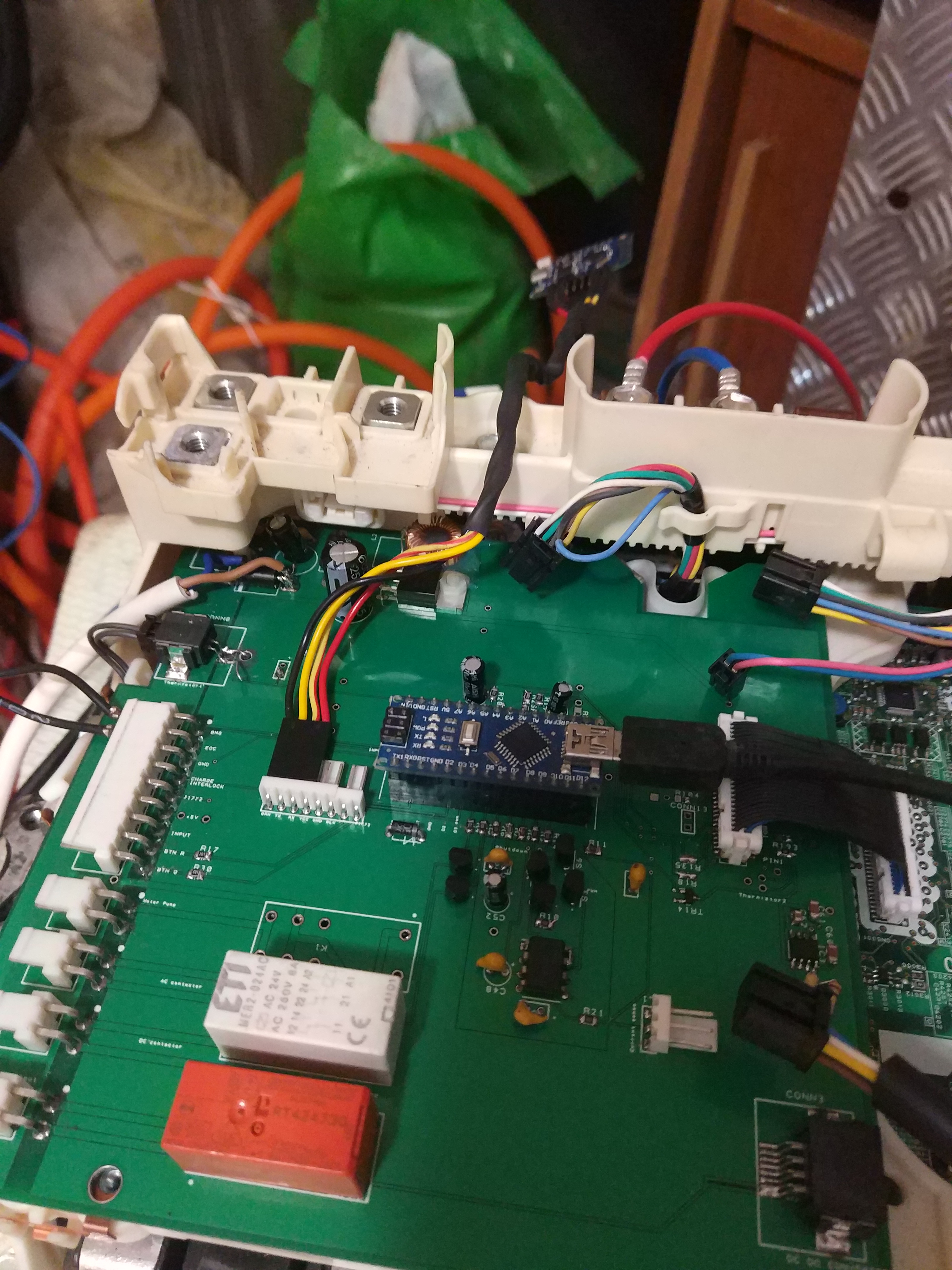

JB i strongly suggest to review your Prius inverter design and its Atmega 328 chip pinout.
EMW charger uses exactly the same chip and is actually proven to work. Now we also got a working interface so we do not depend on the expensive uLCD and buttons on wires.
General schematics of V14 unit is appended. Also a review of serial comms. And finally the code.
It is fully PID control loop so current swings are measured in 0.1A!
Though original resistor divider sensing precision leaves something to be desired but Prius code sends stable signal all the way to 400Vdc!

For what it's worth, in my total hack of an implementation I'm using the atmega328 PB2/OC1B pin (arduino pin 10) as boost high side PWM output and low side would be PB1/OC1A (arduino pin 9) if I were to use low side. Timer 1 is a nice oscillator with lots of options for this purpose.
My ADC inputs from the inverter are as follows. These are Arduino pin names which translate to the atmega328 PC0...PC5, A6 and A7 pins:
- A0: DCBUS1 (output side, i.e. where the battery in a Prius is)
- A1: DCBUS2 (input side, i.e. MG1/MG2 HV rail)
- A2: Not in ADC use
- A3: MG2 L1 current (10k/10k resistor divider)
- A4: MG2 L2 current (10k/10k resistor divider)
- A5: BOOST T1
- A6: BOOST T2
- A7: COOLANT T
In my design all the remaining pins are used for CANbus module SPI, EVSE PWM input/output and main + precharge contactor output (to precharge the charger input HV rail).
Actually I'm using another atmega328 on SPI bus to read EVSE PWM and UI buttons as the main chip is too busy talking CHAdeMO
but with tighter code and no CHAdeMO output that shouldn't be necessary.
Current control is rough as current is measured only at the input side, but this does work when you don't want to add any special components.
Controlling the boost converter with PWM synchronized ADC and canbus communication does keep the 8-bit chip quite busy and it also eats all the pins, maybe something more powerful like the STM32 would be a better idea.

Re: Toyota Gen 3 inverter charger
I am not inclined of using Prius current sensors for charger function. It is on the wrong side and the mechanism which would control output definitely has some phase shift. Not a good idea anyways also for CAN control.
My application is designed around ACS758LCB-100U sensor. I am sure we wont need more
What i did is solder the ACS758LCB-100U onto the positive battery track of large cap and then used dremel cutter to cut the track between sensor prongs. Then i reinforced the joint with some PCB plastic sheet and generous ammount of gasket sealant. Sealant hardens and provides good adhesion to reinforce soldered track against vibration. Charger board design includes space for 3x relays. One AC/DC relay, one liquid pump relay and enable relay for DCDC part and interlock function. This means if i have connected charger then car wont drive as well as charger wont function if car is started. Another option would be to cut/remove the positive track from the cap and use a 10mm2 cable and 100A rated 5V hall current sensor. It would require some calibration in software but would maybe be cleaner installation. See here how i would cut positive track from Yaris cap and install cable from that bolt to positive battery connection. Current sensor could be some 100A LEM on the side.
