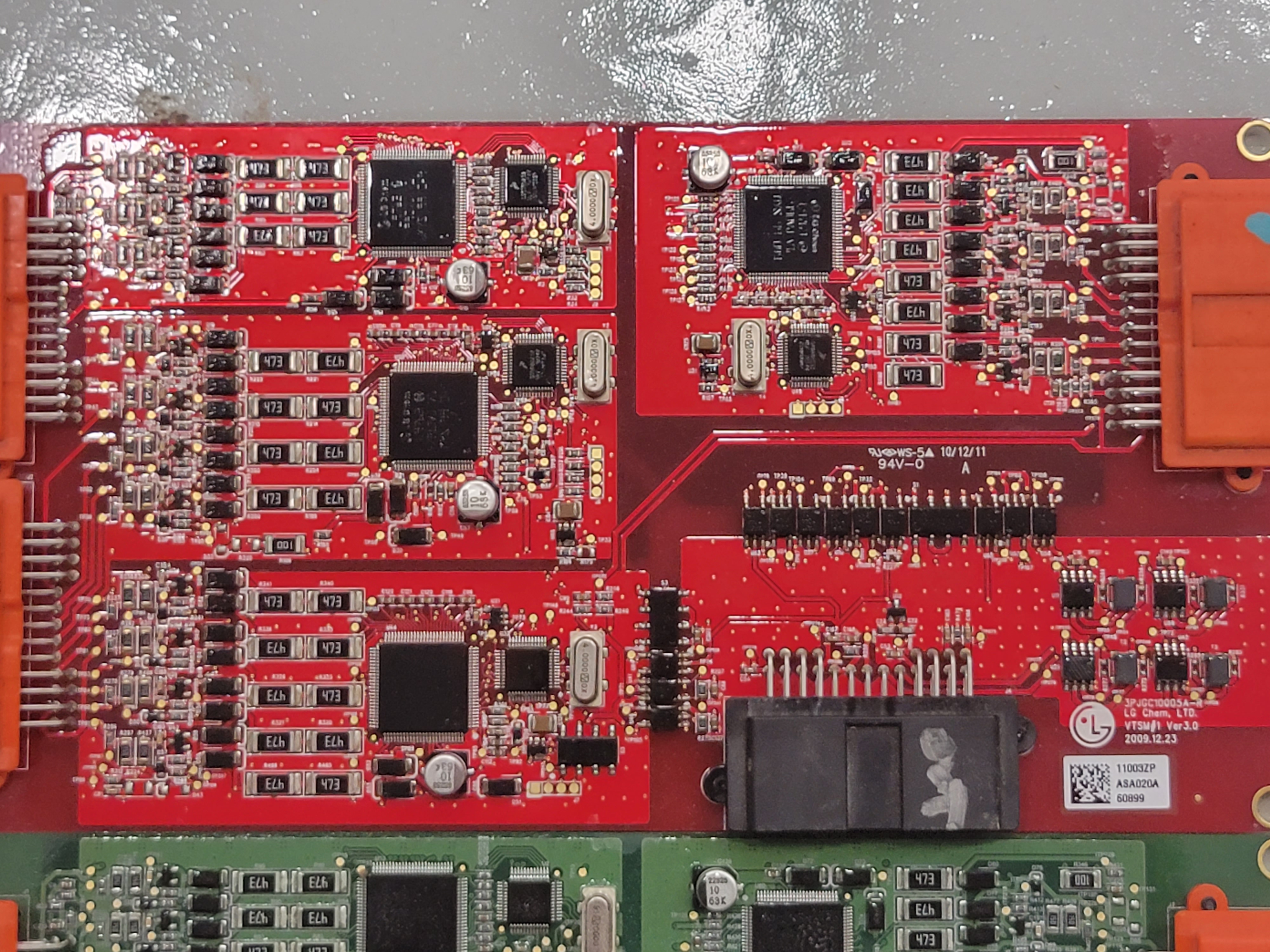

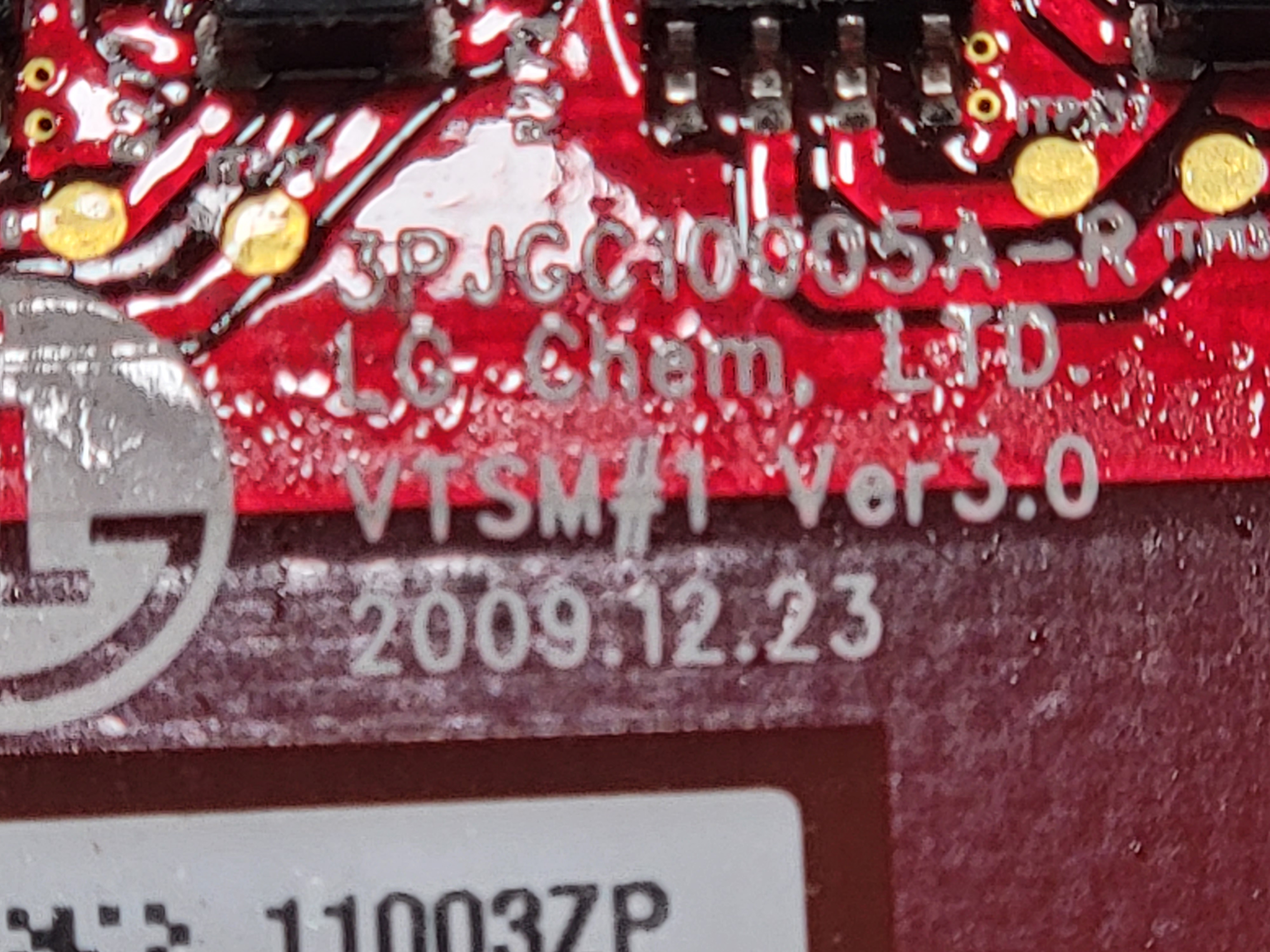

Edit: I'm actually not sure which gen I have now. The red board (which works fine and I assumed was gen2) is dated 12/23/2009 and the green boards (the ones they don't work) are 04/08/2011. So the 2011 ones could be possibly be post 2012 model year.

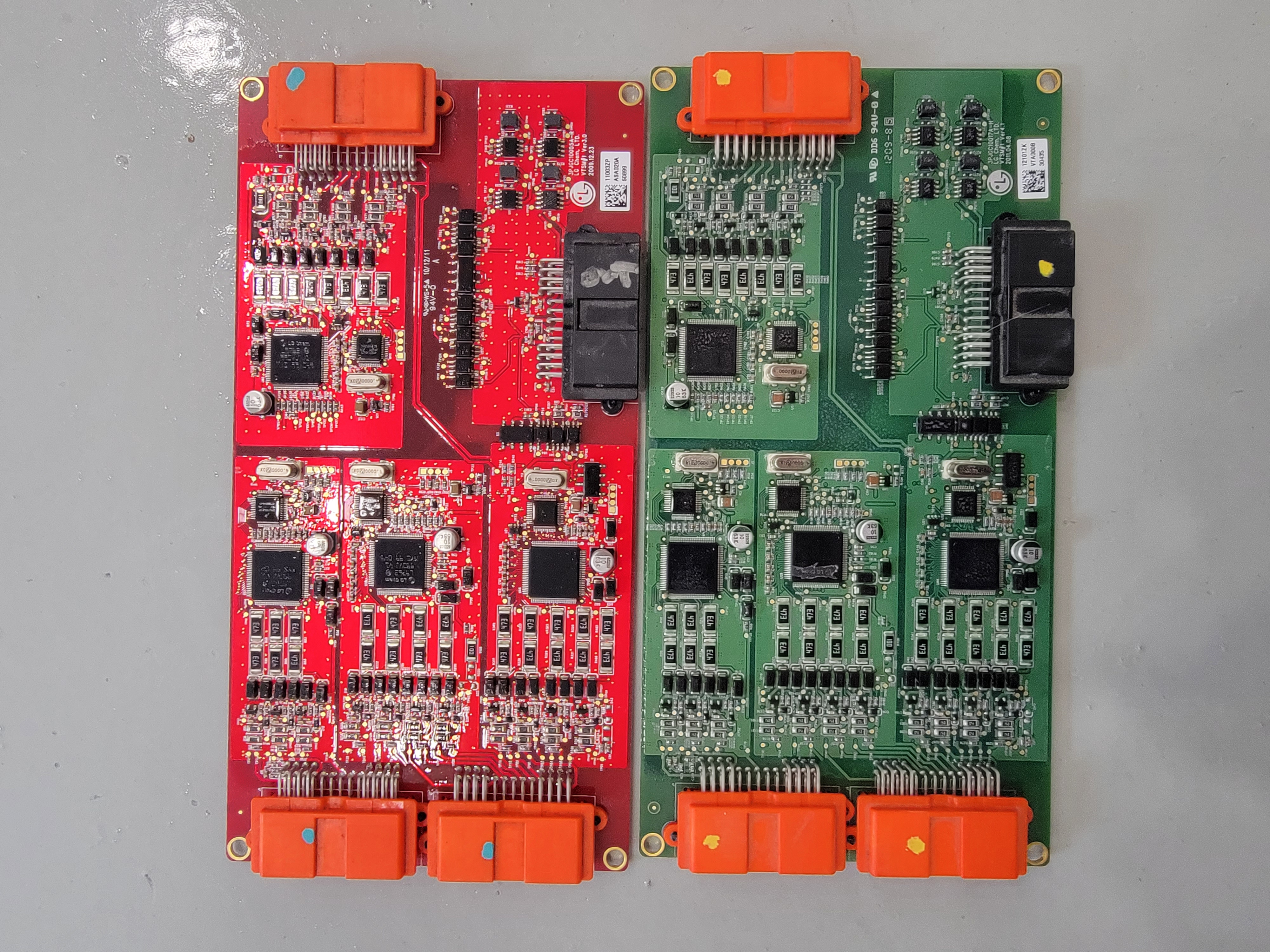

KimchiKimKim wrote: Wed May 31, 2023 2:09 am Are you sure you are working with gen 2 BMS? I'm pretty sure that BMS isn't distributed. Can you add some pictures of your test setup?
I'm not sure actually. Here's photos of the two boards. My test setup is just my VCU wired directly to 1 slave instead of the whole set of slaves so I can try 1 at a time. I have a can sniffer that says the VCU is sending the right messages. It's also reading the cell values perfectly fine from each board, but only the red board will balance.
Looking at the dates on the pcbs, it's possible that the 2011 dated ones could be post 2012.
I may have my nomenclature messed up, I considered pre-2012 as gen1 and post-2012 as gen2 based on battery size and how salvage yards separate those years.

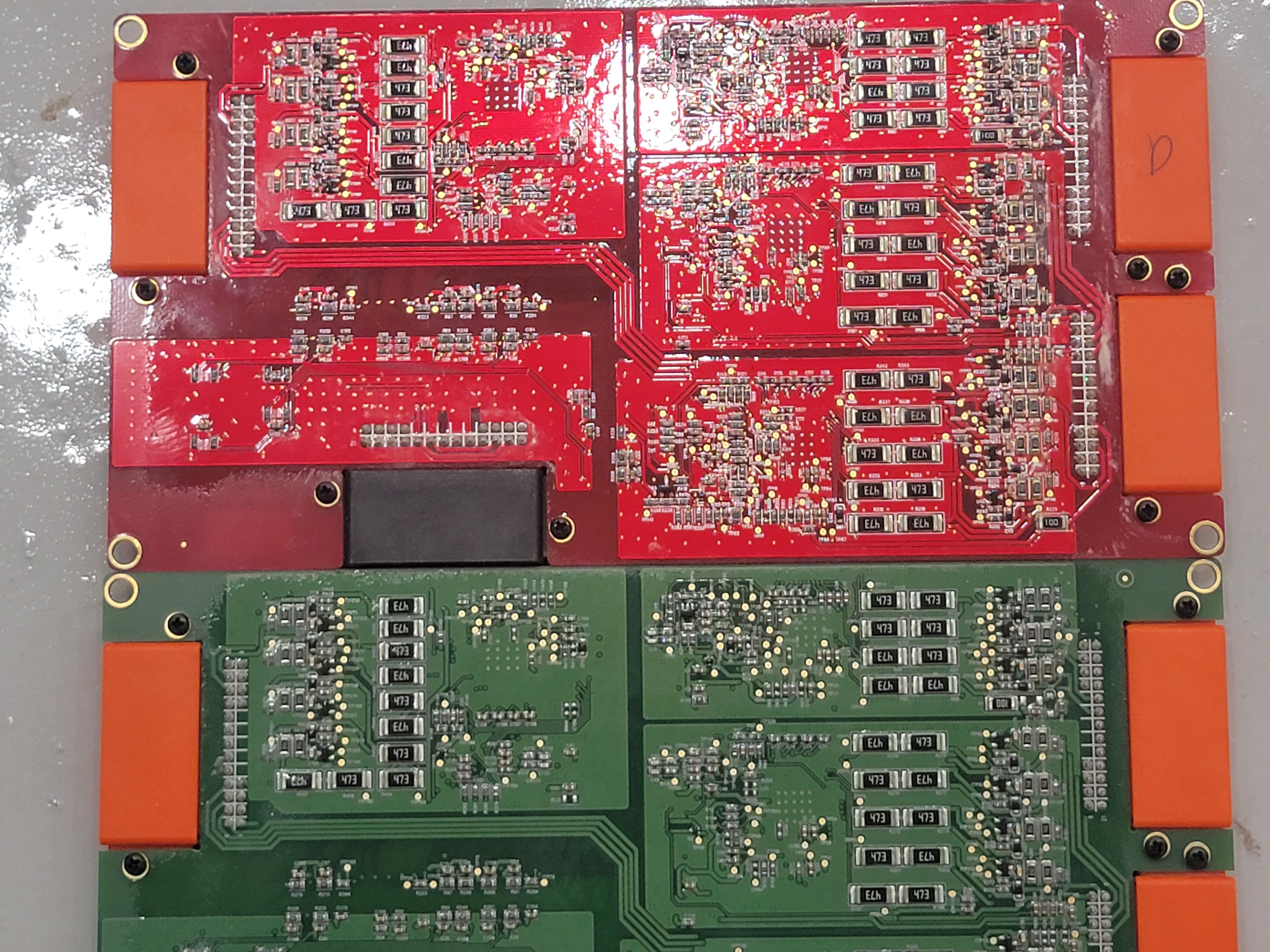

As far as the traces on the pcbs? They appear identical, just different colors. As far as the slave wiring itself I don't really have a way to look. The red slave that came on the spare battery I bought was missing all the wiring so I have nothing to compare to. The connections on the top of the battery look the same.
The part that isn't making any sense to me, is all 6 slaves that came on the batteries communicate cell values fine (Which tells me I have the 5v, Ground, and can-bus wired correctly?), but wont balance. The one red board from an unknown pack I can swap in (like I use the wiring from the green ones and just plug it into the red one) and it will communicate fine AND balance.
