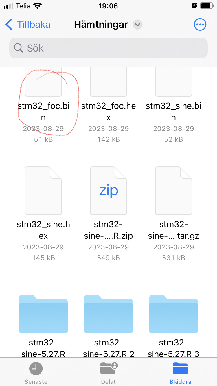

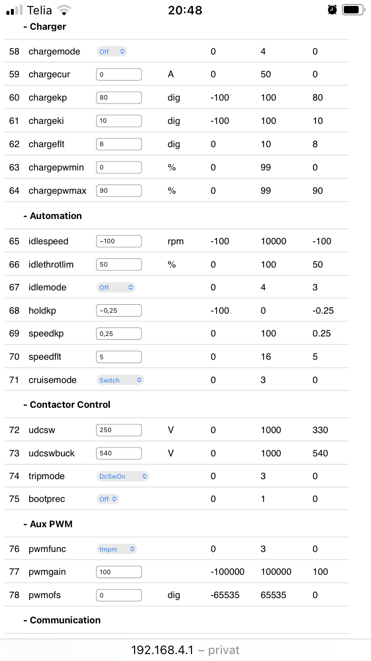

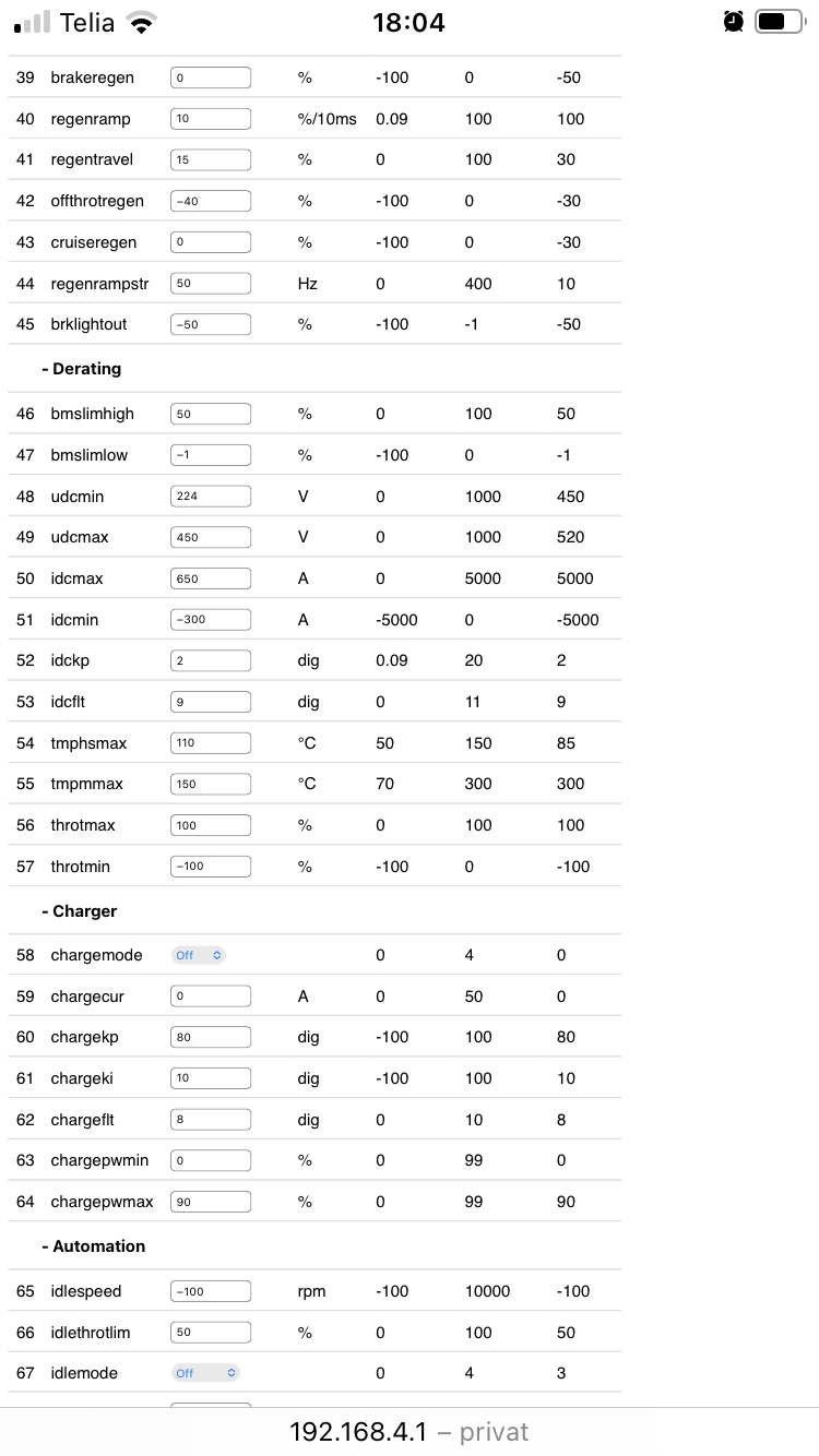

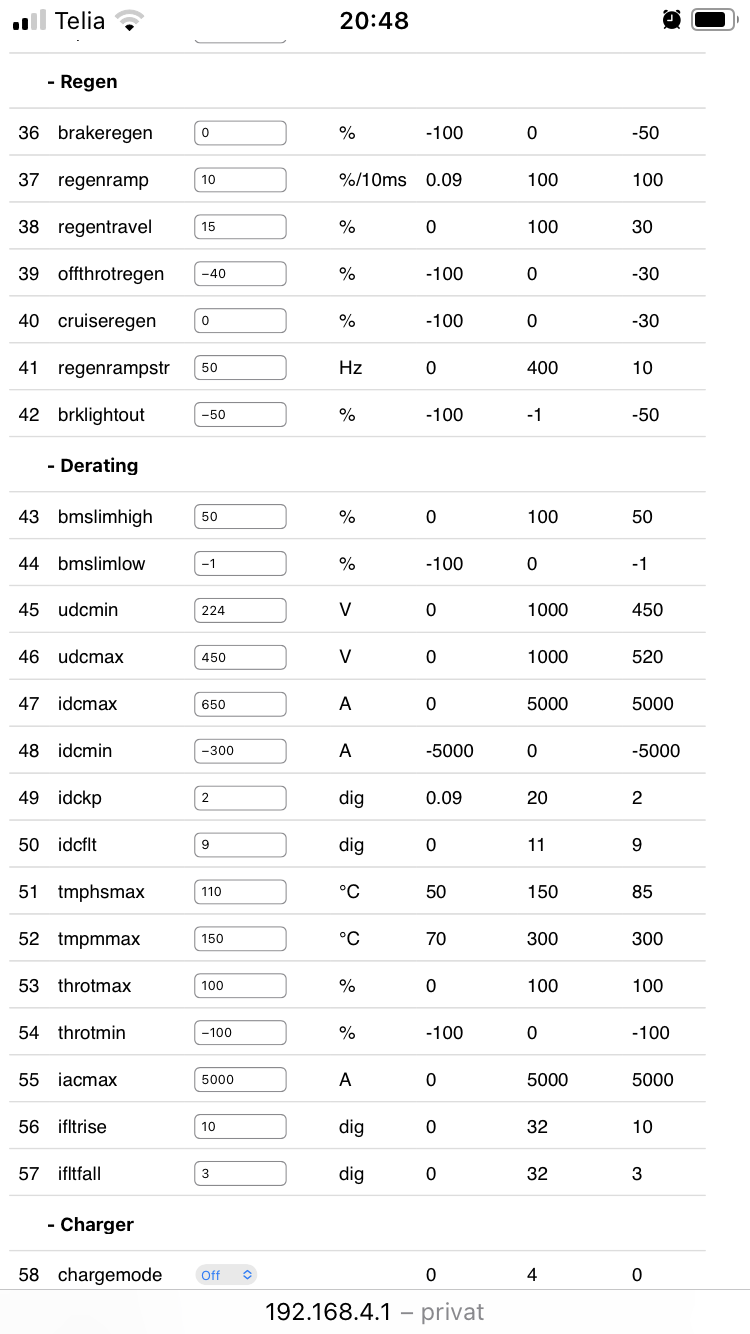

Audia2electric
Posts: 8
Joined: Mon Jul 31, 2023 5:08 pm
Re: Inverter Firmware 5.27.R
Post by Audia2electric »

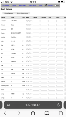

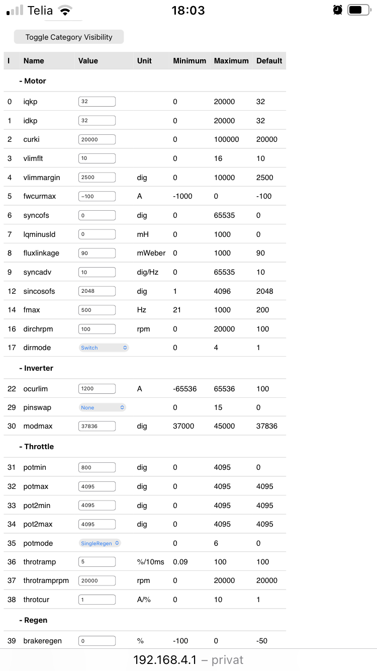

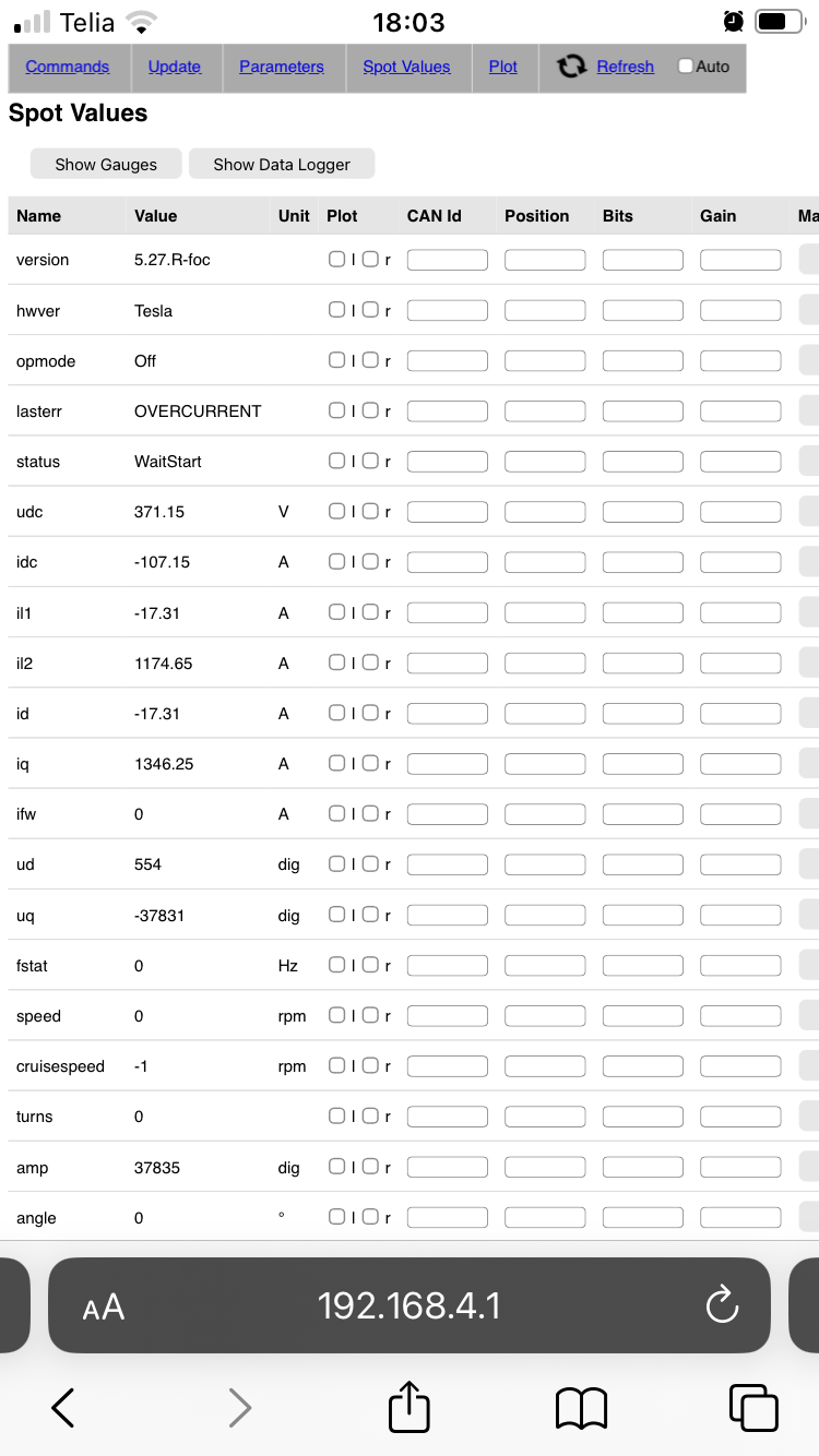

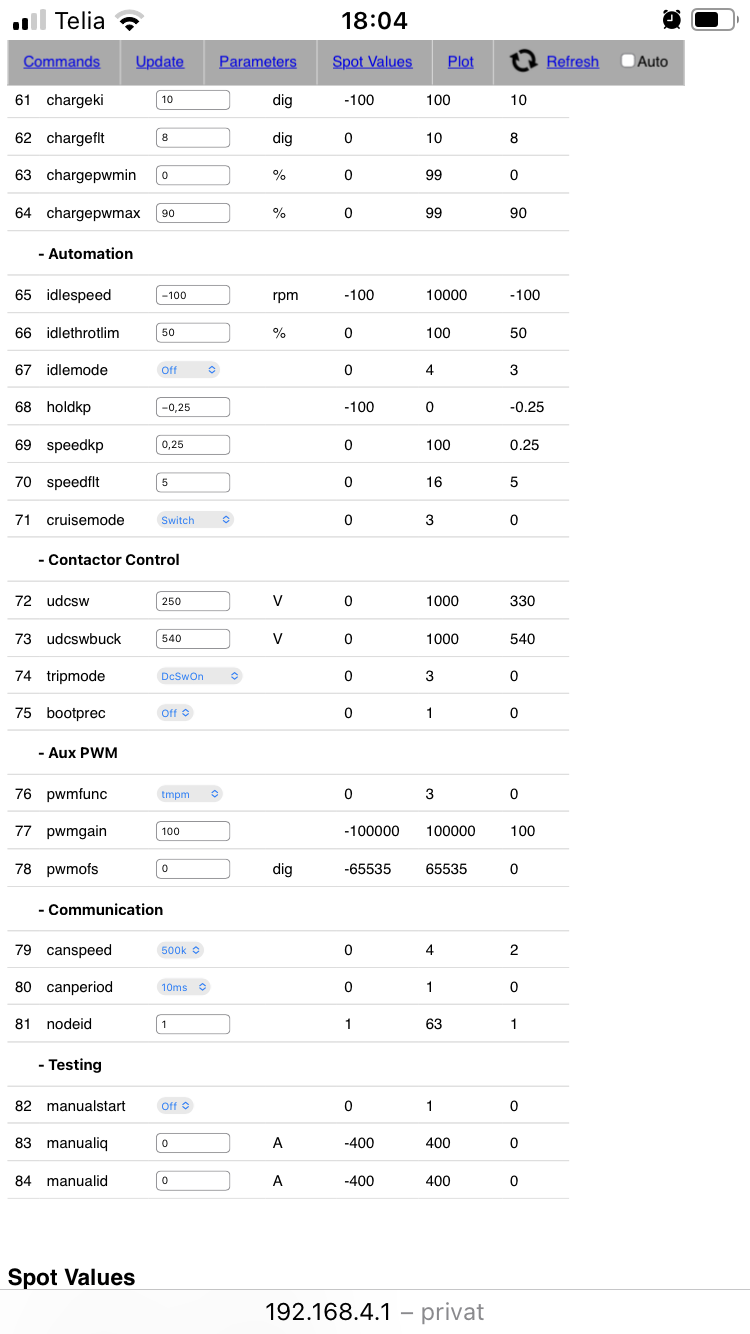

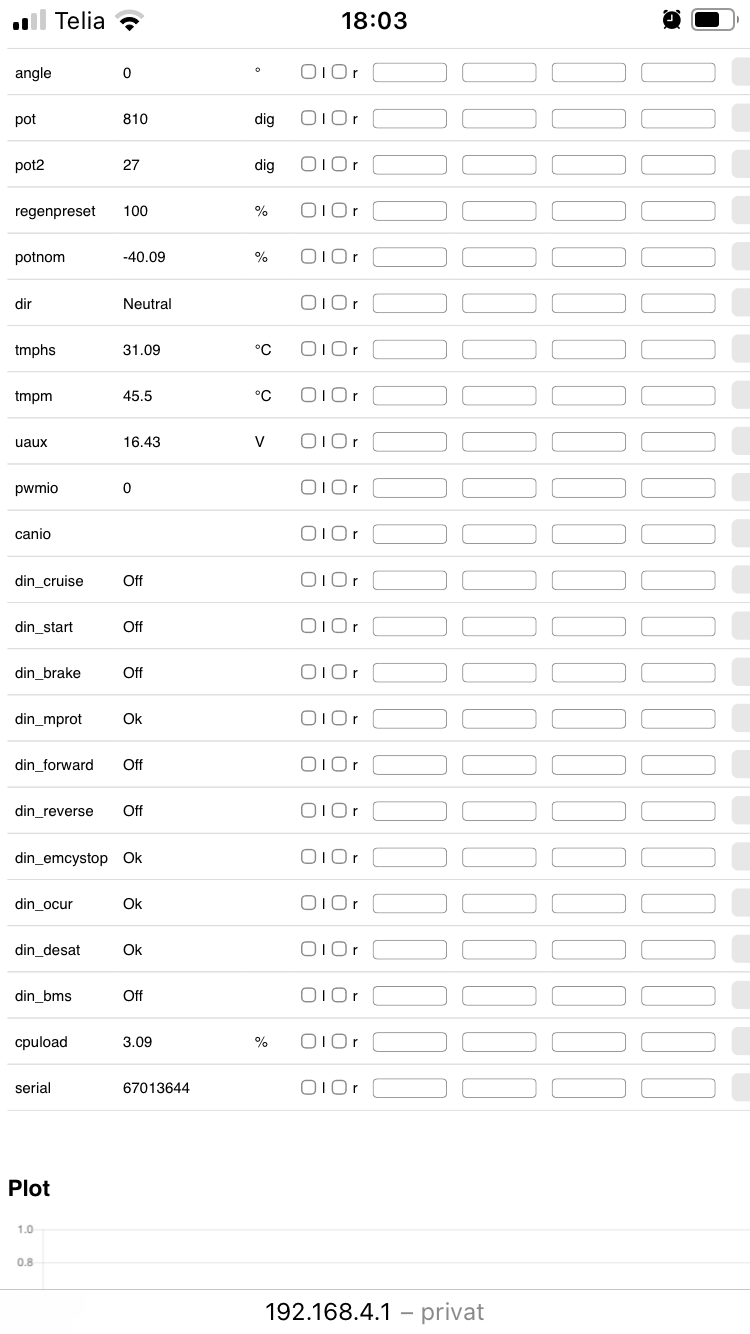

Help!
5.27 uploaded to v.6 tesla sdu board. Before upload (5.20) I also activated hillhold and changed idlethrottlim from 50 to 60. After cycle off/on my parameter set is different…I dont have parameterset started with -Motor->
0 boost
1 tweak
As soon as I activate drive inverter clicks and overcurrent is present. Have I uploaded wrong file? see attached..
Returning from hillhold and idlethtrottle don’t help!
Just got car running again with proper coolant flow and pump…shouldnt mess with working system😕
Romale
Posts: 530
Location: Romania
Has thanked: 315 times
Been thanked: 81 times
Post by Romale »
Audia2electric wrote: Mon Sep 04, 2023 5:26 pm Help!
you made a gross mistake and flashed the firmware from the synchronous motor into the asynchronous)) download and update to the firmware marked sine!
evil neodymium :twisted:

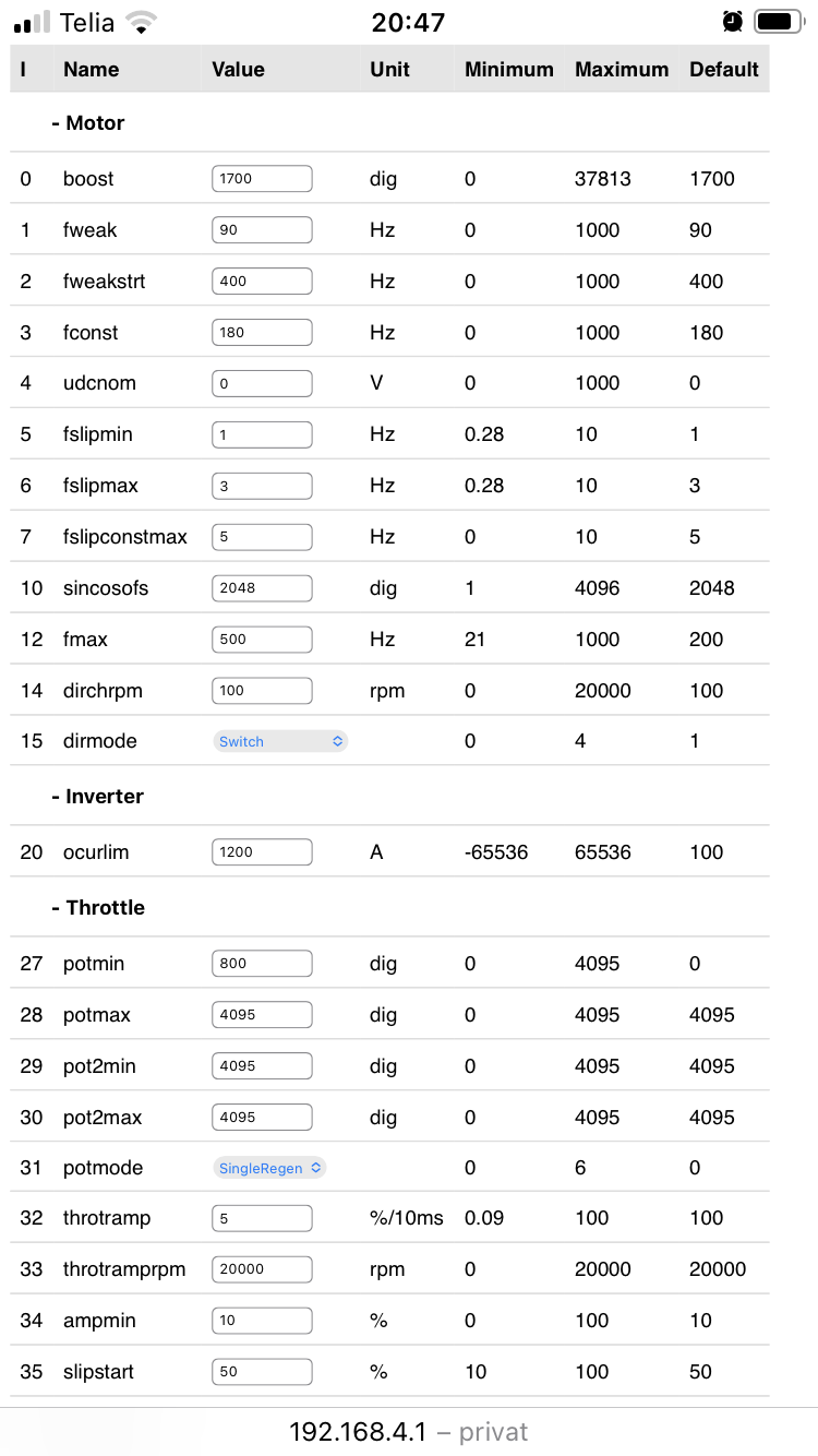

Audia2electric
Posts: 8
Thanks! Prblm solved! Changed to sin file. Testrun showed very smooth in low acceleration but cutoff probably overcurrent not letting me go hard on throttle. Changed back to 5.20
Any parameter changes needed to be able to run 5.27?

Audia2electric wrote: Mon Sep 04, 2023 8:21 pm Thanks! Prblm solved! Changed to sin file. Testrun showed very smooth in low acceleration but cutoff probably overcurrent not letting me go hard on throttle. Changed back to 5.20
The immediate problem here is that your fweak value is much too low. Lower fweak = more current. For reference, here is my SDU tune:
boost = 3200
fweak = 230
fslipmin=1.5
fslipmax = 3.0
fslipconstmax = 3.0
Increase fweak to 250 and go from there.
