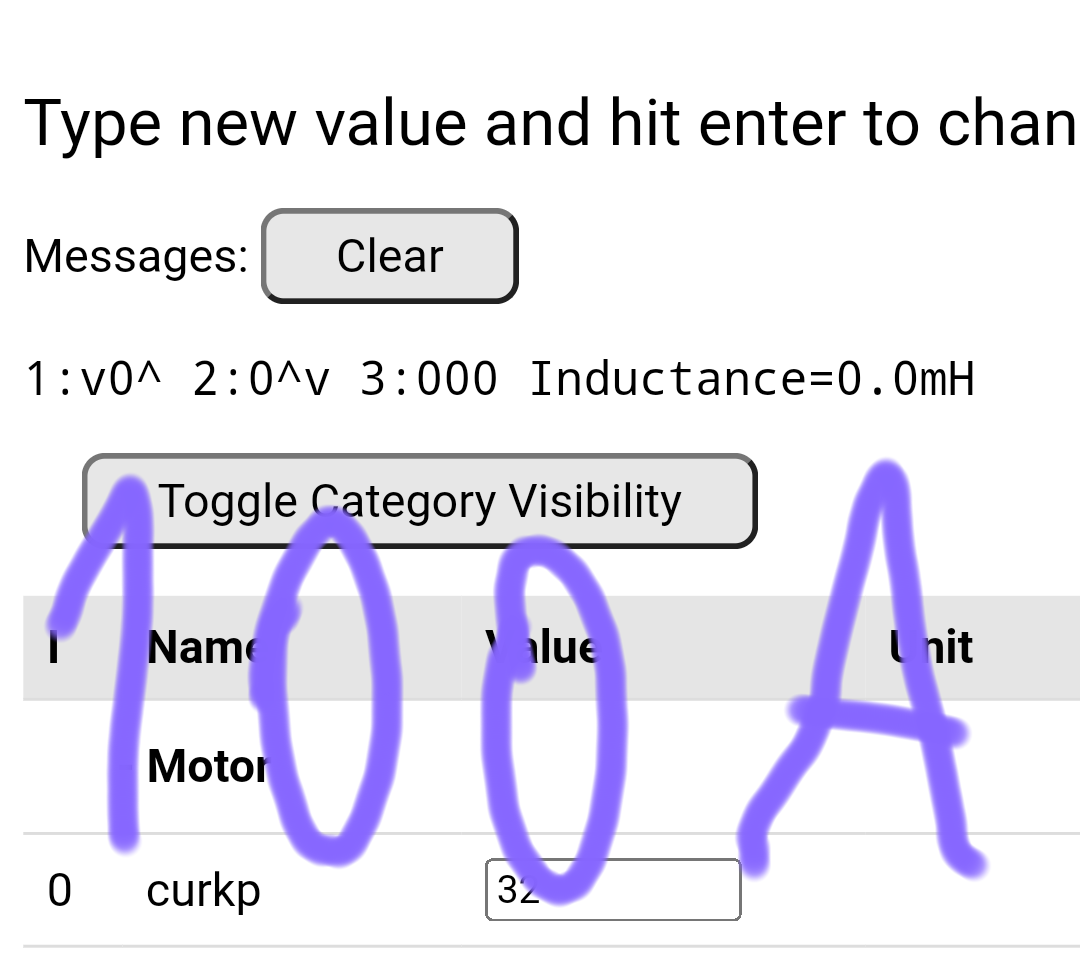

installed a new firmware and set the recommended settings. the phase test failed.

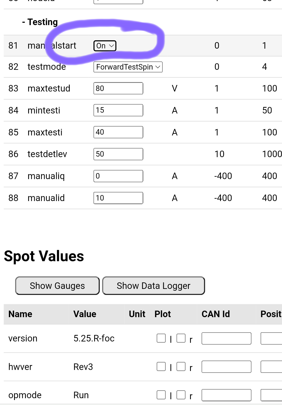

now, without changing the settings, I checked the rotation test. the system gave a message that it was running, but nothing happened! and only when I switched to on in the testing section, the motor turned slightly and the graph displayed it on the corner! probably something went wrong in the new firmware, since the rotation test stopped working. now I will check the new settings values on this firmware
evil neodymium :twisted:

No idea what the new manualstart does or how to use it (it was introduced after I ported the code to the F405 so I don't have it). I've always used the buttons at the top for these tests:

so. I changed the settings as you requested, and with a manual current id of 20 amps, the rotation test was successful. however, the graph is still only one of two! I also tried to run a phase test and got two different answers depending on the specified current manual id

Just checked what the manualstart parameter does and it won't work for these tests. It starts the inverter in MOD_RUN not MOD_MANUAL so won't execute any of the test code. The message you had must have been from an earlier start using the buttons?

I ran all the recent tests in the old way with the button at the very top of the interface
