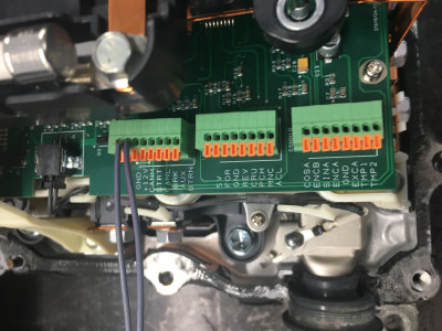

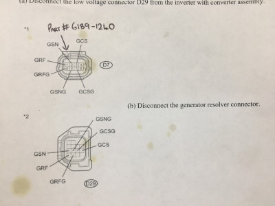

Hi all,
I’m working on a new project for a friend and could really use some help. He is converting his Mk I Golf drop top using a Prius Gen 3 M/G and inverter with the V1b drop in logic board designed by Damien Maguire. There is an excellent write up on the Openinverter wiki for this setup using the V1c board, big thanks to whoever contributed. If you haven’t seen it, check it out - it’s great.
https://openinverter.org/wiki/Toyota_Prius_Gen3_Board
I have the pinouts for the M/G resolver plugs from the Prius wiring diagrams, but haven’t had any success in finding how to relate them to the pinout on the V1b board (which are quite different to V1c. Can anyone help?

As no one else has answered, I think the answer you are looking for is here :-
Have a read around of that area in that support thread (click on the little arrow next to wrote: above to go to that thread
Basically match pins 16 to 21 to the above listkonstantin8818 wrote: ↑Sun Aug 16, 2020 3:13 pm I've checked with 4.87R already, nothing changed.
resolver connection MRFG-GND, MSNG-SIN A, MCNG-COS A, MRF-EXC A, MSN-ENC A, MCS-ENC B
Phases are connected straight 1,2,3 to 1,2,3.

Great, thank you Speedy that’s just what was needed! Having a read through the whole thread now... might take a while. The whole system is rigged up on the test bench, contactor control is working fine so hopefully will have some footage to show on Thursday.

About that resolver connection: If, after syncofs tuning, your motor will run good in one direction but run away in other, try to swap ground and positive wires of sine or cosine detectors MSNG<>MSN, MCSG<>MCS. Damien helped me with this hint, when I've stuck with FOC tuning.

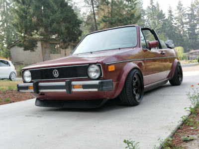

what motor are you going to use on the Cabby? also where on earth are batteries going to go?james@N52E01 wrote: ↑Tue Sep 22, 2020 6:54 pm That’s pretty handy, we’re using similar hardware then as I’m using the Gen 1 leaf motor and inverter on my car and helping with the Gen 3 Prius inverter and motor on the Golf.
My Cabriolet:

Please see Damien's video on FOC tuning, beginning with timestamp 37:00james@N52E01 wrote: ↑Mon Sep 21, 2020 10:49 am Hi all,
Basically, one MUST absolutely ignore wire colors and designations and: a) use a multimeter to determine the wire pairings and b) go thru the process of pairing to find the 1 of 4 possible connection methods that actually works.

Great, thanks ZooKeeper. I’m still not sure if the inverter is configured for FOC or sine wave control. Either way I’m guessing it wouldn’t affect the pairings? I’ll go through the complete video and let you know how we get on Thursday.ZooKeeper wrote: ↑Tue Sep 22, 2020 8:28 pmPlease see Damien's video on FOC tuning, beginning with timestamp 37:00
