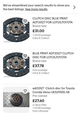

wow that is lucky, ohh right cool, thanks. Oh btw how are you planning on locking them? because every example i've seen people use the core of the clutch disk thing but ofc that thing is sill expensive to buy just for that one partrstevens81 wrote: ↑Tue Jun 06, 2023 10:52 pm Did get lucky with the hv cables, luckily the plugs for the resolver/shifter are cheap on Ali (see wiki), I highlighted the need for shielded cable as it has in the past been suspected to being a cause of some Comms failure on the help threads.

Well £37 isn't going to break the bank
, and compared to the various conectors, midpack disconnect, contactors, fuses you will need it will only be a drop in the pond
