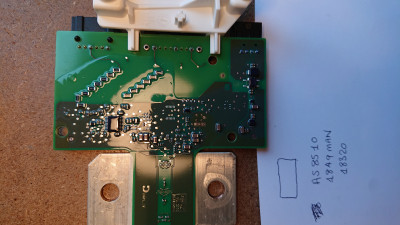

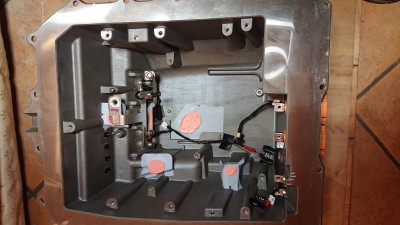

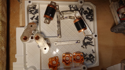

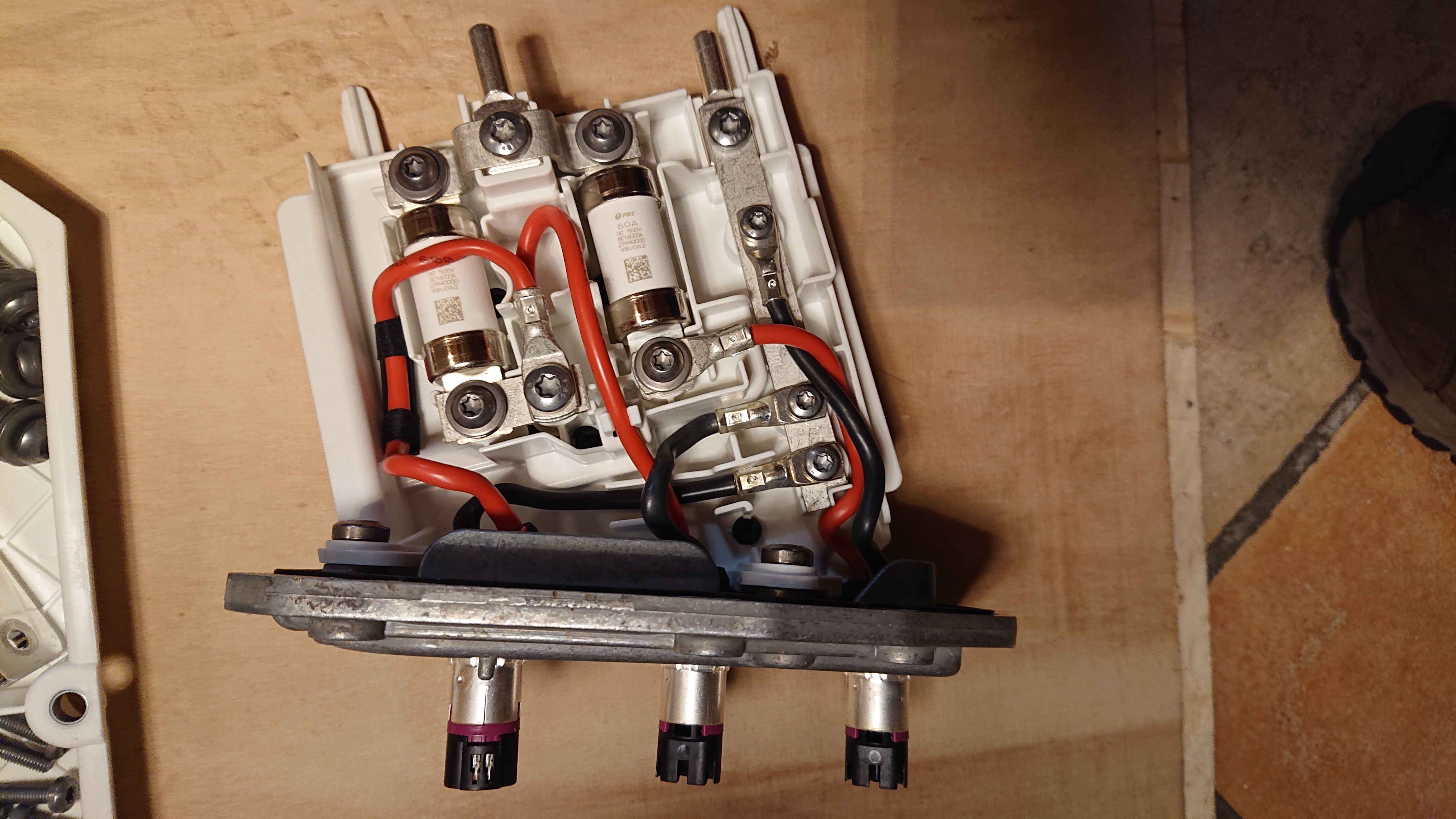

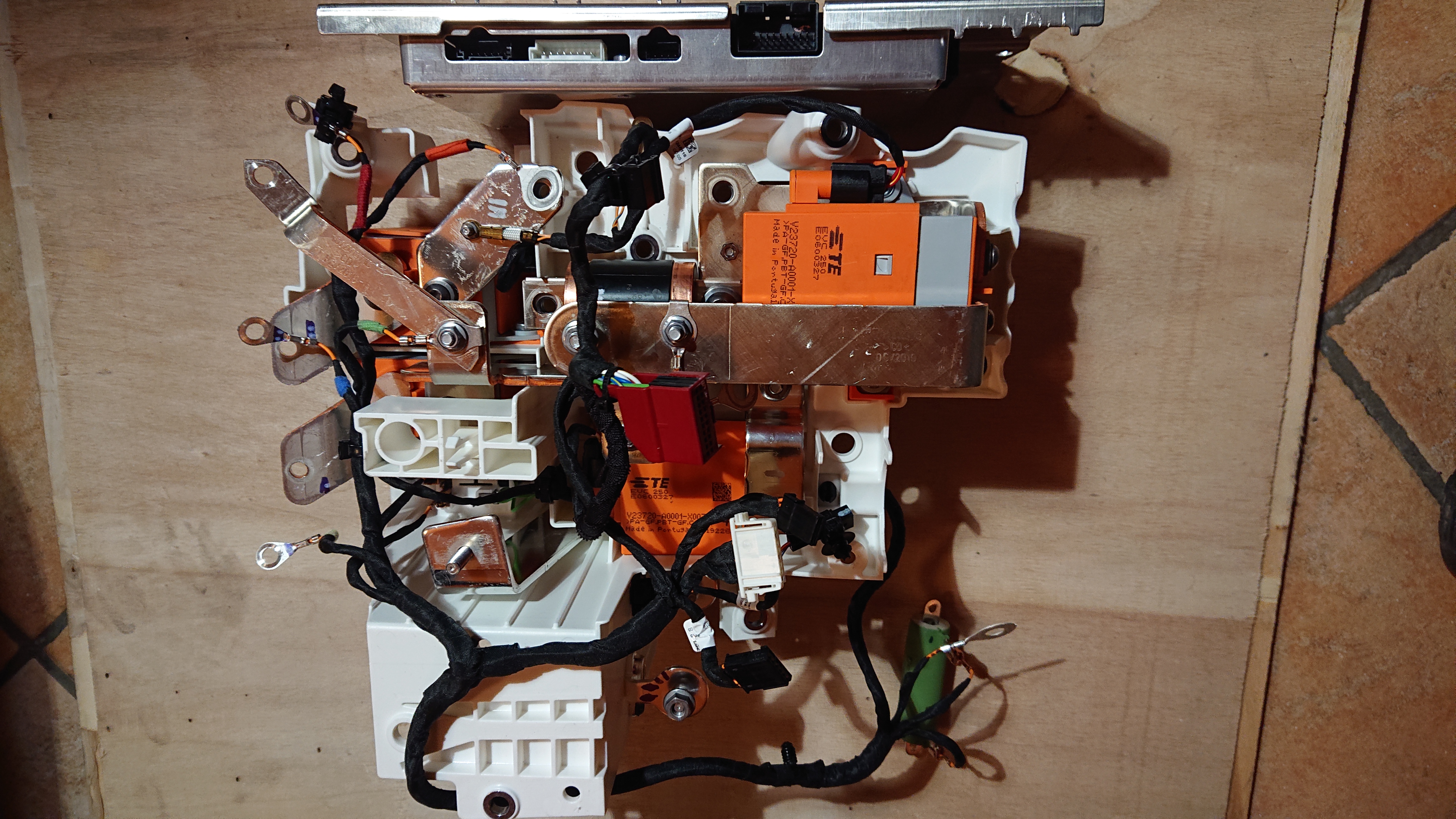

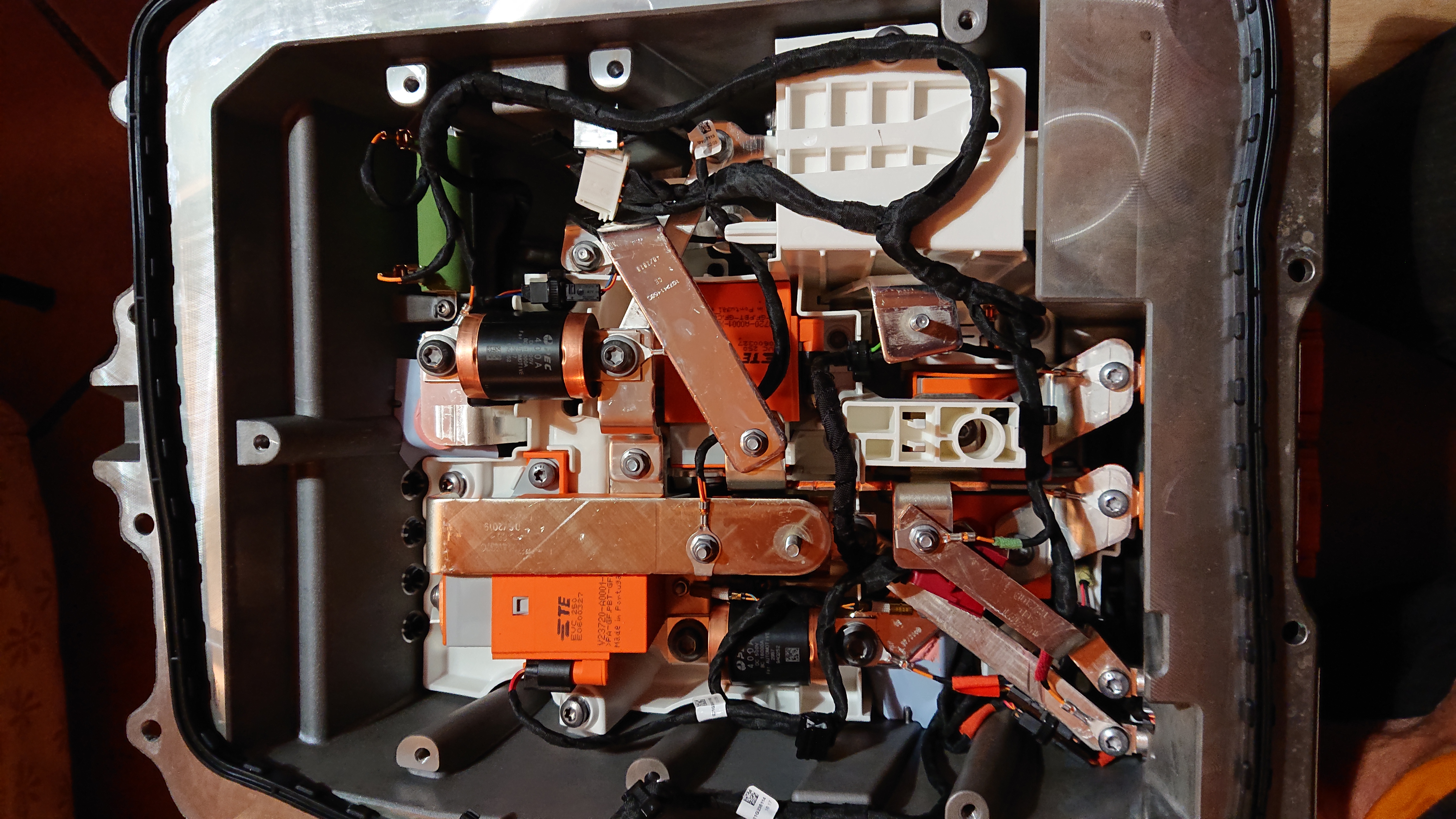

Hi there folks,doing a breakdown of an E-Tron HVJB.
It has an isolation fault (intermittantly), so hope the tear down reveals something.
In any case, I hope this helps with overall builds.
The unit weights about 15kgs!
It contains 4 HV ETE Relays
There are 3 main HV Fuses
There is an internal control unit monitoring various HV values and controling precharge relay
There is another circuit board connected directly onto MainPositive HV Relay.
There ia an added junction for what I am yet to confirm is for the Rear Inverter/motor.
There is also another junction for the PTC, AC and Charger - again to be confirmed.
I hope to locate the Pyrofuse to understand the safety circuits better too.
Enjoy

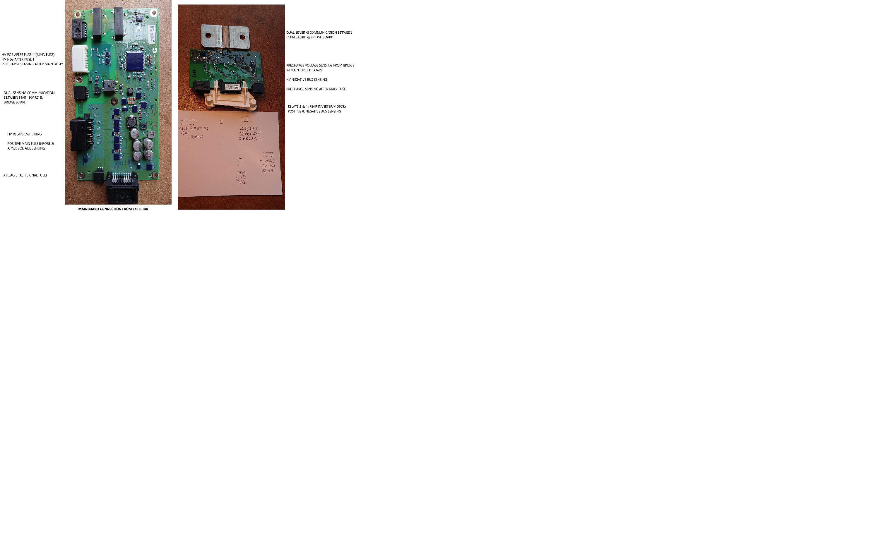

Re: E-tron HVJB

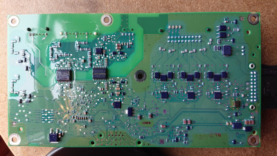

Any chance you make a zoom picture of that square ic on first & second picture; off the current sensor and hv sense board?

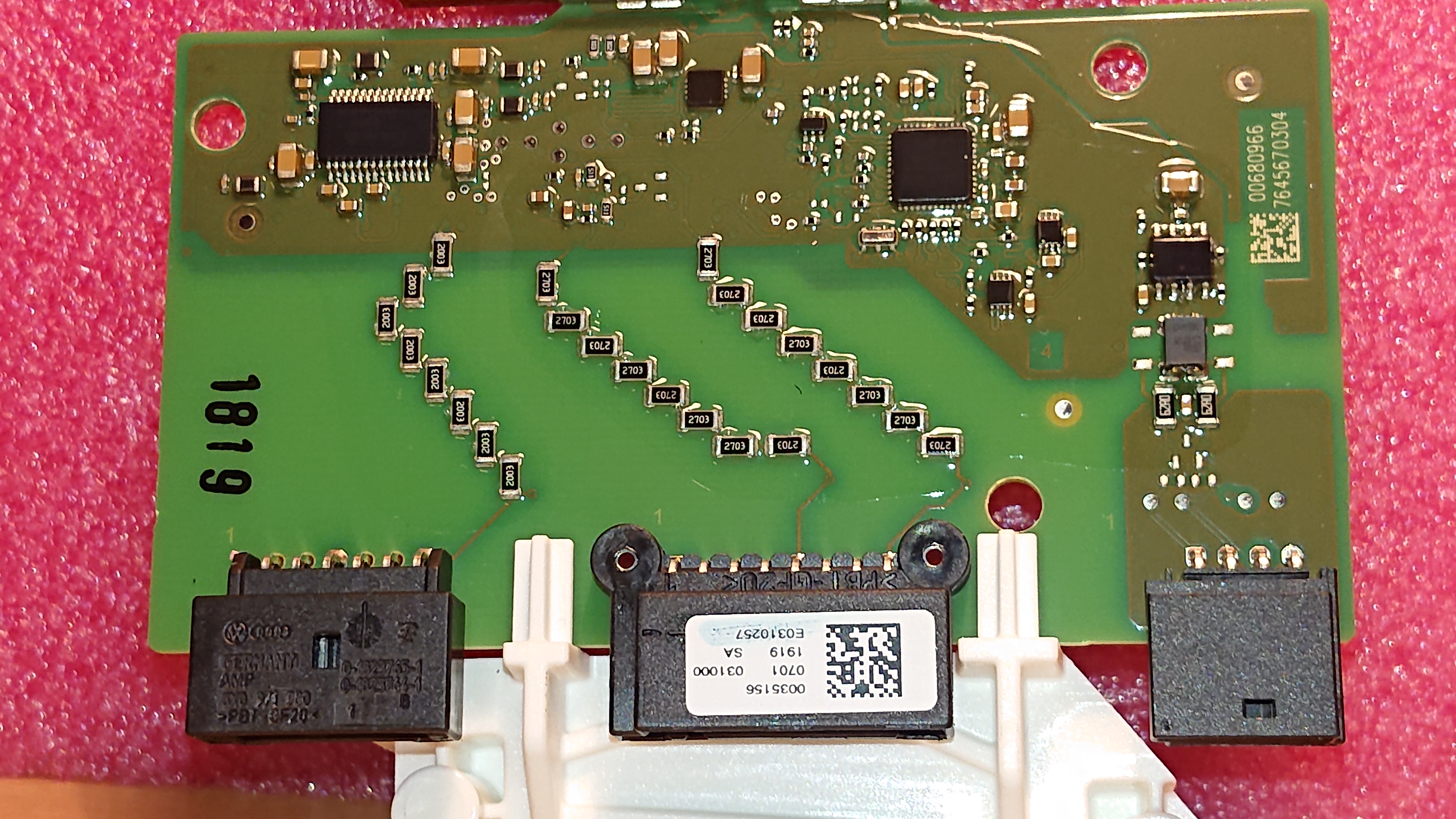

Re: E-tron HVJB
Decided to remove the sensing board. Hope the pictures make sense. Would this be audi's version of isabellenhutte?

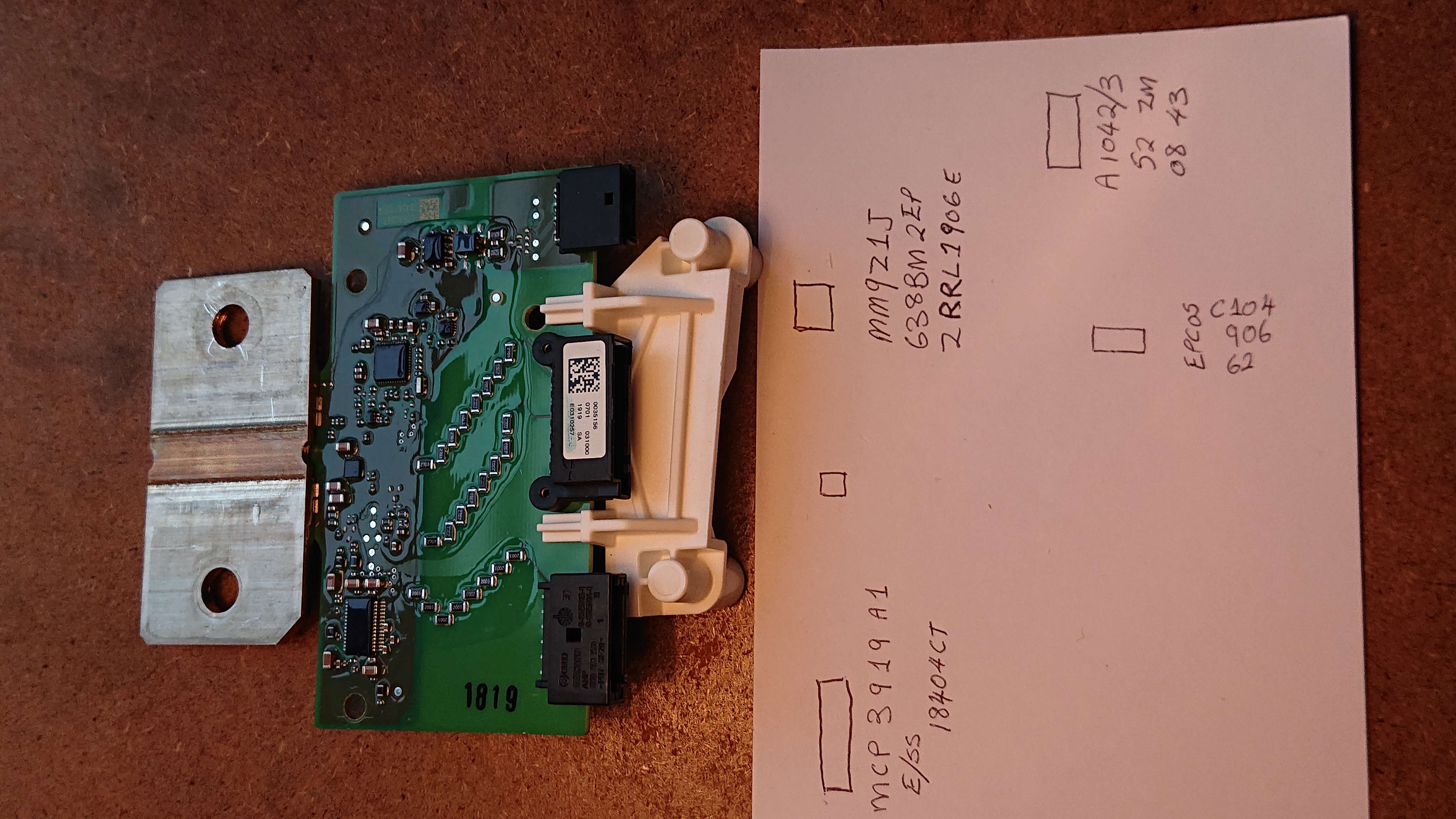

Re: E-tron HVJB
Can you read the "middle" chip? and post it here? i miss a tiny bit to read it.

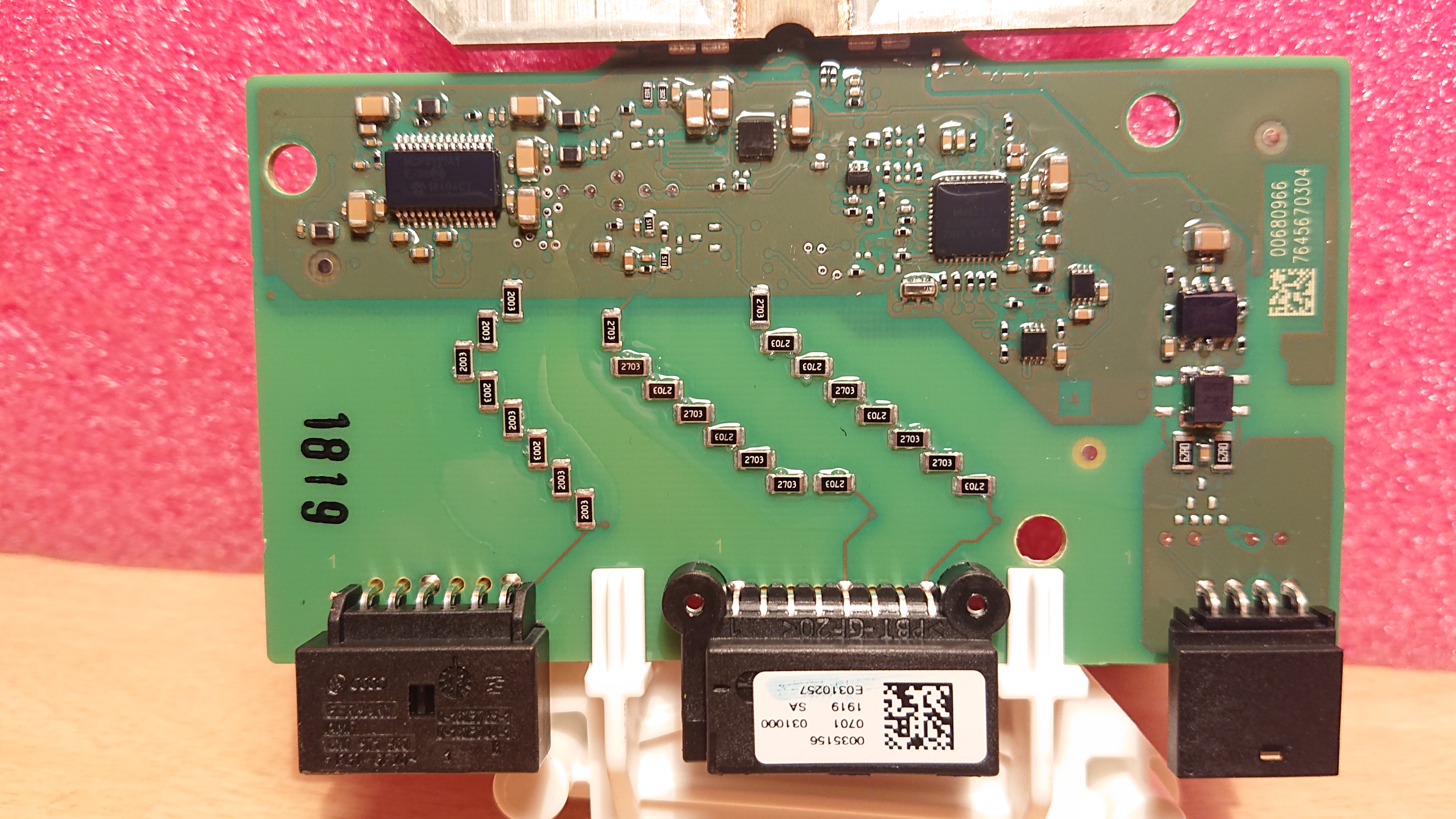

Re: E-tron HVJB
These are references for sensing board.
On a side note, this board connects to the 'main internal board' which will be in the next post.
Is this some overkill, or just how important voltage sensing, isolation and contacter controle is?

Re: E-tron HVJB
This is the main contacter controle board inside the HVJB.
It has 10 wires from the outside world, 2 of which are CAN

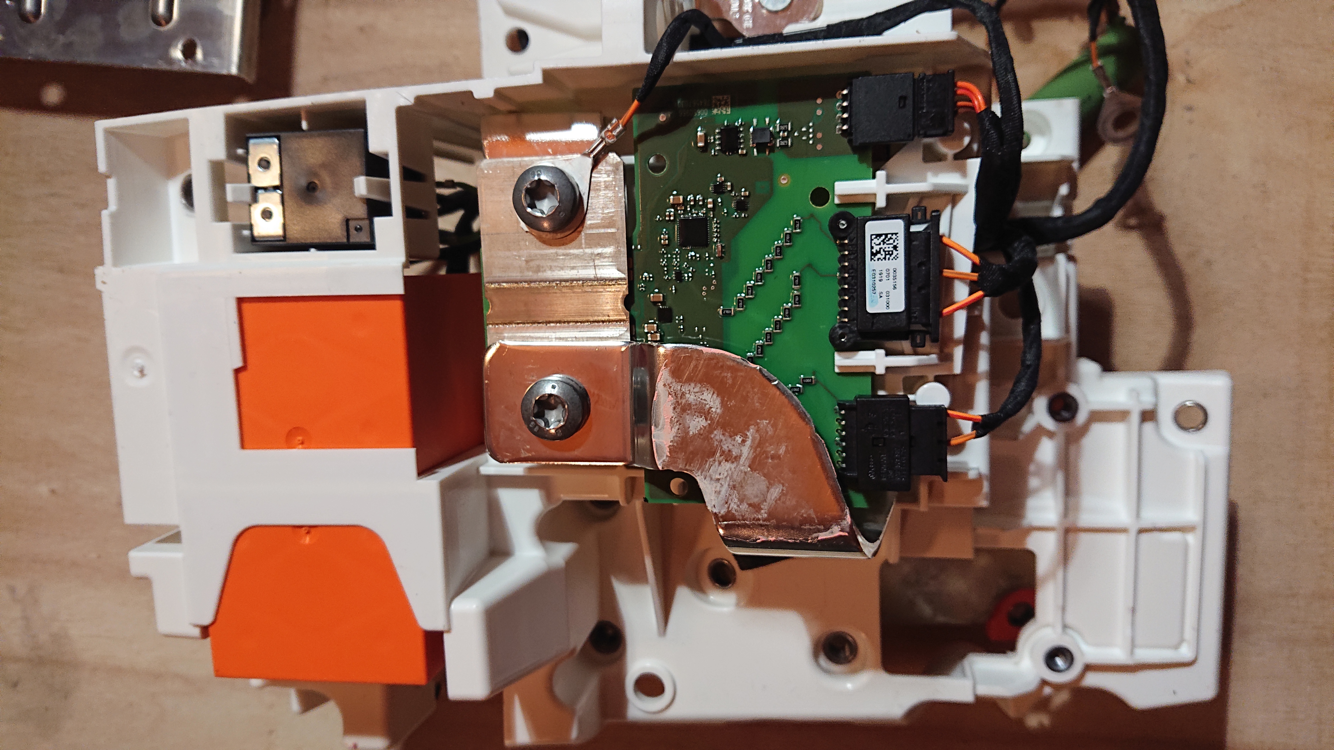

Re: E-tron HVJB

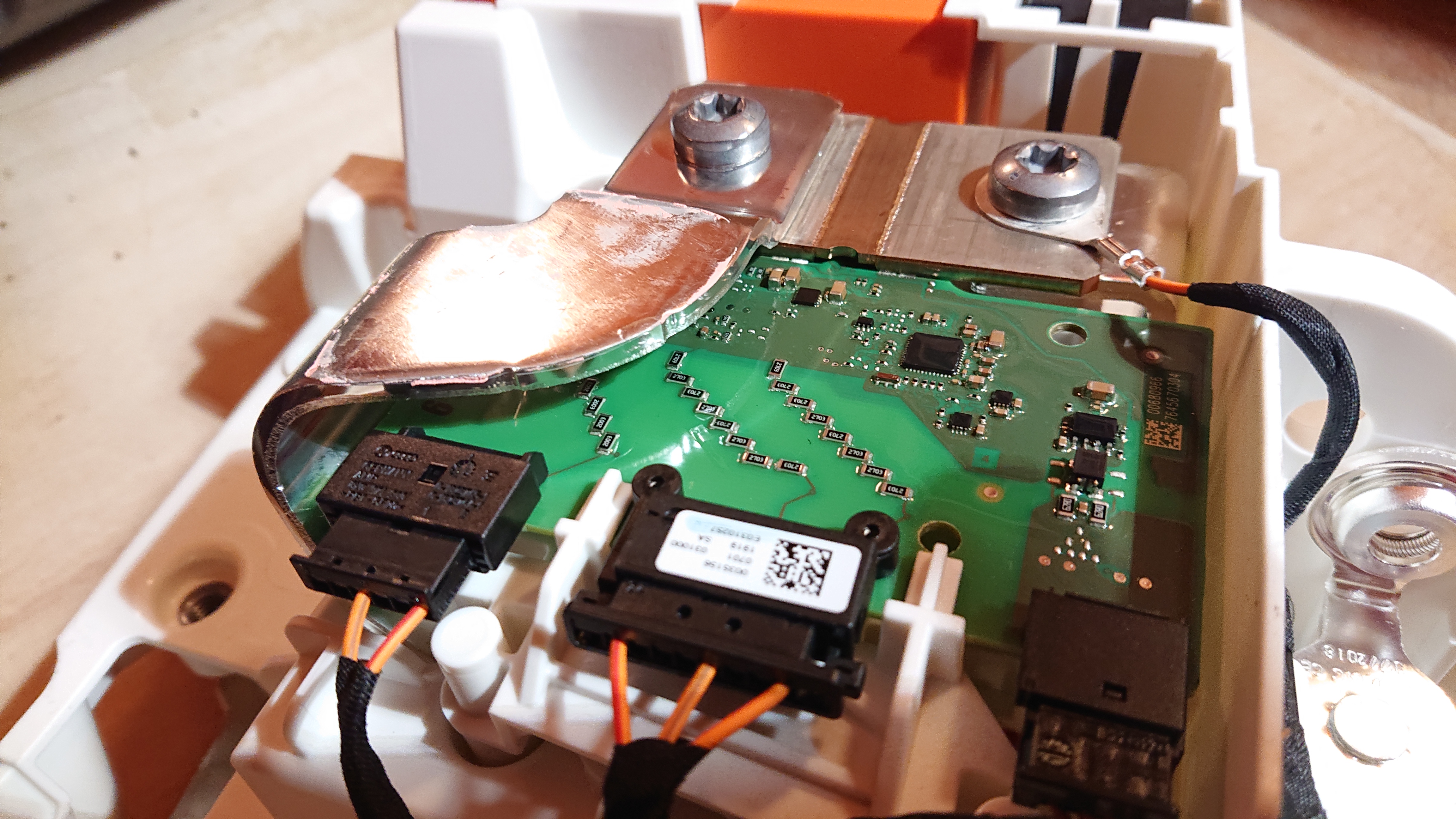

Did some poking about with a multieter and marker pen. Some interesting findings.
There are 2 circuit boards monitoring various voltages before and after the 4 HV Contactors.
Since there are 2 inverters/motors, there's lots of doubling up I imagine.
What is most interesting is the "Bridge Board" before Main Positive HV Relay. It seems to have a circuit to monitor isolation/current, as there are 2 sets of wiring going to the Main Board. There is also a "copper bar" welded between 2 bus bars with Tabs that are connected to the circuit board.
I would like to find out how HV Isolation is calculated, as it is a requirement for my build I would need to intergrate. Time for Wiki and Google

Some more useless info, the main circuit board also has the function of PWM signals to keep the HV Relays closed.
If we want to re-use these contactors, we need to have PWM wizardry as well.
