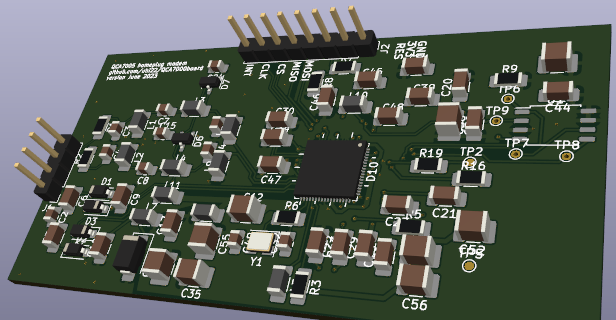

As a starting point, created an "ugly board":
Key features:
- contains only the QCA7005 and its flash. No controller, no power supply, no CP resistor things.
- uses the big 1206 for most of the components, because this simplifies the hand-soldering
- uses only two layers. This is not the optimum RF design. Would be better to have four layers.
- contains lot of room for optimization. It's just a very early example.
Zieg
Posts: 365
Has thanked: 156 times
Been thanked: 149 times
Re: Develop a QCA7000 board?
Post by Zieg »
Awesome! I'm guessing dual layer for easy prototyping then?

uhi22 wrote: Wed Jun 21, 2023 7:04 pm - uses only two layers. This is not the optimum RF design. Would be better to have four layers.
Definitely use 4 layers. It makes routing much easier and the cost difference is negligible these days from JLCPCB.

uhi22 wrote: Wed Jun 21, 2023 7:04 pm As a starting point, created an "ugly board":
Key features:
Have you actually build this? I see it's now possible to buy the QCA7005!
https://www.aliexpress.com/item/1005005 ... W_eSuXFtpY
https://www.alibaba.com/product-detail/ ... 31kXOWtL2Q
My preference would be to couple this with a STM32, but ESP32 could also work.

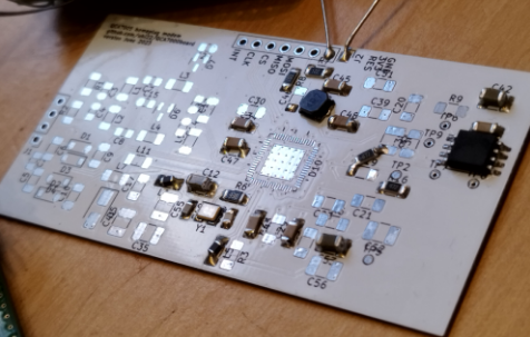

The PCB and components are on the way. Then will try to make it running in the next weeks. Based on the results, plan to add the other components. But I guess this will need some time. Any alternative designs welcome, so maybe we can split the effort.
Edit: PCBs arrived, but the QCA7005 not yet.
