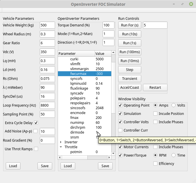

The new interface looks like this:
Any field can be edited but only the low level ones will affect the simulator (most of the Motor and Testing ones, a few from Inverter and throtcur).
The Vehicle and OpenInverter panes are now completely independent of each other.
The Vehicle fields, Torque Demand, Mode and Direction are still persisted between program runs.
The OI parameters are initialised from the OI project param_prj.h file on program start. Either edit this file to suit your defaults or use the new Load button to re-initialise them.
Buttons have been added to allow parameters to be saved or loaded.
The OI parameters buttons use the same format as the web interface so should be compatible (although warnings will occur if moving between different OI versions with different parameter sets).
The Motor buttons just load or save Lq, Ld, Rs and Flux Linkage. The idea is to generate files for each of the common motors but that will have to wait till another time.
@johu - at the moment Param::change is in a params_prj.cpp file in the Qt build directory. There are a couple of issues to sort out with the CAN class access so I haven't tried to integrate it into the OI build. Once that's done though it should be possible to just delete the Qt version of the params_prj.cpp file and use the one in the OI project instead.
This version will work with 5.24R but does need one line editing so for the moment if you want to simulate 5.24 stick with the main branch version of the simulator. The combined branch version of the simulator has been tested with 5.27R and will be pushed to main once the changes have been made to the OI firmware.

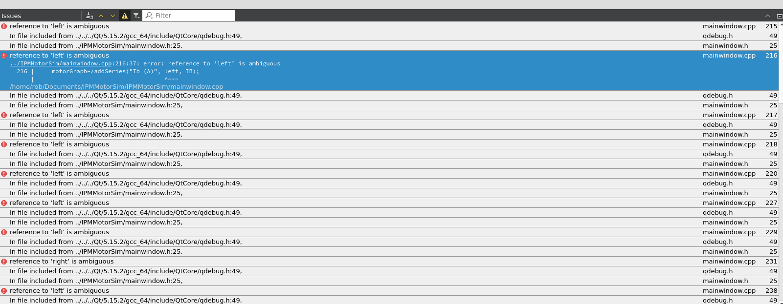

Really sorry pete .... idiot alert!!!
I'm getting the following error trying to compile ....
i'm assuming i don't have a (string) module installed here are the modules i have installed any ideas which one it might be in.
Many thanks in advance on this, when we work out what it is ill update wiki :)
PS i know how much of pita this is.. all i can say is thank you for all you have done.

No problem, thanks for testing it.
Think I might know what that is, saw something similar yesterday but the proper fix needed a few dozen references to an enum to be changed that conflicts with one defined in the libraries. Thought I'd found a quick workaround but obviously not!
Need to update my Qt version! Got a new SSD waiting to go in the PC so that I can put a newer OS but not got round to it yet :(

Just pushed a fix up to github, let me know if it helps?
Should have done it that way to start with, far quicker to do than I expected!

OK got it working....updated my qt whilst i was there ...
i got an error
Could not load the Qt platform plugin "xcb"
but managed to fix this following https://github.com/NVlabs/instant-ngp/discussions/300 (google is your friend)
if anyone else is running linux could they have a go... im one of the oddballs that like LTS OS' (debian) if its a repeatable error ill add a note in the wiki, however suspect it might be very os speciffic.
edit: yes code fixed it (first bug,second bug was qt)

Just to clarify did the code change fix the first bug and then the environment variable fixed another bug that was introduced when updating Qt?

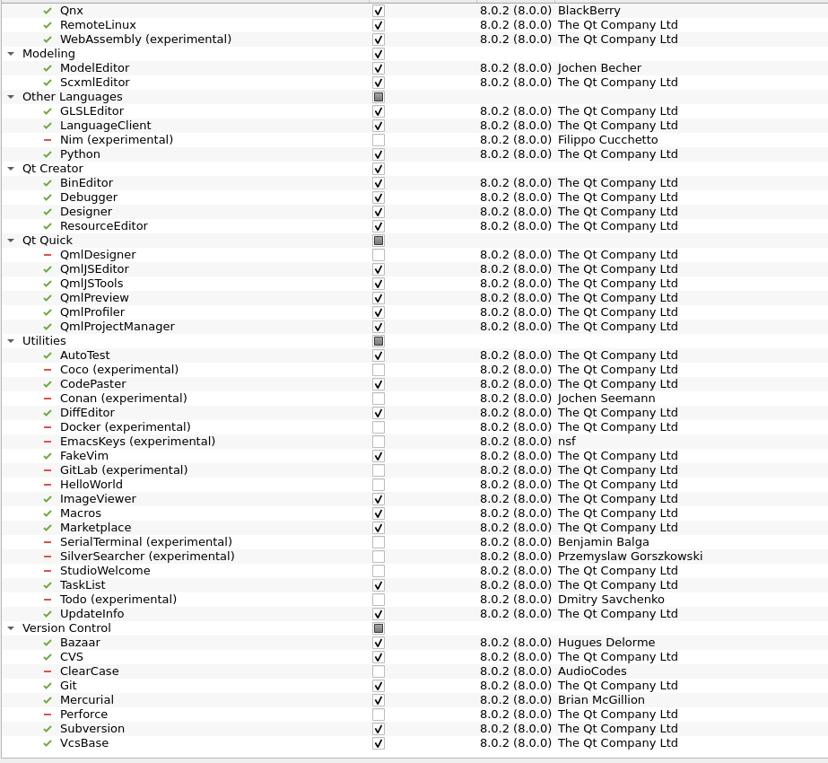

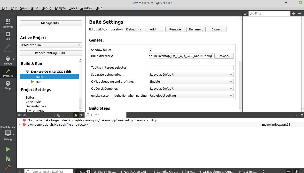

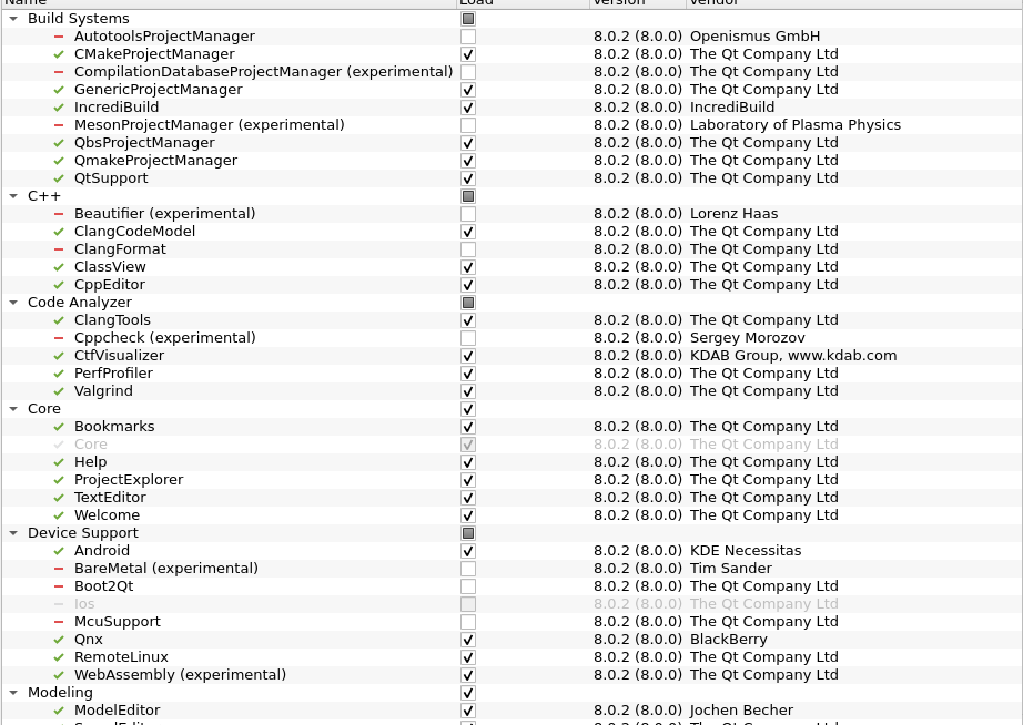

Jacobsmess
Posts: 871
Location: Uk
Has thanked: 545 times
Been thanked: 153 times
Post by Jacobsmess »

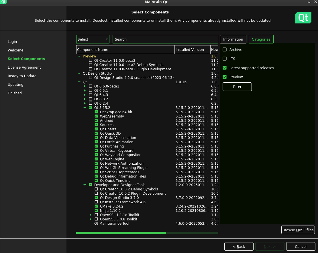

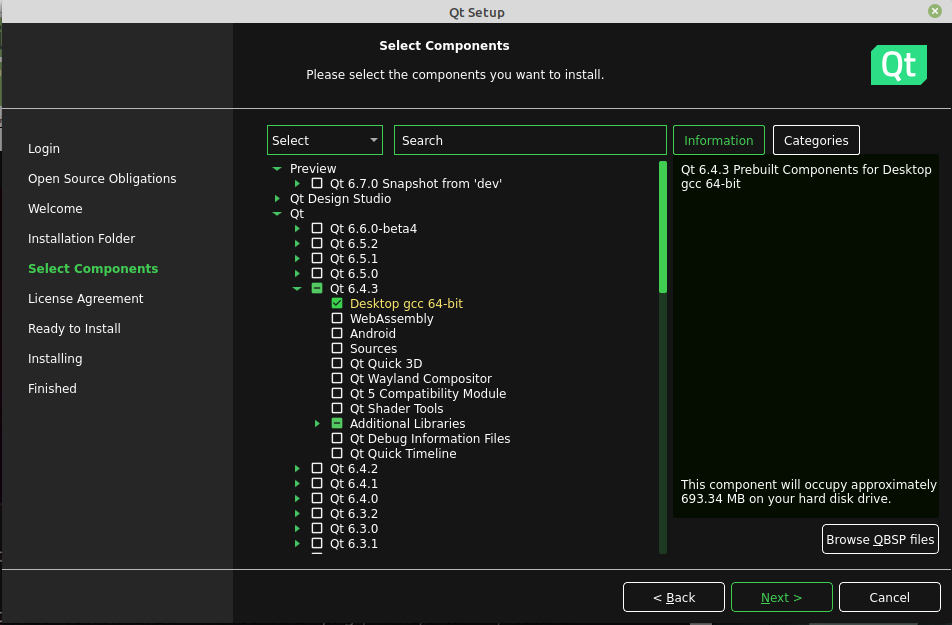

Finally managed to get my old Linux partition running in the hope that I can get the simulator working on it as my Mac is too old....
When installing QT it seems the installer has changed from what it was when the guide was written. The options that seem closest to what is mentioned on the install guide are as pictured...
but it would be nice if this could be confirmed?
Also, given there are newer installation options, would it be beneficial to install one of these or is it best to stick with 6.4?
UPDATE: I went ahead and installed the above and compiled the GIT hub stuff, opened it in QT but it seems to throw up a couple of errors that won't allow the IPM simulator to run... I've attached a screenshot below

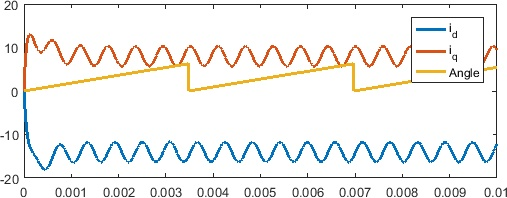

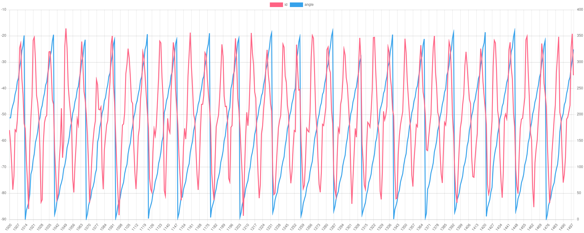

Pete9008 wrote: Thu May 11, 2023 11:58 am I'm more wondering whether it is a harmonic/saliency. It would be interesting to see whether it is phase locked to the motor current?
1.5 years later and with Pete already amiss I went at this again.
It looks like the oscillation is phase locked to rotor angle and runs at twice the electrical speed
Been thanked: 1918 times
Anyone still watching?
I think I'm up against something else. In the article Pete posted the disturbance looked like this:
So 6x the motor frequency and sinusoidal. The disturbance in my plot as triangular shape and 2x motor frequency. Could it be some other artefact?
