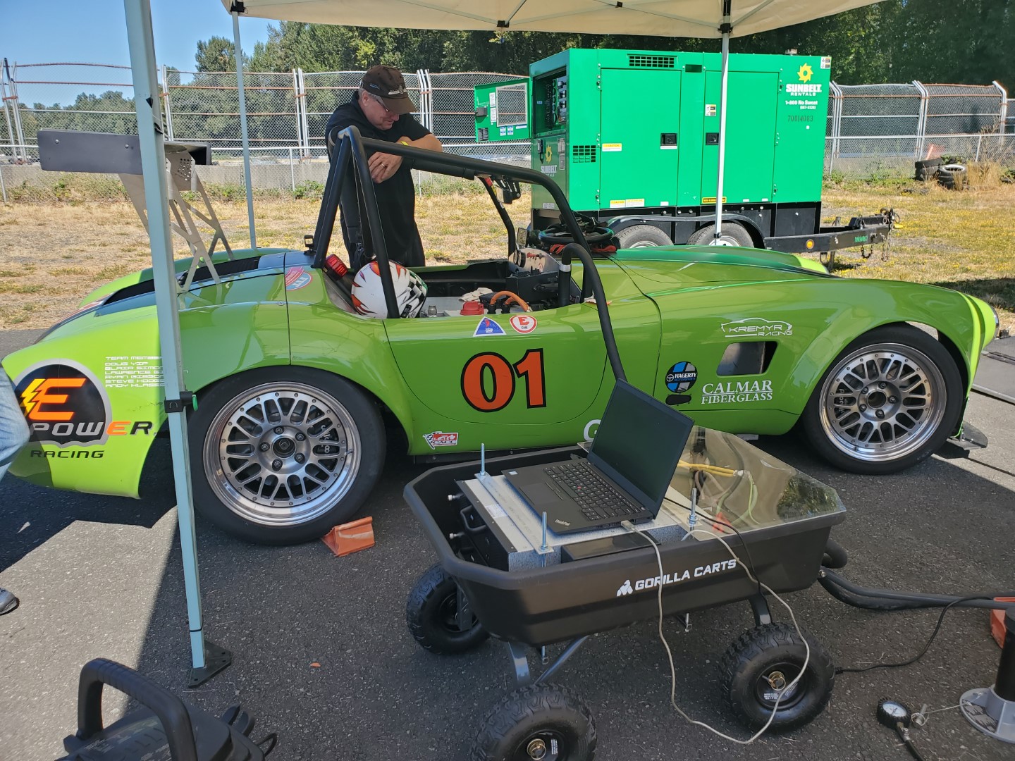

Over the weekend, we tested a new charger setup using a parallel pair of 30kW Charger Modules from China. Input was 3 phase, 440 V from a diesel generator. The charger performed flawlessly at the fully rated 60kw with no errors or problems. Control is via documented CAN bus commands, so this would be a good DIY solution for those that have 3 phase power (> 275V) and need an offboard charger. Price of each module was $1000 USD plus $300 for DHL courier to Canada.
We were very concerned about reports of poor Chinese quality, support etc so we did careful research of the manufacturer and Alibaba supplier. Our fears were unfounded. We were put in direct contact with a factory support engineer by the supplier and received prompt answers to all our questions. If anybody wants details details of the supplier, they can PM me.

Any internal pics to assess build quality?

No pics! I was tempted out of curiosity, but decided against it after everything worked.

What kind of connection plug did you use. And how is the charging managed? You use orionbms in this build correct?

We used a Tesla charge receptacle on the car and a Supercharger Plug on the charger side. Ultimately, the charge will be managed by our datalogger/controller. The Orion BMS will act as a supervisory safety which will cut the charge in case our datalogger/controller mis-behaves. For the weekend, we used a laptop running SavvyCAN to generate the CAN bus commands and a crew member standing by at all times.
