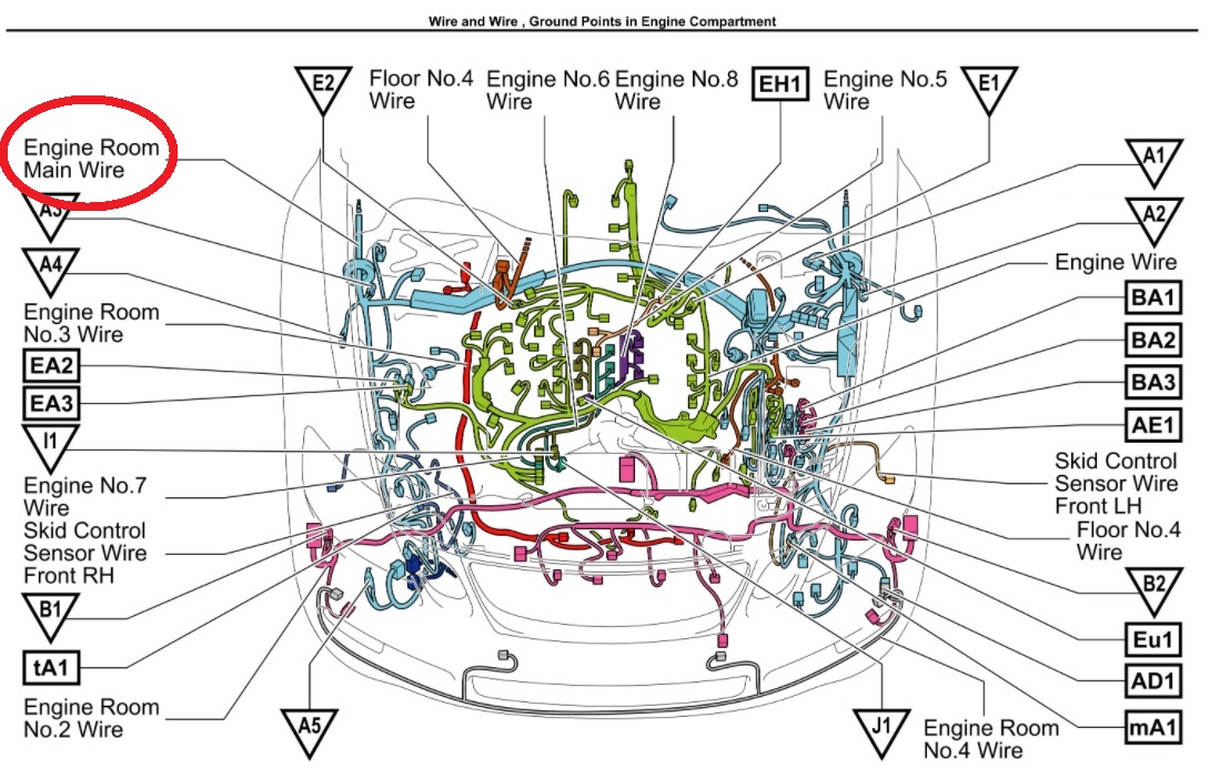

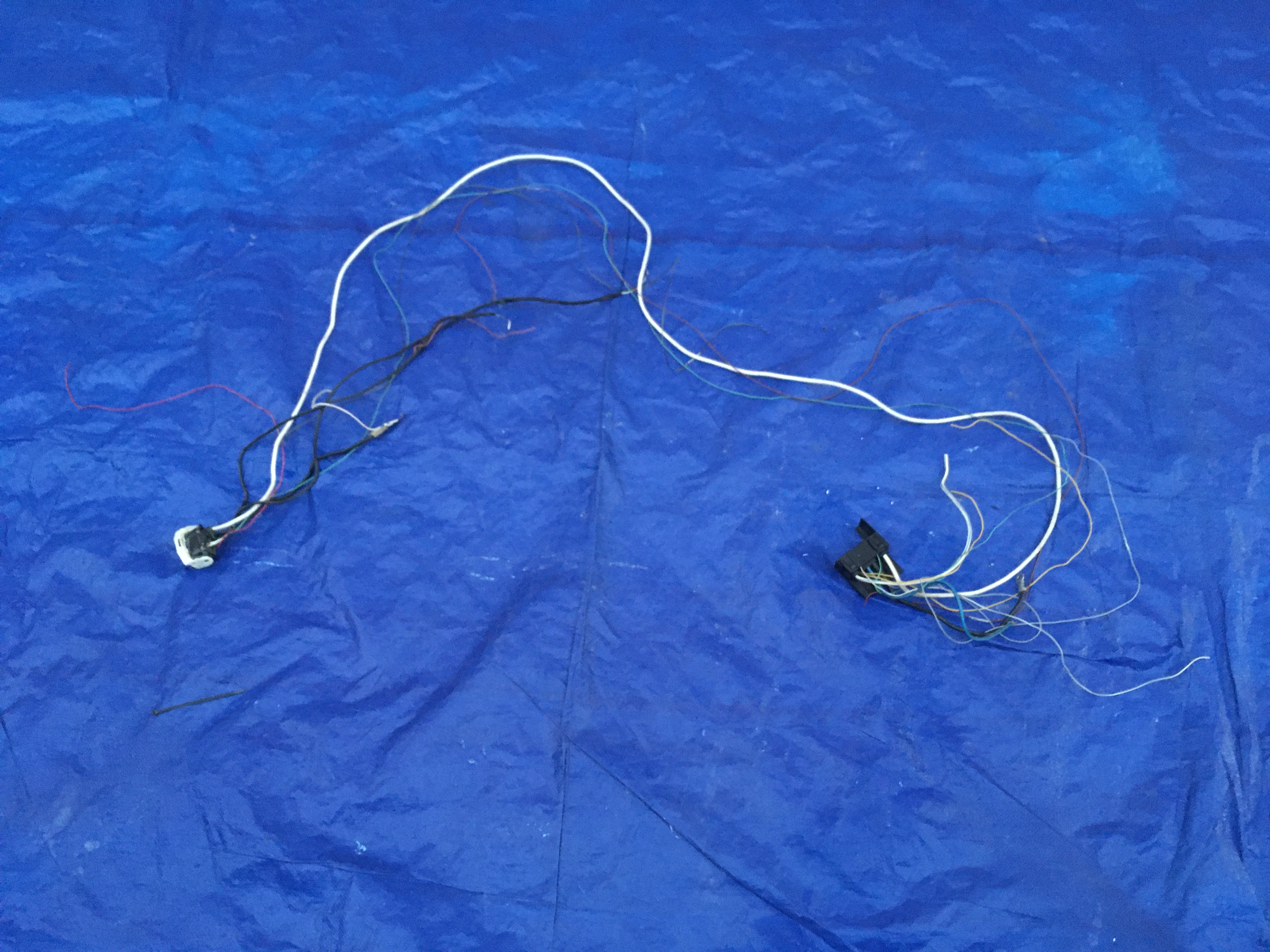

Re: Lexus GS450h Oil Pump Stock OEM Wire Harness n stuff
Post by Gregski »

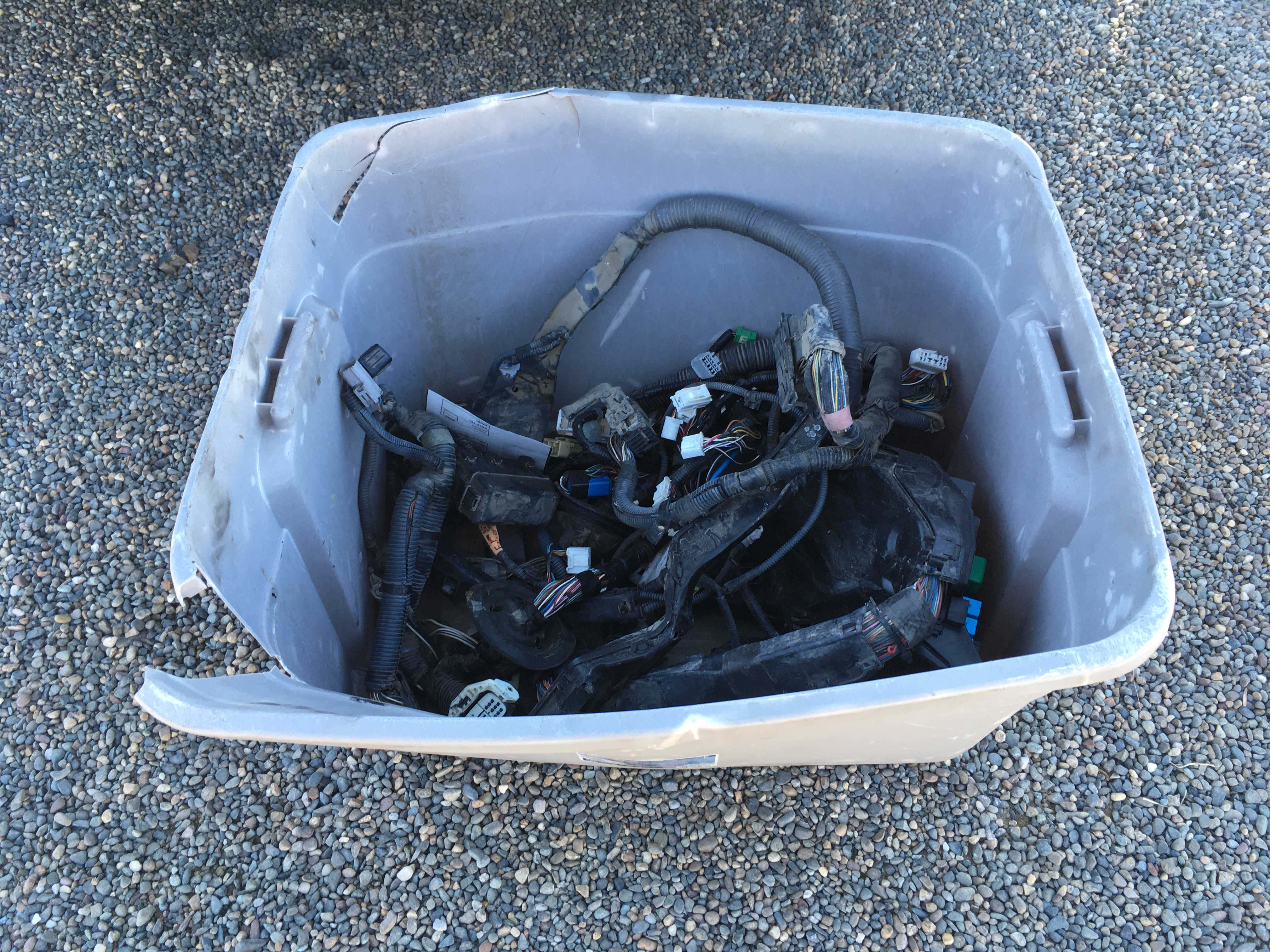

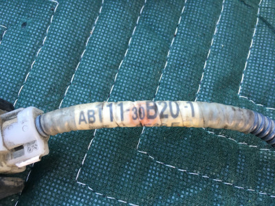

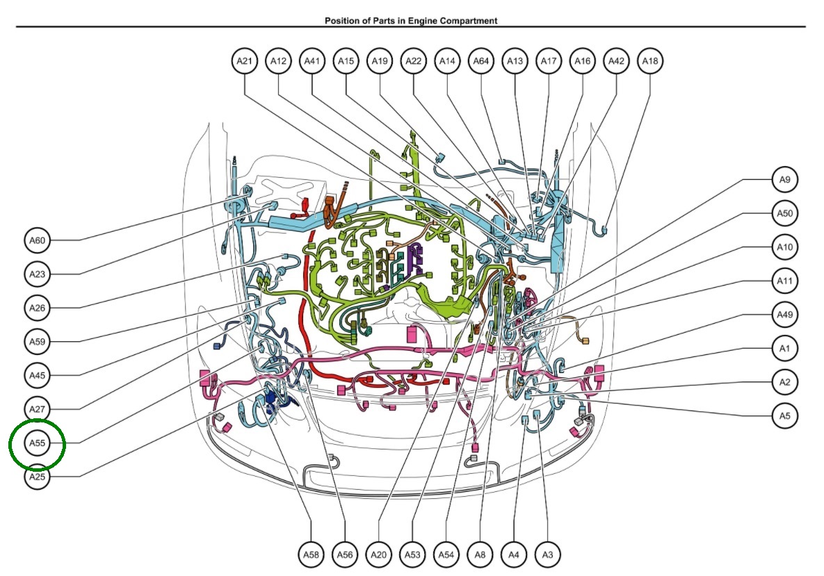

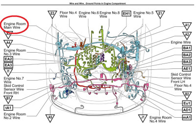

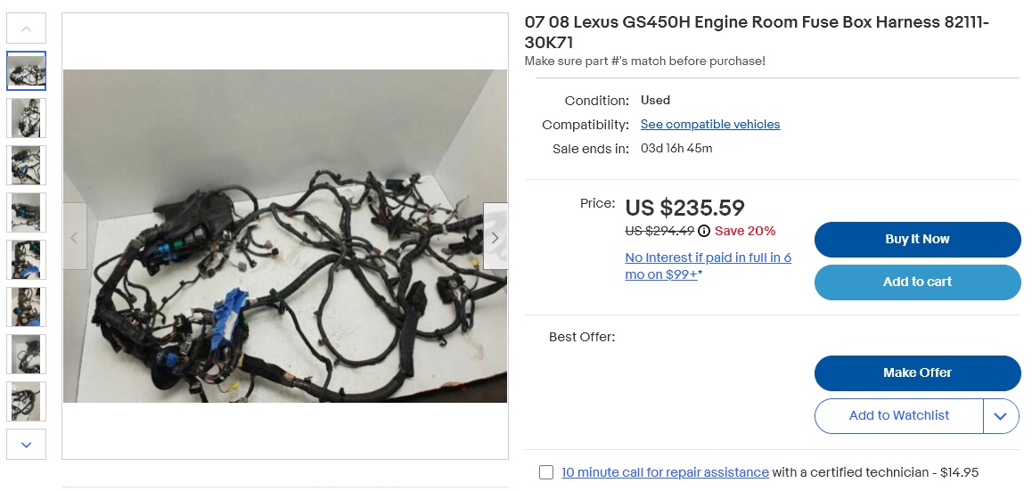

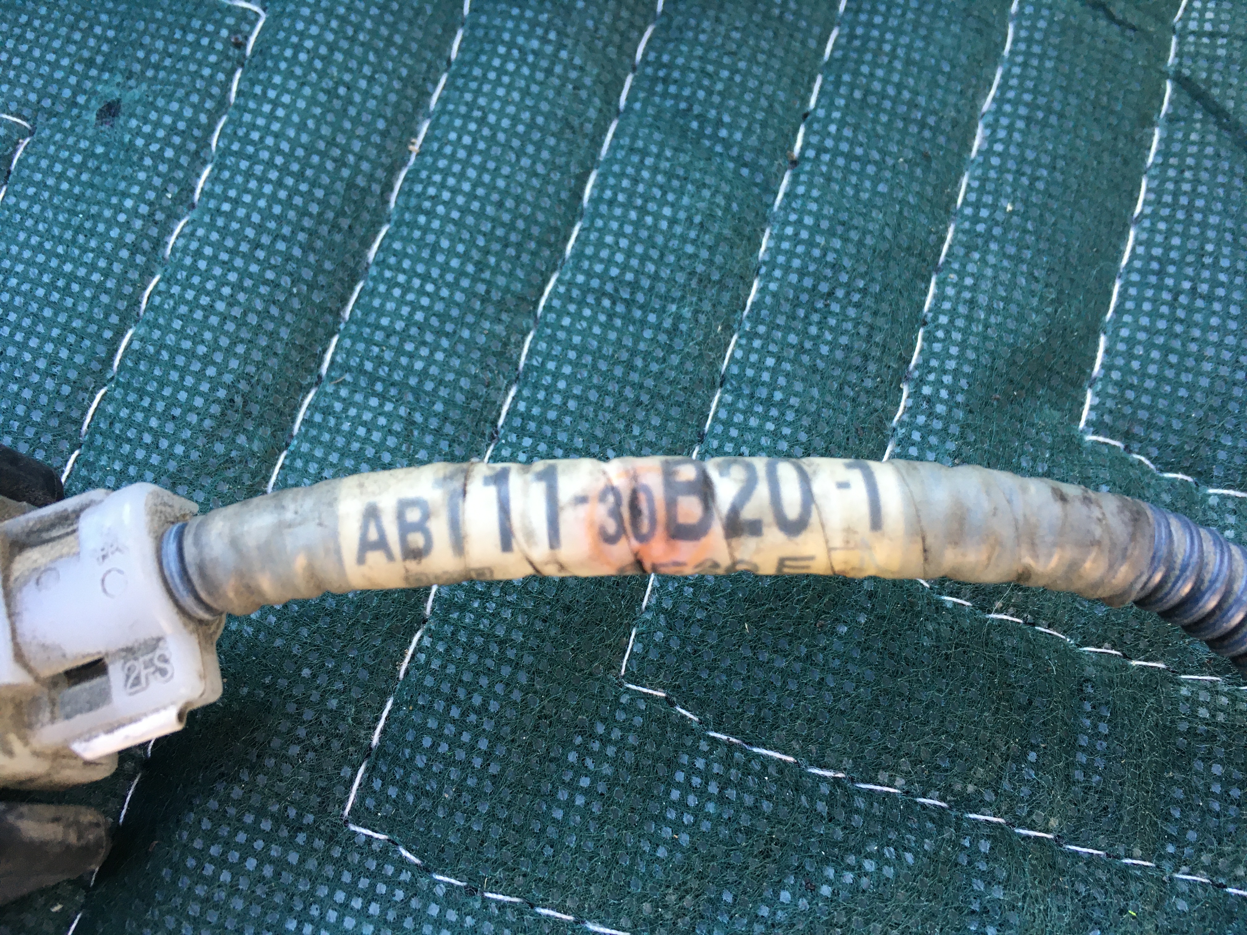

as my friend says: "even a blind squirrel finds a nut sometimes" and so I did, I ended up with the transmission oil pump controller harness by accident really when I bought what Lexus refers to as the Engine Room Room Main Wire harness on eBay (but from a local dismantler in my own town, pronounced: FREE Shipping)
2007-08 Part# 82111-30K71
but goes by many other part numbers depending on vehicle features (like headlights even)
82111-30K62 fits 2008-2009
costs $7,144 new
82111-30K64 fits 2010​
costs $6,341 new

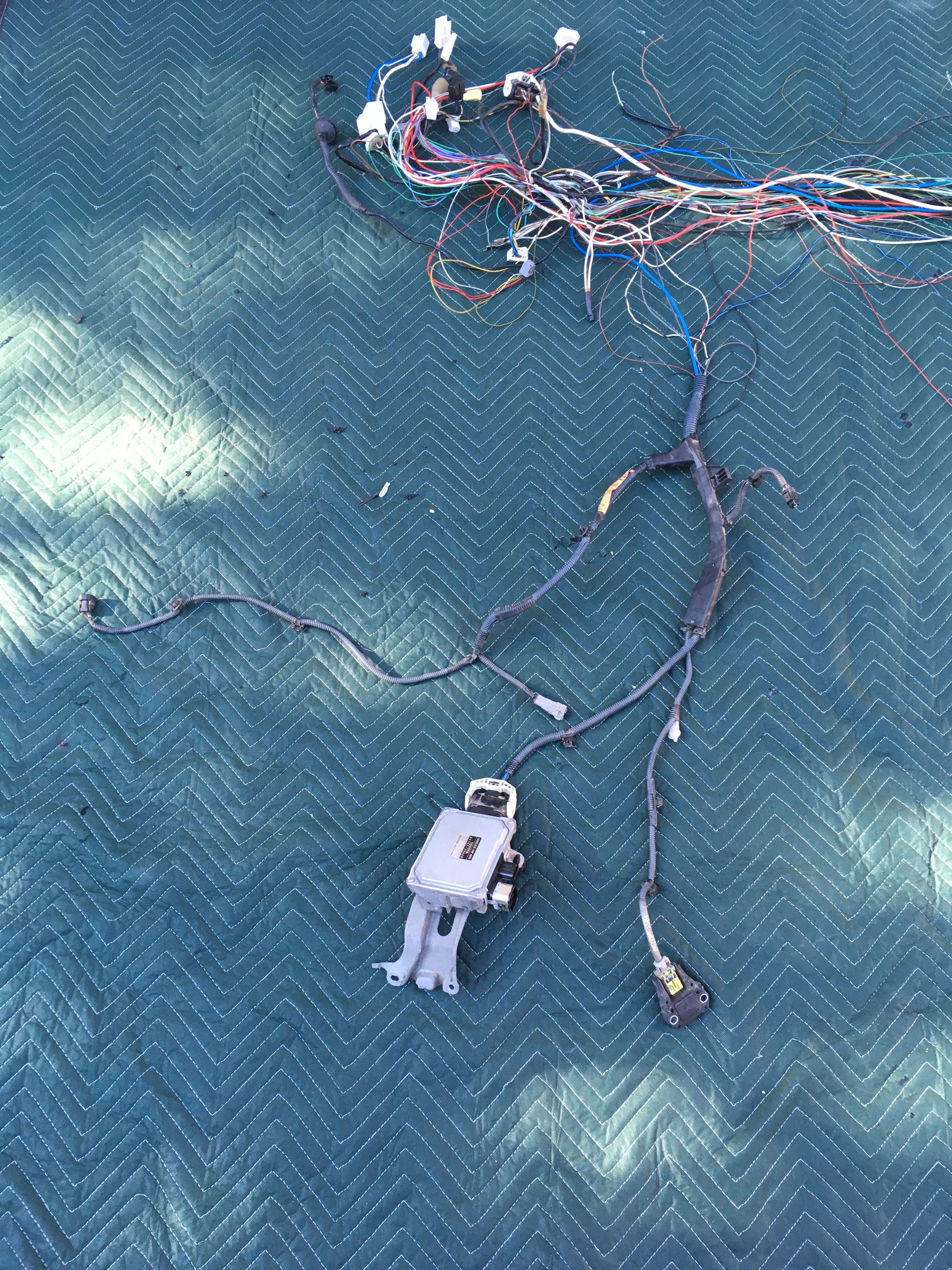

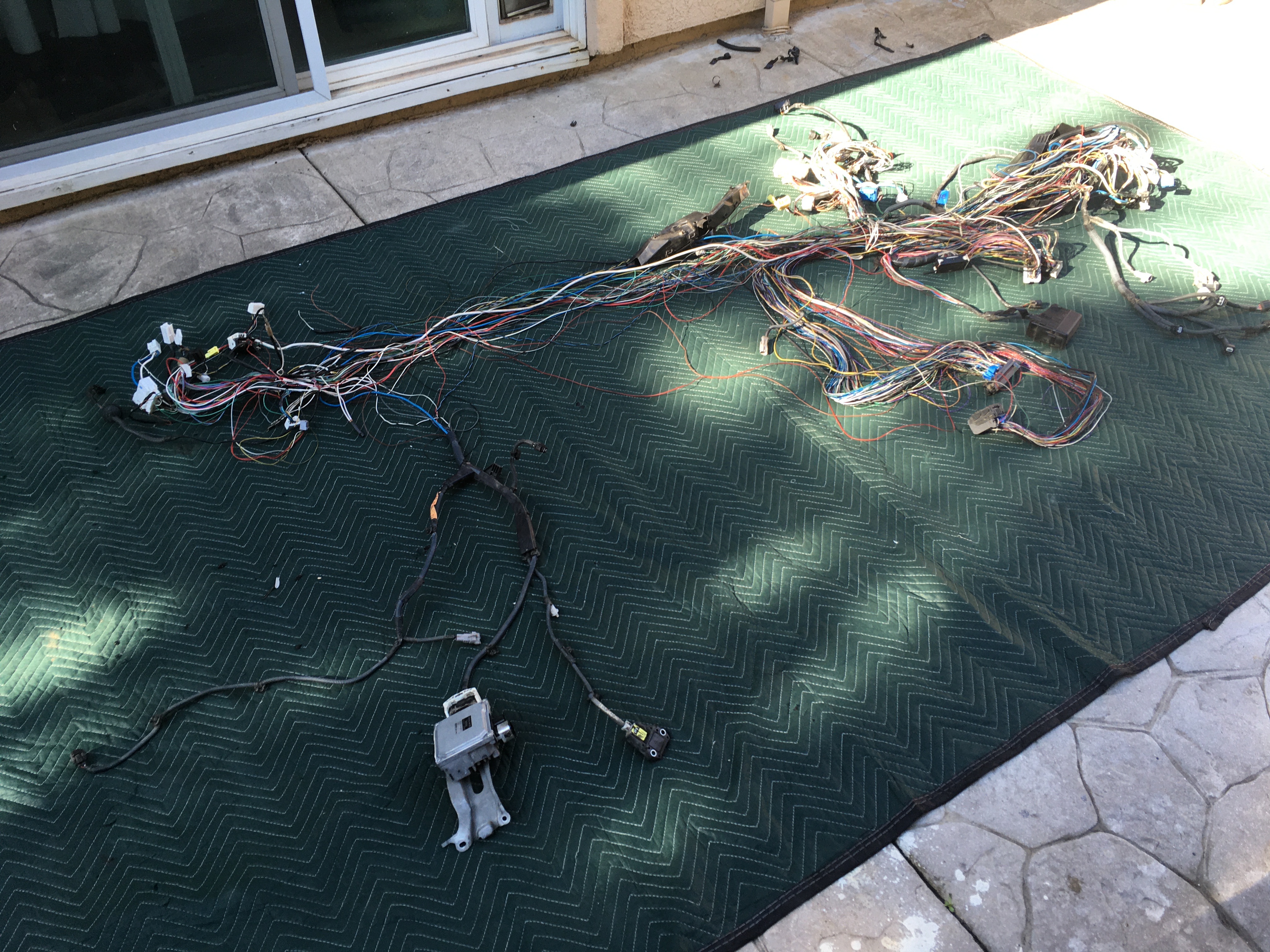

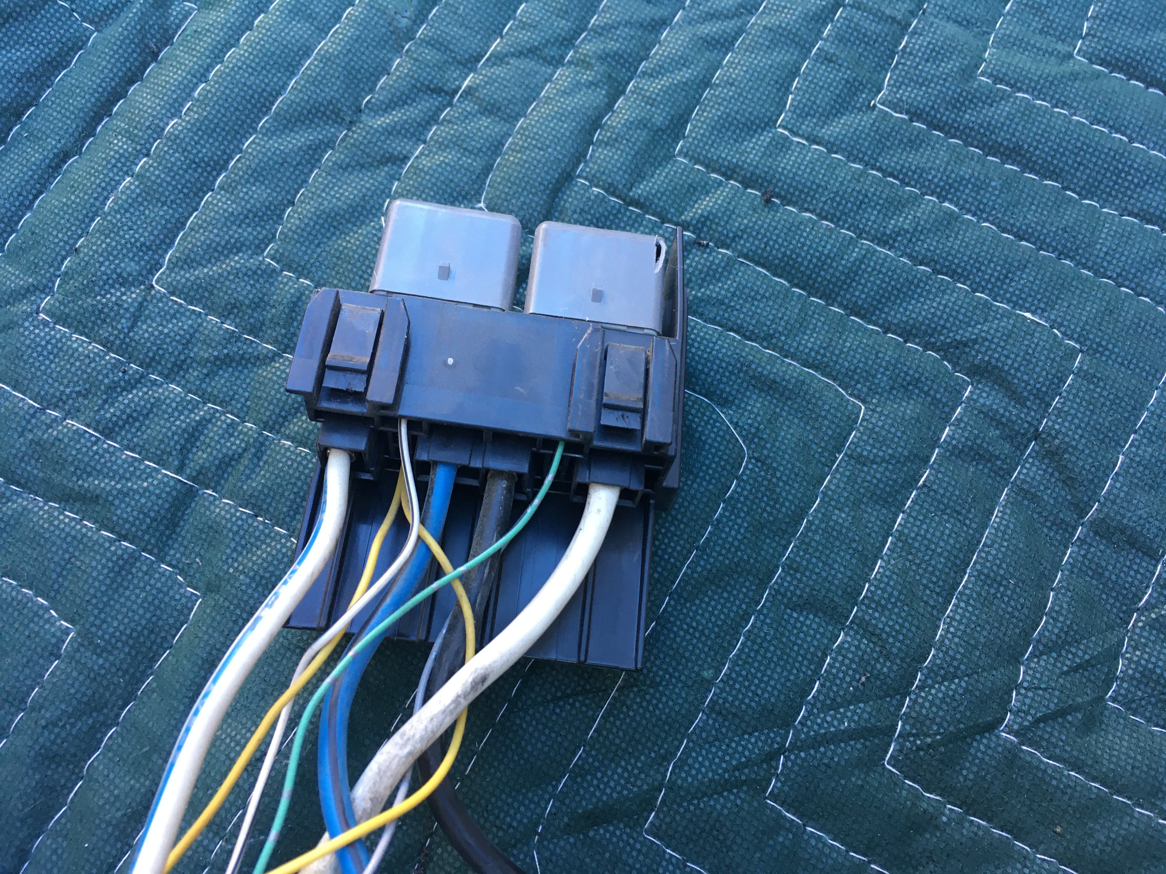

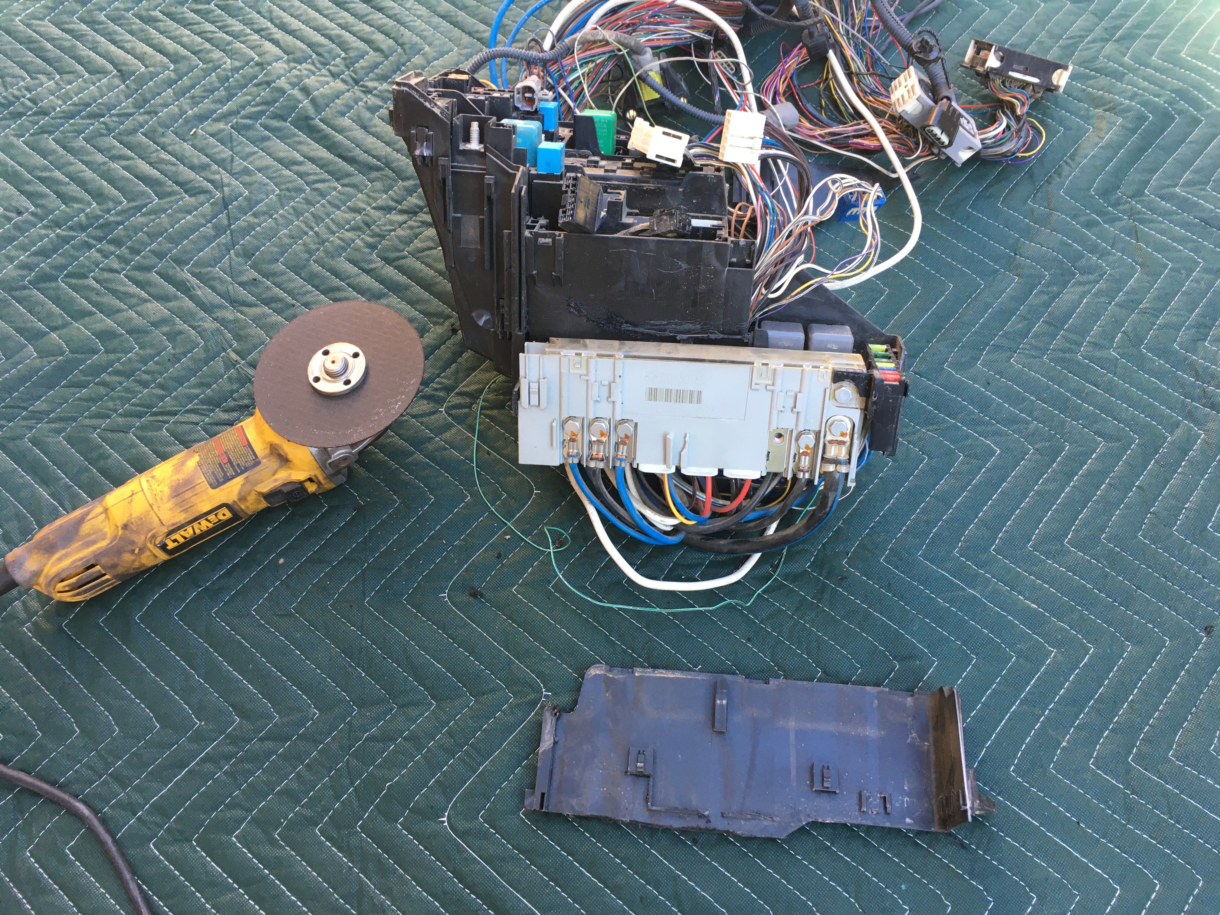

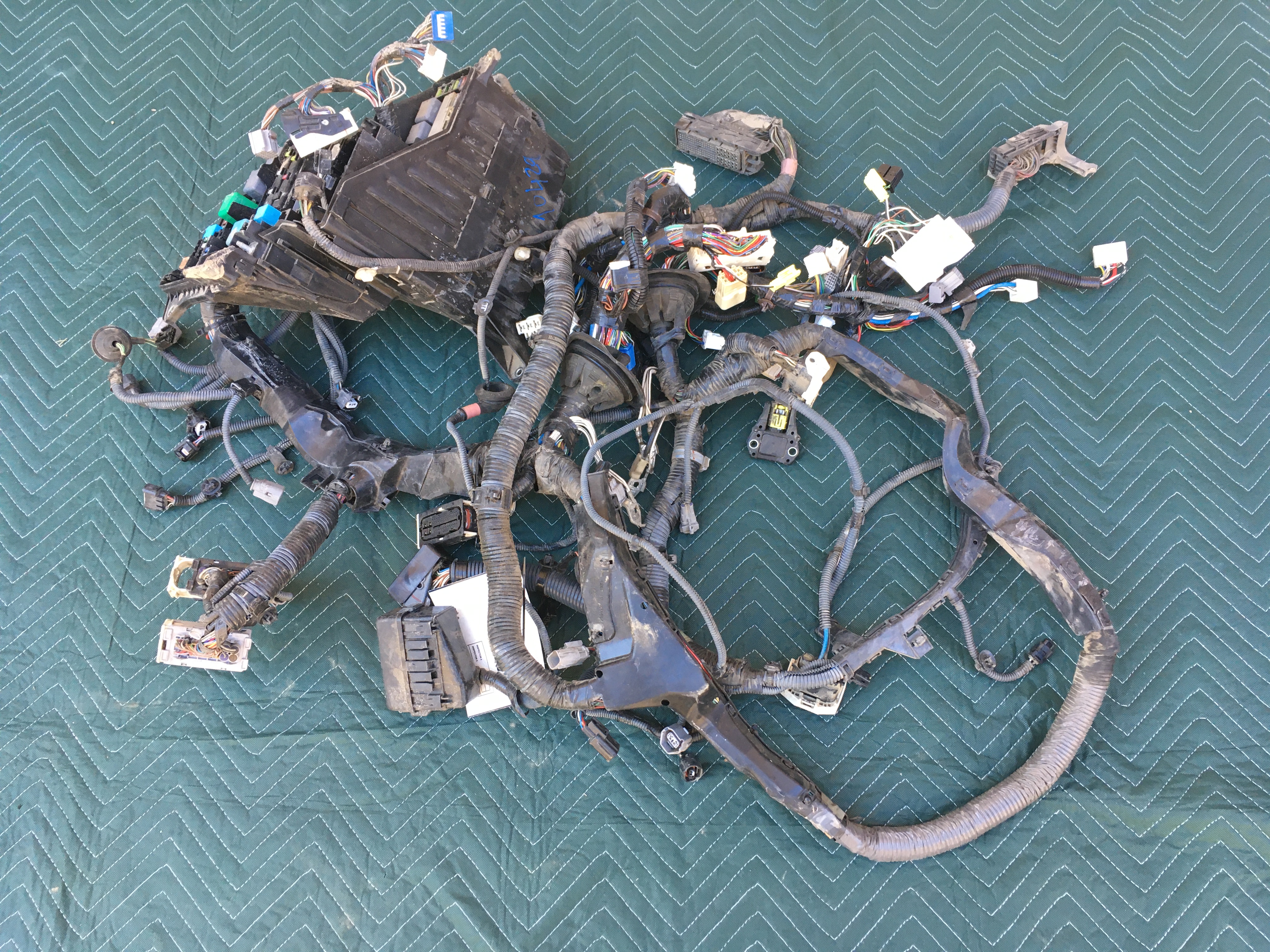

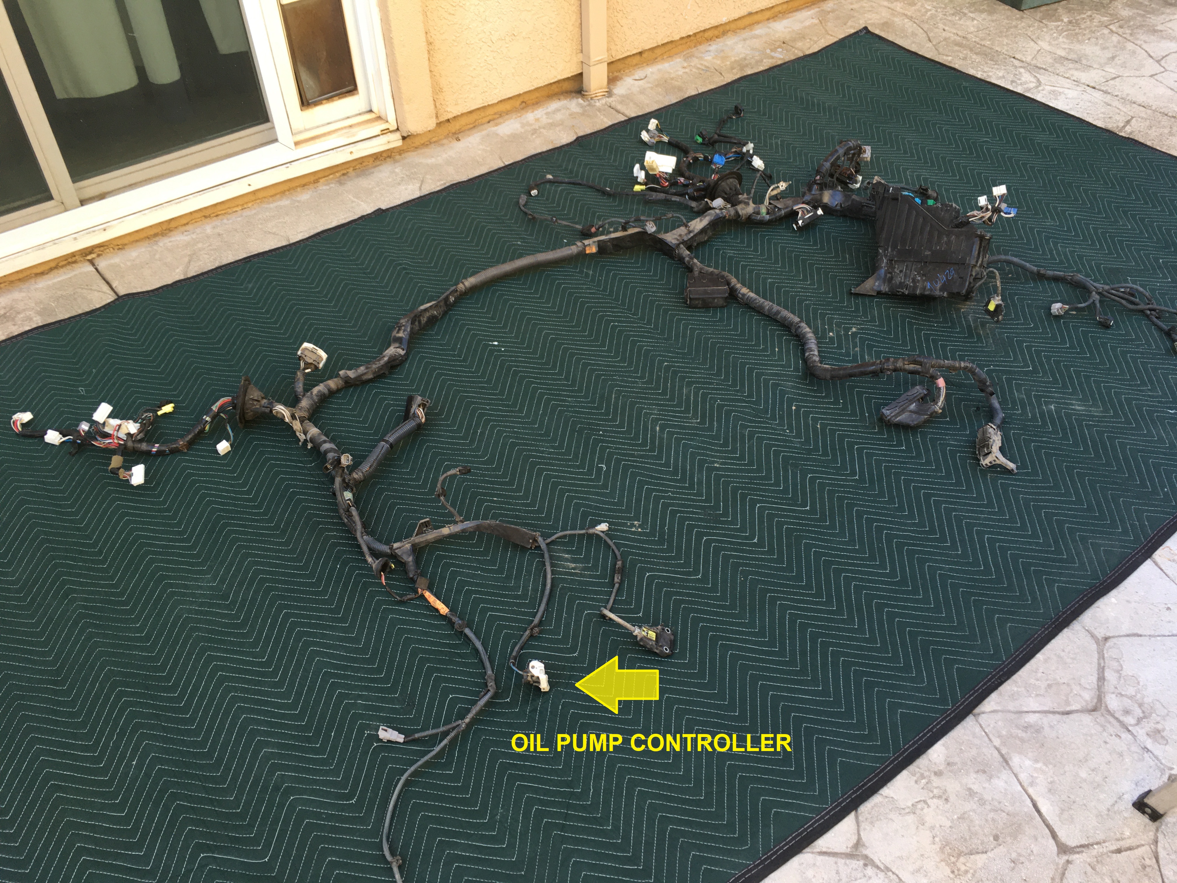

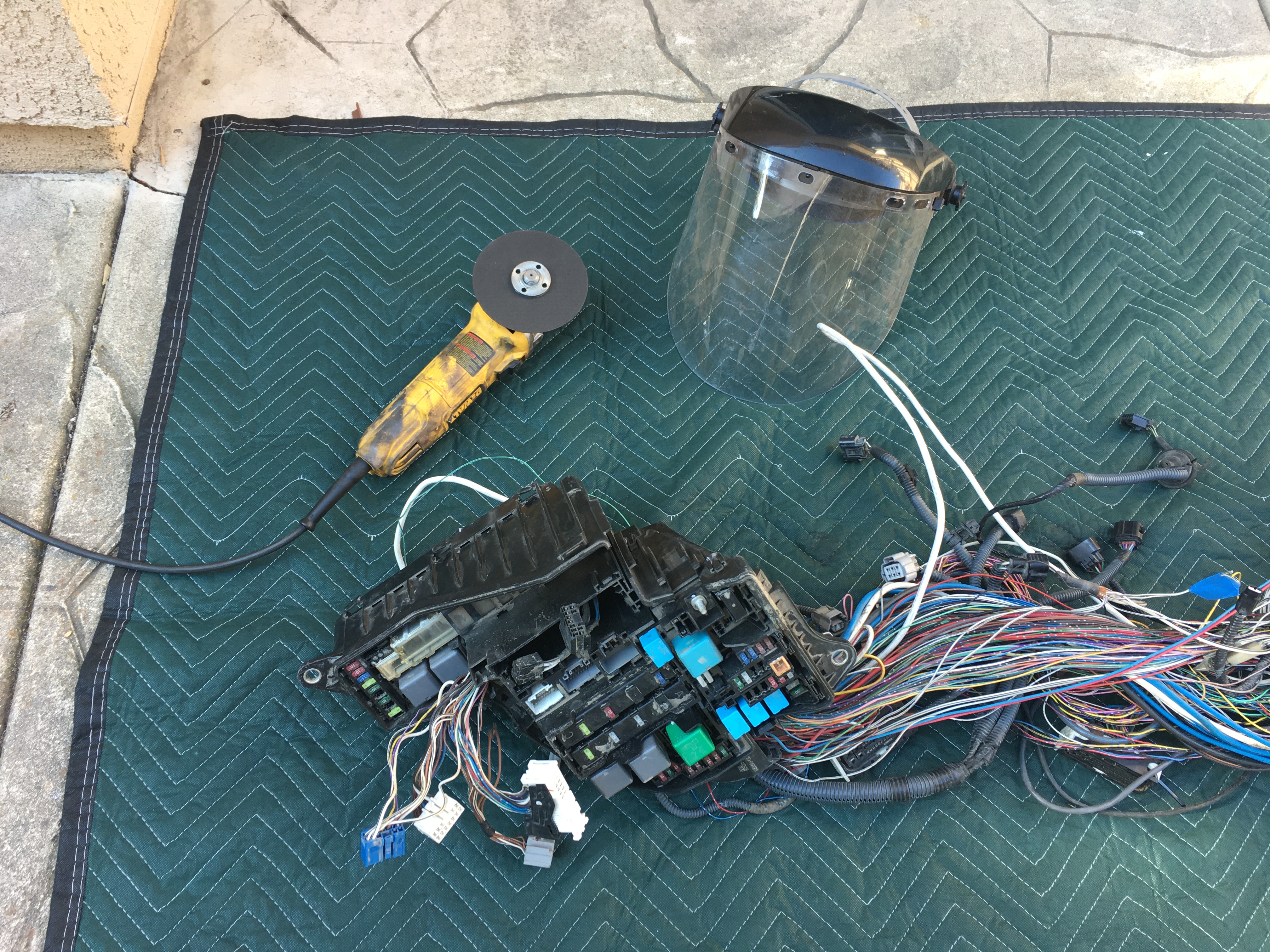

So I bought this harness really for that coveted inverter plug, laid it out in my back yard, and stared at it for a while
Gregski
Posts: 3171
Has thanked: 635 times
Been thanked: 1611 times
Post by Gregski »

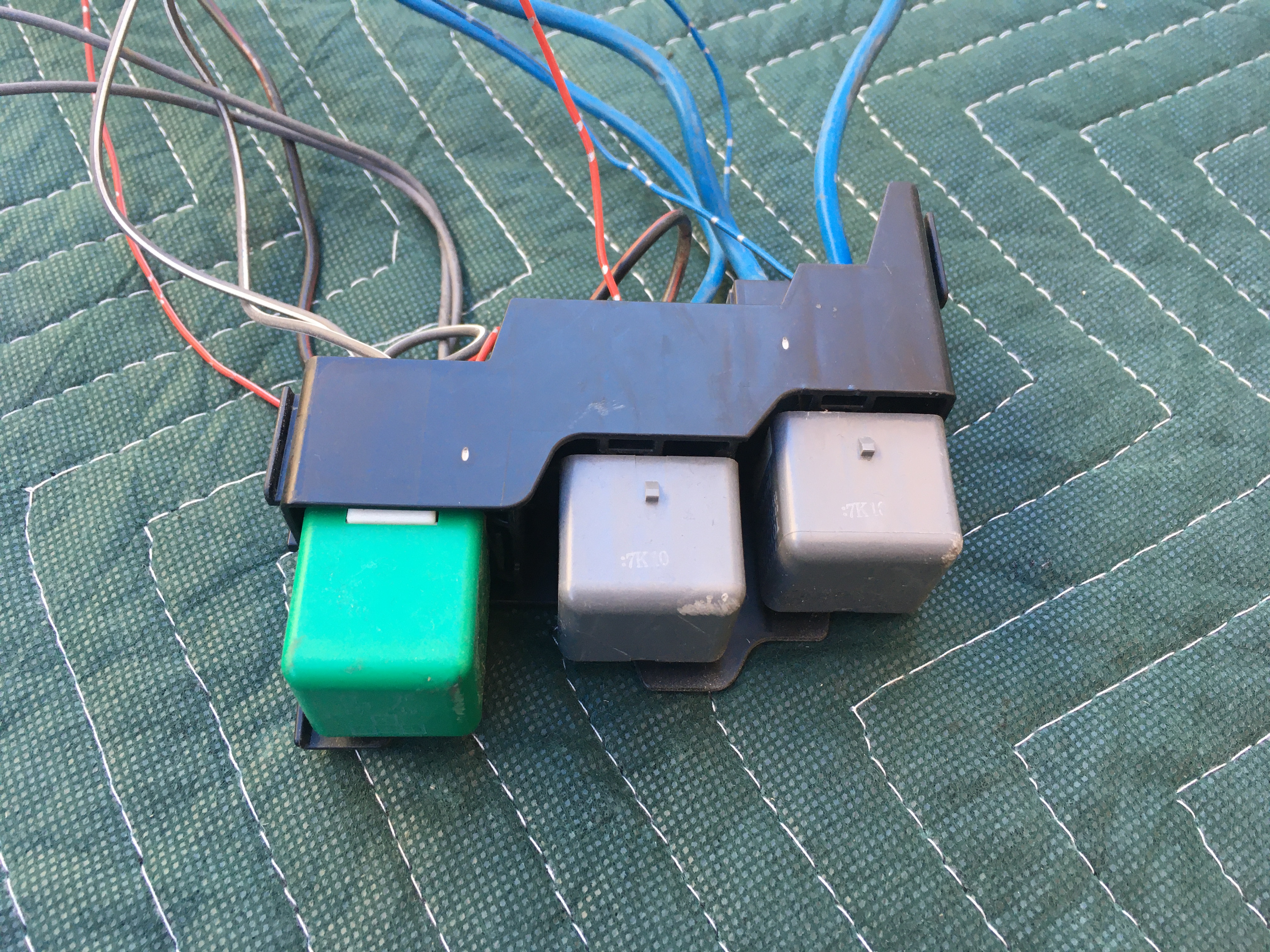

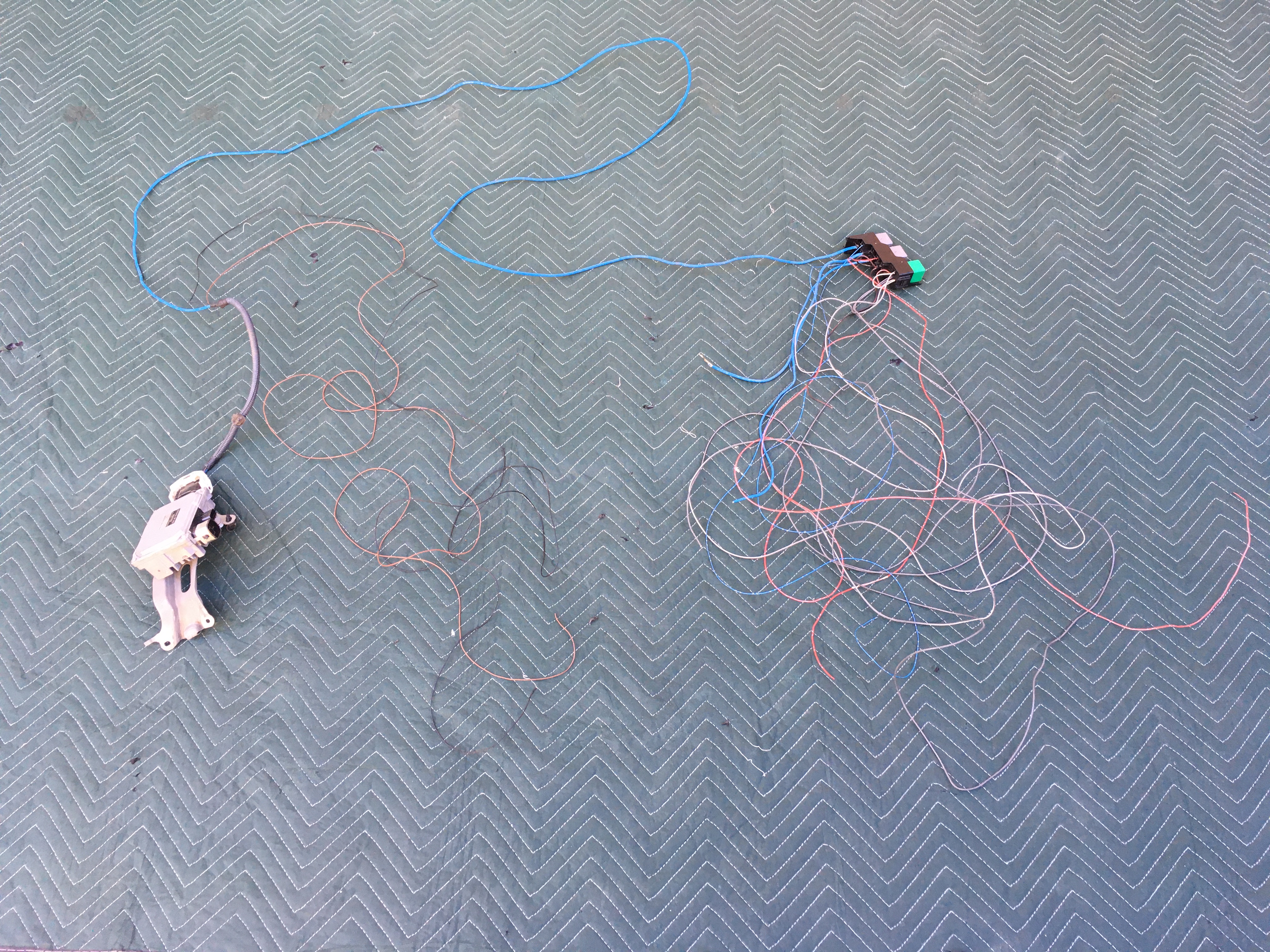

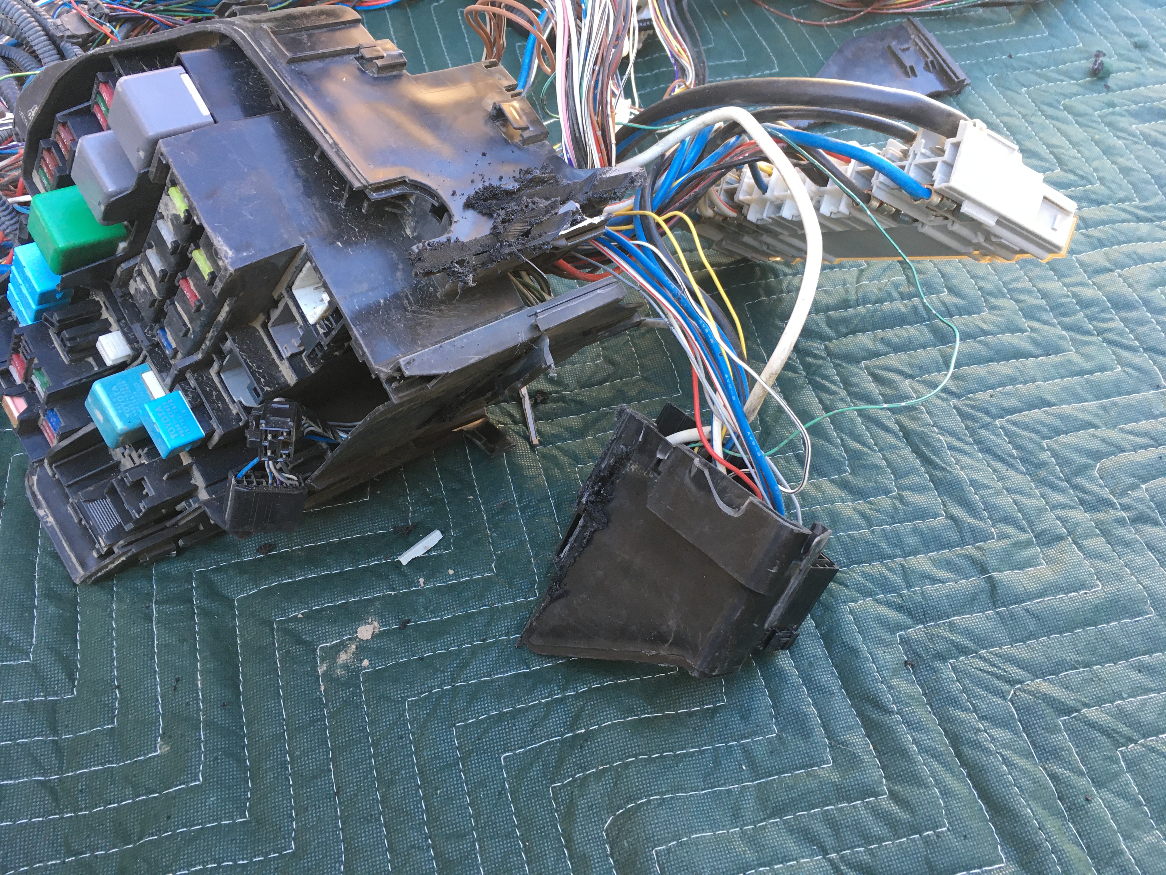

so there is no separate independent oil pump controller harness, it is part of the big @ss main engine room harness and needed liberating
and since I luv repurposing stock OEM connectors, fuses, and relays, I went after it all (and I have no social life)
great care was taken during the extraction process

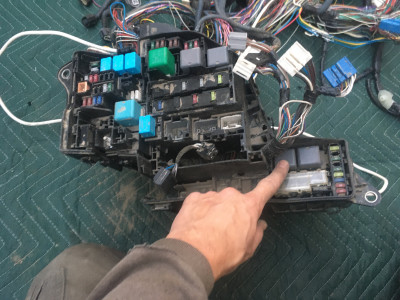

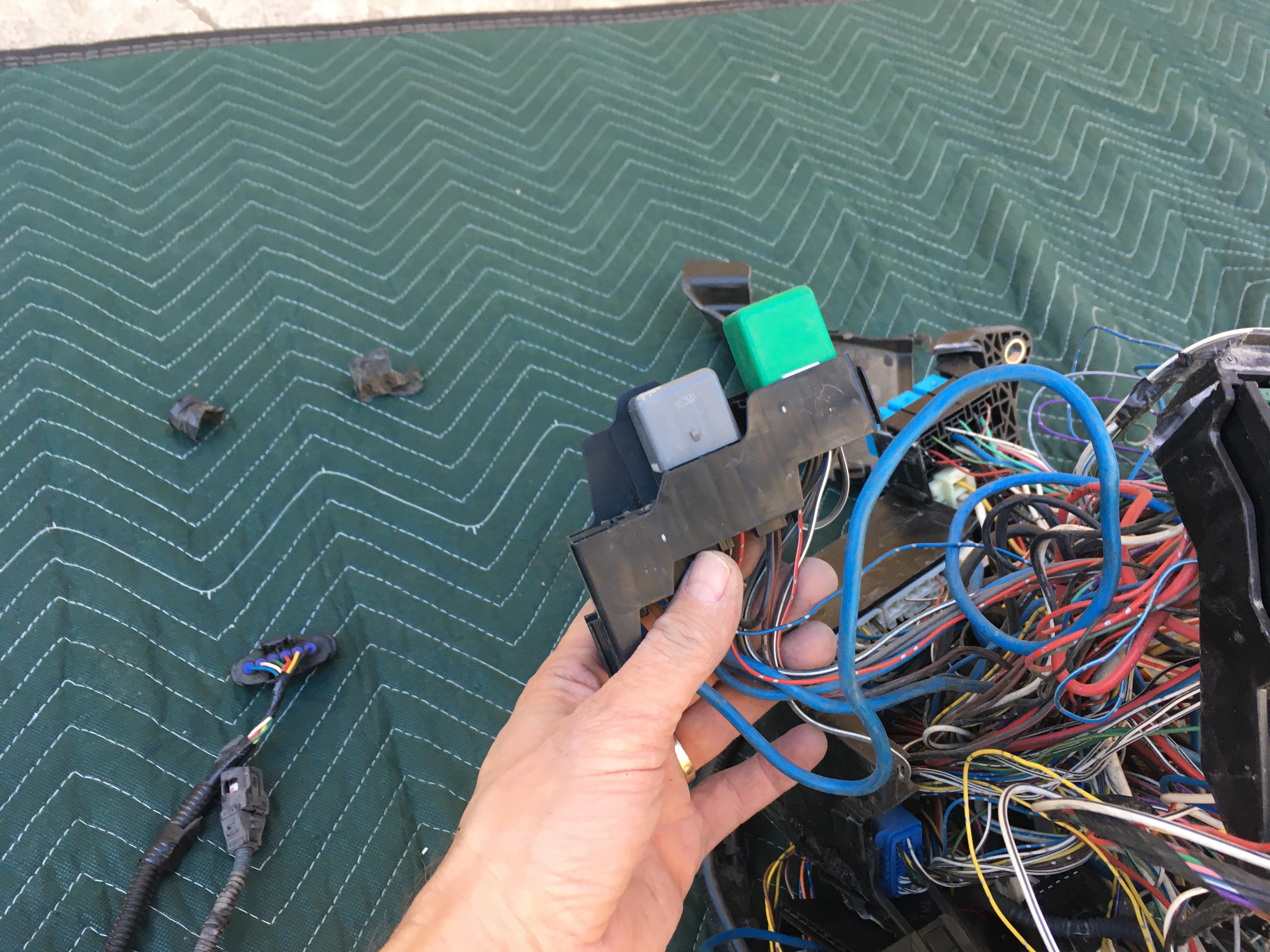

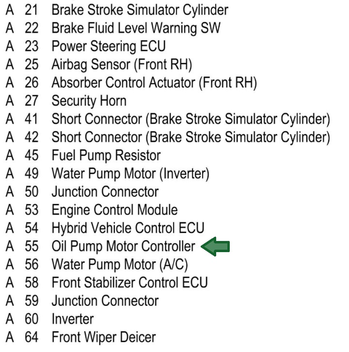

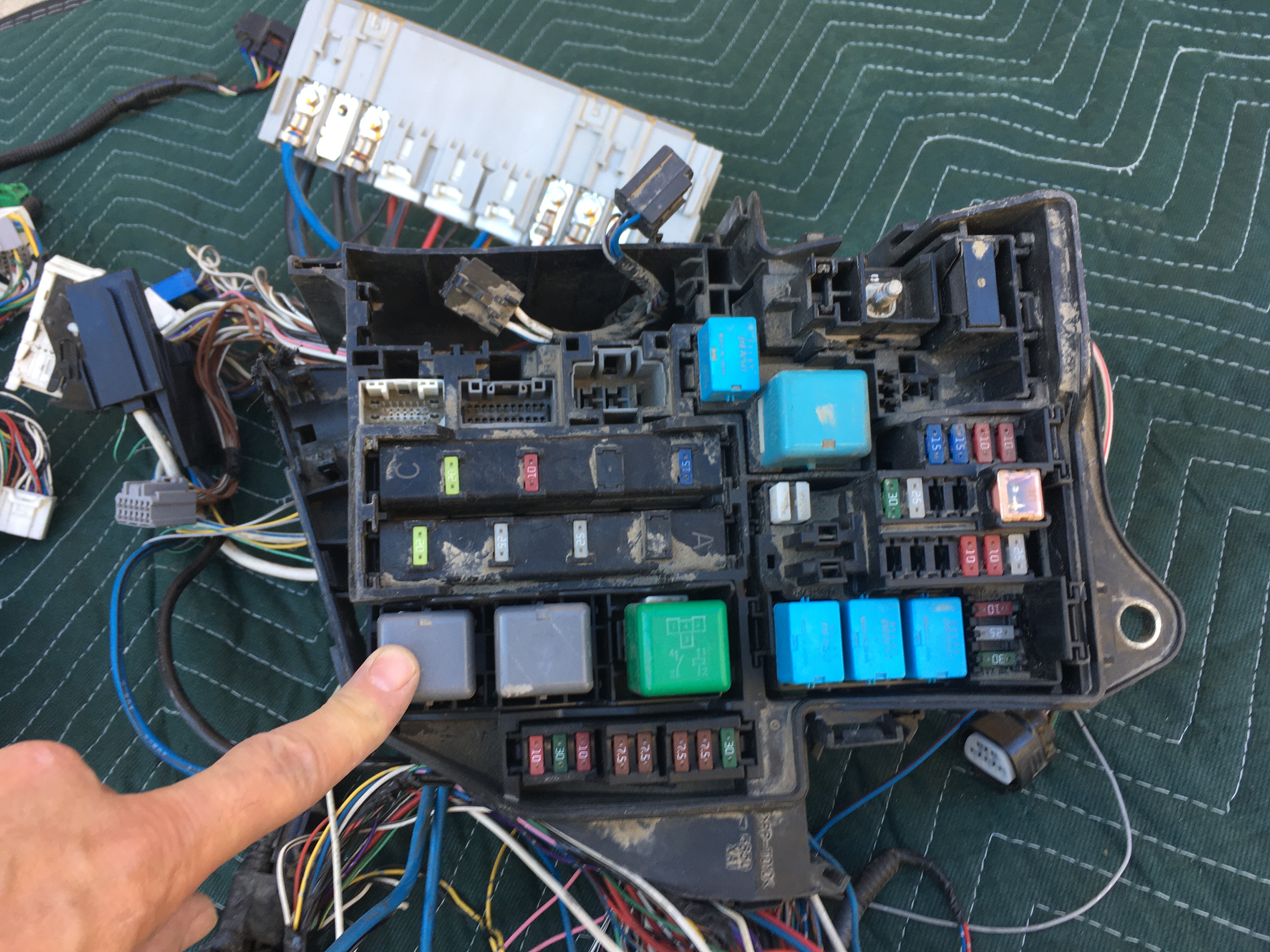

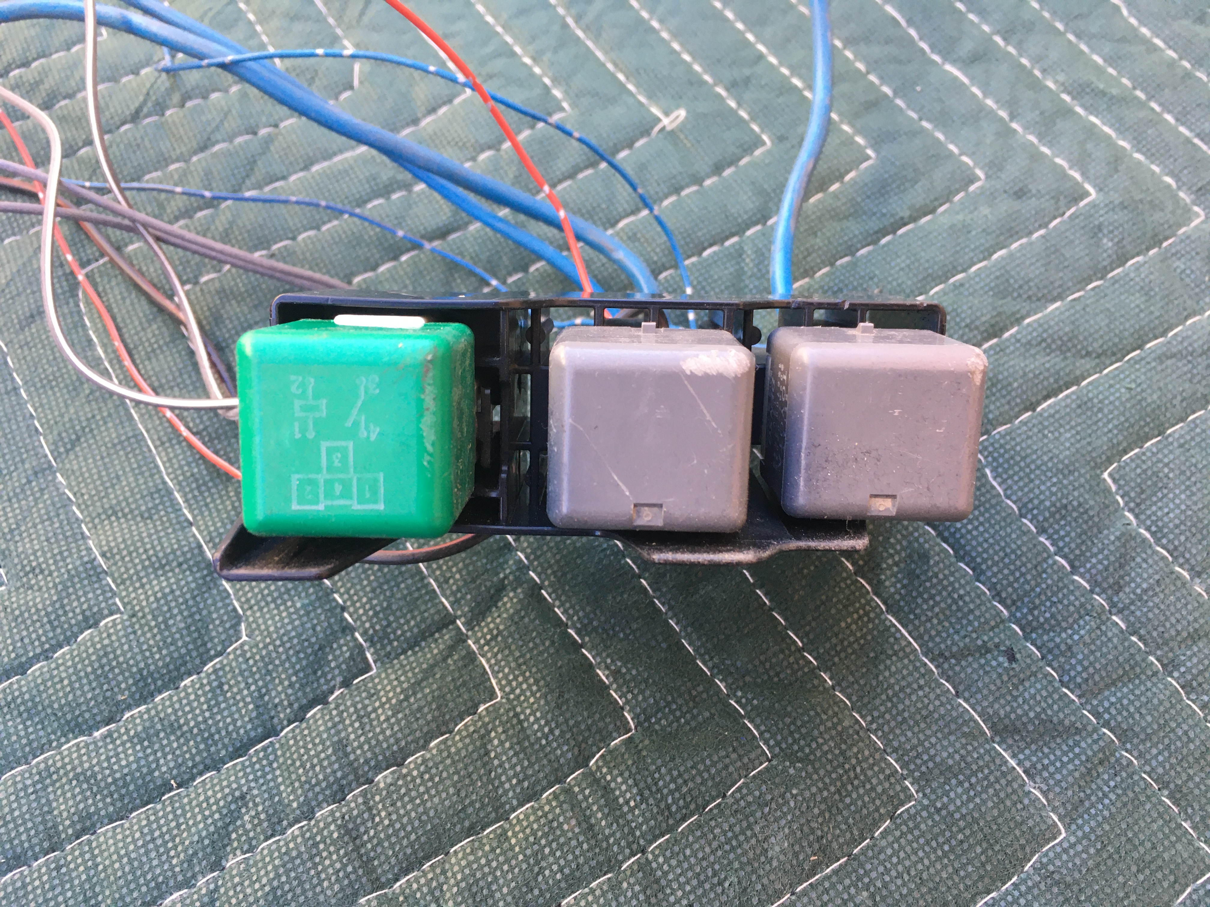

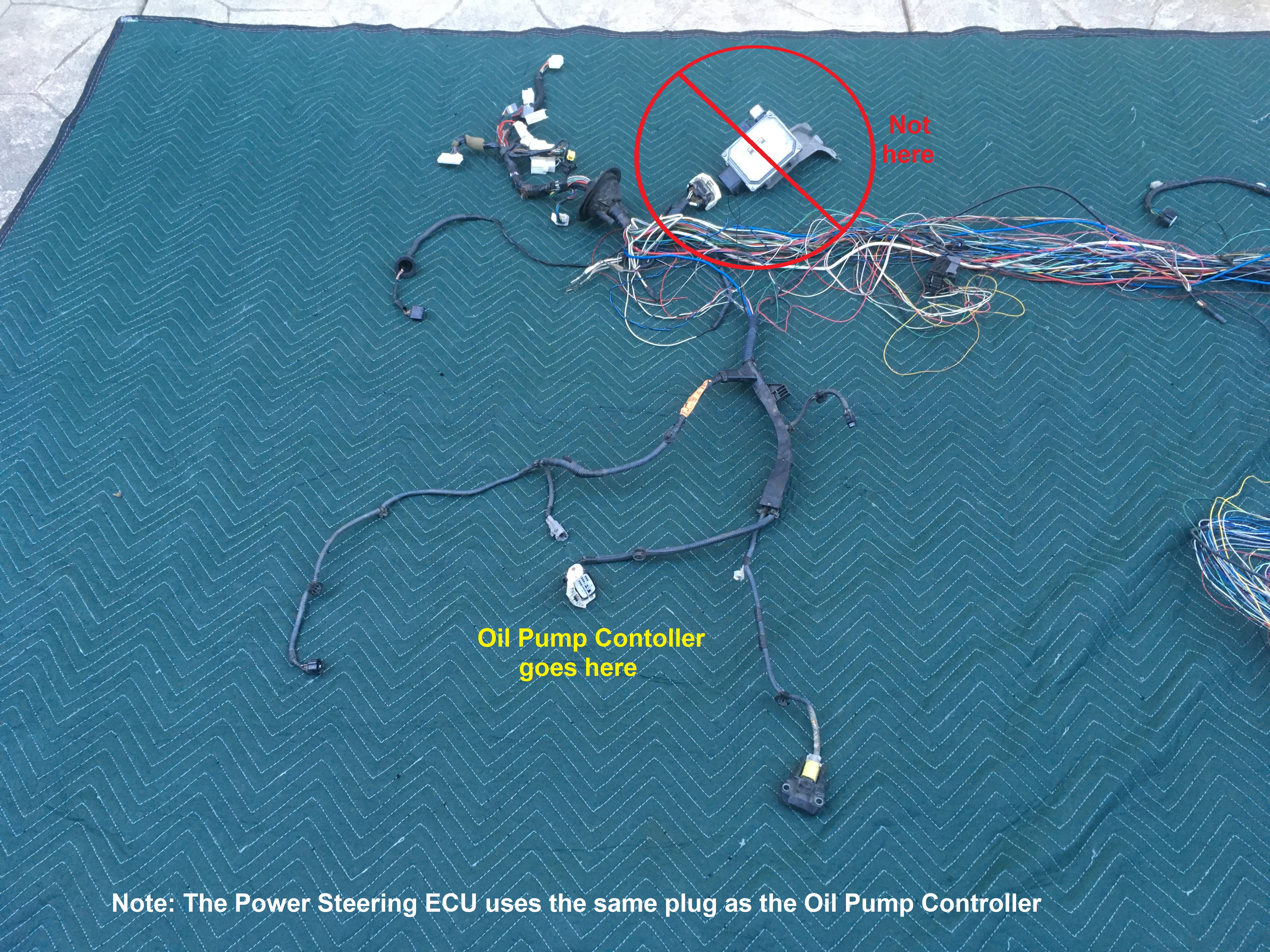

MINI CAUTION
It appears the Oil Pump Controller can plug right in to where the Power Steering ECU would go on that main Engine Room Wire harness, so be careful not to yank the wrong section after spending hours upon hours untangling them all (ask me how I know)
ah yes I am showing you the wrong relay as well
yes this is the WRONG wire harness for the Oil Pump Controller, this one is for the Power Steering ECU

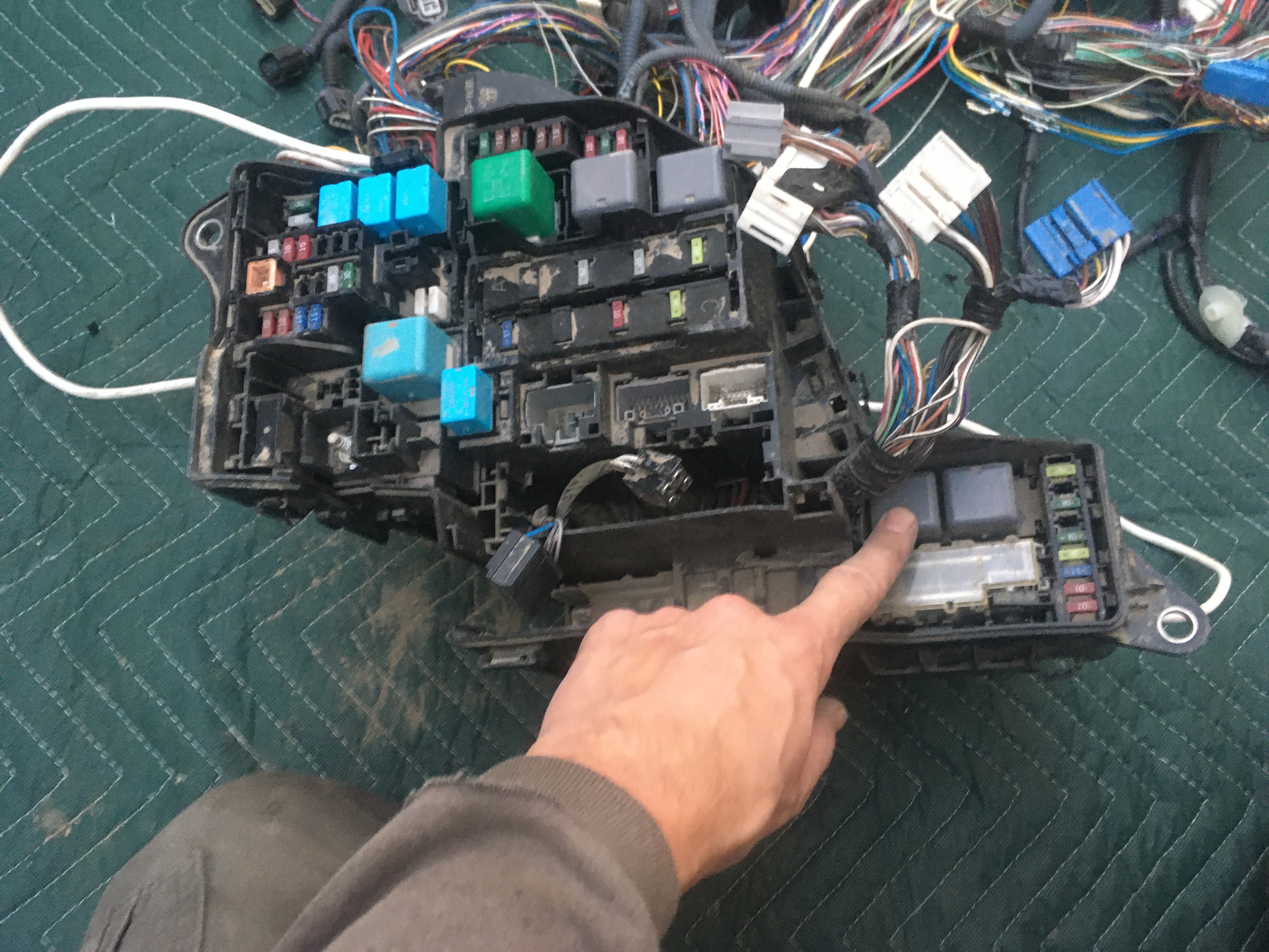

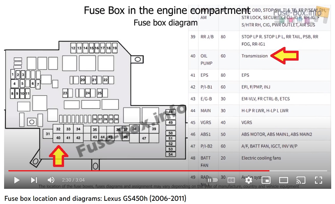

not my video but really well done showing us where the (2006-2011) Lexus GS450 heich fuses and relays live
here I drop you right to the point in the video where they show the engine compartment fuse box, the Oil Pump 60 AMP fuse is #40 and shows up on the list at around the 2:20 minute mark
xp677
Posts: 442
Location: UK
Been thanked: 15 times
Re: Lexus GS450h Oil Pump Controller Stock OEM Wire Harness n stuff
Post by xp677 »
Nice writeup. The easiest option is to buy a pump controller from a breaker which includes that connector and a pigtail (not uncommon as dismantlers often just cut the cables to parts). The wires can then be extended.
50A fuse and relay, I believe.
