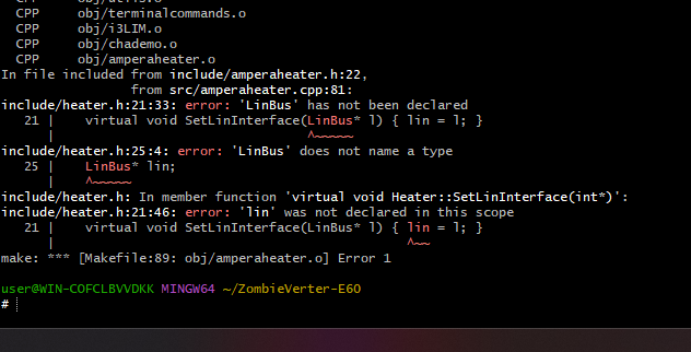

I tried doing and replicating the setcanhardware() but obviously i have a problem with keeping up where the poiinters and what declared and not.
i moved the setlininterface to the base class. and really not follwoing why and which variables i need to declare.
even the amperaheater files .cpp/.h that i didnt touch now it is upset.
im sorry that im dragging you guys this long but between damiens code and OI code and being sperated as each module has its own files.
I want to learn how to pass pointeers and navigate between classes.
anyway here are updated files and new errors. im looking online as well to figure my way but i did encounter and fixed other issues like the sleep for the TJA chip that worked and now the chip should be ready to take usart info.
Sorry for being a headach and a noope.

Been thanked: 1918 times
Re: Added LinBus class to libopeninv
heater.h needs to include linbus.h otherwise it doesn't know the type LinBus ;)

johu wrote: Wed Jul 05, 2023 5:37 am heater.h needs to include linbus.h otherwise it doesn't know the type LinBus ;)
Oh My god, i was that close. I just added linbus.h into heater.h and compiled with no warnings at all.
