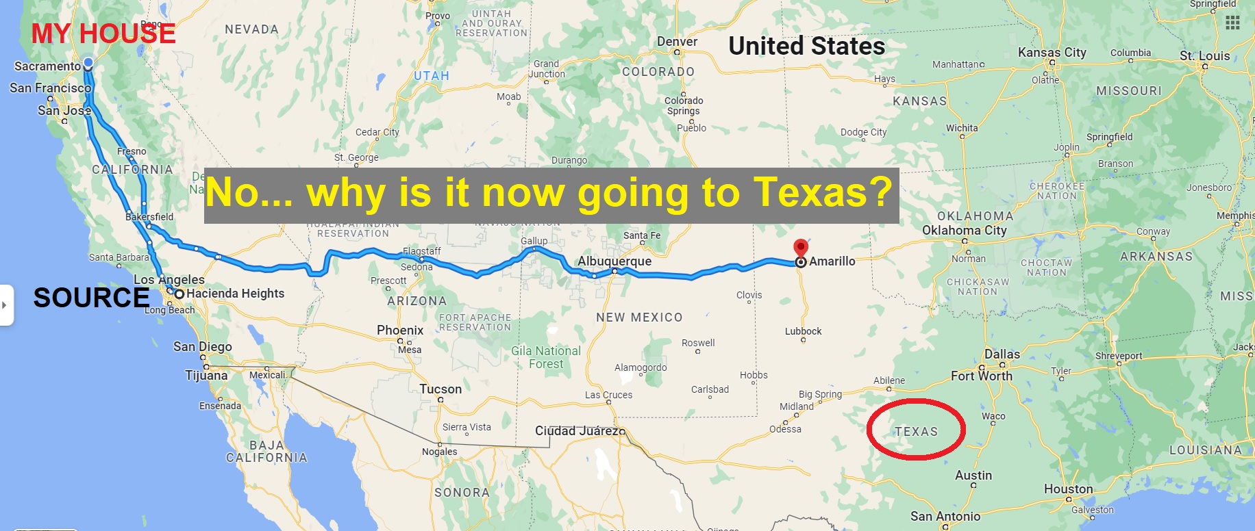

meanwhile on this episode of You Can't Make This Stuff Up ! YCMTSU
OUR throttle bracket is making it's way from California to California via Texas, and you wonder why this build is taking so long, well actually it drove by my house on it's way to Texas...

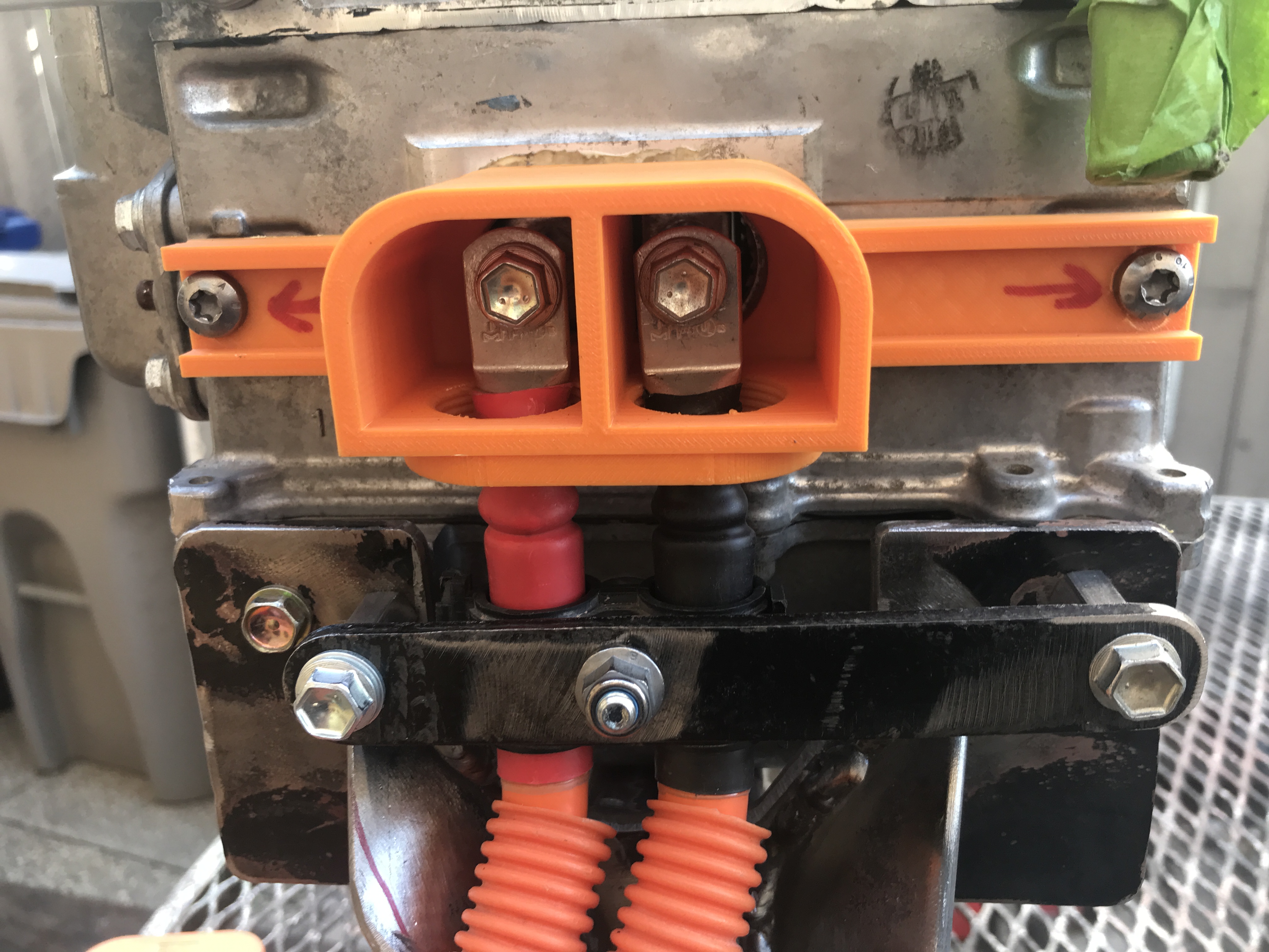

I decided to replace my PVC Ts on the inverter with this orange bracket
P.S.Mangelsdorf
Posts: 1230
Location: Raleigh, NC, USA
Has thanked: 323 times
Been thanked: 352 times
Post by P.S.Mangelsdorf »
That's clean.

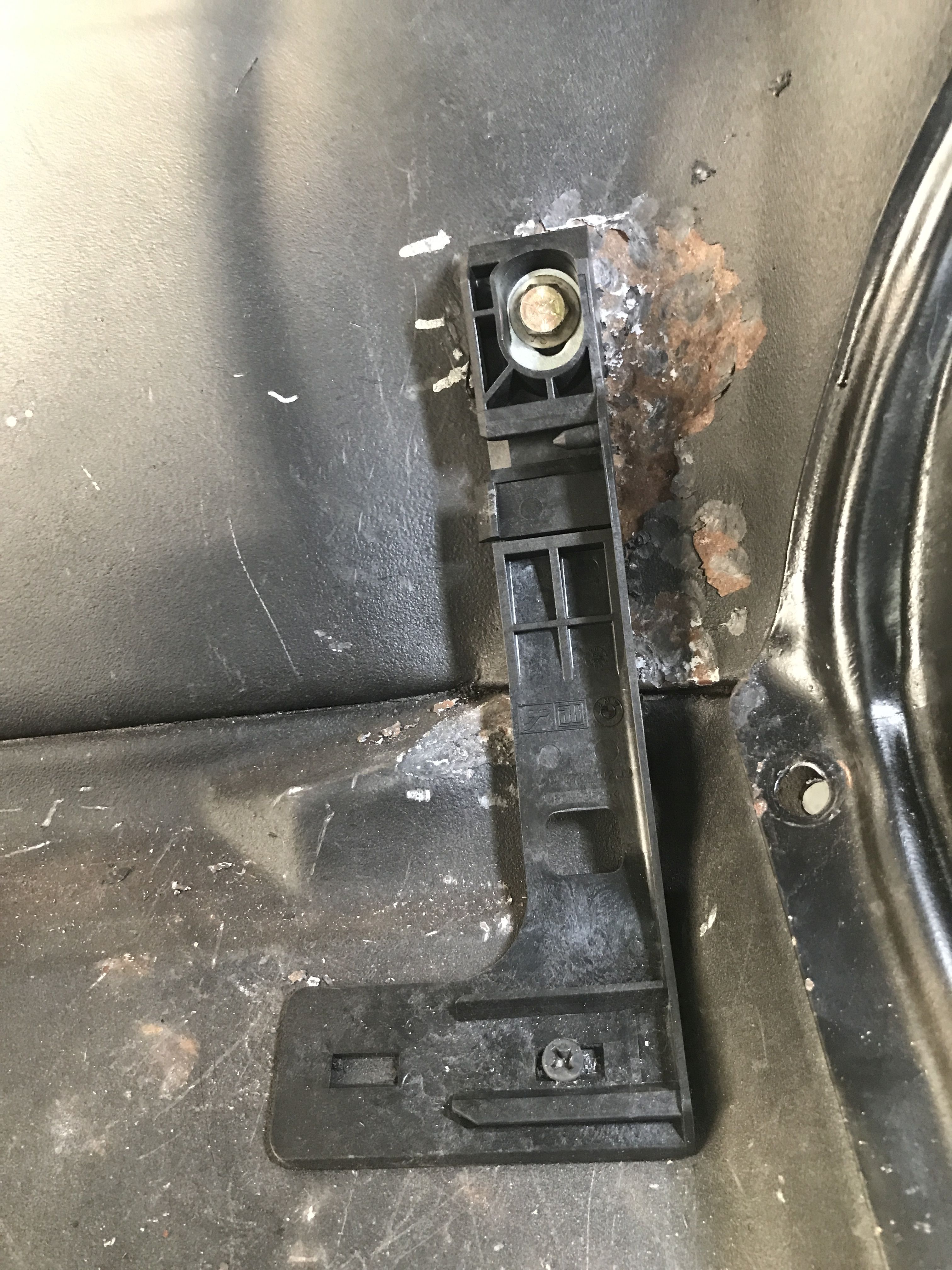

well well well, look what decided to show up, as my friend, Patrick said "a world traveler" the bracket for our BMW E39, E46, E53 throttle pedal part # 6762481
Gregski
Posts: 3163
Has thanked: 631 times
Been thanked: 1609 times
Post by Gregski »
nothing like buying brand new parts and having to modify them straight away, I really wish GM and BMW engineers communicated more better

some gentle persuasion was required
$4 bit coin bucks to the first person to tell us what them magnets are out of?
Fun Fact: if they ever go missing, flip your floor jack over... you're welcome !

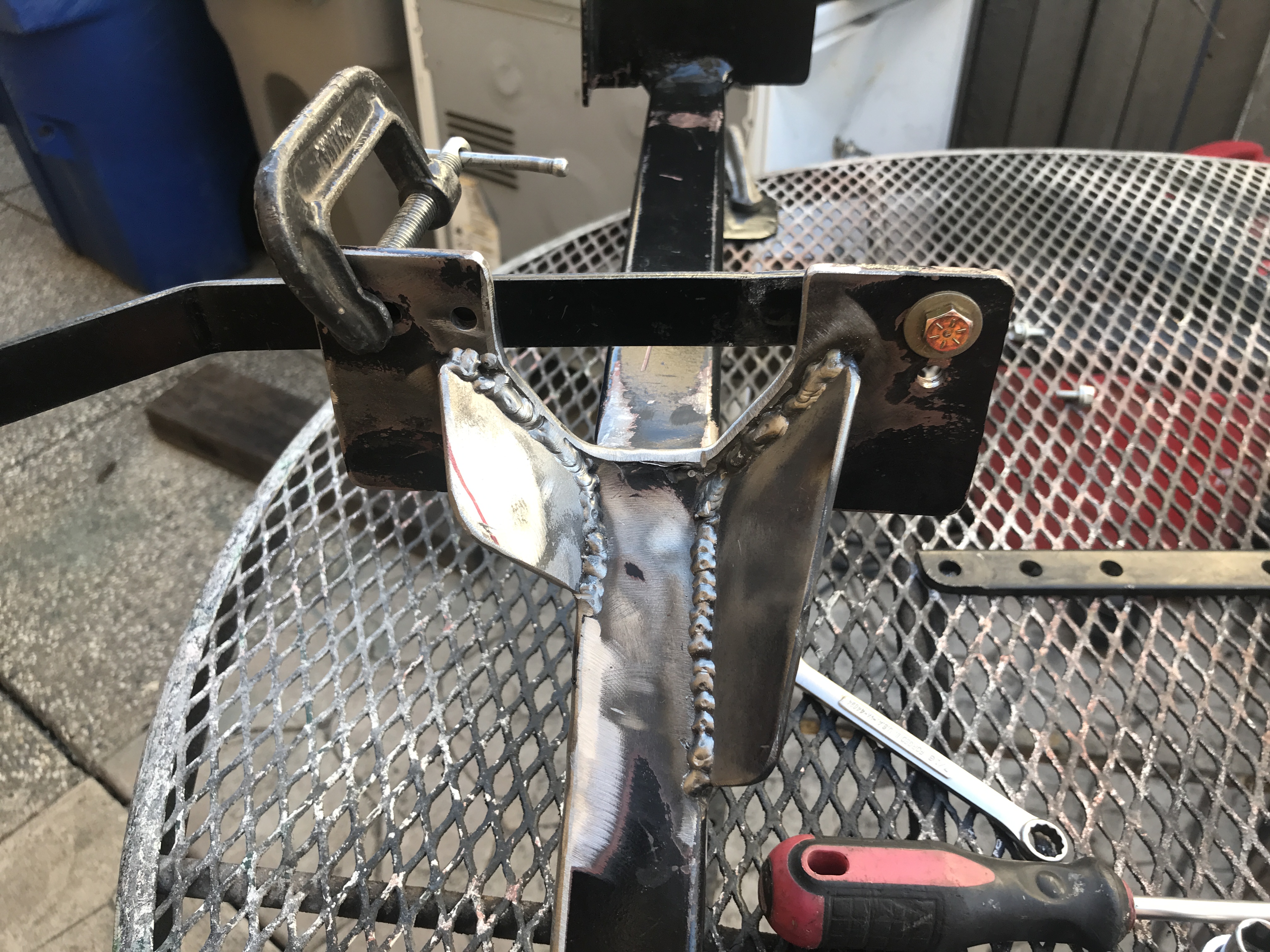

then I recalled that I wasn't too keen on 351 volt power lines hanging off the inverter on two M6 bolts so I decided to reinforce them with a custom bracket
as always we source our metal from only the finest of scrap piles
Gregski
Posts: 3163
Post by Gregski »
Fun fact the holes on the left are not at the same elevation as the ones on the right on the Inverter (but if I don't tell you, you will never know that I have a slanted bracket)
I'm very please with the way it turned out, and it's strong enuff to tow a boat

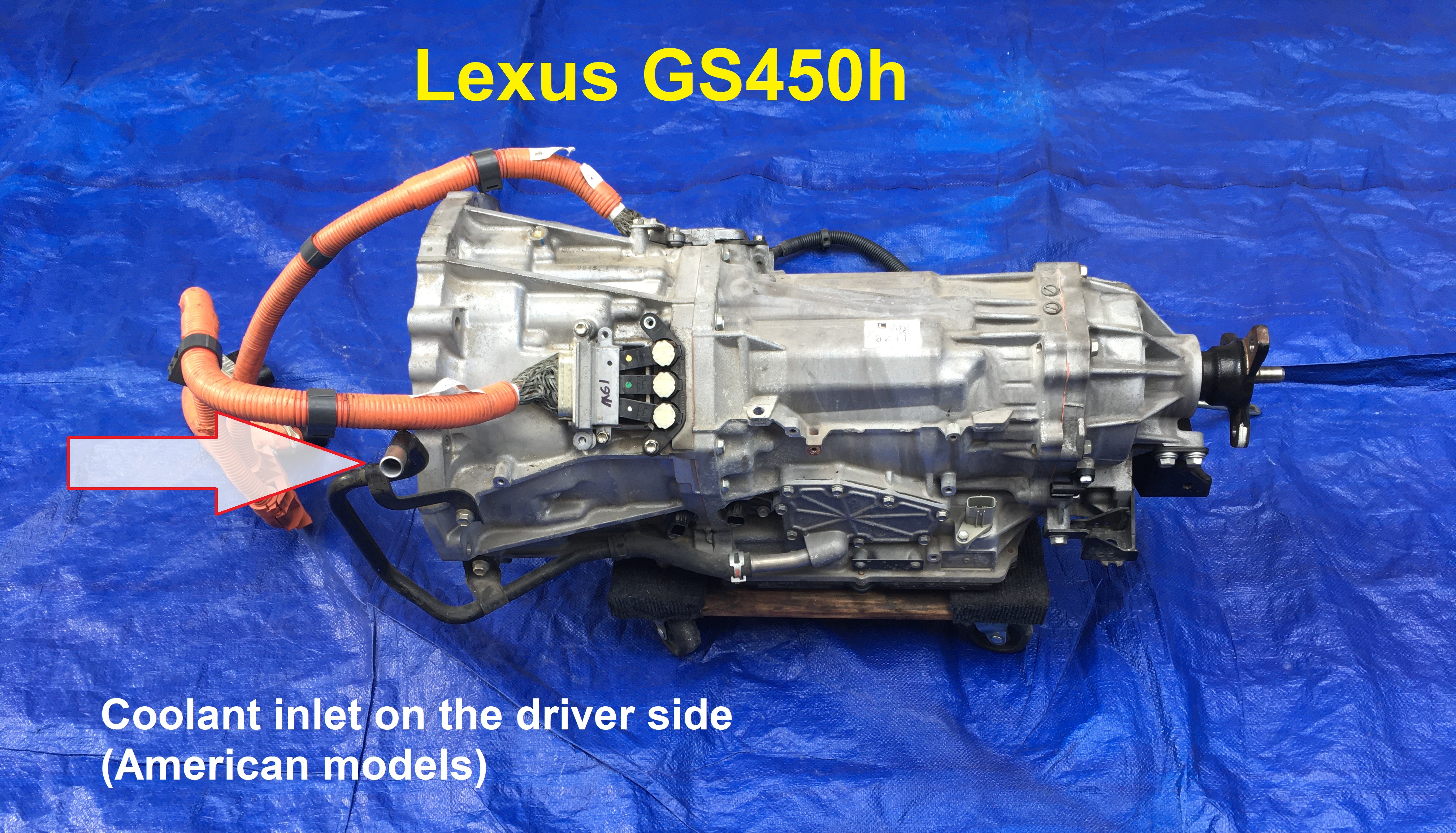

so back to that transmission oil top off which I have been avoiding doing, and here's why
Lexus claims for this to be a Maintenance Free Transmission (pronounced: good for 100k miles before you have to do anything to it) I recall this being attempted by automobile manufacturers in the past and it just takes simple tasks like checking the fluid levels and or topping off the fluid and makes them impossible to do later!
For instance this transmission does not have a dip stick, [unless you consider it's owner] and what appears to be metal dip stick tube, is actually an inlet for the coolant aka water cooling. and the best thing about that tube is that it is joined to the pressed in actual inlet on the body of the trans with a flexible rubber hose, so you can easily remove it / delete it as it is almost guaranteed it will interfere with the firewall in your conversion vehicle, and then you just run a rubber hose directly to that short stub on the transmission
Second, this transmission does not have a filler hole. That's right there is no unscrew this bolt and pour some delicious trans fluid in.
