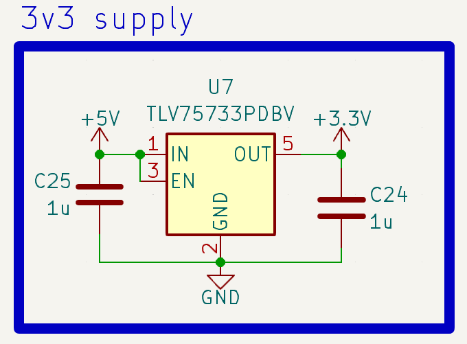

Re: Develop a QCA7000 board?
I'd encourage you to ave a look at the design I use (attached).
JLC parts:
* C311983 (TPS54302)
* C408412 (Inductor)
In this case I was running it at 5V with a TLV75733PDBV linear regulator because I needed both rails, and I often prefer to do this anyway in RF applications, but it's easy to reduce the voltage to 3v3.
This TPS54302 supports up to 28V input (30v absolute maximum).
Is the 68pF intended to be on the switched output? The data sheet says, it should be after the L:
- catphish
- Posts: 961
- Location: Dorset, UK
- Has thanked: 98 times
- Been thanked: 195 times
You're absolutely correct
See attached the generated example from TI PowerDesigner with the correct design.
Looks like I only build one board with this error and fortunately it wasn't for a customer!
