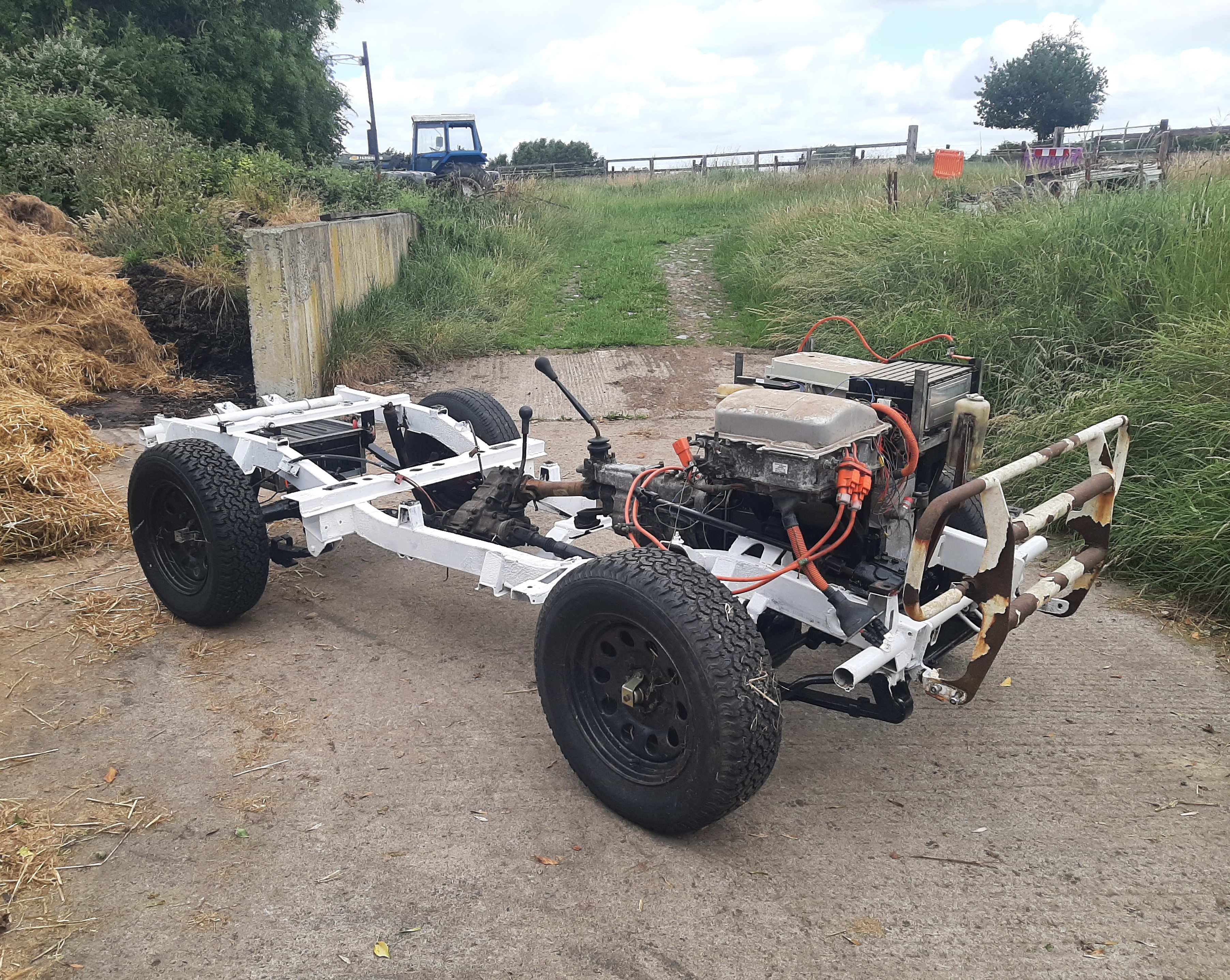

Finally been able to make some progress with this build.
I've done exactly nothing on it for almost a year, but after some staring time over the past few days I've started to hit milestones.
- I rebuilt the circuit of: Gen2 Prius inverter - OI VCU - 12v battery - 12v "HV" battery - lightbulb delta
This worked on a manual run once I increased the boost to >10,000
I then connected the phase wires to the terminals of the Siemens 1PV5135 motor and connected a 100v HV source.
The HV source was applied as demonstrated by Damian at the 19 minute mark of the FOC tuning video.
It took a little bit of figuring out and some help from Johu on the Prius Gen2 adaptor board development thread to get the motor to spin.
Turns out the Gen2 inverter kills off phase current below a certain PWM swing.
This means I'll likely have to program a higher boost setting.
To make the siemens spin I needed to:
1) short circuit the 60 watt bulb once precharge was complete. I couldn't get it to spin with any parameter combination when the bulb was in series.
2) Set fslpspnt to >=10 Hz
3) Set ampnom to >= 20%
4) Set boost to ~10,000
When testing I did manage to melt my light gauge phase wires, blow my lightbulb delta bulbs and get a desat error at the end.
So over the next few days I hope to get a better handle on the parameters that suit this motor best and to test it with a throttle pedal and encoder connected.

From the depths of hell, the Samurai lives!
Yesterday I got it moving under EV power for the first time (see low def parent video of rusty car linked below).
It's been a long time since I wrote a post here.
Absence largely due to difficulty getting body panels to repair rust (still being held up as evidenced by rusty body), project not being where I live and spending much of this year on a ship.
Somehow the Samurai has survived my many attempts to abandon it.
The set up was with 180v of the 360v Zoe pack, and Siemens 1pv driven by Gen 2 prius inverter.
I didn't go any further or faster due to a combination of tuning bugs and a rare triumph of common sense:
  • No cooling connected :)
  • No brakes connected :)
  • The motor motion was violently jerky and needs tuning :twisted:
  • The throttle was only reading 16% pressed, despite moving through the full range of programmed digs :twisted:
I'll back date this build thread now with some photos and requests for help on various issues.
As it stands, POA is:
  • Finish battery boxes (post to come)
  • Fix HVJB bug (post to come)
  • Set up basic cooling loop
  • Set up brake vacuum pump
  • Fix throttle bug
  • Tune motor with full voltage pack connected
All of that before I go near the holy trinity of BMS:Charging:DC-DC :)
Video:
https://drive.google.com/file/d/1_2Tfym ... sp=sharing
