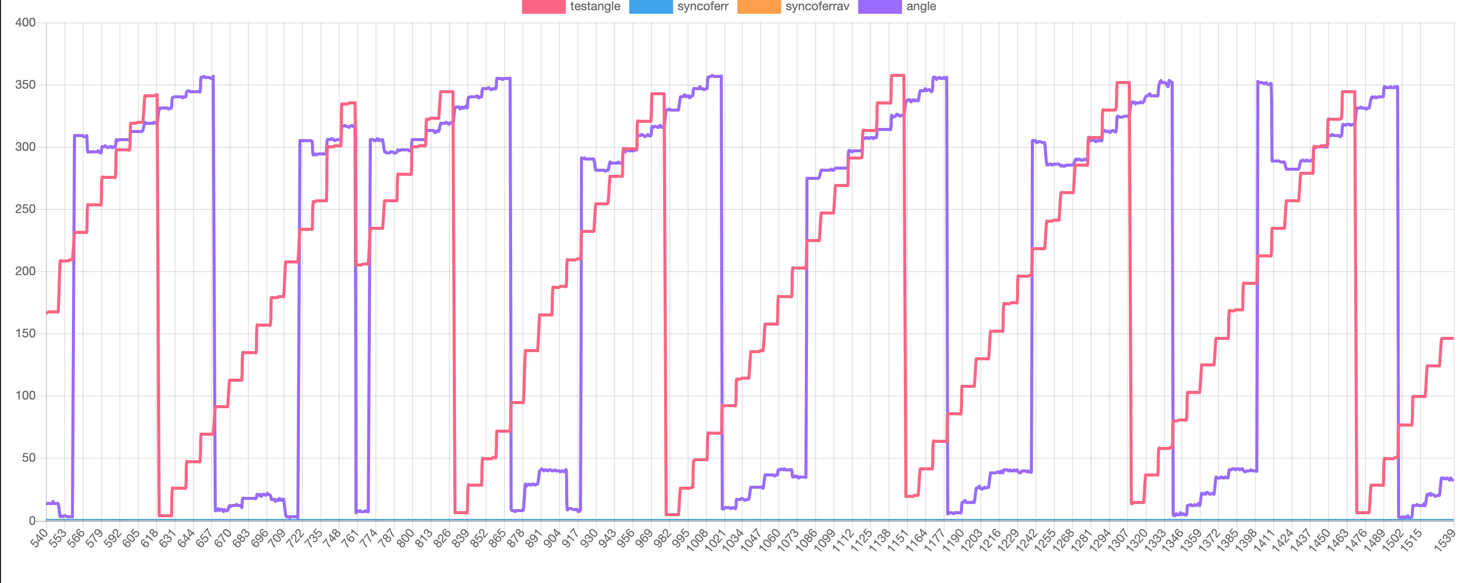

Seems to plot now, suspiciously the angle and test angle seem to be the same regardless of syncoffs value

Pete9008
Posts: 1801
Has thanked: 102 times
Been thanked: 350 times
Re: IPM Motor - Auto-setup
Post by Pete9008 »
One step forward ...... :(
Doesn't look right, fairly sure both are showing the resolver angle but no idea why, had another look through the code and it seems to be ok. Does a resolver check now read the angle correctly?

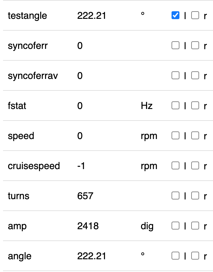

Values are exactly the same

I was hoping it was just a problem reading the parameter (and so the new code would still work) but it looks like it is something actually in the test code. I'll have another look :?
No idea! Had another look through the code and I just can't see how they can be the same.
If you plot both in resolver check mode do they still track (testangle shouldn't be updated at all in that mode)?
Assume the value of syncofs still has no effect on them in test spin modes?

syncofs still has no effect. I've been trying to follow the code as best I can and can't see anything.
Test angle stays at 0 in resolver check

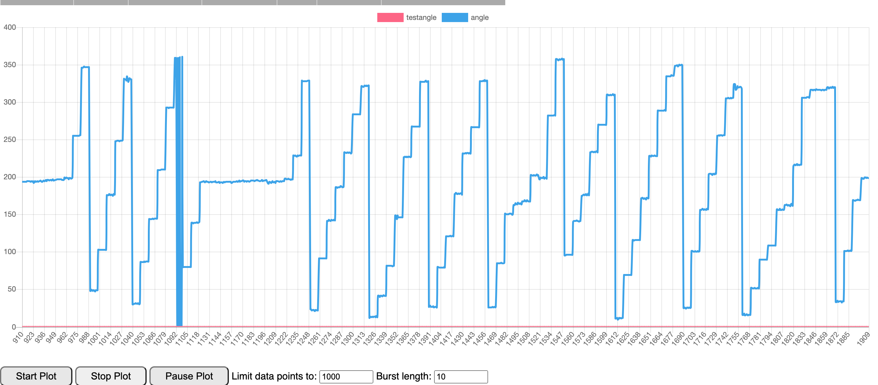

Getting there now. Forward test doesn't spin anymore though. It starts to rotate then rotates back. I tried more Id but no full rotation.
This one shows I had incorrect ratio for motor pole pairs and resolver pole pairs

No idea why the forward test isn't working now, had changed a small bit of the code round there (just to zero the error parameters in that mode) but nothing that should affect the rotation. Just had a look over it and can't see anything obvious.
Looks like there are still some plotting artefacts there that aren't helping. I've started using a burst length of 1 which seems to help a little.

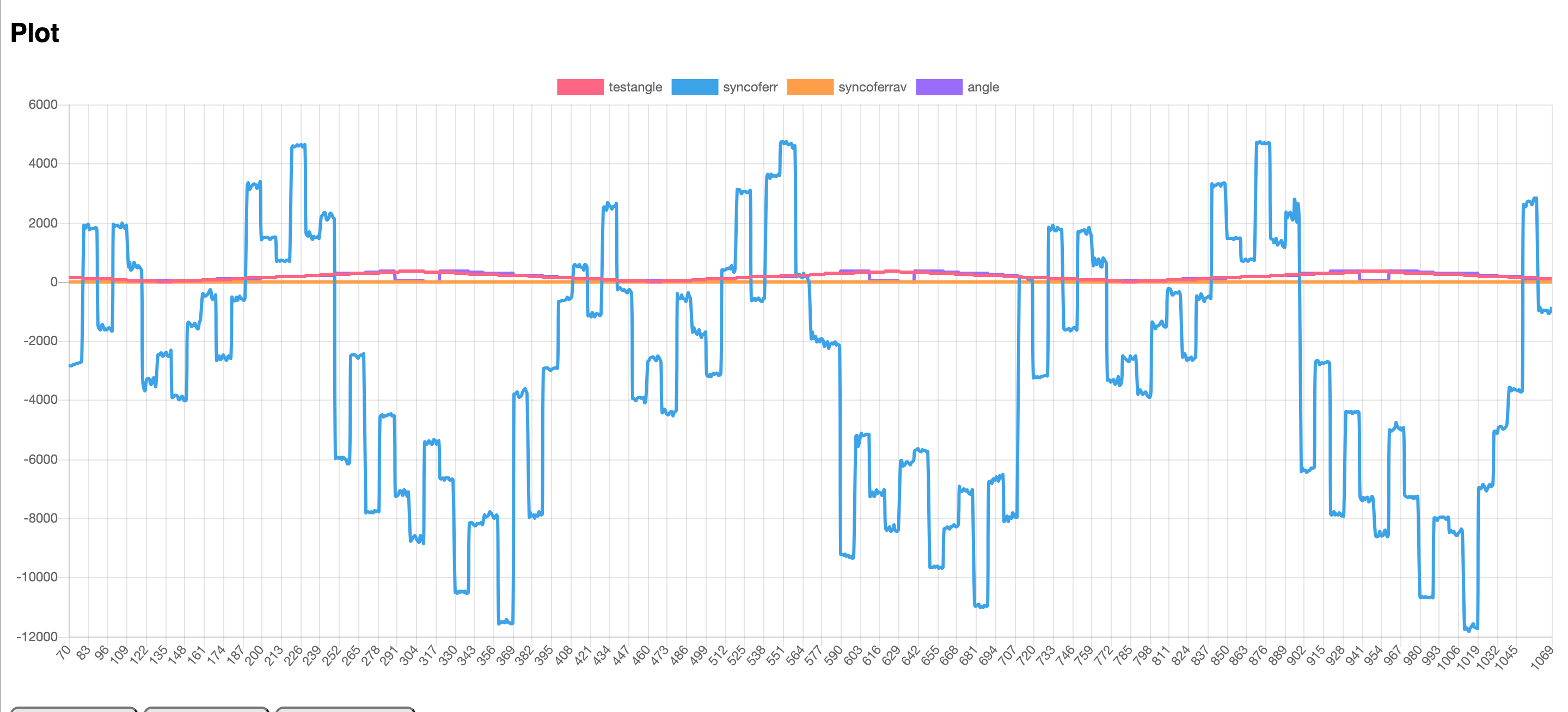

I let it run a minute and it resulted in an average error of 11778.
I put this in syncofs and run another minute
average error was 0 after this.
I then though I'd try normal running and the motor started spinning up and accelerating without any throttle input. Still progress :D

Looking good although it realy should be following the field better than that, those errors seem very large. What Id are you running at the moment?
What syncofs value did you get using the iq null method?
Edit - which motor is this?
Edit2 - something also doesn't look right on the second plot, there is no way the syncoferr trace averages to 0, there must be a lot of other stuff going on that isn't being captured by the plot??
