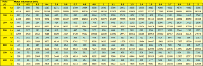

Been thinking about how to setup the controller gains when first setting up a new motor and have come up with this:
These are not intended to be final values, just a way of getting something sensible in there for initial tests. Might also be worth starting a bit lower initially, say half the value, until confidence is built up (to reduces the chance of control loop oscillation from setting them too high).
The values in there are just based on parameters published for the Outlander front generator, rx450h and mgr. Including others would probably improve accuracy but the values for these seemed to fit well with theory and I could find them and so will do for now!
The spreadsheet used to generate is attached if anyone wants to have a look at it or add more data.
The idea is that you use the inductance value that the phase check test gives and the voltage you are running at to look up the values to use for kp and ki. For example in Bigpie's case of 0.2mH and 44V above you would set kp to around 508 and ki to around 9632 for the initial spin tests (and then drop down to 73 and 1376 when running at normal 96s pack voltage).These are not intended to be final values, just a way of getting something sensible in there for initial tests. Might also be worth starting a bit lower initially, say half the value, until confidence is built up (to reduces the chance of control loop oscillation from setting them too high).
StartingGains.ods
- (21.29 KiB) Downloaded 180 times

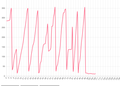

Just posting latest findings. I don't seem to get getting an average error. Maybe I misread last night?
This is Bi Directional the the ki kp increased by a factor of 8
Running in forward mode but with no manual id, looks to give decent resolver feedback.

Re: IPM Motor - Auto-setup
It still doesn't seem to be following the field correctly
What does it do on a forward spin now? (until that spins reliably there's not much point in trying to find syncofs)
Have you checked the phase resistances, is it possible that there is a problem with the motor?
Edit - not sure why the average error would have disappeared
Edit2 - Assume the missing bits in testangle in the first pic are due to wifi dropouts?

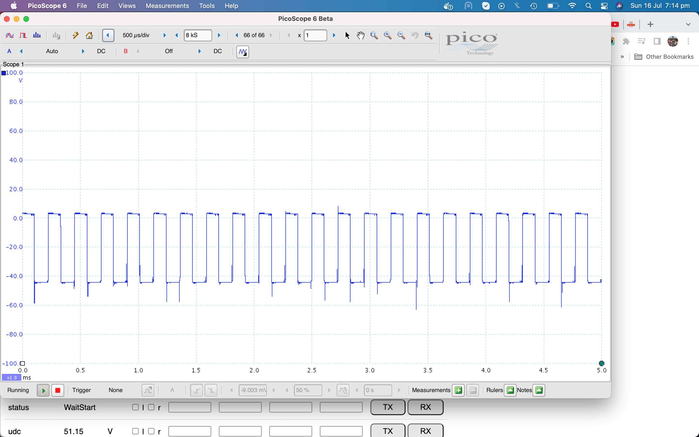

Only had 1 probe to hand tonight. Each output phase with respect to HV gnd. This is fwd dir and 35 amps id
I span this motor with sine firmware the other week
All looks good.I span this motor with sine firmware the other week
Can't fault those waveforms (why are they negative though if measured relative to HV gnd?), all the IGBT's appear to be working fine.
I'm out of ideas again.
Can't quite tell in the video, was the spin with the sin software much smoother? They should be virtually equivalent, both should apply the same rotating field to the motor.
I clipped the ground to the phases and poke the probe to the negative:D I think it span smoothly with sine and also old manual mode
