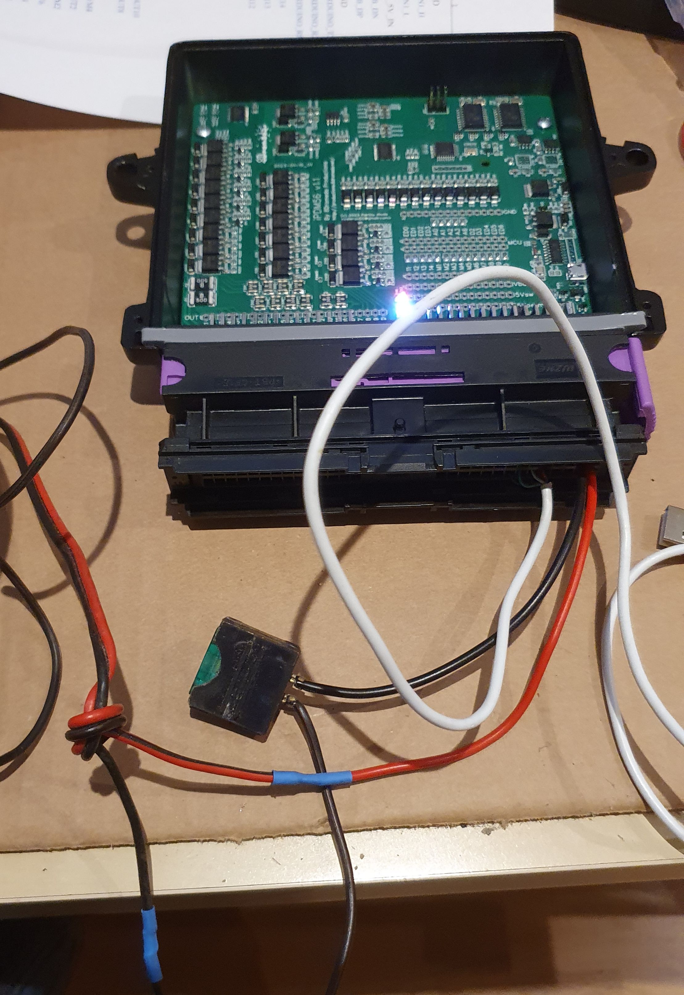

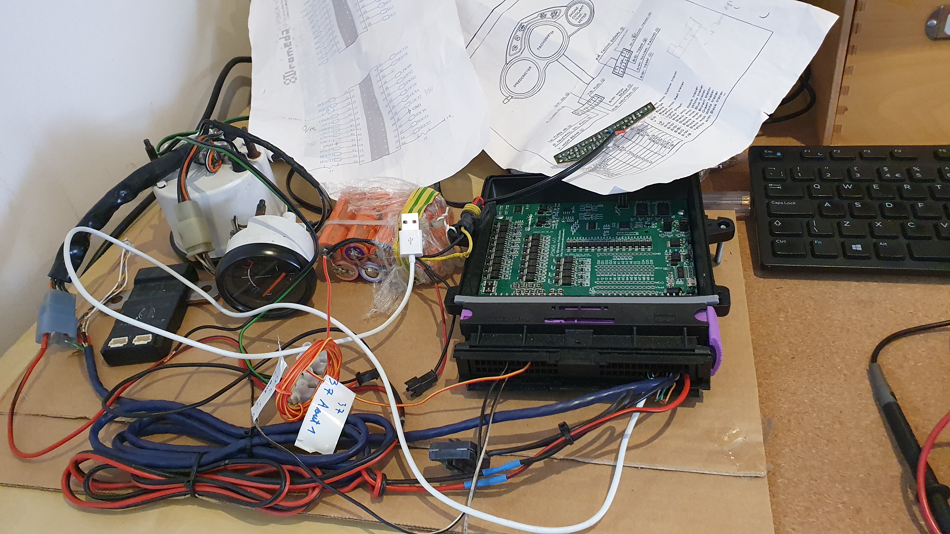

I have a rev 1.1 board here:
I hope it gives someone starting out the confidence to do "the big things".

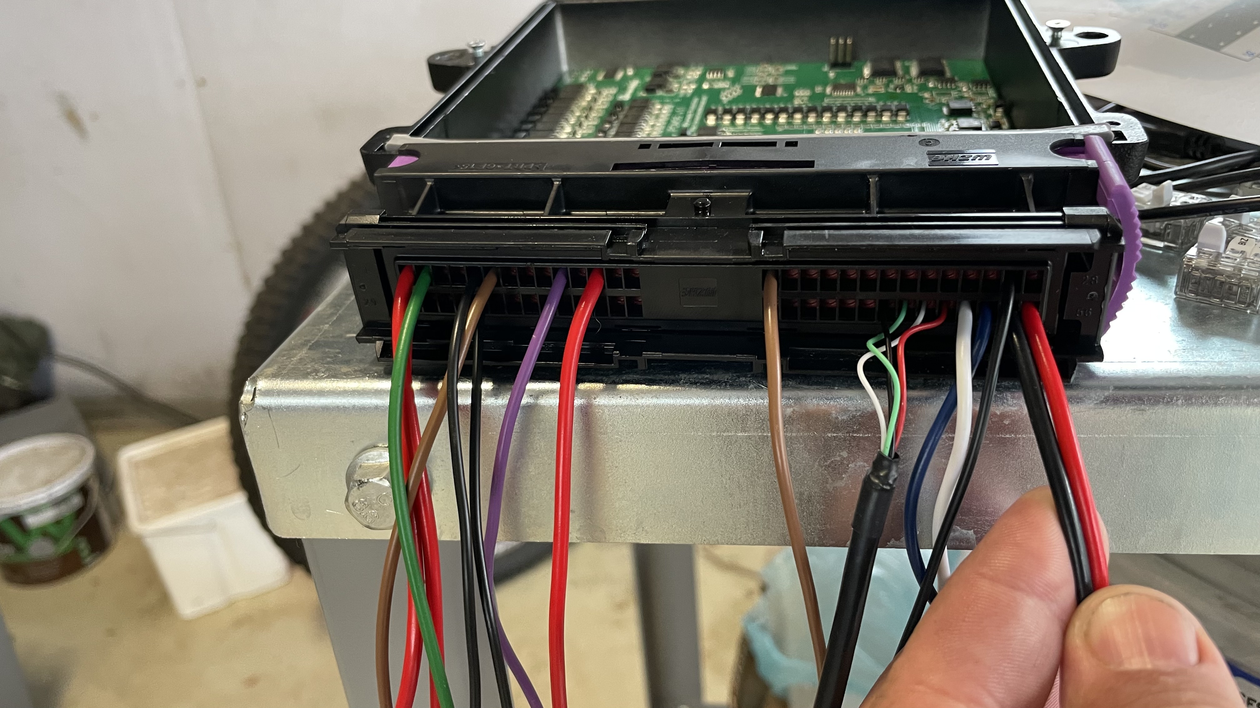

Done:
  • Board check
  • Solder connector and mount to enclosure
  • Working with the pins
  • Programming (testing indicators):
  • First contact with ISA current sensor via CAN

Better a small update than none:
Have wired up the ISA current sensor & resistor, but still need to take the board out to replace R97 & solder jumper connectors for the CAN termination.

First success!
I have soldered the jumpers in and replaced R97 (next to the MCPs) with a 1k through hole one.
Following that, with
ipdm::can_receive(ipdm::can1, handle_can1_frame);
commented back in I'm getting some comms on 0x3C3 & 0x3D2:

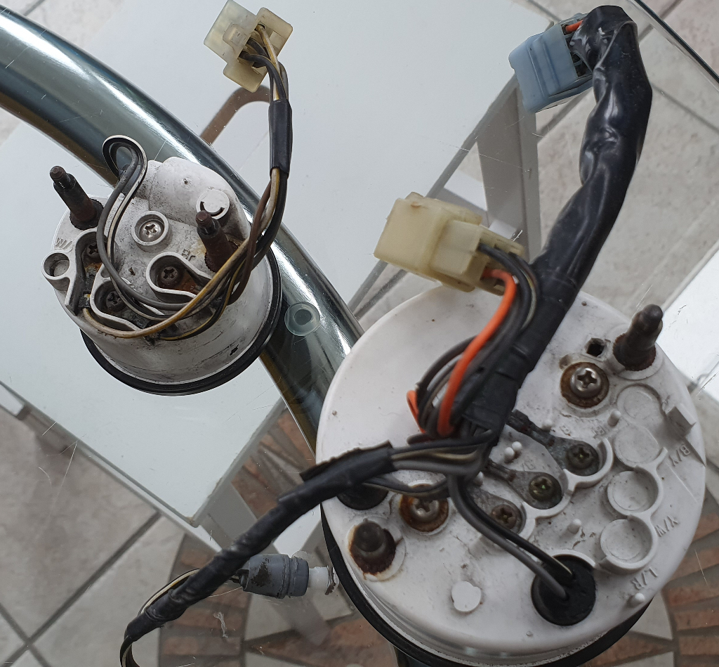

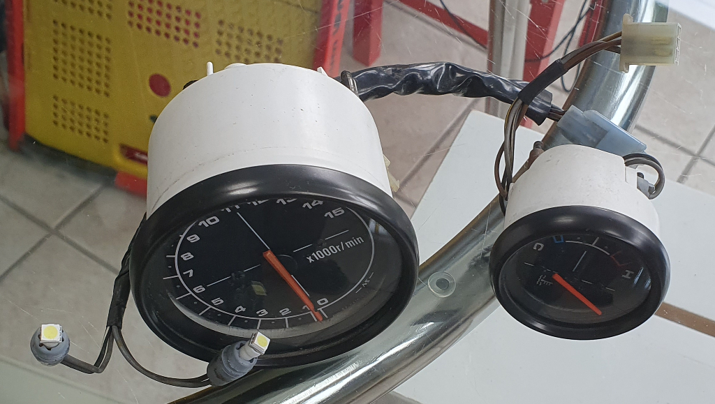

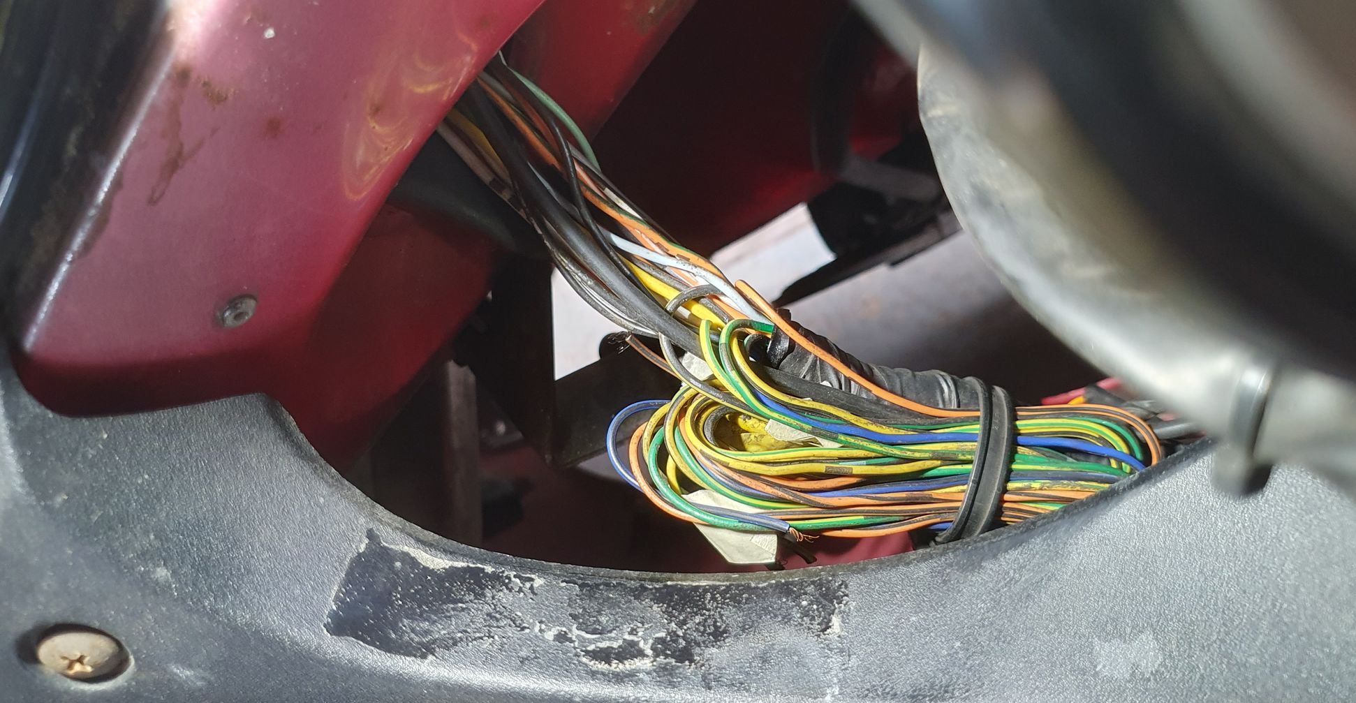

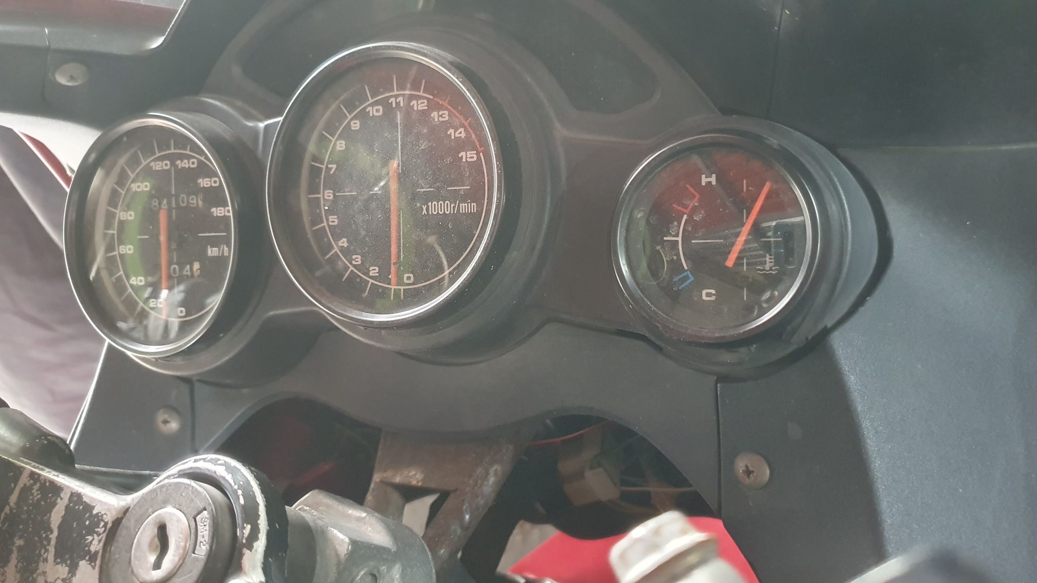

Well, that was one evening mostly wasted:
[*] RF600 wiring colours don't match with the RF400... At least the connector pinout seems to be the same
[*] probably busted the temp gauge with 12V applied...
[*] couldn't get the RPM gauge to move with function generator of my hobby charger. Probably have to take it out to bench test with the iPDM56.
[*] labelled the wires for some of the idiot lights at least
Also ordered a second 56pin connector that I can keep wired in the bike as I add features on the bench. I think I found a location last weekend with some CAD, will make a compartment.

marcexec wrote: Wed May 17, 2023 10:03 am
A lot of older gauges are run at around 9V through a voltage regulator, but I would have thought it would survive 12V at least for a while. Is it just stuck at the top of the scale? perhaps a little percussive maintenance is needed??
marcexec
Posts: 186
Location: Dublin, Ireland
Has thanked: 781 times
Been thanked: 75 times
Re: The Hitchhiker's guide to Celeron55's iPDM56 VCU & automotive Arduinoing
Post by marcexec »
You might be right. I removed the gauges (and cleaned them) yesterday and realized I should probably have done that from the start.
Well, lesson learned - take the gauges out to bench test, guys.
It looks indeed to be stuck just under the plexiglass cover.
I'll whip up something this weekend.

marcexec wrote: Tue Jul 25, 2023 1:55 pm post a picture of your setup
Here it comes. If only red (+12V) and black (gnd) at my fingers are connected, shouldn’t the unit wake up and led glow?
AdrianB
Posts: 65
Joined: Sun Jan 24, 2021 10:34 pm
Location: Wales. UK.
Has thanked: 24 times
Been thanked: 21 times
Post by AdrianB »
raine wrote: Tue Jul 25, 2023 3:17 pmIf only red (+12V) and black (gnd) at my fingers are connected, shouldn’t the unit wake up and led glow?
In a word yes. Double check the wiring and you should also be able to do continuity checks by following the circuits on the board back from the 12v + and - pins to the various components. Starting with where the pins are soldered to the board.
Carlton Commando
Zombieverter
BMW hybrid battery
Outlander charger DC/DC
celeron55
Posts: 804
Has thanked: 38 times
Been thanked: 136 times
Post by celeron55 »
Once you feed 12V (8V to 16V) to those pins, the white LED should light up, and code should run.
What does happen when you do it?
The regulator U4 near those pins is a good place to start probing with a voltage meter. The ISP header has the AVR's 5V exposed so that's also a starting point (or more like the ending point).
Let me know if the schematic and layout images here leave something to be desired: https://github.com/celeron55/ipdm56/tre ... /ipdmhw1.1
raine
Posts: 38
Joined: Sun Jun 27, 2021 10:35 am
Has thanked: 7 times
Been thanked: 7 times
Post by raine »
Luckily I have a second unit at hand and after soldering the connector to it, I plugged in the connector of the first unit to it for test. And yes, it works. Leds illuminate, so the first one was a DoA.
The second unit is working fine and I have managed to get Digital outputs (logic level, lout, hout) working like expected. However, I am still struggling with aouts and lpwms. I didnt succeed with the sample code for usage of the pwm. So if something to wish, is bit more howto use examples for those please.
But positive progress. I am sure, will get it fully working afterall.

Sorry for the absence, getting into this again primarily to drive the OEM gauges.
Higher voltage TVS diode (1,5KE20A, overkill but available) is now fitted so I can run 4S (16.8V).
I also have the stuff mounted on cardboard to move it around and bought a second connector (search for "56 pin female ECU connector") that will stay on the bike for ease of programming/testing cycles.
My Suzuki RF400 build @ES
