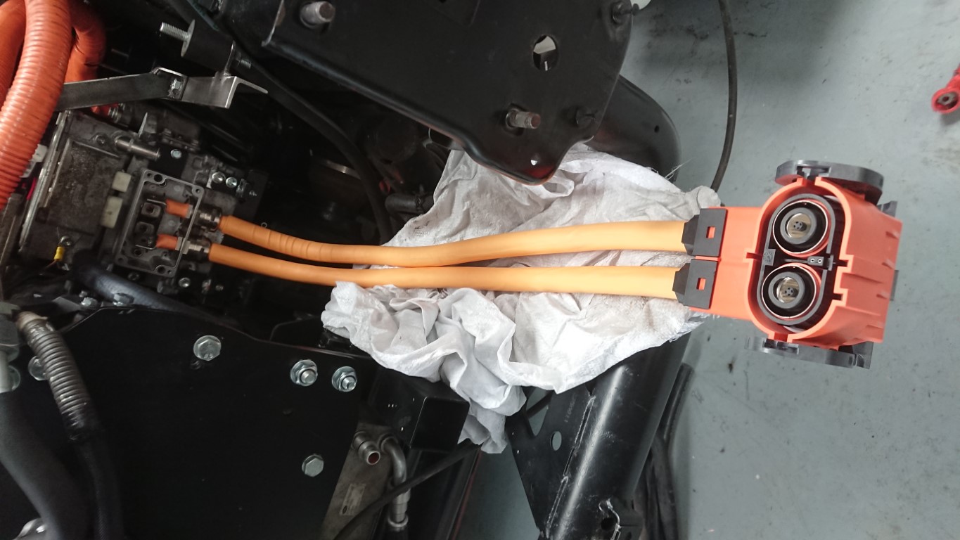

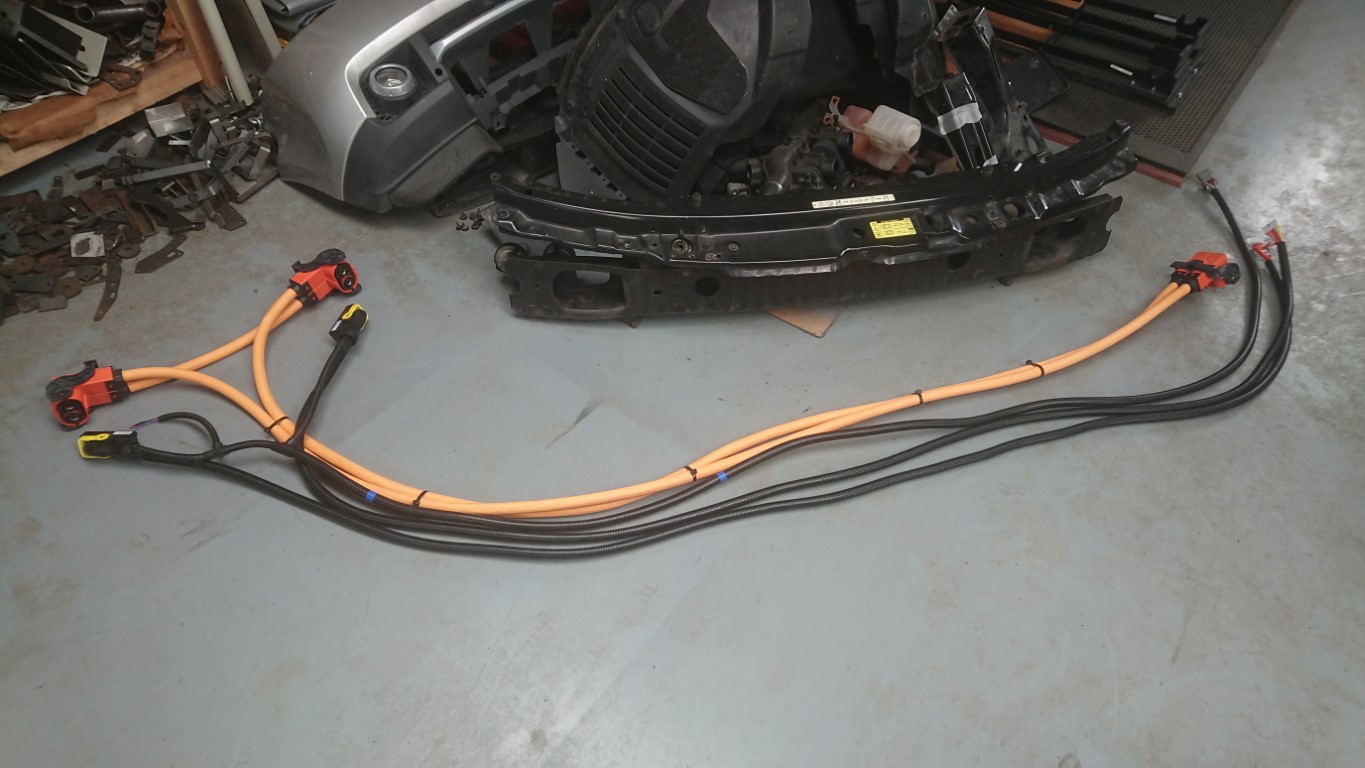

HV Loom:
Amphenol plug and socket kits arrived so had them assembled into two loom sections. Main one connects the two battery boxes and runs to the HVJB in the engine bay. Second one runs from the HVJB to the inverter

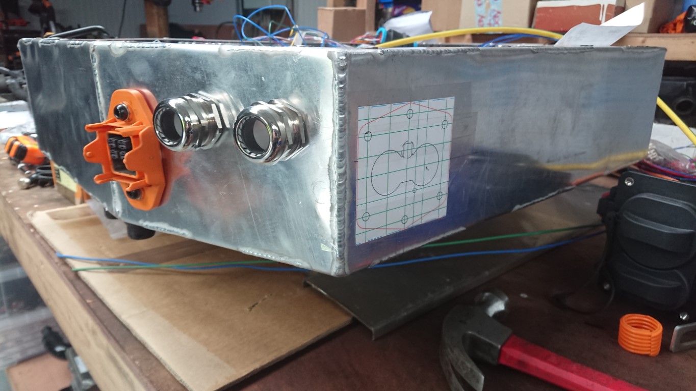

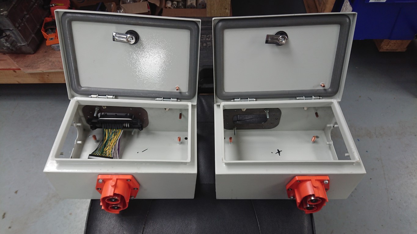

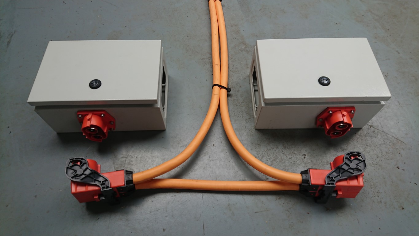

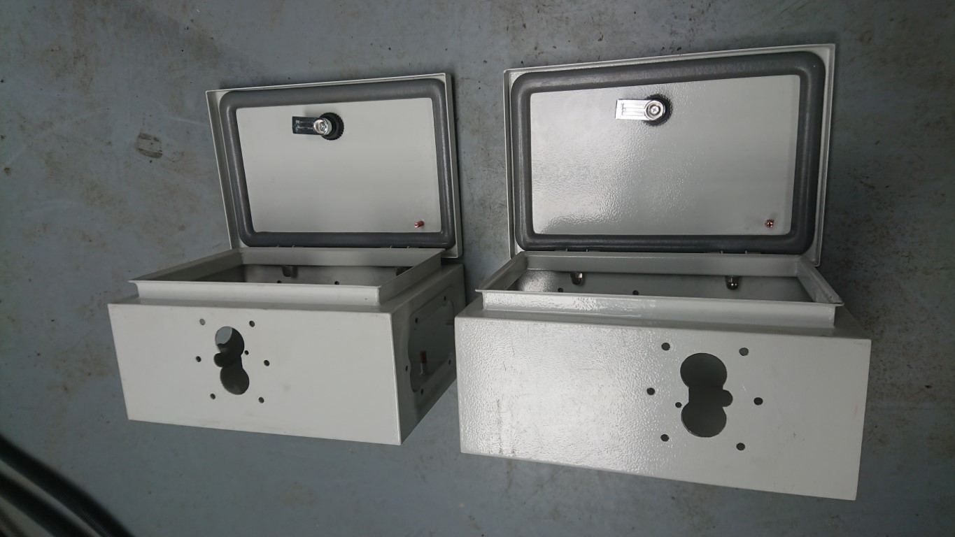

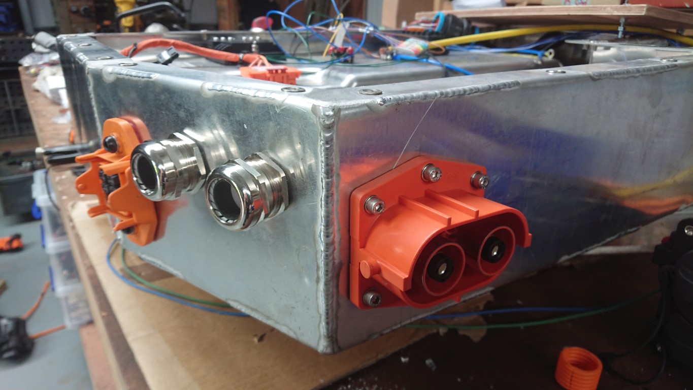

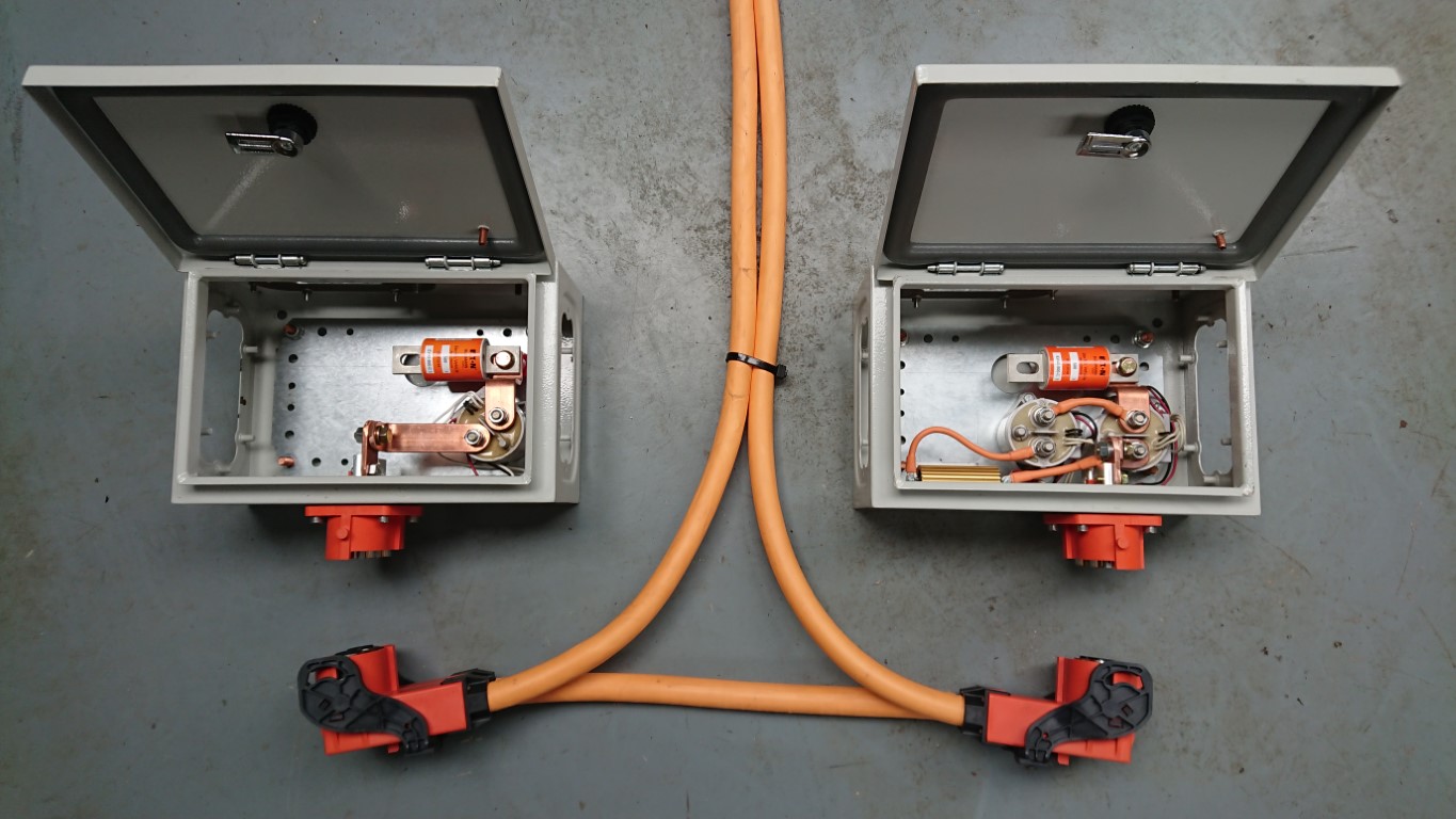

Battery Boxes:
Back to the junction boxes that will be integral to the two battery boxes.
These looms connect both battery box junction boxes to the high voltage junction box in the engine bay and consists of the HV DC loom as well as the Orion 2 BMS tap wire loom and a contactor control loom with some spare wires for future use
Final connector locations set out and quick templates drawn out helps keep everything accurate, especially when there will be multiples of the same cutout
This is how the HV DC loom will connect the two battery boxes

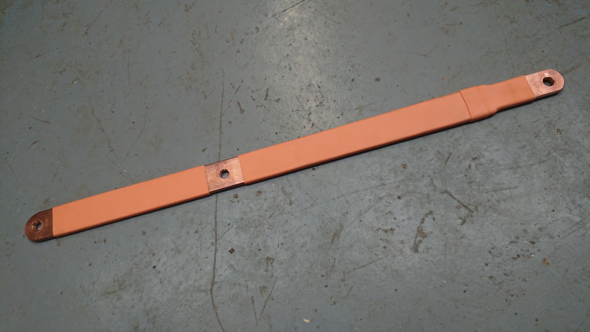

Then back to the fiddly busbar work
The negative junction box with its own fuse and contactor for HV-
And the positive junction box again fused with a HV+ contactor, as well as a pre-charge resistor and contactor

Inverter:
Probably won't get very far with those spindly wires! These were used with the 48V bench test voltages
Time for an upgrade and another matching connector that will also connect to the HVJB in the engine bay
Will add some suitable cable clamps once things are lined up

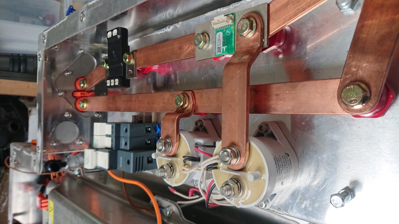

HVJB:
The high voltage junction box in the engine bay will house the Tesla Model 3 PCS (AC and DC charger and DC-DC unit), as well as connecting the battery to the inverter and charging interfaces, which means more connectors :roll:
Originally I planned to hard wire the battery box HV DC cables through cable glands into the rear of the HVJB, but changed direction to allow a more modular build, so how to work around the original holes!
This took way more time and messing than you'd expect!!! Trying to get a layout that works for all the various connectors and wiring that will follow. I have two shunts here, the ISA that will work with the Zombie VCU and the original Tesla Model 3 shunt which when used with the Tesla high voltage controller will provide a lot of data over CAN. So keeping options open for now. There are also two contactors for HV DC charging (have a BMW i3 LIM ready). And finally fuse holders for the TM3 PCS, A/C, and cabin heater
Busbars take up way too much time, but getting there. After I figure out the various taps onto the HV busbars for the fuses etc, I'll heat shrink remaining surfaces

HVJB:
So the Orion 2 BMS needs its own shunt too! Required a little trimming and tweaking to the main busbar to allow it to fit and some tidying with heat shrink

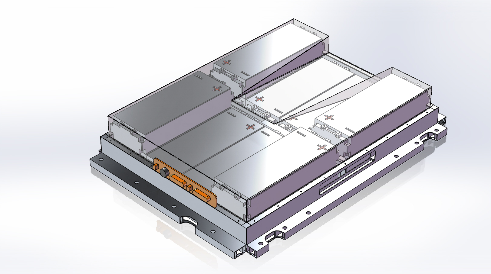

Getting back to the batteries, and there will be a link between the two battery boxes that requires the lower battery module in each box to connect to a junction box. Chance to repurposing some of the original TM3 busbars
I've not tackled the damaged alu BMS trace yet, but have been investigating and experimenting with what looks like a good solution. Testing on some yogurt pot aluminum lids with minimal cleaning/prep and so far I'm surprised at how strong the hold is...build up some courage to tackle that trace soon maybe!

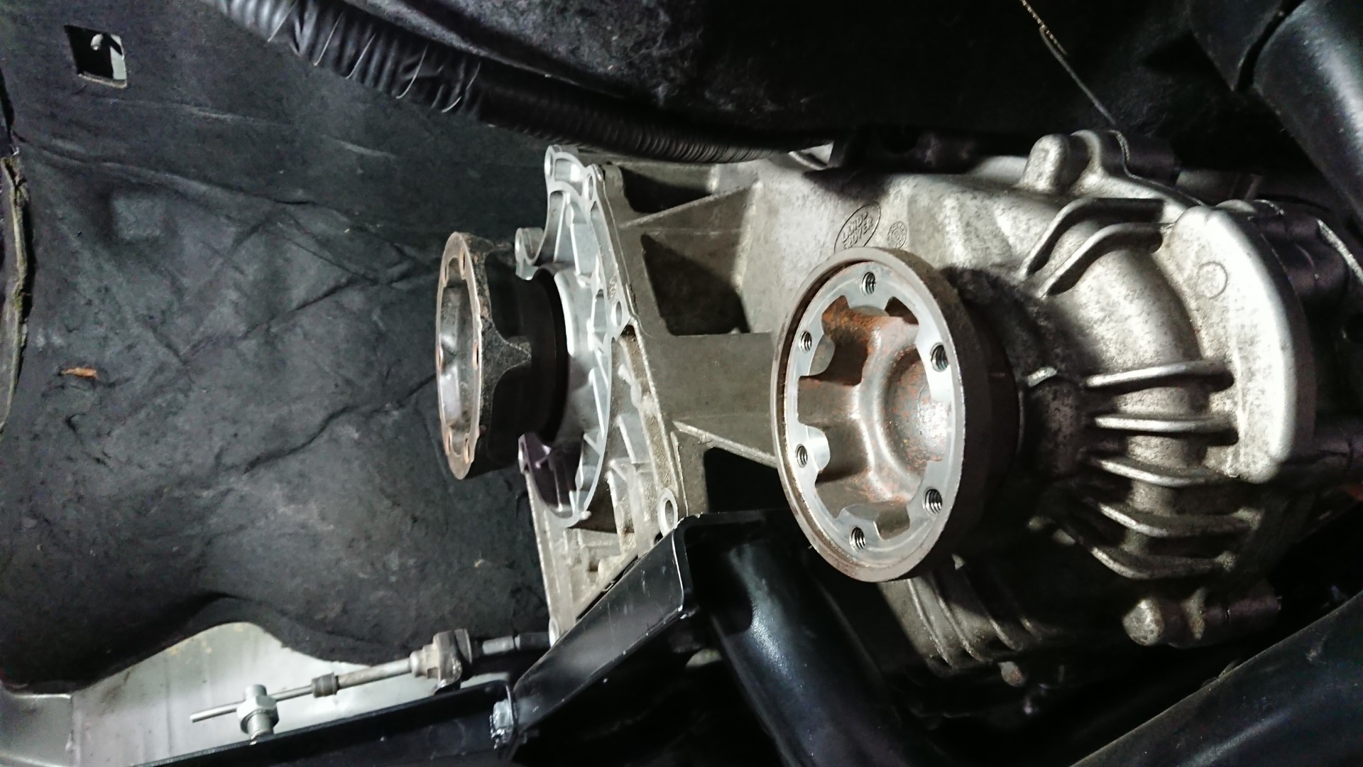

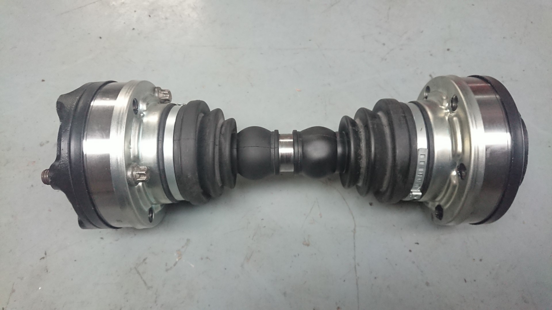

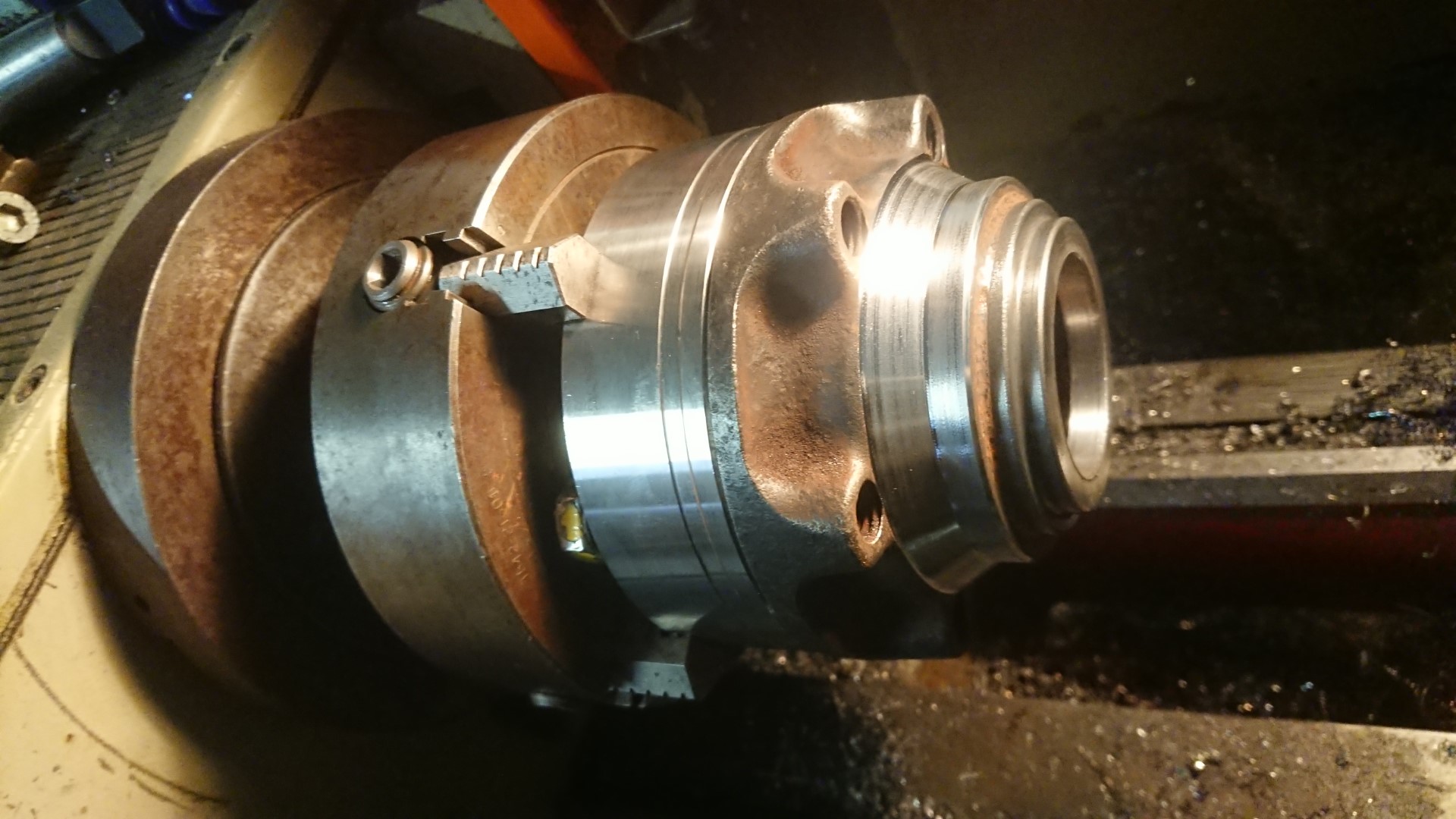

Transfer Case:
The divorced transfer case input stub has caused some headaches along the way holding up that first wheel spin, so decided to try tackle this myself...but not holding my breath! Had spares for the transfer case spline (from a failed gearbox) and a CV flange.
The gearbox output shaft gets a retaining round cir-clip groove before being cut to length and chamfered for a final weld
Where I think the previous version tried to use the CV cup spline shaft in the lathe as a datum, I'm trying to use the CV itself to give it the best chance of alignment. CV gets set up with the dial gauge first and then the CV flange bolts on and more dial gauge checks
Fingers crossed
Using the freezer and the oven, managed a tight shrink fit, and before any welding a test fit seems to look good

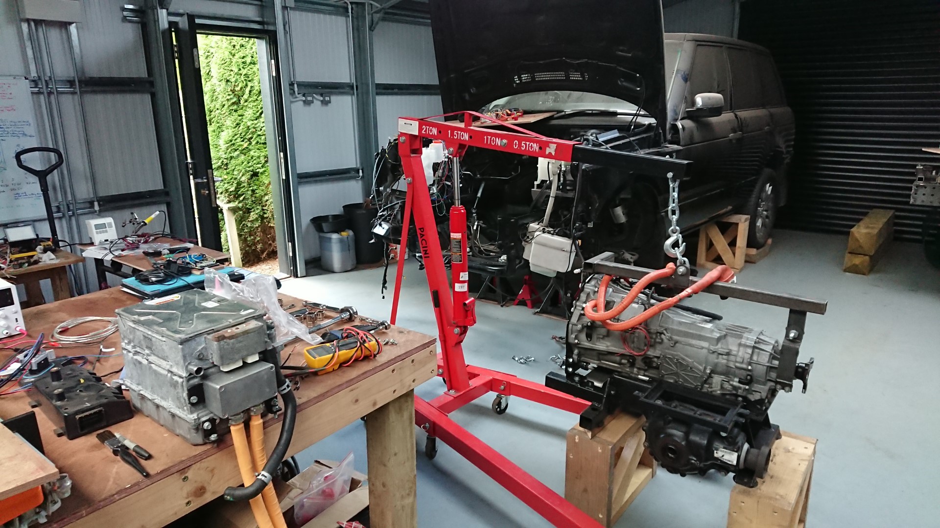

Back to the Transfer Case:
In an earlier post I looked at the motor to transfer case drive shaft angle mock up as the motor sat in the engine bay. I wasn't happy with the drive shaft angle (>12 degrees) but was going to test with this to keep things moving, worry about it another day! Another day has come round, so time to undo previous work...again :(
Out it comes again
Originally the motor was mounted to clear the front diff, axle tube, the right hand side axle carrier, and some rigid steering rack hose lines
This time some parts get changed. RHS axle carrier mods
New, and hopefully improved, divorced transfer case input stub shaft welded up and fit in place
After a lot of time, it doesn't look any different! :? But the motor sits 50mm lower and about 20mm closer to center
Checking alignment
New drive shaft fully assembled
And it looks like an angle less than 5 degrees, that's better. Will it vibrate :!:

Battery:
While I keep an eye out for a replacement TM3 24 cell battery module (recent cell issue), I've been following Johu's work with the VW ID modules. I see them used in commercial universal packs and they have a number of BMS options. So considering an early upgrade to the battery situation!!! :o No harm in looking!
Trying to see if a full 82kWh pack will fit. This is the 12 module pack, and the larger modules means fewer new busbars compared to something like an I-Pace pack
The overall footprint has to get a lot smaller, but I have scope to make the pack deeper. Considered mounting the modules on their side as I have to leave rear driveshaft clearance down the center. This raised questions about having to reduce the capacity due to being mounted on their side and also made cooling a bit tricky. This option gives a narrow footprint which works with the chassis rails
Next option almost works with less modifications to the original battery casing. Plan is to reuse the casing and to try reuse the cooling and underside crash plate. But this sits wider than the chassis rails and so lowers ground clearance where it sits
This is looking like a solution. Keeps the modules flat to retain max capacity, reuse most of the original casing, I think I can modify the underside cooling plate to work for the lower 8 modules, and then use the cut-away cooling sections and incorporated them into the lid top to cater for the top four modules!!! To be investigated further. That would keep all coolant lines outside the pack like OEM. There's free space in the center for the contactors and BMS unit, but as Johu found, the top modules might need to be mounted upside down to simplify busbars
To be continued...
