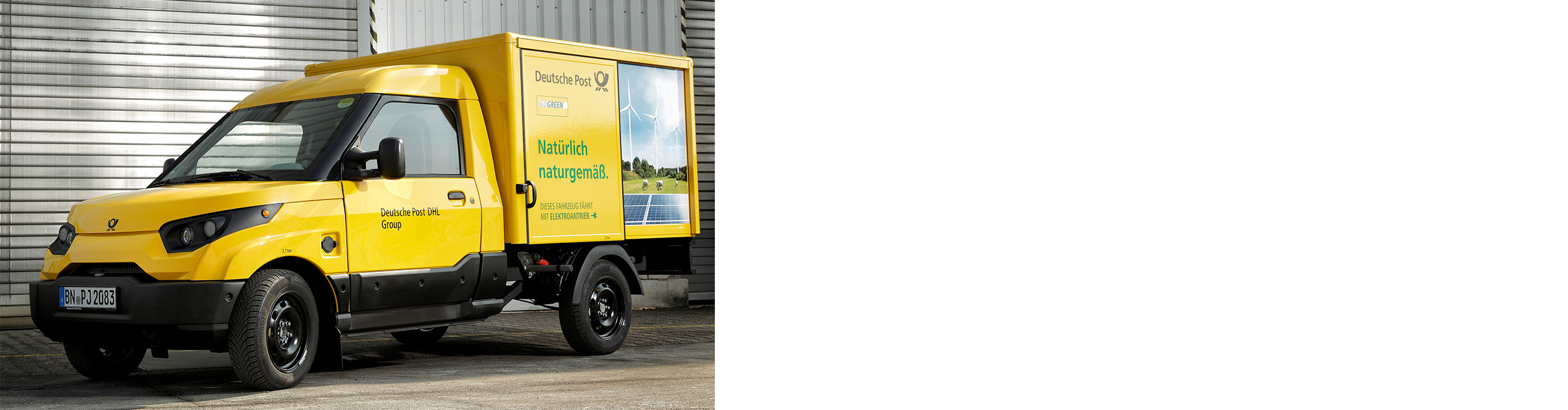

I have a problem with a conversion. For business (I'm self-employed) I have the task of building an electric chassis for a fake LMDh racing car. It is to be used for advertising purposes. For this I bought a Post Car (Streetscooter) and took over most of the EV components. ABS, power steering, brake booster, lighting, window regulators, air bags, seat belts, central locking and electric mirrors were not installed. To make the Power Control Unit happy I simulate the ABS and power steering using an Arduino. I have no error messages when switching on the ignition and the car can be started and shifted into gear, but if I drive faster than 6km/h I get an engine malfunction and the car stops. Any ideas?
before and after pictures
